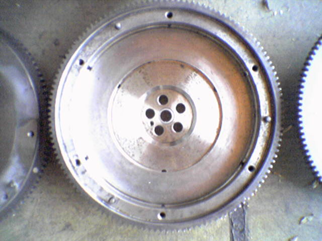

Here's a picture of the new flywheel which measures just over 200mm across the large flat area.

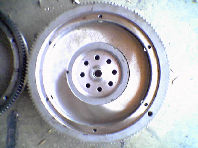

And my stock 1.8 flywheel, which measures around 220 mm across the open flat area.
Mueller
post Jun 20 2005, 03:02 PM
914 Freak!
Posts: 17,155
Joined: 4-January 03
From: Antioch, CA
Member No.: 87
according to KEP, that size is good for up to 300hp depending on pressure plate used.....

That's what I read, but I just don't know if a pressure plate/clutch that size would work on a 901 transmission. I'm not really sure what would be different, perhaps where the transmission shaft goes into the clutch disk? Are the splines going to match? Is the diameter of the main shaft going to work out? Also the release bearing, I'm wondering how that will work.

It'll work fine. I'm using the 200mm in my 356 conversion. 140hp....215mm is better but requires the flywheel to be cut again...obviously...just make sure the right TO bearing is used....

i do know that a 228mm pressure plate* bolts onto a 215mm flywheel (stock 914 size) and I'm guessing it would work with yours also

Looking at the pictures, it seems that because the inner diameter of the toothed ring is considerably smaller, that the bolt holes for the clutch plate are drilled on a smaller diameter ring. I'll measure it later and see if its just an optical illusion or not.
