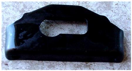

I saw this lockout plate on the Pelicanparts site.
Can anyone tell me where this thing goes? Did my car come with one? do I need it?

That plate goes inside the actual shifer in the cockpit. I have heard that they can wear out, but I have never experienced that.
If yourr bushing are truely "new or in good shape", I would look at readjusting the shifter next. This is done in car, via the hole a the base of the shifter. Do a search here as I think somewhere, someone did a pretty good job of explaining it.

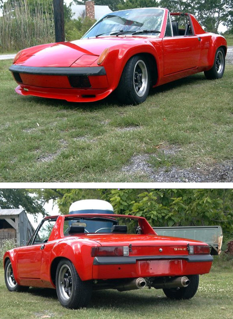

As requested, here are a couple of pictures of my 914. I have the engine and trans out of it at the moment to fix a leak at the crank pulley. the seal was apparently damaged when it was installed.
It should be moving under it's own power again next week end.
A little info:
it's a 74. I traded for it as an unfinished conversion.
2.2 litre 6 with webbers
headers - no heat.
Fortunately it already had the flares and nice paint. I spend the last 11 months welding up rust holes, installing stiffening kit, brakes, sway bar plus lots and lots of other stuff. It has definitely been a learning experience.
There's tons of work left to do before I'll be satisfied with it, but autocross season is starting soon and I need to be ready. I can dig into it again this winter.
