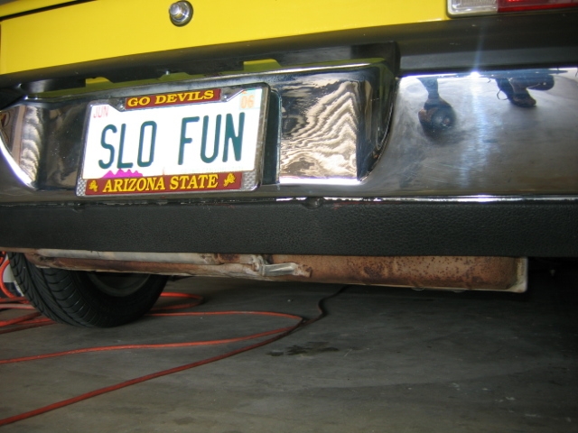

When looking at the back of my car, the exhaust really looks like crap. I would love if a quick coat of that high-temp stuff would clean it up a bit. Any experience as to how well it would hold up on the exhaust?

Thanks for the advice. Since this exhaust is somewhat temporary, I think I'll try my luck with the paint. It sounds like it holds up decent. I just didn't want to paint it on and have it flake off by the end of my street.
