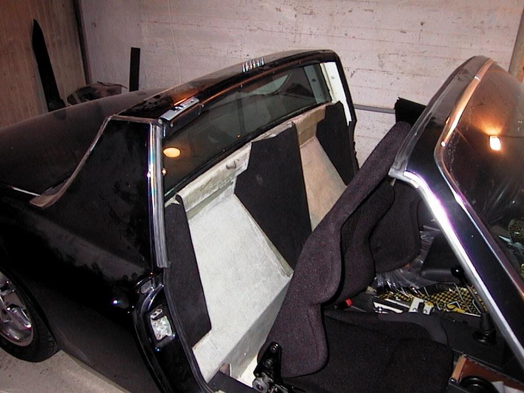

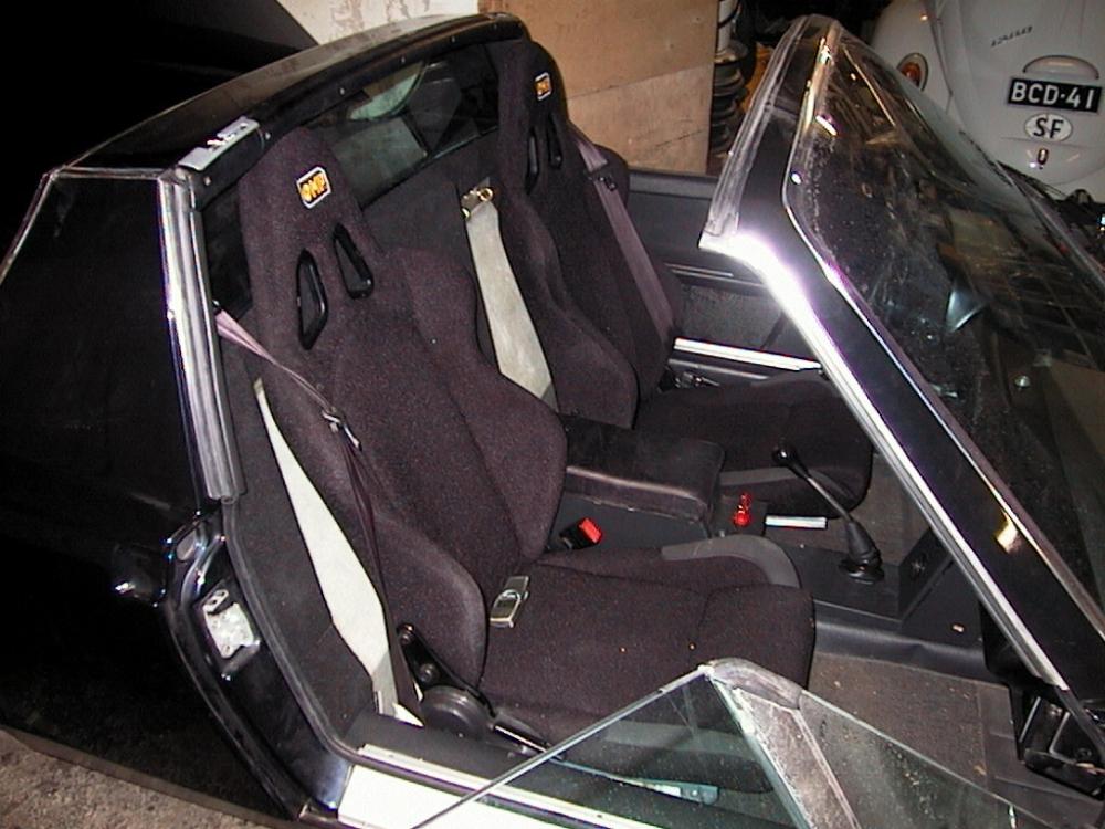

I did my from F/G. Seats are OMP.

hey tim those seat look like exactly what i want. whicjh model are they, and are they comfy
914Timo
post Aug 2 2005, 02:53 AM
Posts: 743
Joined: 13-January 03
From: Finland
Member No.: 137
Region Association: Europe
Oh, yes. Thay are very confy. The model name is comfort (IMG:http://www.914world.com/bbs2/html/emoticons/laugh.gif)
LINK
Seriously, they are ok, but not 100% comfy. I think the quality is not the best part of them. I am not a big guy (about 70 kg), but sometimes I think they can not carry even my weight properly. The side bolsters of the back are too big for 914s. Hard to get in and out. So, go and test them first and then decide if you like them or not. I think they are cheap and they feel cheap too. But, when I bought them about 4 years ago they were the only model that fit even barely inside 914s. All other models were too wide and high.

I realy like the looks of that interior. How did you make that?

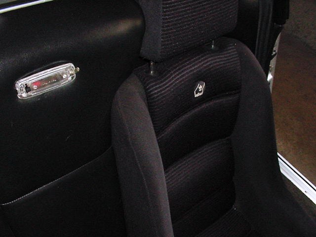

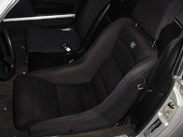

konig. it just clears the indent in the backpad.
k
