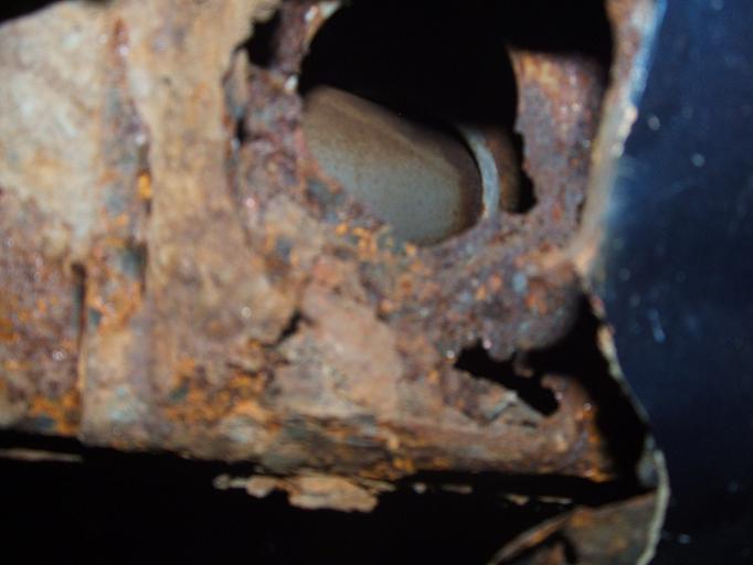

guys do you think its a serious rust??
and i know i need to buy the rocket panel , do i need more parts for it?

That IS serious rust. That is your longitudinal - provides structural ridgidity for the car. Any rust behind the rocker panel is not good and that rust is bad.

The passenger side is usually worse, so be sure to check over there thoroughly.

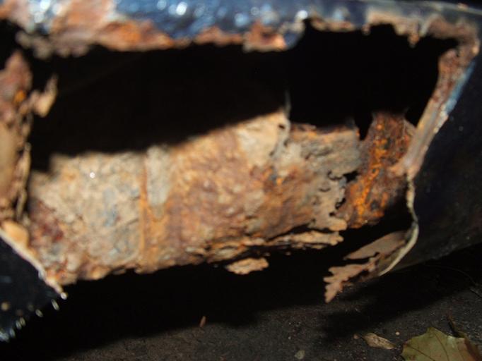

I think i see about an 1/8" of bondo in that third picture? I hope that it wasn't rigged up so it was hidden. That would suck. But yes, pretty serious rust.

See all that red stuff?
Needs to be replaced with shiney stuff.... (IMG:http://www.914world.com/bbs2/html/emoticons/wink.gif)
You can only tell once you grind down all the rust and get to solid metal. Once you do that, then you should be able to know what needs to be reaplaced....
Currently I bet one cubic foot from the hole needs to be replaced.

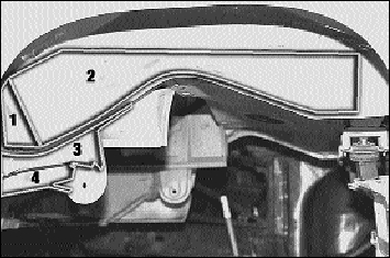

QUOTE (bender @ Nov 4 2005, 07:40 PM)
which parts do you think i need??
thanks alot
Best you click here, select 914 Chassis & Exterior, and possibly consider left & rights of items 1, 2, & 6, plus anything else you'll find cancer-ridden upon deep inspection.

so by the pictures u saw u think for the roket panel area the items u just mentioned it will solve the problem?
it needs to cut the steel out and weld the new parts???

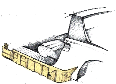

also do you think i need also the rocket clamshells?
or the chassis stiffening kit ?
thanks a lot

You have a significant job in front of you. If can be done, step one if to stop driving the car. Step two is to start stripping parts off of it and using a wire wheel to strip back paint and rust scale to see how bad the problem really is. Finding a good drivers side section off of another car shouldn't be a problem. The passenger side is so common that used replacement panels are hard to find. If you can find one that's monstly good, then you'll be a lot better off. Buying brand new metal for those areas gets really really expensive really quick. Keep us posted. Looks like fun to me, but I'm used to it. (IMG:http://www.914world.com/bbs2/html/emoticons/wink.gif)

the clamshell

The chassis stiff kit get attached farther back than where your rust is. So it won't help. Get Engman's Chassis Stiff Kit instead.

and what about the clamsell??
i need also or the kit that u just mentioned will do it?

If you can find used metal (my recommendation), you don't need the clamshell. But first you must explore just how extensive your problem is and you can not do that with carpet, seats, etc installed.

When I saw that rust, I jumped up on top of my desk and started kicking my feet in the air like a donkey (IMG:http://www.914world.com/bbs2/html/emoticons/confused24.gif)
Yes, it's that bad.
Take all the parts off the car that interfere with the surgery first.
Poke around with a screwdriver to find where the good metal starts. Mark that.
Now determine if you want to fab your own repair parts or find a section from a donor car.
I like those 80 grit flap discs on an angle grinder to clean up metal FAST.
