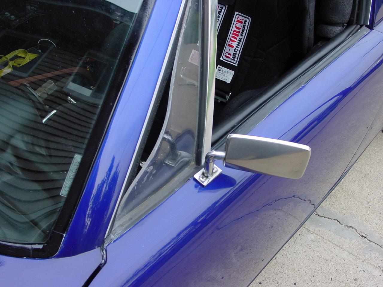

Bunch of rookies, here's how to get air into the driver....

I love it! (IMG:http://www.914world.com/bbs2/html/emoticons/smilie_pokal.gif)
