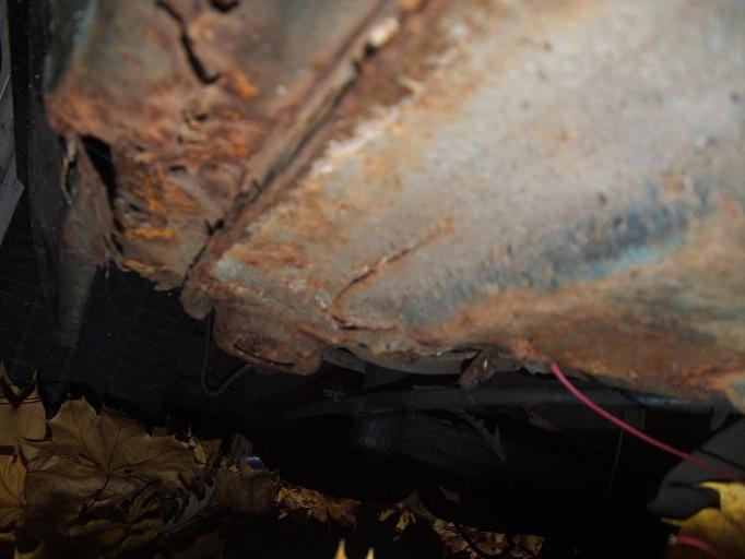

QUOTE (bender @ Nov 9 2005, 09:08 PM)
what do u think guys?
(IMG:http://www.914world.com/bbs2/html/emoticons/barf.gif)
longs are completely rusted away behind those rocker panels ....
run for the hills, that's what i think ...
(IMG:http://www.914world.com/bbs2/html/emoticons/unsure.gif) Andy

(IMG:http://www.914world.com/bbs2/uploads/post-2-1131595631.jpg)
This chassis is gone.
It will split in half soon. That crack is the chassis already splitting.
Spend the money and get a good car (best option) that you can drive and modify to your liking. (and drive WHILE you modify, something that I have been fortunate to enjoy.)
Or like everyone is also saying, buy a chassi. Many good examples. Heck, check the classifieds!!!! Theres a blue flared shell thats been in the classfieds for ever.. and a driver for 2k... Project in oregon, looks nice. 1k
