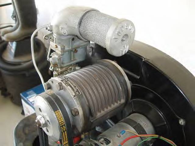

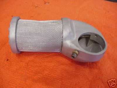

I should have been a little clearer on the intake. It does use the stock manifold, but it uses a special air filter instead of the stock oil bath. What I am missing is the air filter intake thingy mahoozit. It lookie lika dis

Dis it on da cah

Just a wire mesh filter.....get a foam sock to put around it and spray it with the sticky shit..........

Do Tekkor's thingy....go to home depot and buy 90 degree elbow, 6" of PVC pipe, and an end cap.
Drill numerous holes in the 6" piece and cover with a foam sock.
