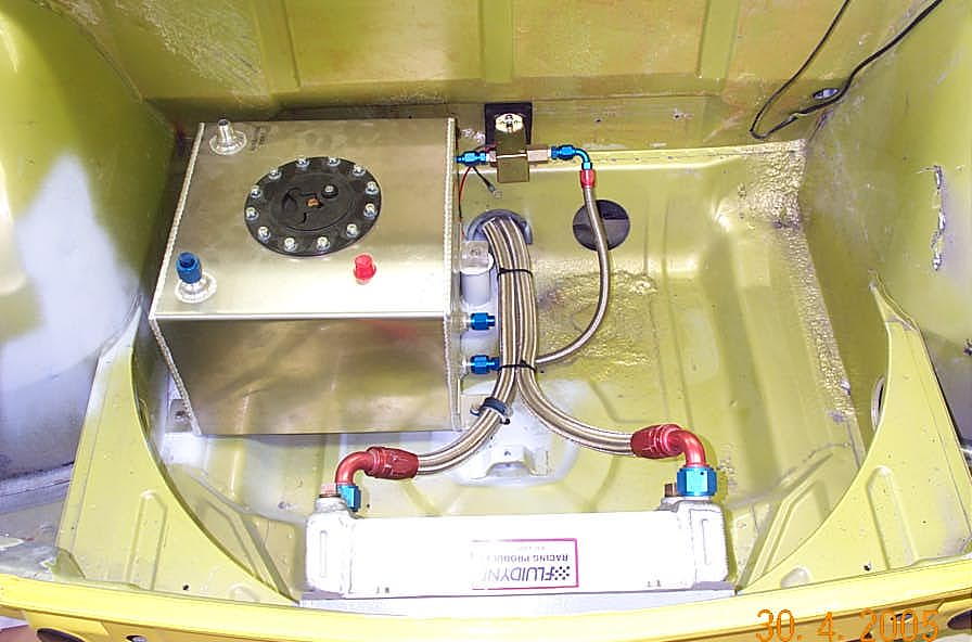

This is not a fuel cell, but a foamed tank. It's 5 gallons but I usually put less that 4 Galons in it. Around 200 bucks from Summit Racing.
Edit: 149.95...found my Summit catalog

auto cross small 2-5gal tank like shown would be nice...
