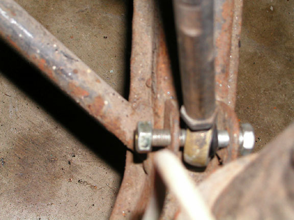

Also, do I leave the space in the u-tab on both sides of the drop link or add spacers/washers? (IMG:http://www.914world.com/bbs2/html/emoticons/screwy.gif)

You need that lower Heim Joint to be able to move, so dont just stack washers... they make special cone shaped washers for exactly that reason.
As far as the horizontal bar goes, set them the same on both sides, the are adjustable so you can increase or decrease the amount of force transfered. Closer to the end is weaker, closer to the bar is stronger

QUOTE (Crazyhippy @ Dec 29 2005, 10:48 AM)
Where do you get these?

Their called rod end spacers.
Hererod spacer

QUOTE (sj914 @ Dec 29 2005, 02:11 PM)
Hererod spacer
(IMG:http://www.914world.com/bbs2/html/emoticons/huh.gif) $8 shipping for $2 parts...

You could try a shop that does suspension work.
here's another link

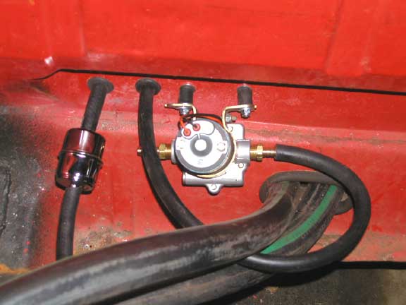

Got the pump in but my isolators are too loose in the side mount. I may go ahead and mount them solid and of course I need to move it to the right to take the kinks out. (IMG:http://www.914world.com/bbs2/html/emoticons/screwy.gif)
Found out the fuel line in the tunnel is metal, thanks Brad and crew...

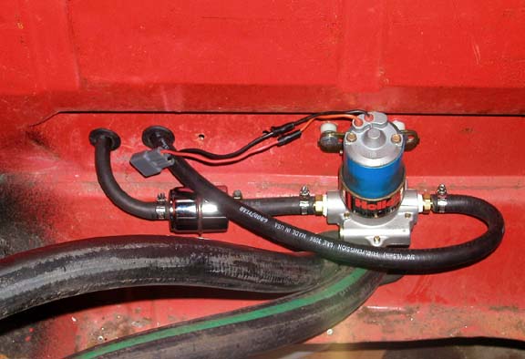

Finally finished the installation of the fuel pump. Had to get different size grommets because the 1" were just loose enough to slip out. The vibration isolators didn't hold the pump from the side so I used some plastic bushings. Soldered on a connector. Drilled new holes to relocate the pump. Changed the bolts 3 times, sheesh all this eats so much time... (IMG:http://www.914world.com/bbs2/html/emoticons/wacko.gif)

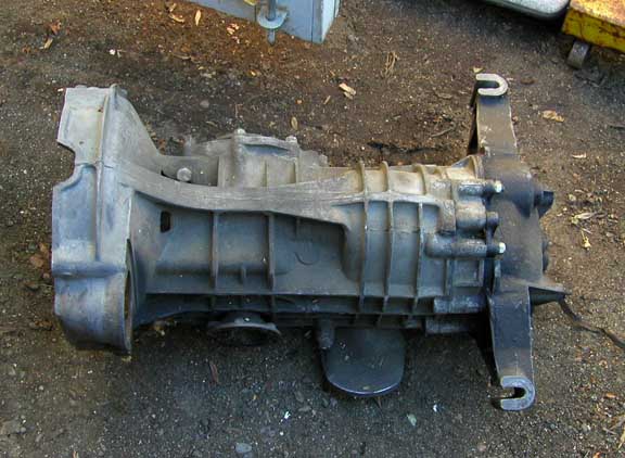

had to clean up in front of the garage getting rid of a couple of engines and my wife's attachment to her first car.
At least the engine is off the stand and I've started to assemble things. Cut an aluminum dust shield, installed the pilot bearing (hope the pounding didn't mess up the crank) (IMG:http://www.914world.com/bbs2/html/emoticons/ohmy.gif) , fit the adapter plate...

dirty tranny...

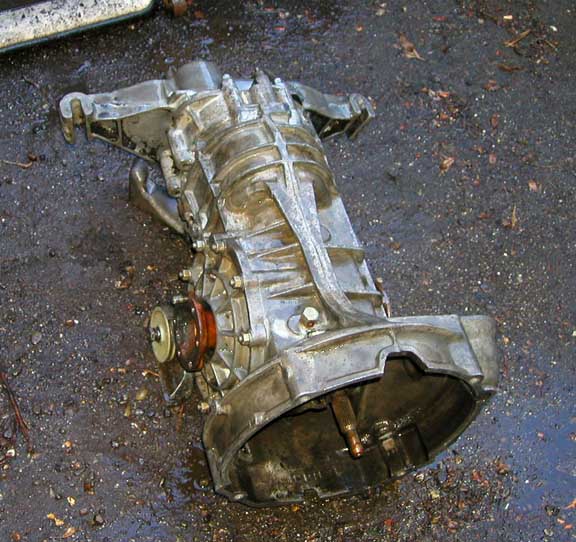

clean tranny...

901 spare? or Jaide trani?

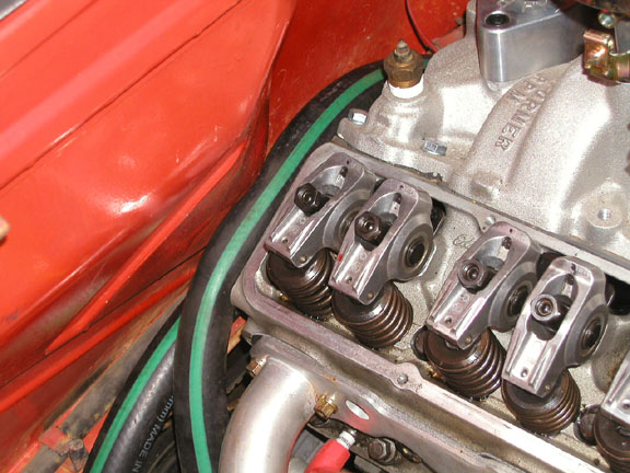

I expected to use a hammer on the firewall for valve cover clearance but the w/p hose is also compressed between the head. Too tight for comfort! (IMG:http://www.914world.com/bbs2/html/emoticons/screwy.gif)
