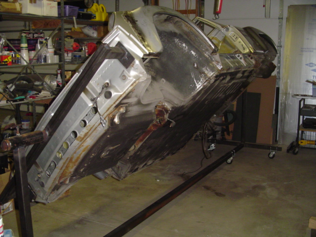

I was supposed to be Jetskiing in Daytona right now, but stupid a** Spirit Airlines cancelled my flight and left me stranded at home instead. I felt bad about takin' off for the weekend with soooooo much to do to my car anyway, so I made the best out of being stuck and went and bought some tubing and made my rotisserie.
Took the good part of a day to build and damn I wish I had done it a lot earlier. It makes working on the car so nice!
Here's a pic...........

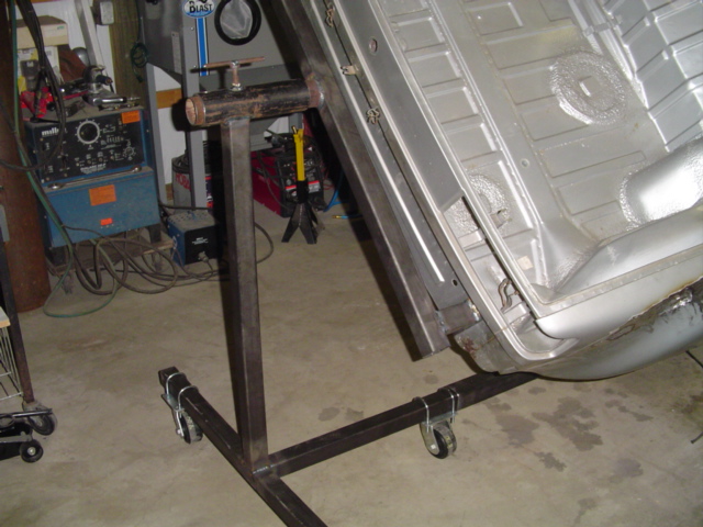

nuther......

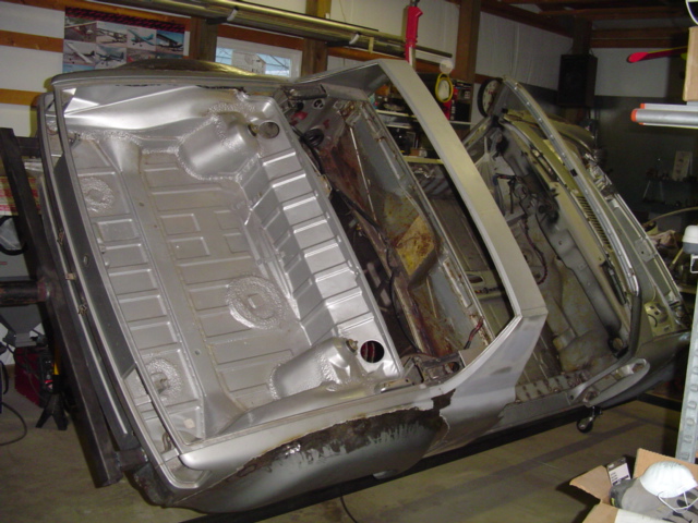

One mo......

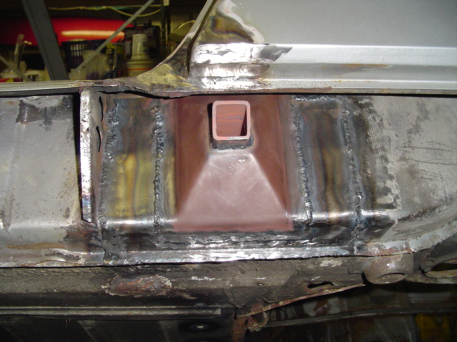

And then took advantage of the newly available angles to repair the drivers long and replace the jackpost. It took about 1/4 the amount of time it took when I did the passenger side because the access is so much better with the rotisserie.

Looks great, and a good looking tub too!

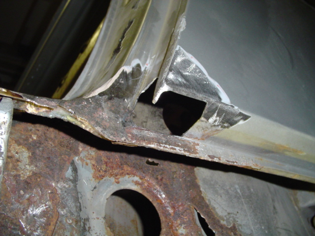

Oh yeah, before shot of the jackpost area........yuck!

Don't know if I can scan the convenience store napkin that I drew the plans on in the parking lot of the metal supply yard! (IMG:http://www.914world.com/bbs2/html/emoticons/wink.gif)
It was really pretty easy. I just measured the length/width of the car and winged it. I will probably make this available to club members in the NJ/PA/DE area when I'm done. I'd rather see it used than stored.

How's the balance at those pivot points? Does it prefer to be right side up or upside down? Does it just bolt to the bumper mounts? How thick is the tubing? Anything you'd change if you were to do it again? (I'd like to know before I copy your design (IMG:http://www.914world.com/bbs2/html/emoticons/wink.gif) )
