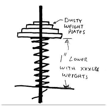

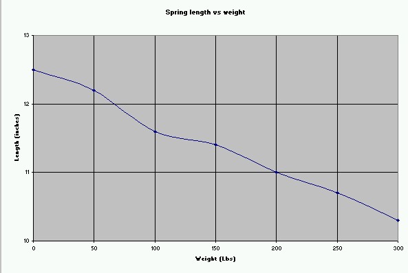

Ok, I tried it with more weight. I added weight in 50 pound increments, up to 300 lbs. I got more than 2" of compression. It looks like it's pretty linear.. I even graphed it. These are supposed to be 180 lb springs, what do you guys think?

QUOTE (bondo @ Jan 17 2006, 03:17 PM)
besides the fact that you are a geek??? (IMG:http://www.914world.com/bbs2/html/emoticons/smile.gif)
looks like you are on the right track....
my method (I am not an artist)

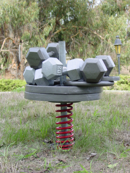

Ok, here's the pic.. this is 300 lbs. Half the pipe is pounded into the ground. (IMG:http://www.914world.com/bbs2/html/emoticons/smile.gif)

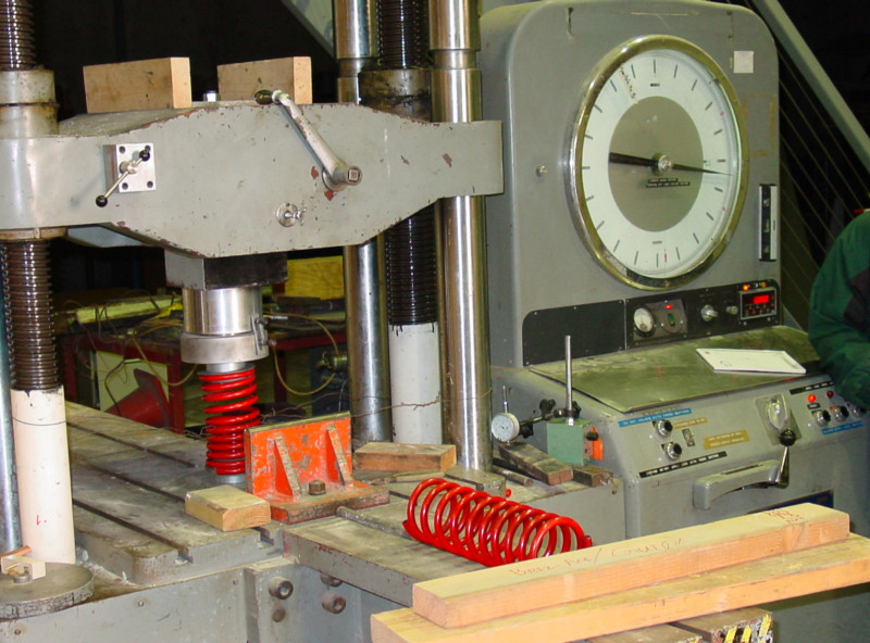

Ok, I measured the spring and used this formula to calculate the theoretical spring rate. (theoretical because not all alloys that are used for springs are the same) It comes out to 160 lb/inch. It also can't be exactly accurate because I measured the paint, which has some thickness.
Of course I'm not the type to be satisfied by math.. so I rounded up a spring tester.. of sorts. The displacement accuracy is .001.. the force accuracy is 1%. This is the sort of thing that satisfies me. (IMG:http://www.914world.com/bbs2/html/emoticons/happy11.gif)

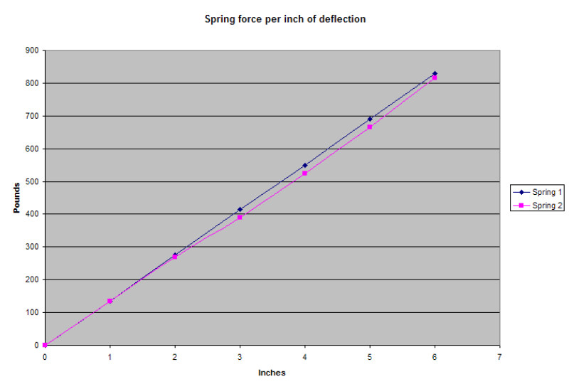

Here is the graph of the data. (I did the graph a little differently this time.. makes more sense this way.. displacement vs. force) I tested both springs, as a double check. There's no way around it, this is a 140 lb spring.
