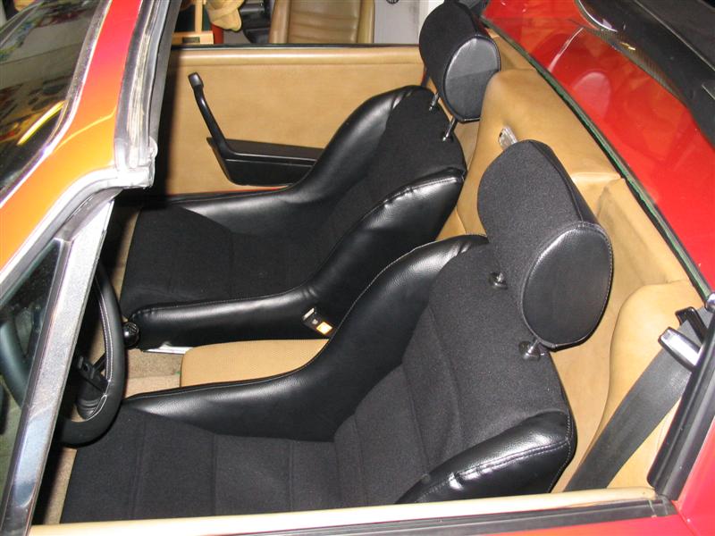

And here they are installed. Man the second seat sure went a lot quicker than the first. What a PITA the first one was. Partially my fault for not centering one of the holes I had to drill.
Not to crazy about how it looks with the brown backpad. May replace it with a thin piece of wood covered in black. A project for another day...
