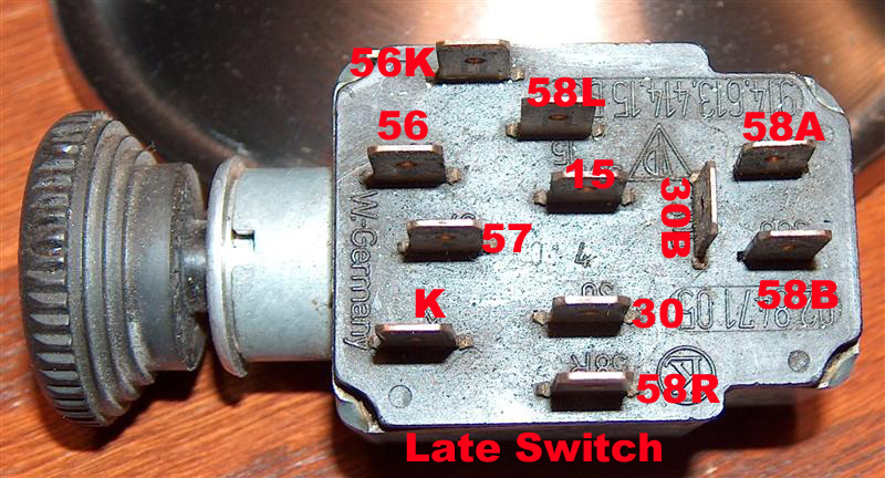

anyone got a picture of the pin-layout of a early vs. a late Headlight Switch ???

(IMG:http://www.rccauto.com/engine/switch.jpg)

okay, which is which
SLITS
post Feb 1 2006, 02:37 PM
"This Utah shit is HARSH!"
Posts: 13,602
Joined: 22-February 04
From: SoCal Mountains ...
Member No.: 1,696
the one with 10 pins is early....the one with 11 pins is late.....or try babelfish translation (IMG:http://www.914world.com/bbs2/html/emoticons/av-943.gif)

And how many pins are actually REQUIRED? Just 4:
1 +12 in
2 +12 out to side, tail lights (1st position)
3 +12 out to main lights (really, hi/lo switch or relay) (2nd position)
4 +0-+12 out to dash lights (dimmer knob)
The difference is what's split inside the switch v. what's split outside the switch.

Ron, can you clean off the late switch so i can read the terminals???
muchas gracias....
it *gasp* may help me fix some gremlins....

QUOTE (Aaron Cox @ Feb 1 2006, 05:44 PM)
muchas gracias....
Cleaned, labeled and parfumeed for the little Corona engineer......toot toot
Oh, you need to look at the image a few posts above....then scratch and sniff..........

ron was off on a few pins....
ironically, i think this solves my foglight problem.

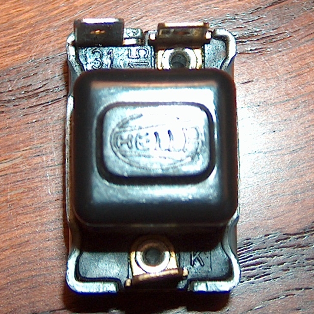

just for reference in case someone does a search in the future...
this is a fog light/rear defrost switch (same switch - different knob insert)
should be able to read the 3 terminals....
