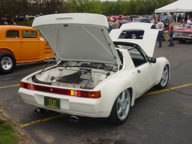

The shocks work just fine. I bought my pair from E-Bay. I had to use them because my v-8 car is so bastardized that there wasn't any more room for the "torsion bar" spring factory setup. If I had a stock 914, I'd keep the stock spring assembly though.

I replaced the springs in the front and the torsion bars in the back with gas shocks. I like the idea of upgrading little things like that to modern technology. Having said that , the carbs I have on it aren't exactly state of the art. l
