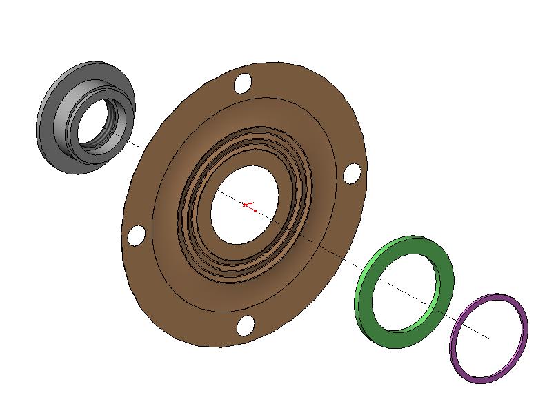

Sorry for a very delayed response from me on this with relation to the drawing for the diaphragm. I have been extremely busy lately and didn't get to spend much time on it.
Jeff B. and I did have some offline discussions during this time. Originally, I had planned on designing the boss on the diaphragm so that it would attach to the diaphragm with a threaded nut. So I was going to try and source an appropriate sized nut to do this. But Jeff suggested that we just replicate the original design rather than trying for the nut approach. I'm fine with that.
But the diaphragm that Jeff sent me is a good one and he doesn't want it destroyed. And in the assembled state, it is very difficult for me to tell which parts are which in the pressed-together state. Here is what I wrote to Jeff regarding this:
With the idea of replicating the original, it is very difficult for me to tell how it was assembled without cutting one apart. There are 4 'steps' to the center boss where the retainer is installed. It is difficult for me to tell which part is what, and if the retainer is simply a retaining ring that has been pressed on, or if it is a part that is highly deformed when pressed on (as in, the retainer starts out as a ring, but ends up with a step in it).
Anyway, take a look at the images I have attached. This is one way it could have gone together. It involves four parts: the diaphragm, the boss, a washer, and the retainer. In this case, the retainer is just pressed into place (not deformed).
Here is the exploded view I sent him:
Demick

And below is the assembled version.
Maybe Geoff or Dave can send me a bad diaphragm (OK if it is already cut in half). That way, I will be able to replicate exactly the design the factory had for this.

It is not a 3 piece unit but two pieces. The ring is held in place by the collar being mashed onto it at the step shown by the red arrow.
I can send you the other half piece I have sitting here on my desk. Send your address to me.
