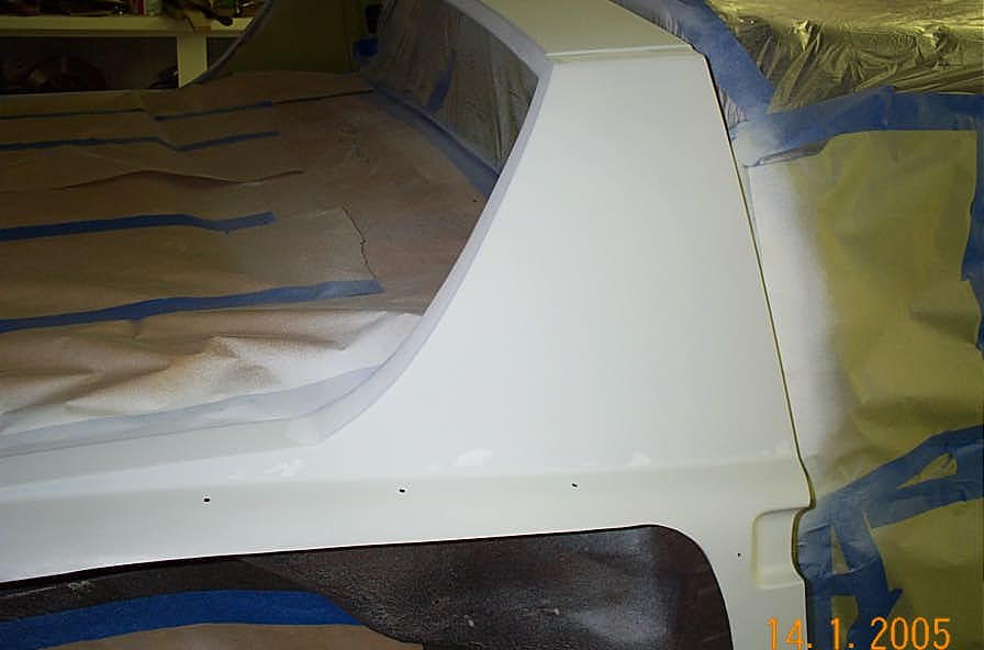

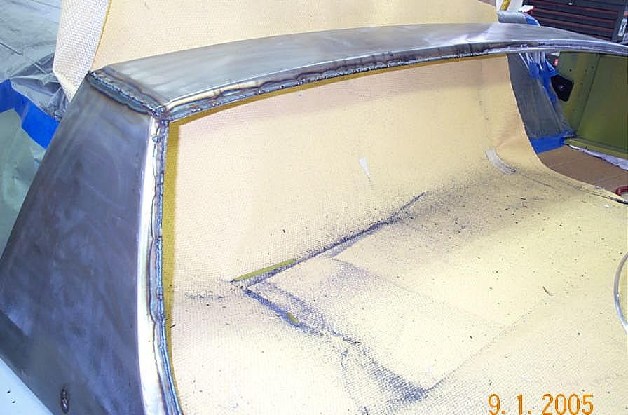

You want the surfaces *clean*....no paint or other guck
in the weld area....real clean. On that overhead, grind the pinch seam down so both sections of metal are the same height & CLEAN. You gotta get your face up close to that joint to keep right on that parting line & I ran it down hand.
I never found shrinkage to be an issue....just laid it on.
This was a similar seam, but 3 sections of metal & almost flat.
J P Stein
post Mar 24 2006, 08:22 PM

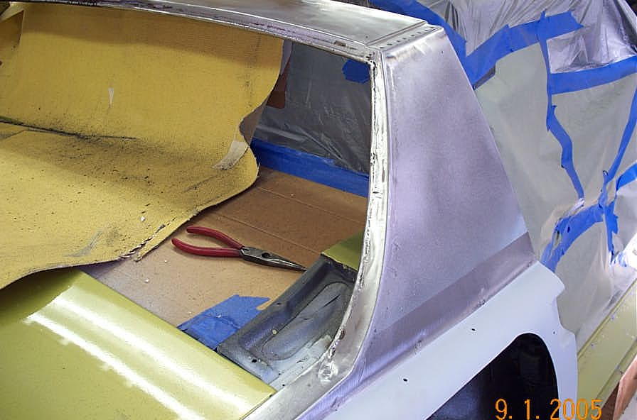

Did you have trouble keeping the wire on the seam as well?
You seam welded, ground it down, and welded it again? Explain to me what you did with that sail pannel.. Thats my next weld project..

As I said, there are 3 layers of sheet metal there.
I had to do about 3-5 inches at a time as the spotwelds holding it together are.....disappeared.
After the "fin" is ground down just a bit proud of the flat surface, you're faced with metal, gap, metal, gap, metal.
Naturally when you have a deal like that , blow thrus are a problem.....but just keep doing a wash pass and seal em' up.
On that lower pinch seam, I ground as described, welded, (Yes, a hell of a time keeping on the parting line.....get close. & brace on your other hand....even when it's on fire) then came back and smoothed things out with various grinding instruments. An angle grinder for the big globs, then a sanding disc and/or rice cake on a die grinder to make things pretty (kinda). You don't wanna leave sharp edges or joggles....stress points crack....or start em'. Smooth is gud.
IMO, that arch is a high stress area on the car.
