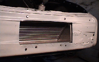

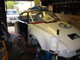

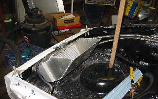

gratuitous pics of my 911 fluidyne cooler set up (IMG:style_emoticons/default/beer.gif)
