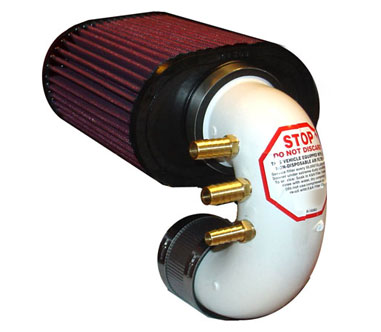

Looking for feedback on the below product. Would simplify the engine compartment quite a bit, make adjusting the idle easier...
Does it replace the plenum?

Seem like it would attach to the throttle body, like most hi flow intakes. Not sure how it would fit to the verticle TBs?

Replaces the air box.
As long as your not buying it expecting 5hp...
It will make a cool engine noise..
Just dont expect a lot of power increase from it... Maybe a little..

I built one of these for my 914 and it works great. I went to my local Menards store and purchased 2 - 2" PVC street ells, 3 - 1/2" hose barbs, 1 - 2" sewer pipe clamp, and ordered a K&N RU-1520 filter. The small end of the street ell just fits the throttle body and the larger end fits the 2 3/4" opening of the filter. You could make it with one street ell if you use a smaller filter or you have a different throttle body location.
You do get more noise from the free flow air filter, but I don't mind that and really like the result. They are also selling these on ebay if you want to avoid the hastle of putzing around with it yourself.

Obviously only fits the 1.7s only; the 2.0s with their vertical throttle bodies would need something else. The 1.8s would need to have the air flow meter between the filter and the pipe.
Looks like a very PVC pipe elbow. With a few holes and some brass plumbing fittings. I'm guessing you could be like Trekkor and visit Home Depot and make up something just as good for cheaper...
Doesn't look like there's any way to keep rain out of the filter. Not much of an issue if you have your rain tray, but if you don't, it could be a real problem!

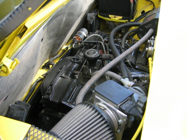

For what it is worth, I bought the K & N unit from 9Xauto.com. It fits on my 1.8 perfectly and the rain tray still fits as well.(this pic is before I got the tray back on)
