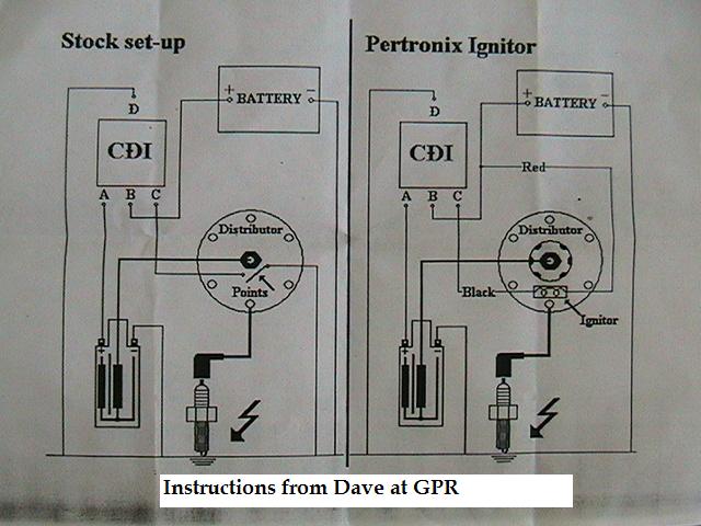

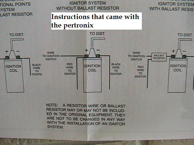

Okay, I pulled the Crane unit out and picked up a Pertronix unit yesterday from GPR.
I was given 2 sets of instructions. 1 set came with the unit and Dave gave me a supplemental set.
The instructions that came with the unit just shows the leads going to the coil. Easy 2 wire install.
The set that Dave gave me shows the wires going to the CD box.
Allan

What do you need the CDI box for when running a Pertronix? The CDI is for points-equipped distributors; can't see needing it with the Pertronix module.

The six can run without the CDI box. you just need the power to the coil and the pertronix to the coil. Same way you would hook up a 4 cyl. with carbs. when you get that running then add the MSD. then the Pertronix goes to MSD and MSD goes to coil.

Here's your answers. The CDI box requires a special coil. The one you show is NOT that coil. Given enough time, a conventional coil will eat the CDI. Been there, seen that. Maybe not today, or next week, but it WILL do it. The MSD requires a different coil. The CDI box improves the spark characteristics. 911s NEED enhanced spark, trust me. You have a kluged up mess there; obviously the previous owner or "mechanic" hadn't a CLUE what he was doing or how things are done in the modern world. (Hint: The Scotchlocks give it away!) I would cut to the chase and do the whole thing from scratch, and do it right. If you want to use the Bosch CDI, you'll need to buy the correct coil, then look at the wiring diagram posted yesterday. We can help you, but you have to want to be helped. If we give you the correct answers, and you keep asking 'til you get the answer you WANT, you're not gonna get it fixed, and we're gonna stop trying to help you. BTW, points often last 20-30K miles with the Bosch BHKZ (CDI) system. Long enough that subbing in a trouble prone Pertronix makes little sense. The Cap'n

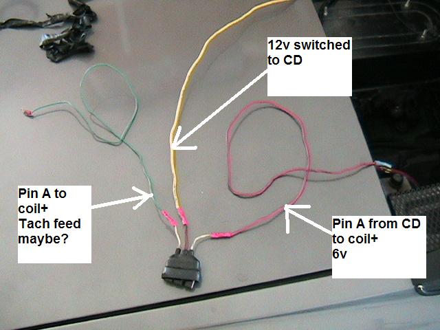

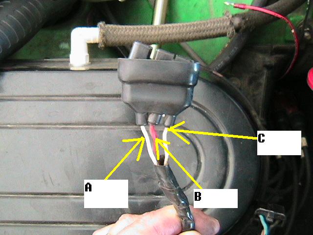

Pulled the CD box. Here is the connector. B is 12v switched. Can I use it for my switched power and just cap off the 6v switched that was hooked to the coil?

And, my CD box doesn't have a D connection unless that's just the body of the unit to ground.

That is the shielded wire braid that goes around the CD box wiring. One end attaches to a ground stud on the engine by the distributor, and the other end attaches to the spade connector tab above the 3pin connector on the CD box.
Without it you can get some weird crossfiring issues due to inductance from the plug wires.
And you definitely need 12V at the CD box.
BTW.. the Cap'n is right. You need the CD box or some kind of aftermarket spark amplifier to keep the 911 engine from fouling out plugs. They can be run for short periods without the CD box, but it willl misfire at high RPMs and foul the plugs something fierce.

Pertronix is already in the dizzy. I went out and started un-wrapping wires and have found this so far.
Please note that the red wire is actually pin B...
