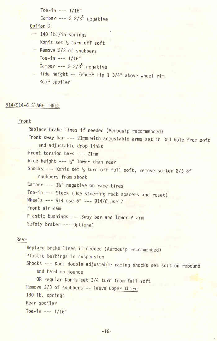

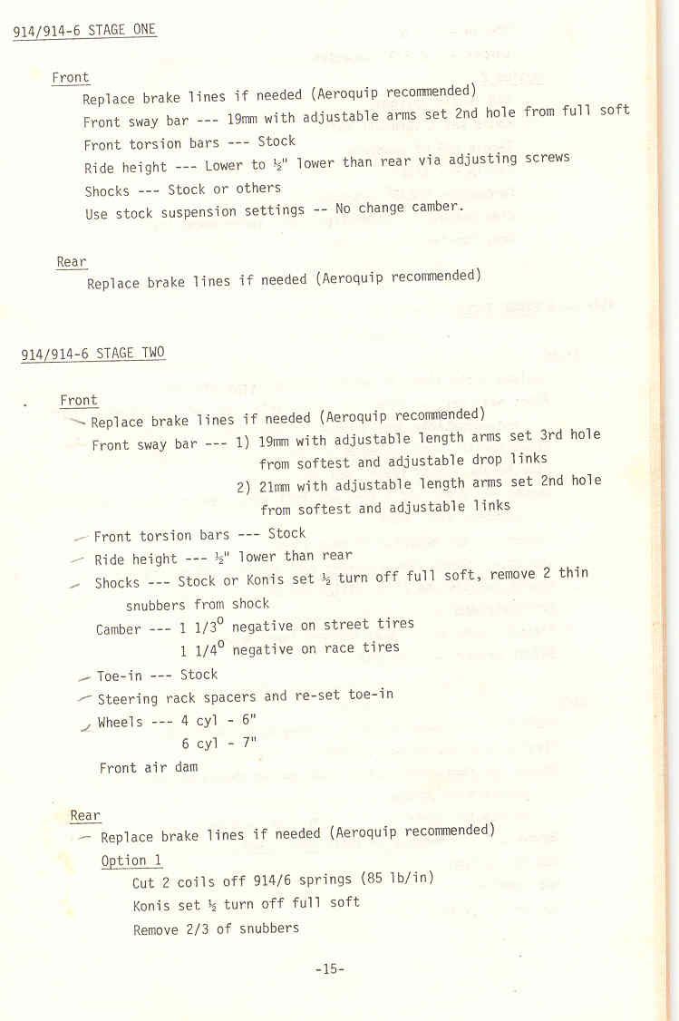

Automotion put out a little book in the '80's about setting up a 914. I've got it somewhere.
I know, I know the info is 20 years old, but we could see the format of thier tables. I'll look for it and scan it. Paul |

Let me try this...
| URY914 |
Nov 7 2003, 07:32 PM
#28
I built the lightest 914 in the history of mankind. ![]() ![]() ![]() ![]() ![]() ![]() ![]() ![]() ![]() ![]() ![]() ![]() ![]() ![]() ![]() ![]() ![]() ![]() ![]() ![]() ![]() ![]() ![]() ![]() ![]() ![]() ![]() ![]() ![]() ![]() ![]() ![]() ![]() ![]() ![]() ![]() ![]() ![]() ![]() ![]() ![]() ![]() ![]() ![]() ![]() ![]() ![]() ![]() ![]() ![]() ![]() ![]() ![]() ![]() ![]() ![]() ![]() ![]() ![]() ![]() ![]() ![]() ![]() ![]() ![]() ![]() ![]() ![]() ![]() ![]() ![]() ![]() ![]() ![]() ![]() ![]() ![]() ![]() ![]() ![]() ![]() ![]() ![]() ![]() ![]() ![]() ![]() ![]() ![]() ![]() ![]() ![]() ![]() ![]() ![]() ![]() ![]() ![]() ![]() ![]() Group: Members Posts: 132,067 Joined: 3-February 03 From: Jacksonville, FL Member No.: 222 Region Association: None |
page 2

Page three
If Tom Green comes looking for me for this, tell him you don't know me.
Paul |
