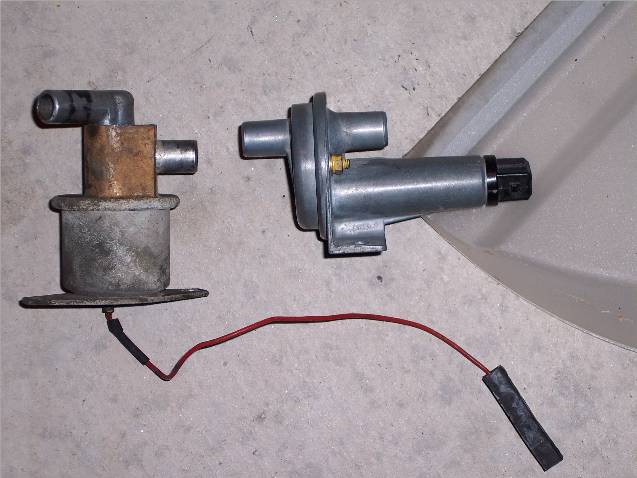

The one on the left is the original NLA part from my 1.7. Can I use the AAR on the right in place of the one on the left? Where can I get a fuse like the one attached to my original AAR?

You can install a later style AAR valve in but ususally the early style are just rusty inside and sticking. Squirt PB Blaster into it and let is soak in before applying 12v to it to see if it frees up and heats up. Thats just a connector not a fuse.

What is the purpose of that black connector? As you can see, the wire on one end has broken off. Can I cut out the black connector and just bypass it?

The setup I have seen on 914 is that the red wire ends in a female spade connector that plugs into a double male plastic connector so it doesn't ground out on the engine.

You can use the newer design AAR (it's the one from the 1.8L) with no problems. All you have to do is to get an plug that matches the connector on the AAR. It is just a standard Bosch injector plug that you can buy at FLAPS. Then you hook one wire on the plug to the white AAR wire on your harness, and the other to ground.
After that, it will work fine.
Oh, and if you need an AAR, have them look for one off a mid 80s 280z or Sentra. they are electrically and physically identical, and much cheaper and easier to find than the Porsche part.
