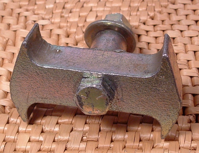

Get the flywheel lock tool.
http://cgi.ebay.com/ebaymotors/VW-VOLKSWAG...1QQcmdZViewItem

Step on the brakes....
The flywheel lock is the ticket.

Any way to do this w/o removing the trany?
