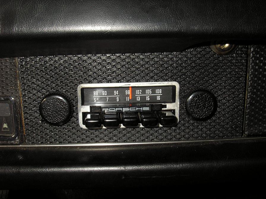

I took a newer radio out of my car and installed this older one. No, it does not sound as good but does work well. I just love the old light that that matches the light coming from the instrument gauges. I think a modern LED screen would wreck the charm of driving the car on backroads at night.

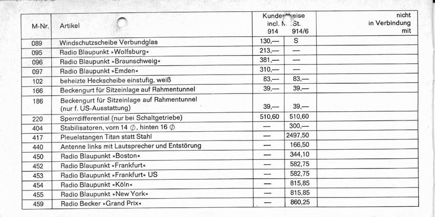

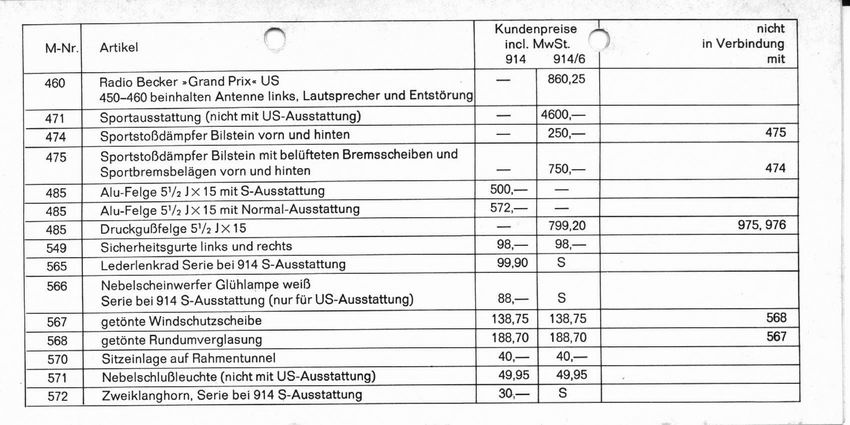

IIRC I already posted this one in another thread
some guys alway claim that there were no factory installed radios - at least for the USA
well then, Steve just told us, that not only his window sticker showed the radio (this could mean it's dealer installed), but also the COA says so - this definitely makes clear that it has to be factory installed, correct?
and here are two pages out of the optional equipment price list from MY'71 (print# W41-010-0371-0108)
they list all the factory options, including the possible radios - seperated for the 914-4 and the 914-6
and as you can see, there are also some radios marked as US
