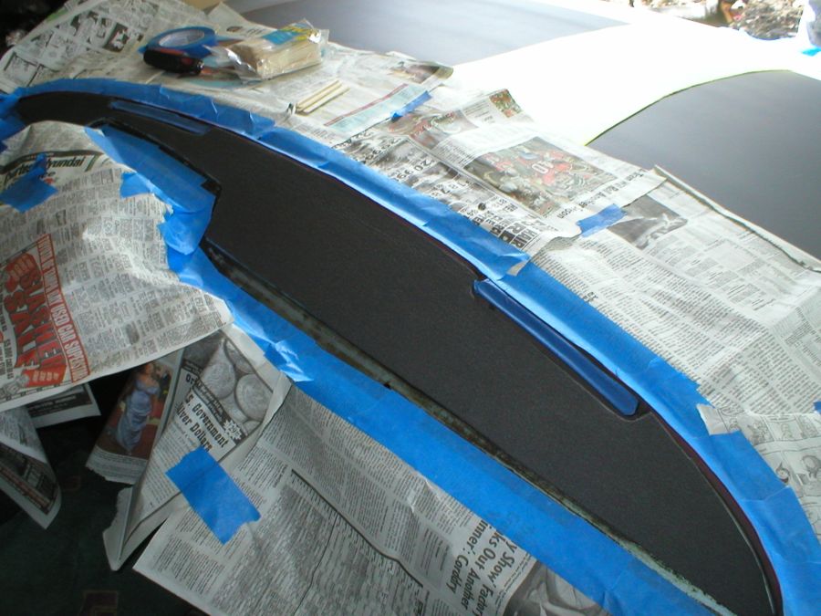

I received the closed-cell foam and installed the foam and vinyl today....
I first made a template..
Next, I taped everything off to keep the glue from spreading...
Then I cut the foam to the exact size of the template and glued it in place...
