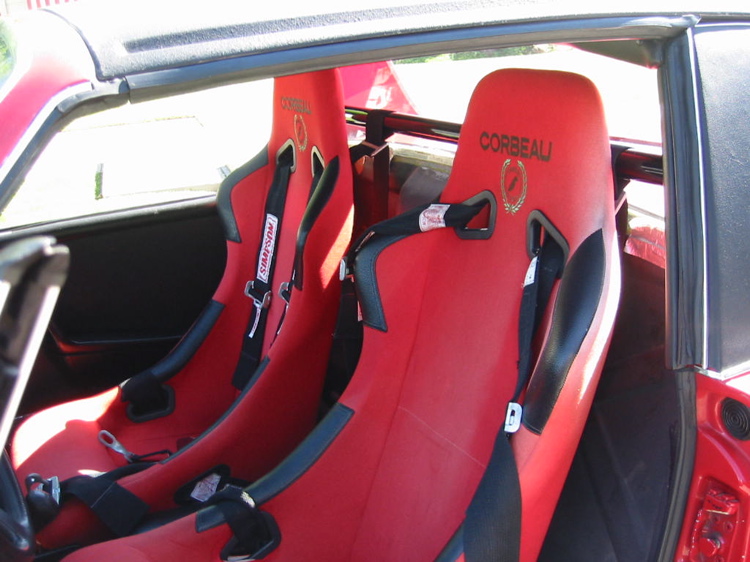

I know it's not exactly what you are looking for, but after the autox at the SR Airport last year, I put in a set of Willans Super Sport harnesses. It's a 4 point with an OEM style latch which makes it easy to use on the street. I got it here http://www.bethania-garage.com/willans_super.htm for $105. I really like them.

John - that looks cool and practical but if I am going to drive any of the PCA track events they want 5-pt harnesses with the sub strap...might as well just buy it once and buy it to last. Can't wait to see those new wheels on your car (IMG:style_emoticons/default/biggrin.gif)

Remember the PCA rule is if the drivers seat has a race seat with a 5pt. harness the passenger has to have one if the car is stock and has regular seats you can use stock seat belts but they have to match it was for instructor saftey
