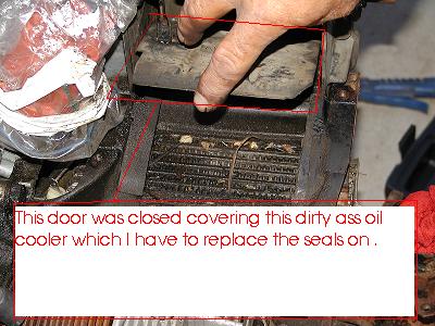

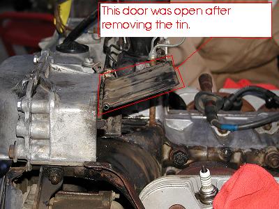

I need some help here . I dropped my engine to fix some major oil leaks . I'm wondering if I can take this nonworking assy. out while I have the tin off I don't have a T-stat. so i'm thinking it won't hurt to remove them. Am I correct in my thoughts? Here are some pics. of what i'm talking about.

the one over the oil cooler can be rivited down to permanently blow air into the oil cooler. the one on the other side can be eliminated.
at least for my track car... (IMG:style_emoticons/default/biggrin.gif) that is exactly what I have done.
And mine was still working properly. (IMG:style_emoticons/default/happy11.gif)

maybe the top one,maybe, if you have no plan to use the belows. Definitly not the bottom one, it directs the air over teh oil cooler

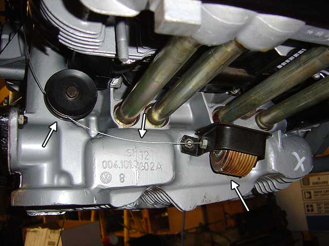

there is a pulley system on the bottom left side of the motor that connects to a bellows that heats up, expands and then closes/opens the doors in the manner you found them.
It is an aircooled version of a thermostat on a water cooled motor..

Sorry man, you got to keep em. Get the T-stat working, even in Cali. When you remove flaps in the cooling system, (they actually route air to the rite places,) the motor will run hotter in all the wrong places.
The cooling system is very well thought of, but it needs to be working on a T4.

If this a street 914 you will be real sorry if you don't keep the flaps...by default if the thermostat cable breaks, the flaps are positioned for full cooling. You can buy a new thermostat and cable from evparts for less than $100. You want your engine to warm up...if not, the wear on the engine running cold longer comes at a high price. The type three coil opens 10 degrees sooner than the OEM type 4...but not that big of a deal.

The T3 does fit...EVparts sells a cable kit with the correct T4 coupler for $20...it's all plug-n-play. I didn't realize T4 thermostat's were available...I couldn't find one when I was looking for one a few months ago. I wanted a new one...

maybe he just mis-identified the type as i think it's actually a type I thermostat adapted to work on a type IV
Yes, your right...it is a Type 1, not a Type 3 thermostat that converts nicely for a Type 4 motor...sorry for the confusion.
Here is a great article on the Type 4 thermostat with pics...worth the read.

QUOTE(JBart @ May 4 2007, 11:17 PM) *
NO
you need the flaps. especially the one over the oil cooler. look at how the air system works.
if you remove that flap you will have *NO* air going through the oil cooler at all!
you're going to cook your engine in no time ...
the flap over the oil cooler actually forces air into the cooler when it's DOWN and covering the top of the cooler!
