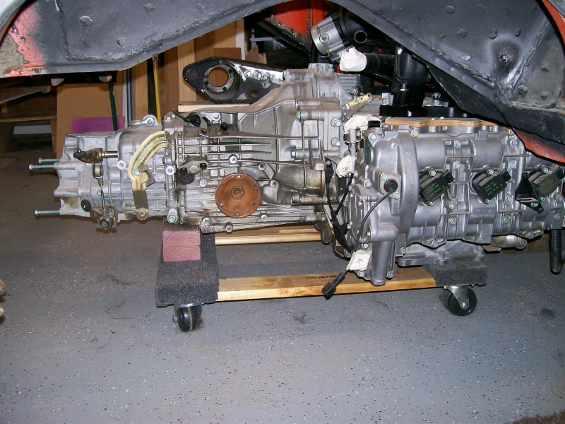

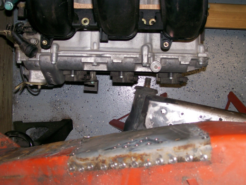

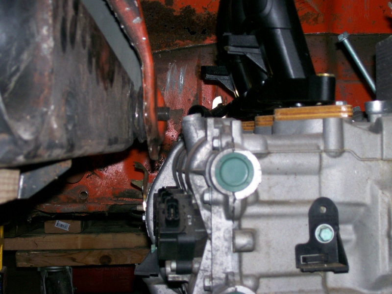

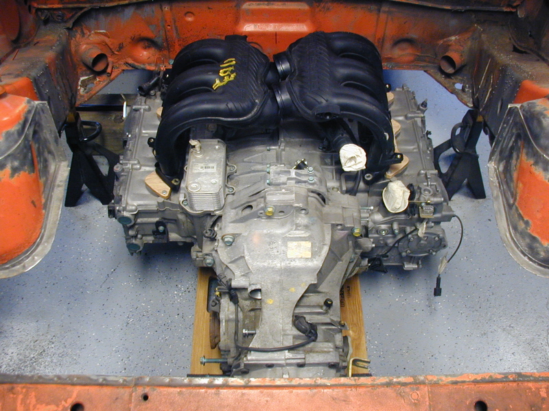

Well I was gonna post these in a blog when I got some time, but since it has been brought up again here are some photos of the clearance issues. Let me know if you want more photos. oh yeah, 2000, 3.2 S motor, 44k miles with 6 speed out of same car ( donor flattened by tree, ouch).

another (IMG:style_emoticons/default/wub.gif) Attached Image

and another

and the last for now. I will gladly take measurement off the motor and tranny if any one needs them for fitment issues, or photo the tranny mounting bolts for those wondering if the tranny will fit other motors. (IMG:style_emoticons/default/smile.gif)

(IMG:style_emoticons/default/ohmy.gif) Thanks for the pictures! Great documentation.

the pics are great! What's your rear suspension solution gonna be?

Glad you liked the pics. I am leaning towards a semi trailing arm suspension like "groots" groot designbut have considered a dual a-arm setup, possibly 986.
After I get the motor and tranny mounted I will see how much room I have forward for the semi trailing arm mounts and decide.
Just got the welder (millermatic 180) a couple of weeks ago and still laying down practice beads refining the skills (IMG:style_emoticons/default/welder.gif)
