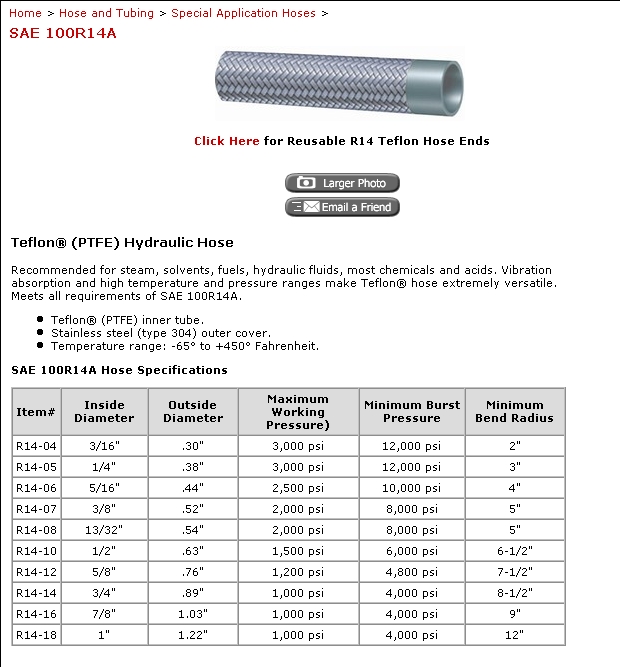

QUOTE(SirAndy @ Apr 27 2007, 12:11 PM) *
my guess is no more or less than the factory rubber oil-lines.
interestingly enough, none of the typical raceshop outlets mention anything about "fire resistant" with their braided stainless oil-lines either.
both use a similar elastomer as the main component, so i'm not sure a thin layer of stainless mesh on the outside would help much in case of direct contact with flames.
both, the braided lines and the plain lines have the same max. operating temperatur (~300F), i'm guessing both will simply melt the elastomer when exposed to much higher temperatures (flames) ...
also keep in mind that both types have another inner layer of braided mesh sandwiched between the inner rubber and the outer rubber ...
(IMG:style_emoticons/default/cool_shades.gif) Andy
Maybe it's just me, but I like to use hydraulic hose. In -12 size it is $4.55/foot.
post Apr 27 2007, 04:02 PM
Post #203
Resident German
Posts: 42,560
Joined: 21-January 03
From: Oakland, Kalifornia
Member No.: 179
QUOTE(John @ Apr 27 2007, 01:54 PM) *
i dunno, i would assume that by the time you see 12000 psi in your cooler circuit, your engine has probably already turned to dust ...
seems like overkill to me.

QUOTE(SirAndy @ Apr 27 2007, 02:02 PM) *
Yup.
So does a 3.6 in a 914... (IMG:style_emoticons/default/poke.gif)
I like to call it "peace of mind".
Your car is looking good. Do you have an ETA?

Although the burst value of the hose is very high, what kind of pressure causes the hose to blow off the barbed fitting?

QUOTE(thesey914 @ Apr 27 2007, 02:23 PM) *
the blue hose is rated for up to 250 psi ... meaning, it's still safe to operate at 250 psi.
should be plenty ... if not, you'll read about it here first ...
(IMG:style_emoticons/default/stirthepot.gif) Andy

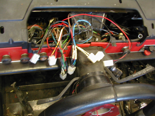

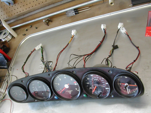

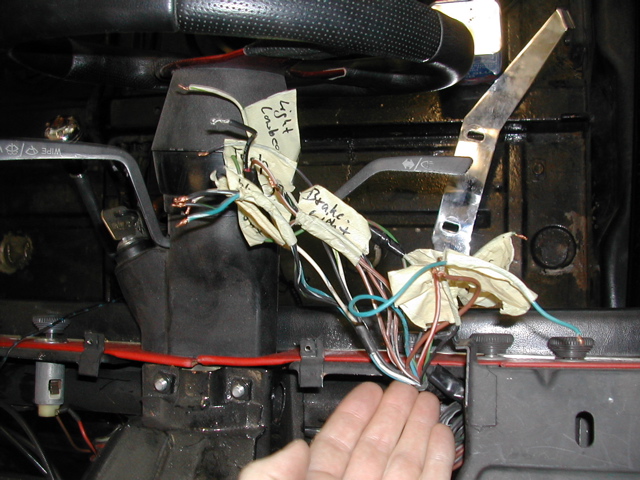

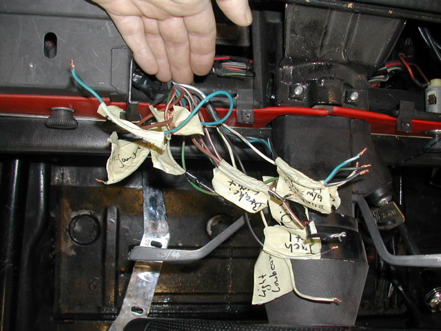

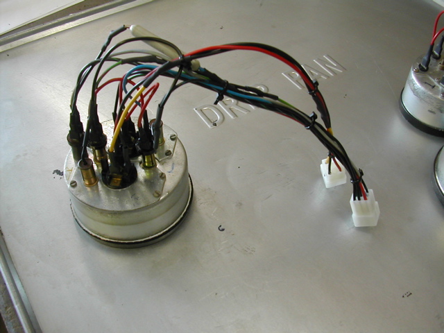

while i was in there ... (IMG:style_emoticons/default/unsure.gif)
the wiring for the gauges was always a bit messy (the 911 dash requires rerouting some of the original wiring) so i decided now was the time to do it right.
i got a bunch of electrical connectors and added a connector (9 pin) to each gauge.
then i extended the existing wires and added connectors as well.
now i have a quick disconnect for each gauge and plenty of wire length to take them out of the dash.
i used color coded wires where possible (out of a old harness) and put labels on all the important wires and numbered the connectors.
before:
gauges wired up:
cluster with extended wires and connectors:
now i can reinstall the dash and put in the new windshield ...
(IMG:style_emoticons/default/piratenanner.gif) Andy

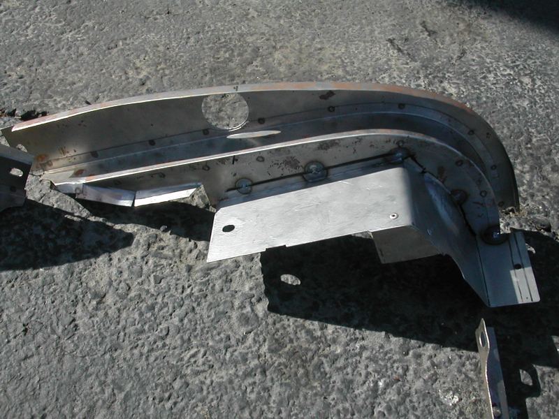

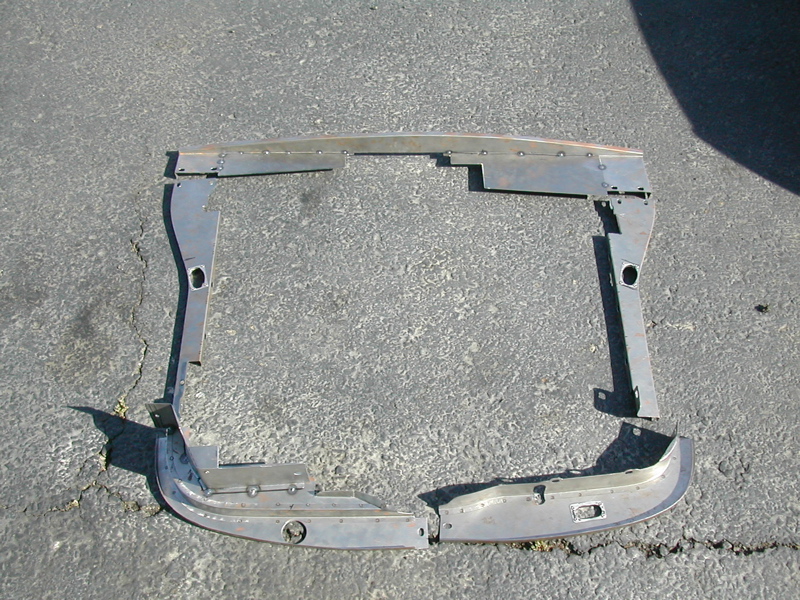

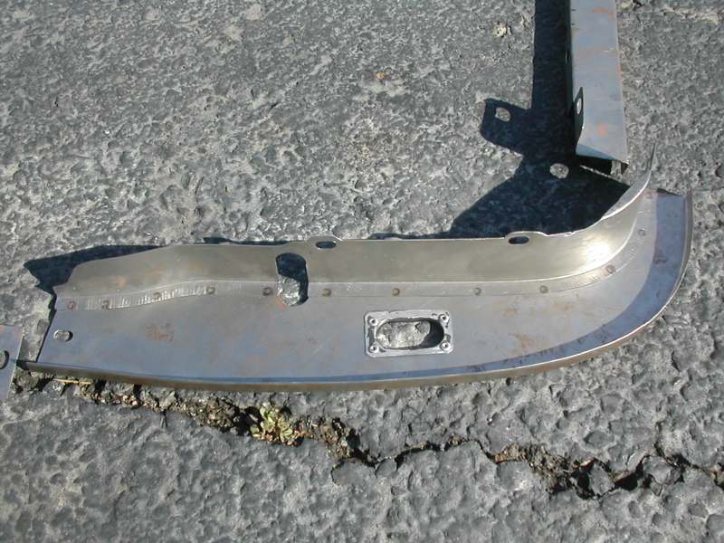

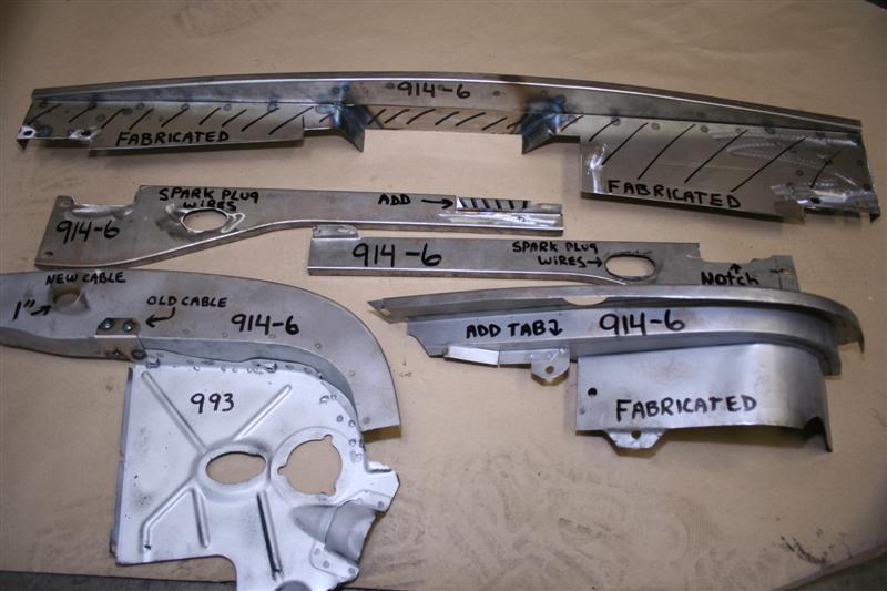

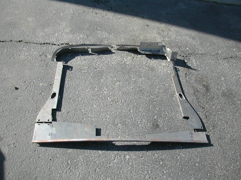

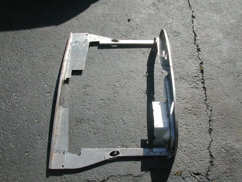

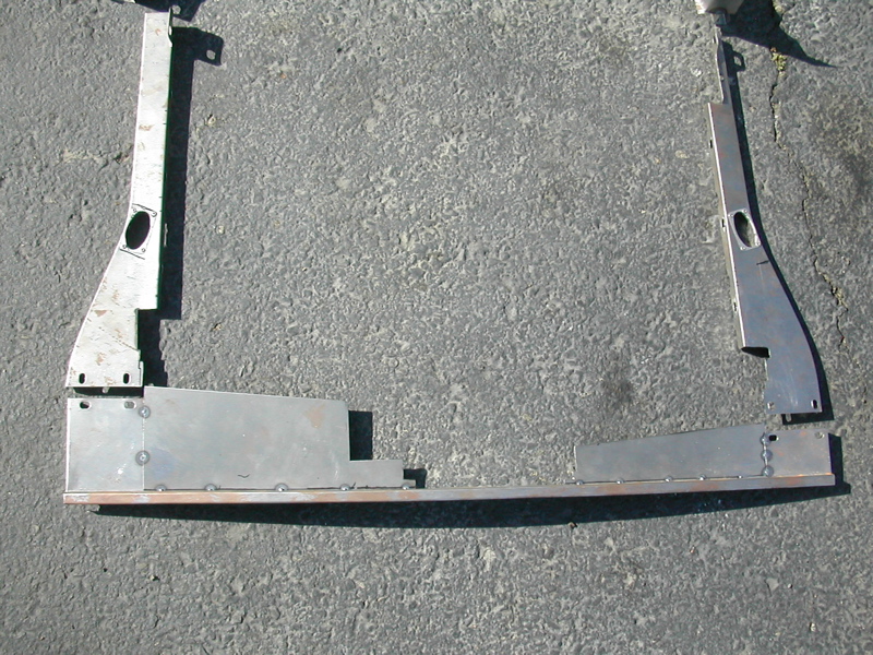

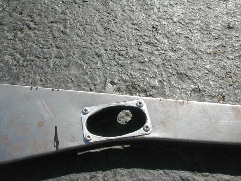

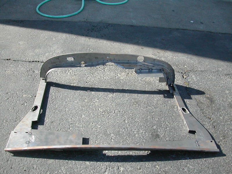

Engine tin finished and ready for powdercoating ... (IMG:style_emoticons/default/piratenanner.gif)
I started with a set of patrick motorsports reproduction 914-6 engine tin.
I knew it would have to be modified to fit the 3.6L, but i have to say, for the price i paid, i was very disappointed with the overall quality of the tin.
- First, it arrived all bend and banged up. (IMG:style_emoticons/default/WTF.gif)
- Second, the edges were just left unfinished after cutting the metal, so all pieces had razor sharp edges. (IMG:style_emoticons/default/icon8.gif)
I had to file down all the tin pieces before we even got to work on making it fit ...
- Third, the fitting is poor. On one side, there's a 1/4" gap where the two pieces are supposed to butt against each other! (IMG:style_emoticons/default/mad.gif)
Patrick says that the tin will fit the 3.6L with some minor modifications. I'm not sure what they're smoking, but it must be pretty strong stuff.
We had to do some very creative sheetmetal bending, warping, hammering, welding, drilling and riveting ...
(IMG:style_emoticons/default/smash.gif)
(IMG:style_emoticons/default/poke.gif) Andy (from McMark's shop)
And here's the end result:
post May 24 2007, 09:59 PM
Post #213
Resident German
Posts: 42,560
Member No.: 179
(IMG:style_emoticons/default/thumb3d.gif)
PRS914-6
post May 24 2007, 10:02 PM
Post #214
Excellence Magazine Project 914 3.6
Group: Retired Members
Posts: 1,278
Joined: 20-May 06
From: Central California
Member No.: 6,031
Andy, it looks good. It's a lot of work to do it right. It took me a weekend to get mine done. You can use the 993 OEM sheetmetal in the back if you have it. A little trimming and a few tack welds. It allows the air flow to go the proper direction and not bleed out the back. Look at the bottom piece of this picture.....
post May 24 2007, 10:17 PM
Post #215
Resident German
Posts: 42,560
Member No.: 179
QUOTE(PRS914-6 @ May 24 2007, 08:02 PM) *
hey paul, yes, i used the two original side pieces in the back. i just didn't put them in the picture as they're not part of the 914-6 sheetmetal.
i cut both of those pieces to be individual and didn't tack them onto the 914-6 sheetmetal.
that part went smooth. which i can't say about the rest of the tin.
3 days worth of custom fab work in that tin!
(IMG:style_emoticons/default/blink.gif) Andy
PS: i used the stock 993 grommet holes for the plug wires and the sensor wires and just rivited them into the sheetmetal.
i'm also using the patrick throttle cable, which allowed me to use the existing throttle cable hole in the tin. no need to add another 1" hole ...
PPS: how was the initial fitting on your tin? (IMG:style_emoticons/default/idea.gif)

Andy, I'm assuming you are asking how it fit when the engine went in the car? The answer to that is "no problems" The rubber around the perimeter of the engine bay connected perfectly and the gap beteeen the tin and rear suspension arm areas were equal so I was pretty happy when it was all test fit.
BTW, I used a Rich Johnson mount and it allows some adjustment but it didn't really need any.
Now if you are asking how it fit on the engine when I first bought it, that is a different story. Like you it was 2 days of work.....The side pieces were the only ones that were close.

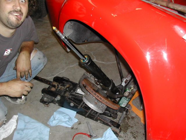

got some more stuff done today ... (IMG:style_emoticons/default/smilie_pokal.gif)
McMark installed the new koni (yellow) adjustable shocks while i was grinding away in the engine comp. (IMG:style_emoticons/default/smash.gif)
we also installed the transmission portion of the JWest Sideshift-Kit,

It appears Andy had a 100% failure rate on his used old shocks. The fronts LITERALLY fell apart during removal (kinda like the rears). Those puppies were not doing ANYTHING near what they should have been. Andy is gonna be ripping up the AX course at the WCR. (IMG:style_emoticons/default/driving.gif)
We are very close! (IMG:style_emoticons/default/boldblue.gif)

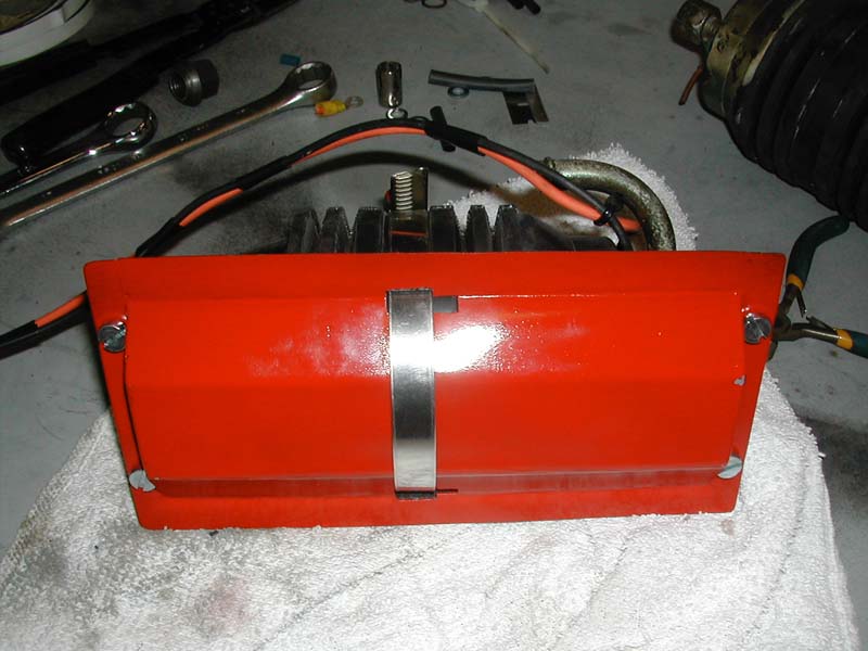

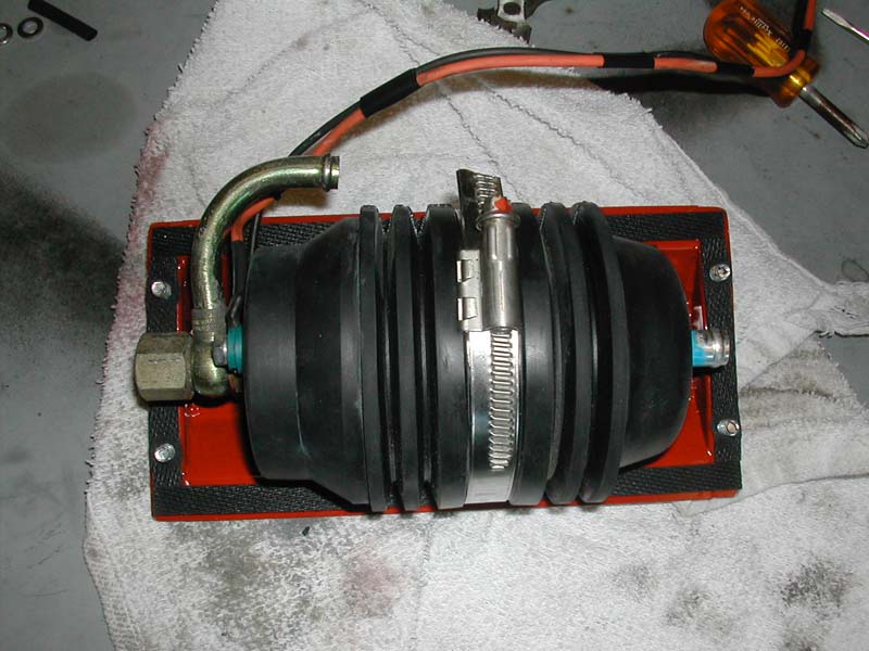

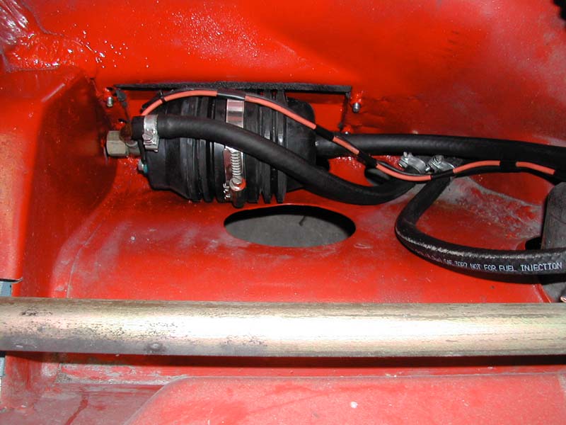

today was fuelpump day ... (IMG:style_emoticons/default/drunk.gif)

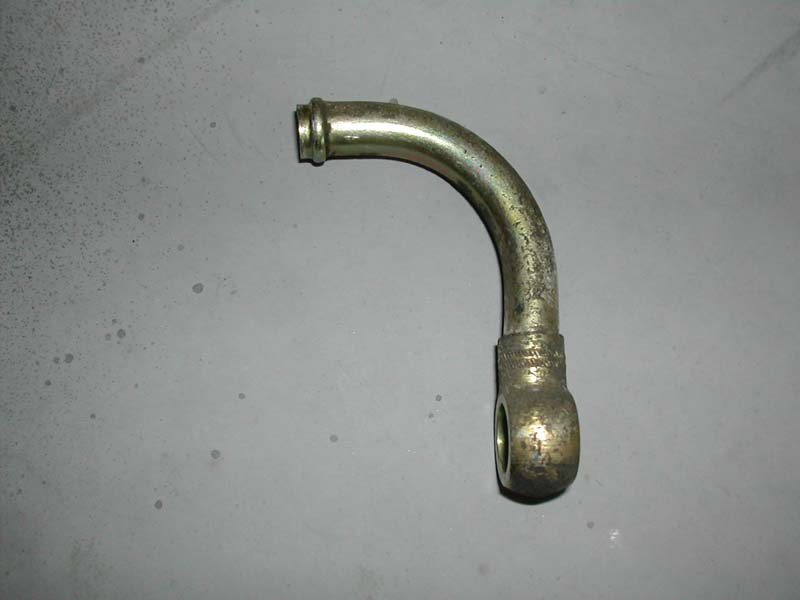

the 993 fuelpump does not suck, so it needs to be mounted close to the tank and *underneath*.
first pic is the stock 993 fuel line. all i need is the fitting to the pump, so i cut off the rest and made a nice flared end.
original line:
cut off part i'm going to use:
then i mounted the pump to the fuel-door and added the hard lines and the wiring:
backside:
and finally, mounted in the car:
and from the inside of the car:
