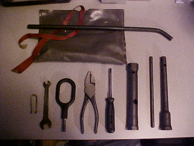

There's a thread on this in "Originality & History". Here's what should be in your car.
(IMG:style_emoticons/default/cool_shades.gif)
73Phoenix20
post Jun 22 2007, 04:37 PM
Posts: 334
Joined: 15-June 05
From: Michiana
Member No.: 4,283
Yepo, that is Correct, Mr. Blackstain! You win the Prize at the bottom of the Cracker Jacks Pack!
In fact, the photo is of my 1973 914 2.0 "S" Tool Kit. Although, I have seen the "Pouches" made from other vinyl materials, including one type that looks like it was covered with small "bumps"...go figure...
Later 914's got the VW Tool Kit treatment, with the few essential wrapped up in a black plastic "Bag", and held together with a rubber band... black and about 7mm wide...
Johny Blackstain
post Jun 22 2007, 05:37 PM
Posts: 3,434
Joined: 5-December 06
From: The Shenandoah River
Member No.: 7,318
QUOTE(73Phoenix20 @ Jun 22 2007, 06:37 PM) *
Got the photo from this site:
http://www.p914.com/p914_tools_kits.htm

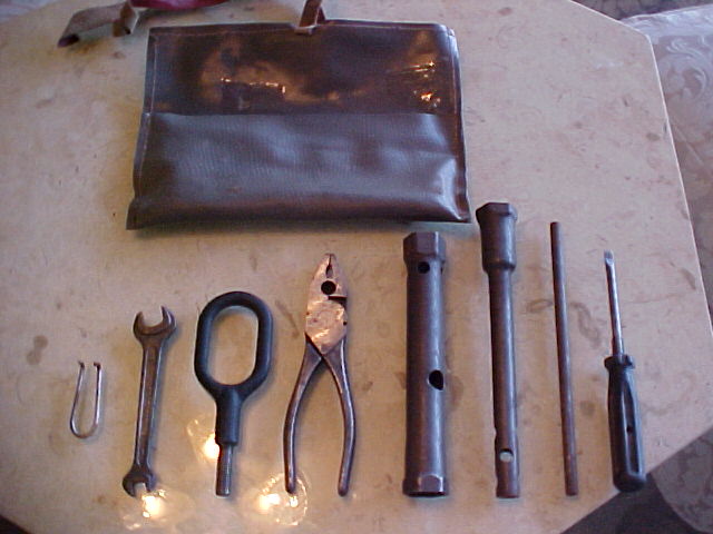

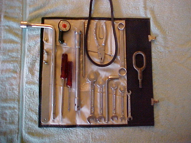

So you did...now I wonder where "They" got those photos...?
These are all taken in my living room... very interesting...
Attached ImageAttached ImageAttached Image
73Phoenix20
post Jun 22 2007, 06:58 PM
Posts: 334
Joined: 15-June 05
From: Michiana
Member No.: 4,283
[/quote]
And one more, showing the Bag with the Red Sash...
BUT, now I see that the Pliers are not exactly the same , nor is the Tow Hook!
Amazing how similar the photos can be....

It's my site.
Honestly, I created it because I got really tired of seeing people totally misrepresenting things on eBay and in other online sites as "factory Porsche 914" equipment or "rare original 914/6" when it was aftermarket or VW or standard 914/4 or otherwise incorrect. For things like tool kits, gauges, mirrors, etc., I couldn't find a good, free, online repository (especially one with pictures) to spell out what was correct for a given 914 or 914/6 model year, so I figured I'd start one.
For instance, In the three tool kits pictured by 73Phoenix20, the top one (bag w/ white ties) looks 100% correct for a '70-'73 914/4. By the presence of the 914 tow eye-hook, I expect the second picture is supposed to be a 914/6 tool kit, but 914/6 tool kits had no tire gauge, the bag is aftermarket (white interior and polished snap are wrong), the spark plug socket is for a 912, the open-end wrenches appear to be "SELECTED-SPECIAL-STEEL" (post 1974 911) instead of the correct "DROP FORGED STEEL" wrenches, the P208 pulley wrench is aftermarket (should not have a hole in the end), and the screwdrivers and pliers are also wrong. The third kit is a Beetle kit with a painted 914 tow eye-hook and a spark plug socket likely from a VW single or crew-cab. Most people wouldn't know or care (IMG:style_emoticons/default/yellowsleep[1].gif) about any of this... but, for those that do, I built P914. I'll be adding a "badges" section when I get a chance.
I hope that's what you meant by "...history behind it." (IMG:style_emoticons/default/smile.gif)
