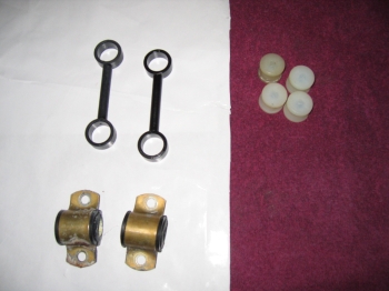

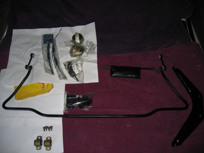

So I'm working on making the underside of the LE as pretty as the topside, pull the end links off the rear sway bar & the bushings just disintegrate into yellow crumbs. Yes, I'm changing all my suspension bushings! No big deal, been sitting on new bushings for 3 years & I need to use them now. So how the hell do they get pressed in? I'm having much difficulty in this step & I have a press! I also foresee much difficulty getting them onto the ball mounts on the end of the sway bar. Any thoughts, ideas, recommendations? Thanks

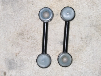

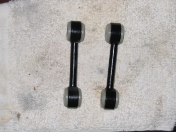

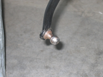

It's 10:49 AM & we're done. I'd like to thank the "World" for this momenteous occasion, that of proving the old cliche': "the right tool for the right job." I used a padded vise, teflon instead of silicone, a big screwdriver & I simmered the bushings in well water on the stove. Thank you Teeners! (IMG:style_emoticons/default/biggrin.gif)
(IMG:style_emoticons/default/cool_shades.gif)
(now comes the hard part- getting them over those damned ball ends! (IMG:style_emoticons/default/chair.gif) )

BF Channel-Locks work just fine for installing the sockets on the balls. The Cap'n

(IMG:style_emoticons/default/agree.gif) Bingo! The Cap'n called it & it's cake. Big old channel locks pop them suckers right on. Used teflon spray first inside the bushings & then painted w/ lithium grease. Overkill... so no probs (IMG:style_emoticons/default/biggrin.gif) .
