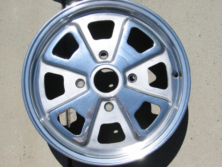

I used the search function, and couldnt find too much...so, what is the best way??? I dont want to remove the anodizing, so should I go with the "mothers" power ball, and metal polish, or the actual mothers wheel polish??? I want the non-anodized parts to be nice and chrome(y) (IMG:style_emoticons/default/biggrin.gif)

can't polish the wheels without removing the anodizing...
it coats and protects the alloy....
to polish you need to remove the anodizing to get to the metal to use abrasives and polishing compounds on the actual alloy...
If you are talking about just the rim and paddles, then you can use sand paper, depending on the depth of any scratches.
I used started with 800 grit sand paper, used some scuff pads, 1000 grit, 1200 grit, 1500 grit and then lots of metal polish with a buffer.

Dan, those wheels look nice. Do you have a closeup pic? Did you also do the background or just the spokes?

I only worked on the paddles and the rim...left the anodized part alone...came out pretty nice for a total time of about 4+ hours for all 4 wheels
