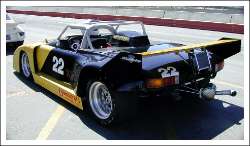

Member No.: 2,880
it all takes developement....Jake is willing to put in the time and money.
Randal's car should be very nice once he gets the motor into the chassis and works out the bugs....
If his car/motor combination is as good as it looks on paper then it might be very nice indeed.
And yes it will be interesting to see how it does with regard to longevity.
Our history around these parts with highly stressed T4s is less than stellar.
Bill Newlin used to build a new motor at least once a year...
Car was blazingly fast when it ran....
car ran a 1:40.8 at Laguna in '98.

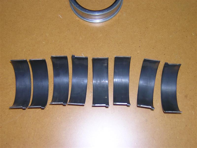

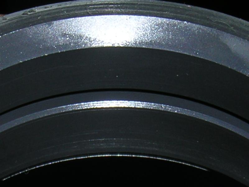

We are not shooting for just power, a HUGE reason I am doing the roller lifter and cam work is to reduce the engine's need for oils with large amounts of zinc..
The Porkies heads are being developed for large street engines and prostock VW drag race engines making around 300HP N/A from as little as 2.4L and 15:1 CR with .700 valve lift.
grant is right, AX is largely related to the entire vehicle's arrangement and set up...
Want some proof or longevity, below are some pics of rod bearings and main bearings that saw 6- 45 minute national races and one entire SCCA runoffs, that was 4 solid days of punishment. The engine revs consistently to 8,300 RPM (shift point) and has seen near 9K RPM with these bearings installed. These are Oem bearings that have been running against an Ion nitrided BONE STOCK (and lightened) crank and of course both these processes were "pipe dreams" about 5 years ago when we started developing them together....
