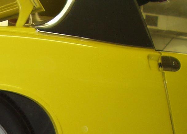

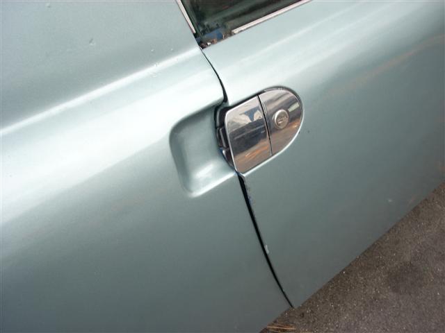

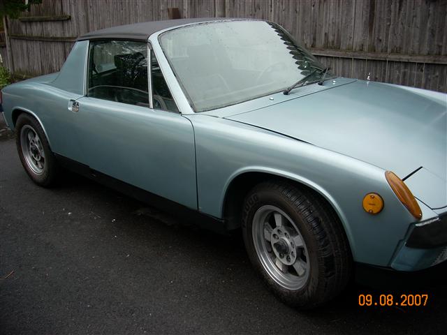

I cant seem to align my passenger door.What gives? Bassically the door overhangs the back of the door jam at the bottom(see pic).I do not think that there is any body flex that is causing this problem. There are 6 bolts that hold the door on. I have moved these all over the place and the door will not align. It closes but not quite correct. Any ideas on what I should do.
I did close the door,remove the top and roll the window up and down with no binding. That is why I believe there is no body flex. Also the longs look solid. Any advise would be greatly appreciated.

Pull the rocker cover and take a couple more photos. It's diffeclt to tell from that angle what's up with that one. The quarter panel looks like its pushed in on the bottom from that angle.. Also looks buckled between the door and wheel opening. (IMG:style_emoticons/default/confused24.gif)
Take a photo straight on of the fender to door, and the door to quarter.

Door alignment can be a PITA.
Did the door fit properly before?
How long has it been off?
Have you done significant welding to that area of the car (hell hole and rusty longs?)
It took a while to get my doors back on again so that they did not rub anywhere, and my gaps still are not exact. may not have been when I took them off, though. Its been so long...

Was the door always like this? Looks to me like the rear lower corner of the door stands outward away from the rocker/body line. You could see if a spare door fits better. That would tell you if the problem is in the door or the body.
BTW, that's what color my 914 is supposed to be and that picture looks really nice. I'm ready to paint it back.

I bought the car a month ago. Not sure what the previous owner did. I got it from a small local auto dealer. The longs are not rusted but I`m not quite sure what the hell hole is??? Not sure if I want to know,sounds kind of nasty. Anyways there is some indication that the door jams were patched. I hope that I do not have to start cutting to get things to line up. This is my first 914 and my first project car.

My 73 passenger door is similiar, doesn't stick out quite as far. As I started stripping paint on the quarter panel and I found about a 1/4" of bondo (IMG:style_emoticons/default/barf.gif)
The panel had been crunched and repaired poorly. Maybe take a magnet and test the panel for lots of body filler, and look from inside the wheel well for signs of a crash. Hope this helps, and the hell hole, yeah you don't wanna know (IMG:style_emoticons/default/mad.gif)

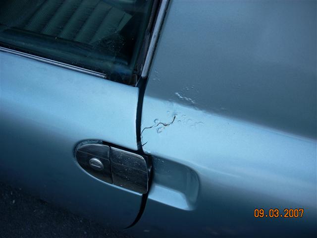

I know it's of no consolation but my passenger door is much worse. My car was probably hit in the door at one point. If this is what's driving you nuts on the car, consider yourself lucky.

Not driving me nuts but it is 1 of a gazillion little things that are adding up. The only problem is when I close the door it kind of puts pressure on the roof pillar and I can see it flex evrytime I close the door.

How did you determine that the longs are not rusted? Did you take the rocker panel off? If not, you may want to do that. Take the jack point cover off first and see what it looks like in there. To get the rocker panel off, you'll need to drill out some rivets.
The hell hole is the area under the battery tray. Rain would wash acid from the battery onto the frame rail and cause corrosion. Virtually all Teeners suffer from this to some extent. Get down in there with a flashlight and check it out.
I'm far from an expert, but I just got my first 914 ('71) a couple months ago, and am nearly done looking for rust. My floopan is shot (I could do a Fred Flintstone imitation), inner firewall is perforated and the hell hole is gone, but the longs and jack points are both fine. The trunks are both good. There are some bubbles at the base of the A-pillar that I expect will lead to small holes. Left rear fender has been replaced and the whole car was repainted original color. Overall, I'd say mine is not bad.
If you haven't done so yet, lift your carpet and look at the trunks and floor pan. Look at the floor pan from underneath. Rear windows leak and cause rust on the floorpan... check your window to make sure it's still well mounted. Taillights leak and cause rust in the rear trunk.

Take some diagonal measurements of an aligned door opening (or the other side) to compare. "If" the hinges aren't loose and the body is straight, you can pull up on the door end while it open to fine align it. This is one of the body shop techniques. shimming is another. Someone may have put weight on the door to get it to it's current state...

Overall there is hardly any rust.Most of it is some small surface rust on the bad paint job. I have attached a picture with what I think is the worst area on the car. The hell hole (now I know what it is) seems to be fine. It looks like it was treated with some of that rubber sealer. There is no rust in either trunk but there is some surface rust under the headlight motor. That looks like a tough spot to get to and clean up. I saw some pictures of the longs when I got the car. They look great. Under the car has only small surface rust. My plans are to sand and paint ( I think).

there is a major problem with the driver's side @ the sail panel. i think there is a ton of bondo at the crack. prob rusty under the paint. bummer. sorry. get a small 'stuck to fridge magnet' and start checking for areas where it won't 'stick'.

There is a lot of bondo in this area. However this door closes fine but the bondo deffinently needs some repair work. The bondo is isolated to an area of about 6" x 6". I did check most of the car with a magnet. I guess my entention is to have a working car (not a daily driver of corse) and also not a show car. The rest of the car is fairly solid. Not quite sure what my options are for the bondo other than to grind and re-fill.

Depends on what you want out of the car. You can love it as it is, knwing that it will eventually rust, but you get the fun of driving it now.
Or you can go digging in, and finding out how bad the rust really is now. This can lead to lots f money spent, and not driving the car for 2 years.
But, dollars to donuts, if you passenger door is not fitting, and the car is flexing when you shut the door, you have some significant rust in there somewhere.

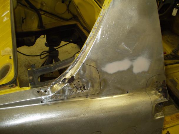

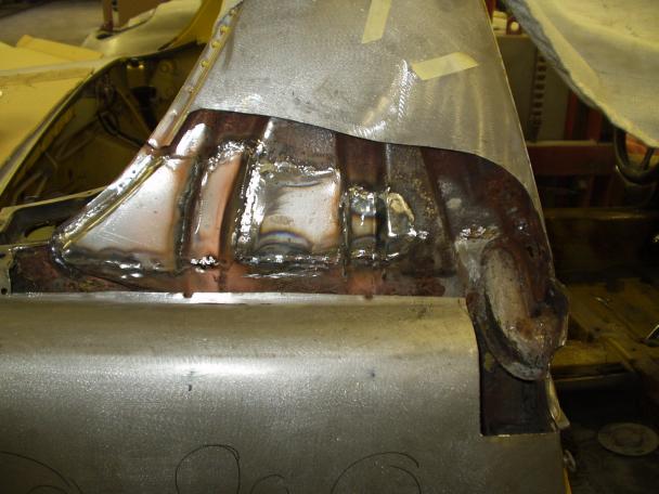

As an example, shown below are three photos of my car which is currently undergoing restoration. The first photo shows what appears to be a nice, solid 914 sail panel and rear quarter. The second pic, with the paint and roof vinyl removed, shows the extent of corrosion, just on the outside. Further investigation revealed additional corrosion inside the rollbar area (third pic). This fix hasn't been cheap, but I've owned the car, driven it and cared for it since '75 and was willing to commit to its restoration.

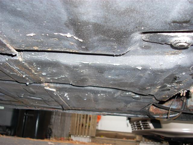

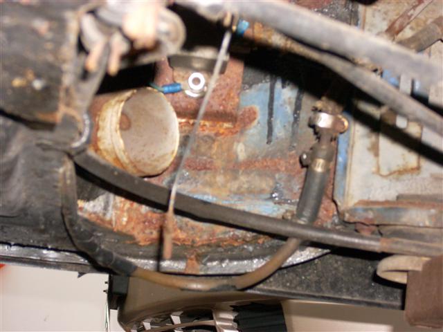

Here is a a little bit better picture of the door. Also a couple pictures under the car. I am not sure what the oppinion is of the rust under. Is it horrible or manageable? I dont think it looks all that bad. The area that I took the pic of is on the passenger side. Most of the car under is clean with some small surface rust.

The bottom pic is the underside of the car, right?
What is directly on top of that, under the battery, against the firewall. That is where bad rust will be hiding, if its there. It might have apint or somehting covering it, probe it with a screwdriver or a pic. Even tapping the screwdriver with a hammer should not harm the metal if it is solid. If it goes through, then you have to make other decisions.
Don't feel bad if it does - it does (or did) for most of our cars.
It could just be that your door is mis alligned, or needs a little shim.
If it was me, it wire wheel that rust and slap some rust converter on there to keep it from rusting further (the bottom pic) and then repaint with something tough - eastwoods chassy black or some other epoxy based paint. But, well, thats me and I have not been able to drive my car since the resto started Oct of 2005....
