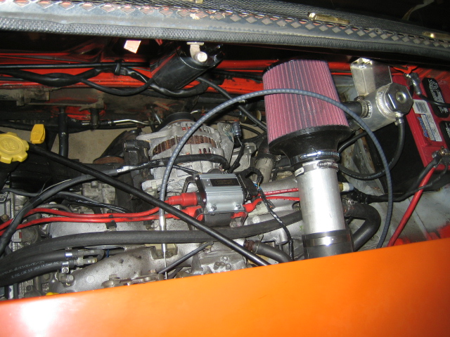

Hi. I recently converted my 914 to Ej25 power, and love it but i am having issues with air bubbles in the radiator and it wont cool very well.
Can someone please give me a diagram or maybe just tell me their hose routing and radiator cap pressure and tell me if the bubbles ever go away.
Symtoms while driving....I gun it and then close the throttle and coast and i get water coming out of the radiator reserve tank ( i have it routed in a tube so it doesnt splash around) and i see a stream on the road when i do this. Then when i get home i can bleed the top air bleeder screw on the top of the renegade radiator and a ton of air comes out, then i go to the back and i can fill the fill cap with another pint of water. This NEVER stops. Always needs water and their are no leaks apparent other than this squirting symtom.
My radiator cap is a 16 lb cap. The routing goes from thermostat through the engine block up , out the mainfold on top to the highly mounted aluminum housing that i bought from Renegade that i fill the water from( this has the radiator cap part), then down underneath the car to the radiator up front then back to directly into the thermostat/ water pump again. I drilled the thermostat also like instructed with 3 small 1/8 inch holes in diaphram.
I am lost why it still needs water all the time. I know why it does because of the spurting, but dont know why it does this....arrggH!!
Any help is appreciated. thankyou very much.

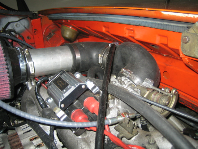

back of engine compartment

I have the aluminum bottle like yours mounted in the exact same location as yours in the pic, but my subaru shoots the water from the bottom directly at the cap, so this i think is the problem. At a good throttle pressure is hitting the cap making it unstick and shoot water to the expansion tank when the pressure isnt even built up, then i have less coolant and then the boiling point isnt as high due to the fact that now i have less coolant.
I am changing the system to go directly to and fron the radiator without any bleeder there....instead i am running a wrx expansion tank and running the heater core lines in the back of the subie motor which are smaller 1/2 inch lines in and out of the expansion tank, and that will be my new expanstion location. this way the actual flow of the water will not be pressing directly at the cap and the only thing that will be making it surge up and loose coolant through the expansion tank will be pure coolant pressure itself and not current of the water during hard acceleration......hopefully this is my problem ...seems logical, a new tank and we will see.....

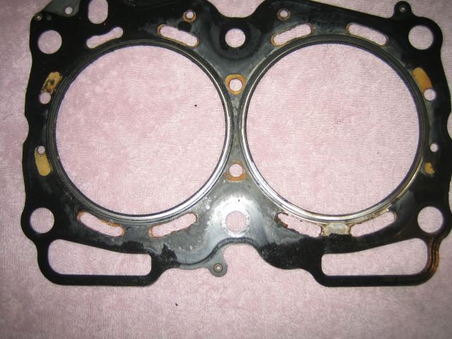

PROBLEM FOUND!!!! Bad head gasket. I was almost going to do it the subaru warranty way and put their "subaru conditioner" in, but I am not like that and I love knowing things are done correctly.
TORE IT DOWN! Found.........Head Gasket leaking into coolant, easy FIX!!
I am going to bring the heads in, resurface them, new gaskets everywhere. new h2o pump and upper coolant manifold gaskets..... Whew GLAD I FOUND SOMETHING!!!
Here are the pics. look at the shiny parts of the gasket near the piston, Shiney from piston to coolant passage. Definately leaking into coolant and causing expansion!

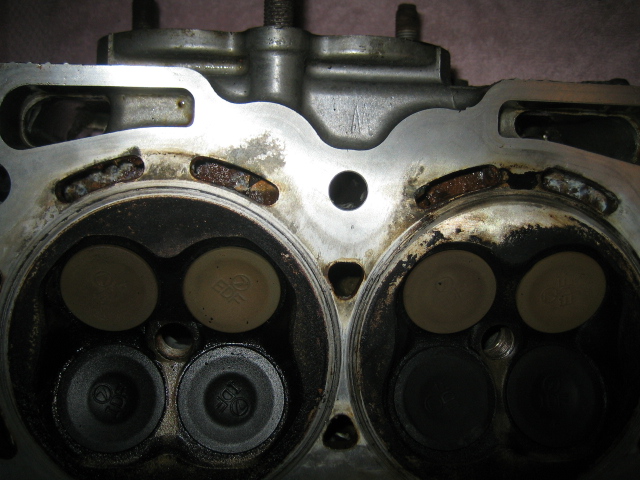

budman5201
post Nov 10 2007, 07:52 PM
Posts: 595
Joined: 1-April 07
From: tempe, az
Member No.: 7,635
another..black area between piston and coolant passage on head!
I sprayed down with water to wipe off the surface stuff so you can see the exhaust trail between the piston and the coolant passage.
