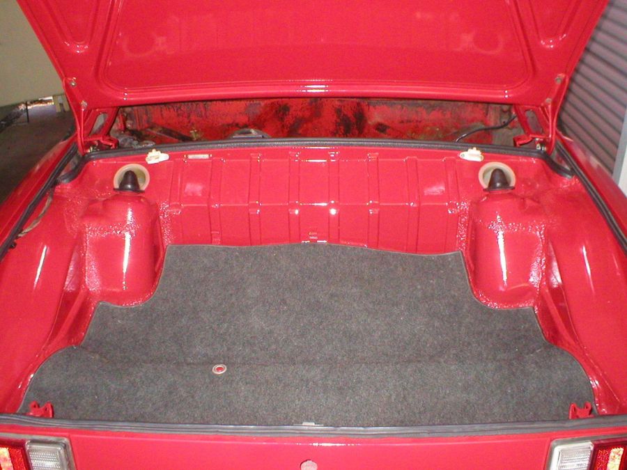

Well, after getting my first project completed.... (IMG:style_emoticons/default/av-943.gif) and surviving a very hot summer, I've gone back to working on this car...

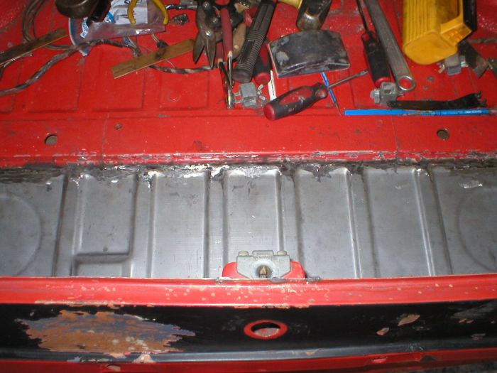

Here's the link to the post showing how I installed the rear trunk floor...
-- Rob

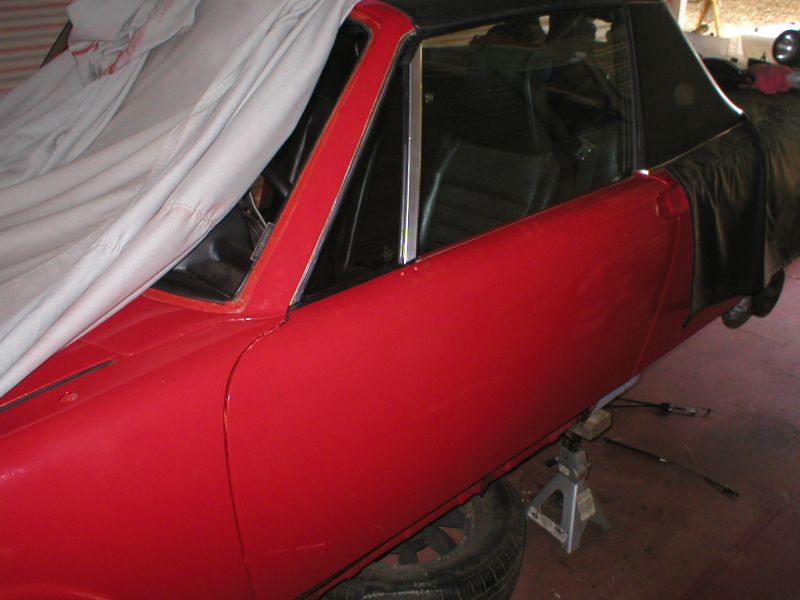

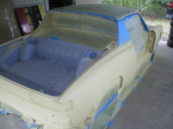

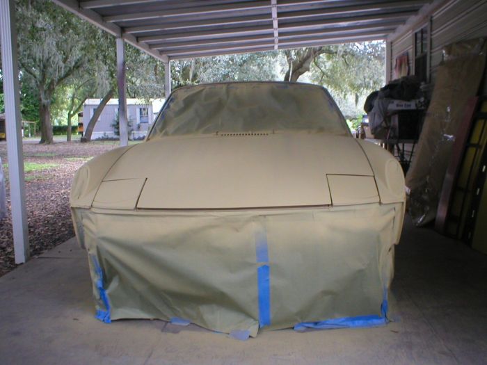

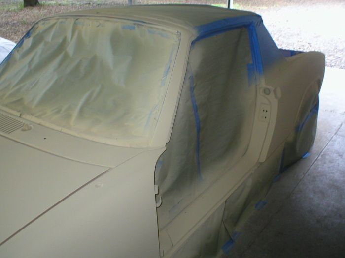

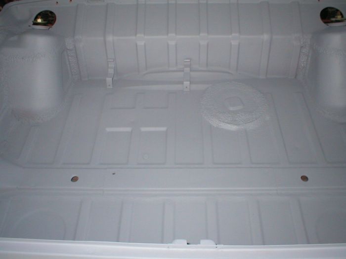

I spent the last couple of weeks prepping the car and was finally able to paint it with primer this weekend. Man, it takes me several hours to tape this car... Anyway, here's the after pics....
I'm soooo tired from this weekend. I'm popping open several Sam Adam's Octoberfest and relaxing tonight... (IMG:style_emoticons/default/beer3.gif)
-- Rob

Are you doing the painting too?
Be prepared for lots of sanding as this is what makes a decent paint job into a spectacular one.

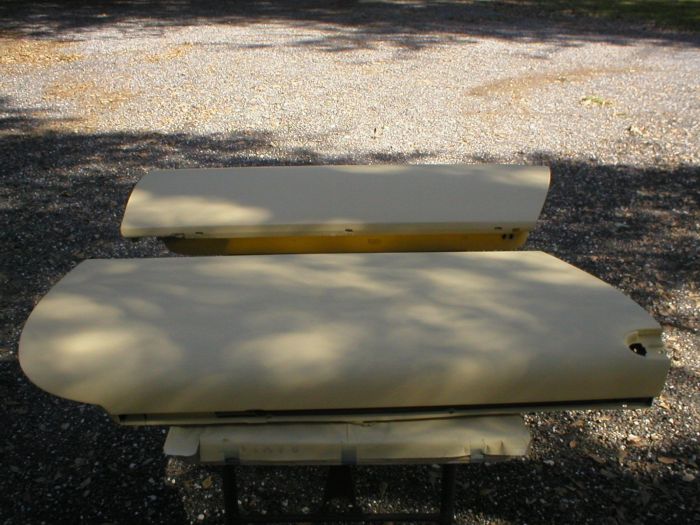

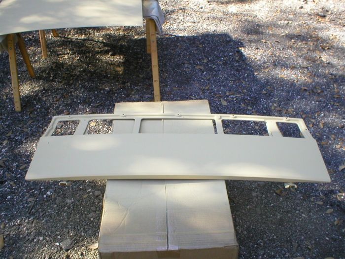

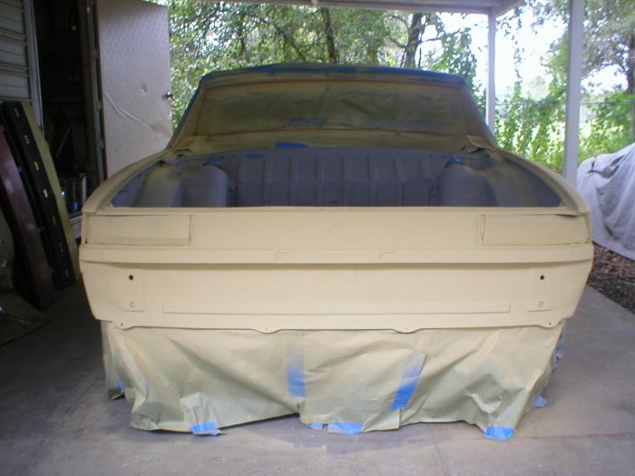

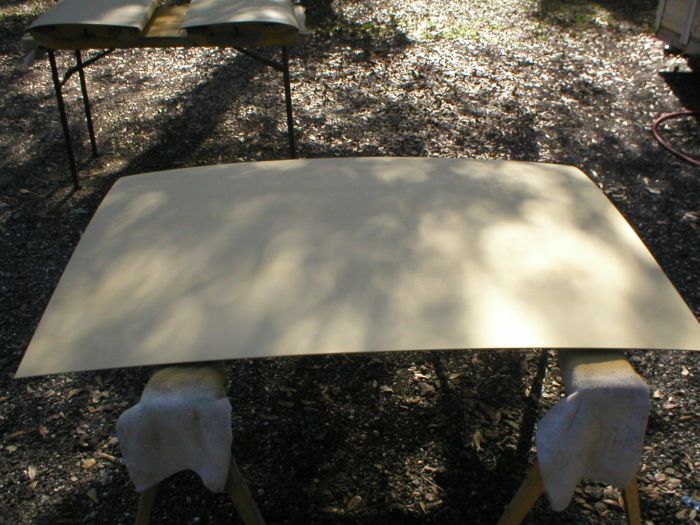

After a couple of weeks of prepping the doors, engine lid and rear trunk lid, I was able to lay the first couple of layers of primer on them. I still need to do some more sanding, then a light couple of layers of reduced primer before I can have them ready for paint...

Here's a link on my website that shows the center section painted. I used a plastic wiring loom and aluminum foil to protect the wires and small sections I didn't want to paint...

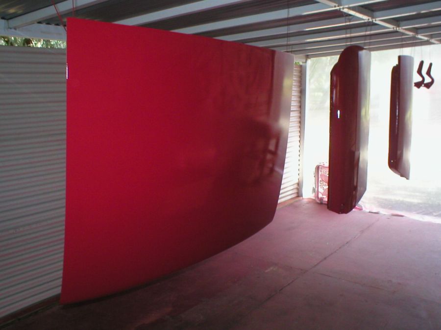

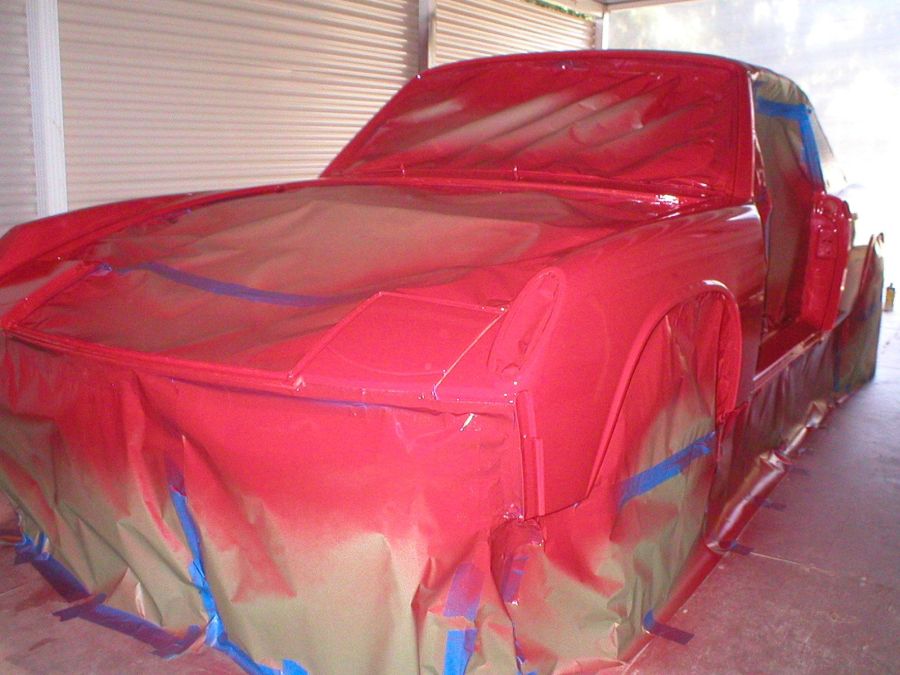

Well.... I painted the car this weekend.... I decided to paint it with single stage acrylic/enamel, also the original color, bahia red...
-- Rob

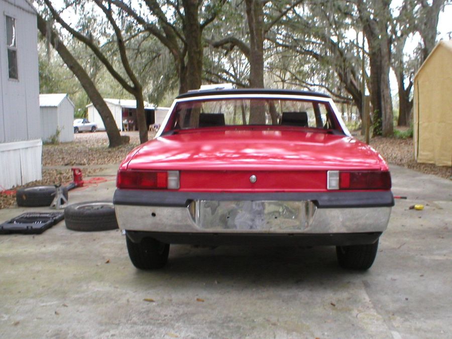

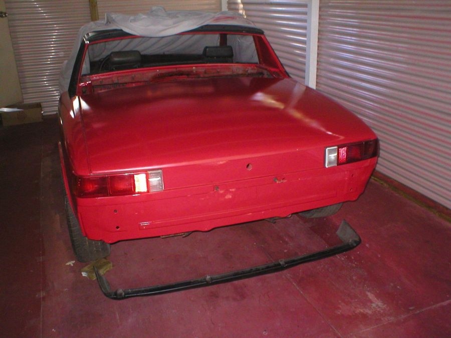

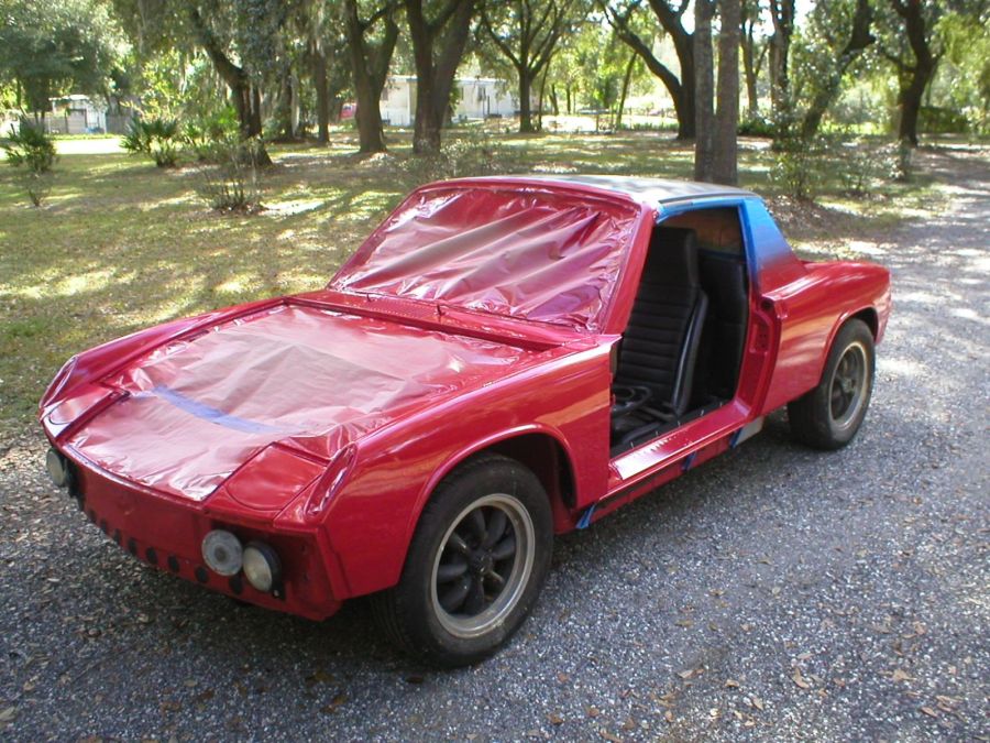

Well, I've finally gotten back to working on the car. After the paint cured, I buffed it out and installed the hardware for the rear trunk.
And the rear trunk lid and rear tail lights...
-- Rob

I finished installing the rear valance, bumper and rear trunk lock...

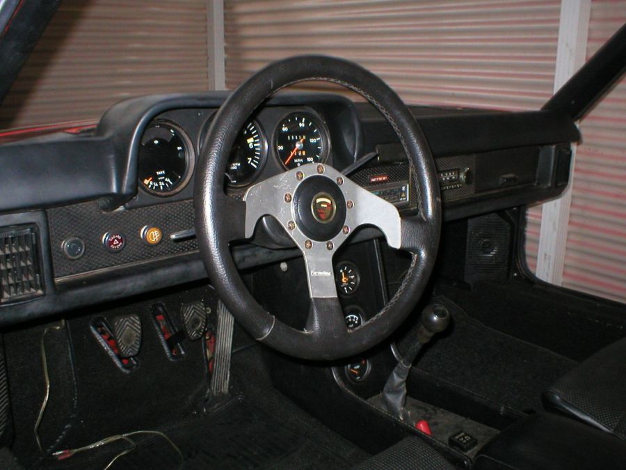

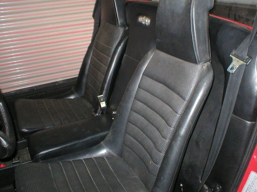

I also completed installing the interior, after I took some of it apart to paint the car. Here's a view of the seats.
And here's the dash. I still have to wire the speakers, install the sun visors and have a professional install the windshield...

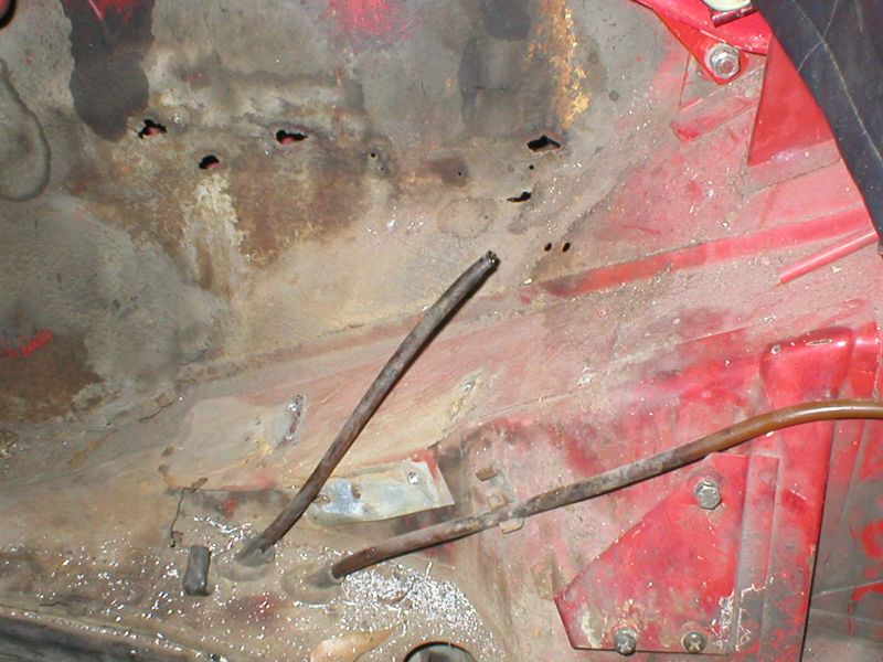

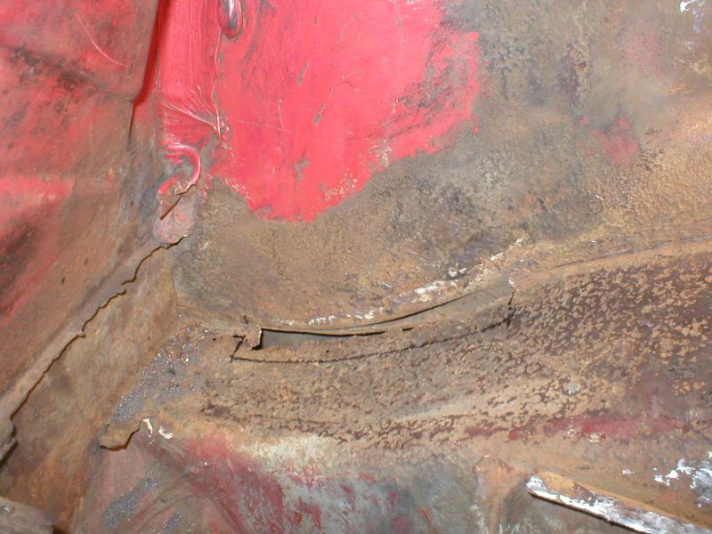

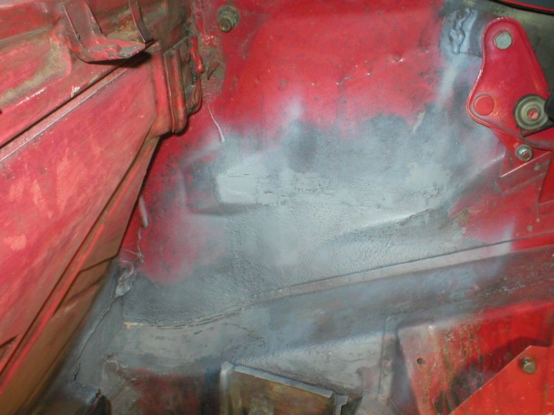

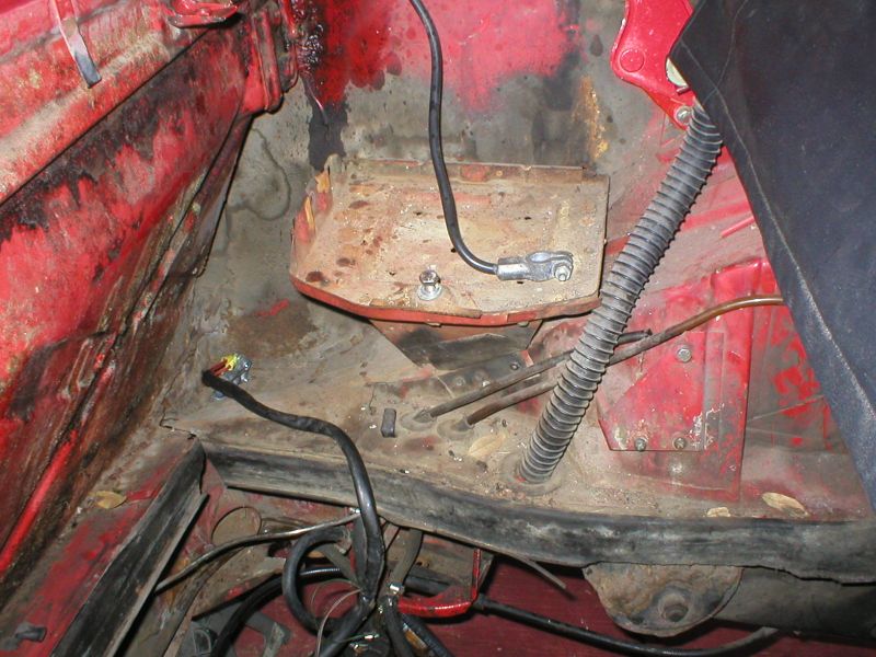

Anyway, I dropped the engine/tranny so that I could finish the repairs in the engine compartment. This first business was to remove the battery tray and stand. The PO had already replaced this, but they mounted it back into place with either pop-rivets or sheet metal screws. Here's the before shot...
After I got the battery tray out of the way, I noticed that the side wall needed some repair..
Then I noticed that the hell hole needed some attention...

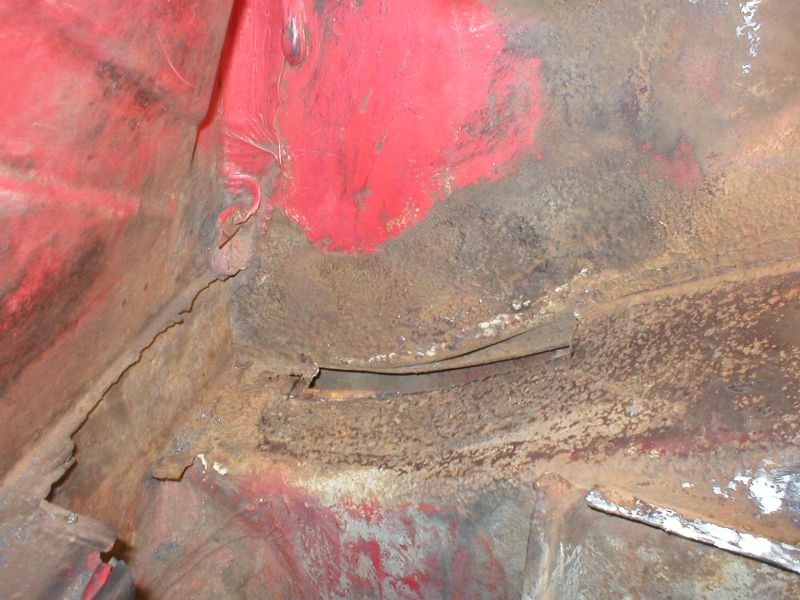

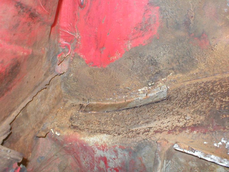

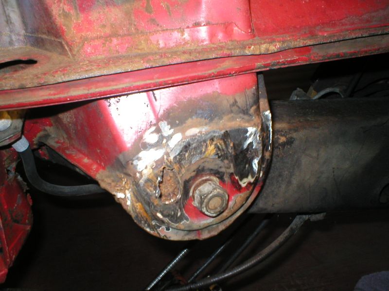

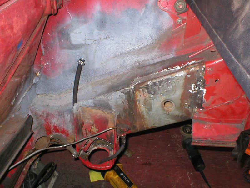

When I dropped the engine I noticed that the right rear suspension ear had been repaired in the past. Someone had done a lot of welding and didn't bother to grind/clean it up. So I decided to grind it down and see what the issue was.... Well here's a shot of the weld gone and a nice rusted hole ....
So I spent the day removing the suspension ear... BTW, I've seen other, more experienced 914ers remove theirs, but I had to remove mine in about 2-dozen pieces. The worst part was removing the factory applied strap welded underneath, in 2 places.... Anyway, here's a shot of it removed.... I have the part on order and expect to receive it next week....

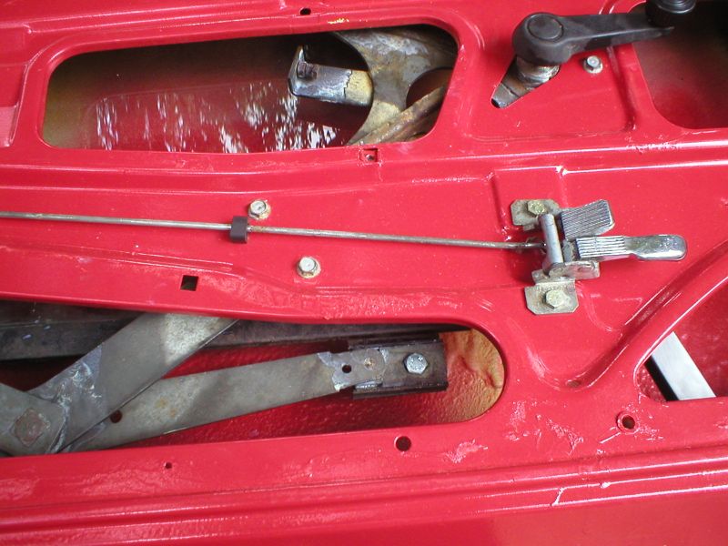

I finished rebuilding the doors and mounted them today....
Here's a shot of the widow winder and the slider at the bottom...
