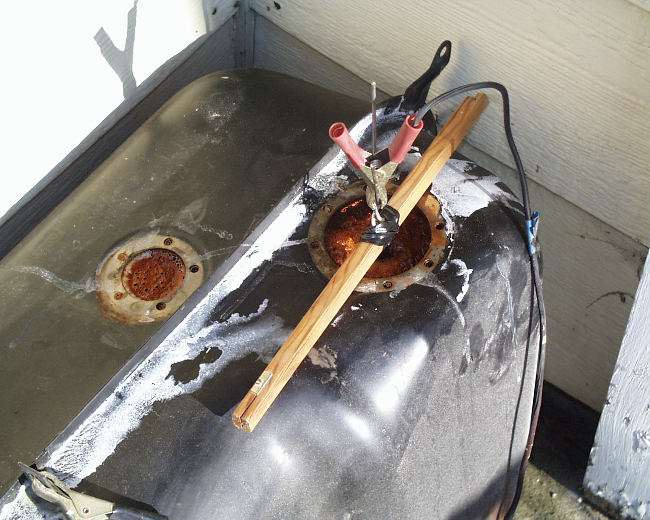

Phoenix-MN
post Jan 26 2008, 08:54 AM
Posts: 927
Joined: 23-January 04
From: ST. Bonifacius,MN
Member No.: 1,590
I filled the tank and dropped an electrode (roll of steel) inside the tank.

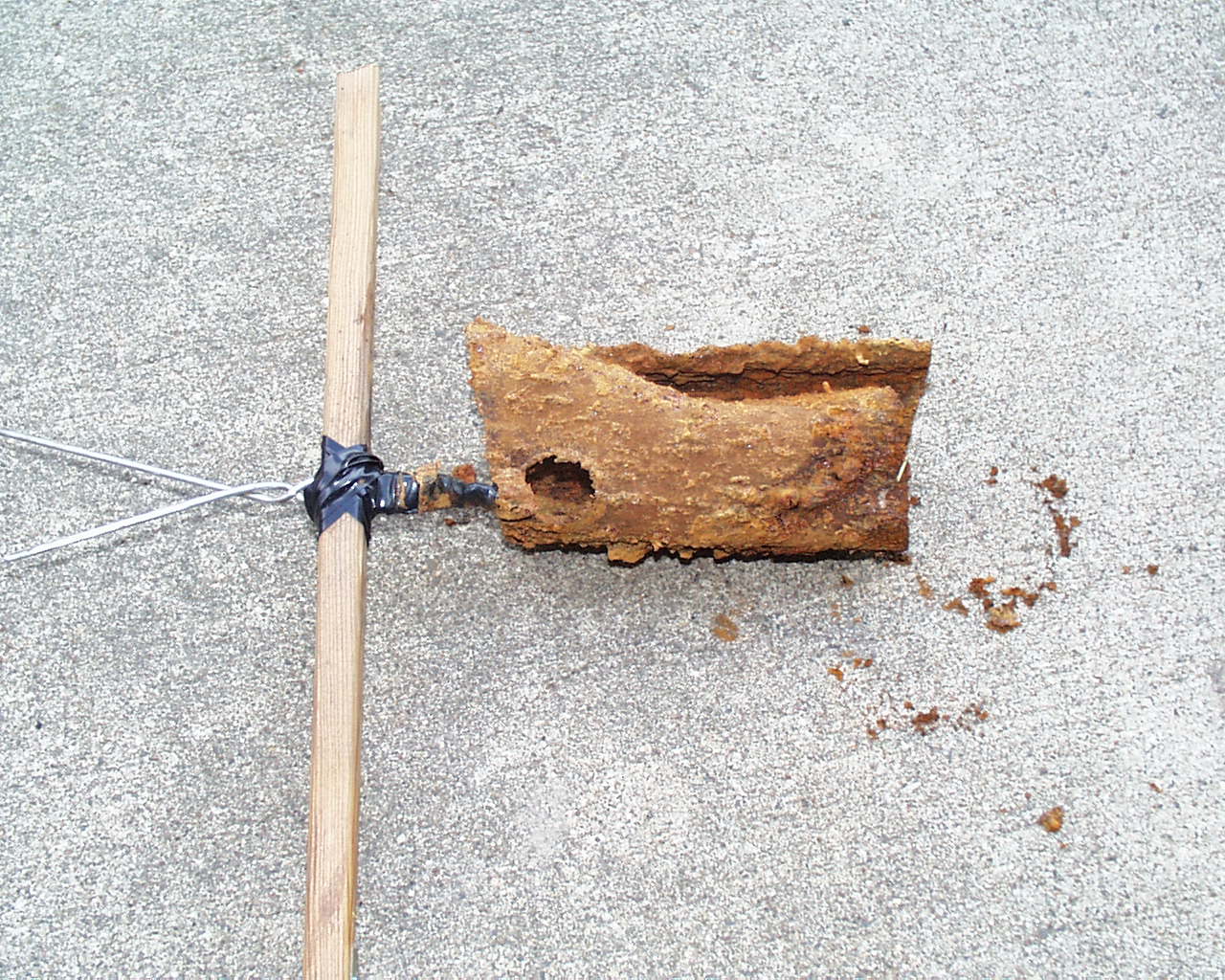

Phoenix-MN
post Jan 26 2008, 08:55 AM
Posts: 927
Member No.: 1,590
Electrode after a day
