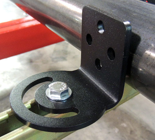

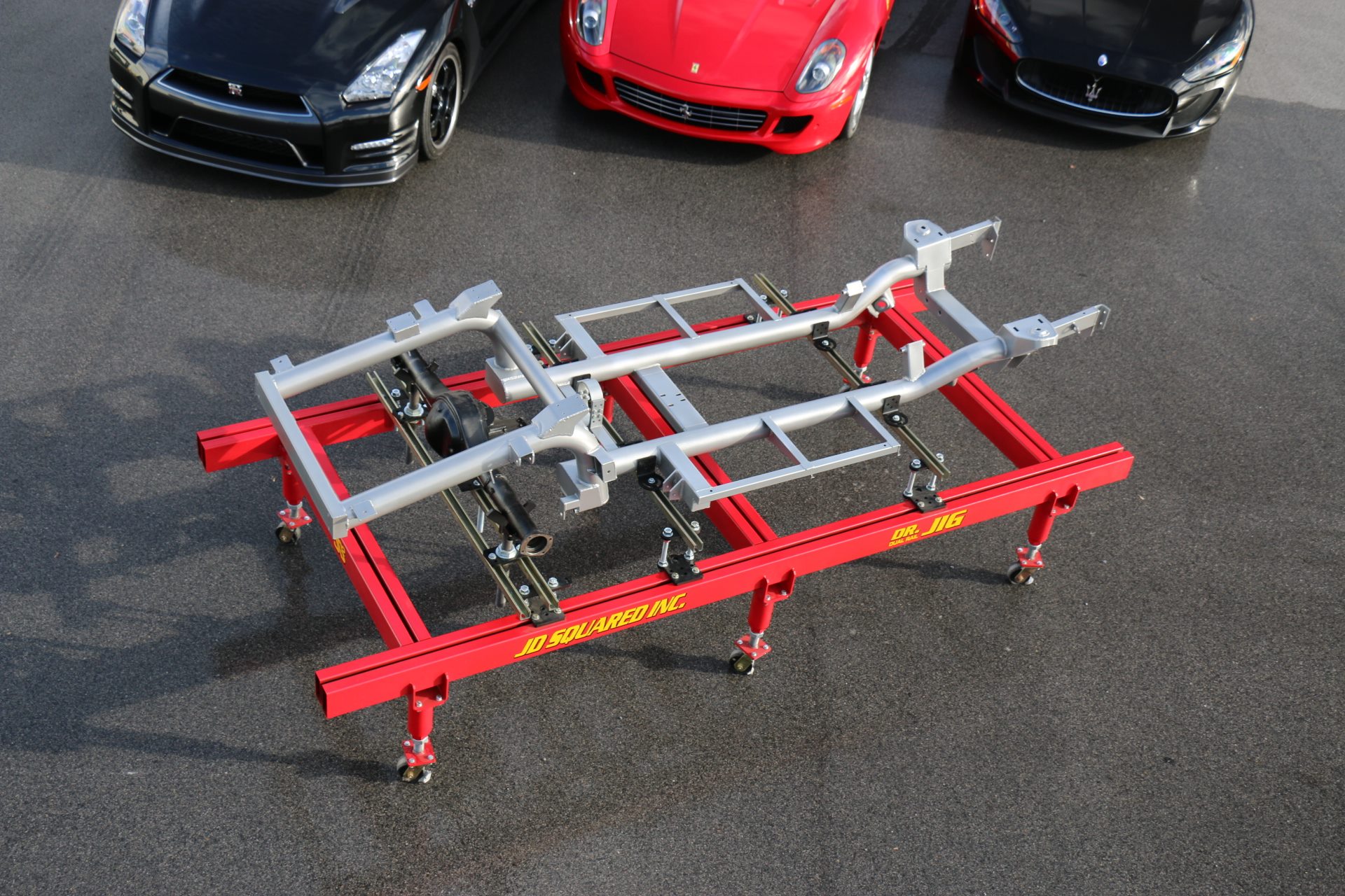

I pulled the trigger on buying a chassis jig today. (IMG:style_emoticons/default/biggrin.gif)
(IMG:http://www.914world.com/bbs2/uploads_offsite/www.jd2.com-11782-1392234464.1.jpg)
https://www.jd2.com/p-94-dr-jig.aspx
I got 20 riser plates,
(IMG:http://www.914world.com/bbs2/uploads_offsite/www.jd2.com-11782-1392234466.2.JPG)

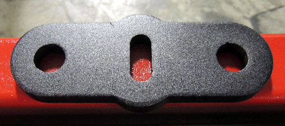

12 bridge plates
(IMG:http://www.914world.com/bbs2/uploads_offsite/www.jd2.com-11782-1392234467.3.JPG)
6 angle plates
(IMG:http://www.914world.com/bbs2/uploads_offsite/www.jd2.com-11782-1392234468.4.JPG)
I still need to get the unistrut cross beams and the 3/4" all-thread and hardware. I'm thinking about fabbing some right hand/left hand adjusters along with the fixtures I'll need to make.
It's kind of a lot for me, but I actually couldn't believe that I found some prduct new that so fit my needs for that price, and for it to be made in the US.

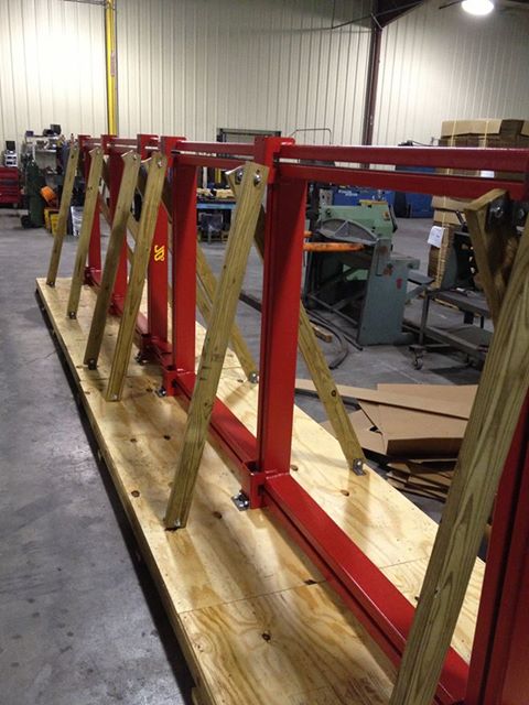

That part hurts the wallet a little. It's 12' x 5' and fully welded together by the 6 brackets, 800 lbs. They ship it freight. They're going to call me and arrange when to be at my shop to put this in my parking spot. (IMG:style_emoticons/default/biggrin.gif) Well, one of them, as that's 2 in a row. $500 to ship from TN to CA
(IMG:http://www.914world.com/bbs2/uploads_offsite/sphotos-b.xx.fbcdn.net-11782-1392269588.1.jpg)
That might be one I bought, as he said he has 2 there, and they just started making these late last year.

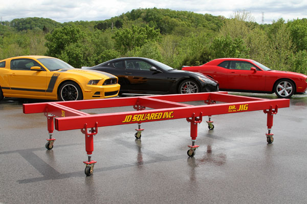

Another imprssive shot of the thing, a customer sumitted to them.
(IMG:http://www.914world.com/bbs2/uploads_offsite/scontent-a-ord.xx.fbcdn.net-11782-1392269590.2.jpg)

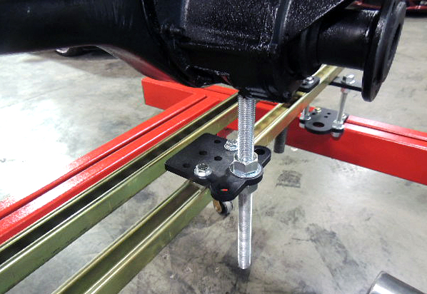

The unistrut stuff, you can get from the maker, their site is pretty cool, as is their product. I'm looking to get like 6 cross beams of 5', (though you may have to buy 10) probably the P1000T
http://www.unistrut-direct.com/browse.php?...hannel&id=1
(IMG:http://www.914world.com/bbs2/uploads_offsite/fbcdn-sphotos-c-a.akamaihd.net-11782-1392269591.3.jpg)
Some coin but I could spend more than that building my own probably, and have it come out taco'd. I watched a video on truck garage how-to series, and their floor was perfectly straight when they built one. Also, I don't know how they kept it from moving when they welded it.
Also, If I built my own, it would have been only to mount a 914 on, so this one being modular/moveable was a big plus.
