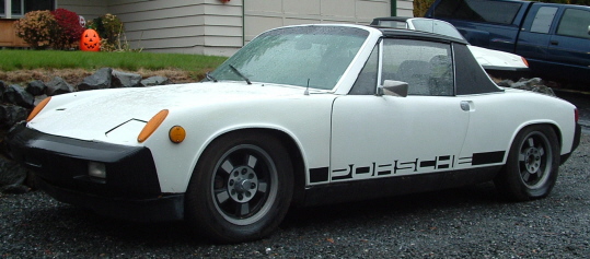

well here it is, turns out the rust is the outer rocker, no biggy,
battery tray rusty,no holes, all else solid, Bad news no run. prime system bad fuel line ,gas spraying straight up , New fuel line Good news , new plugs, cap ,rotor ,wires , already installed PO's friend Bad news no spark Replace the only thing they didnt , the condensor ,yes =spark More bad no start prime -starts dies ? Oh look new oil and filter,PO's friend Tighten oil cap starts and runs , no smoke ,runs good then quits Good news out of gas. more gas runs and drives needs pedal bushings ,tires, and push rod seals. body straight was yellow repaint white, not so bad except for the black bomb can job under the hoods. finally look at the odometer 80k seems correct. Attached image(s)
