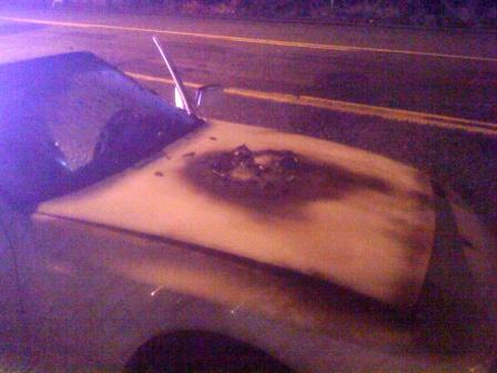

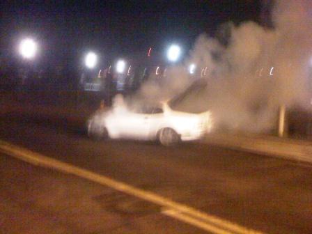

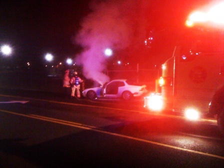

I Had just got back from a quick trip to SFO and back the weather was nice, the sunset gorgeous, jumped back in my car, I'm going to get home a little early, and I notice a slight fuel smell. I Pull over and as I do I hear a pop. I knew I had a fire. Called the fire department and as they were right there at the airport the were these in minutes. Made a pretty good mess.

computers4kids   From the pics it appears the fire started in the f...   Nov 1 2009, 08:31 AM

scotty b   Fuel rails are known to crack on these cars. My gu...   Nov 1 2009, 02:54 PM

scotty b   Do yourself a favor and get Lindseys fuel rail. It...   Nov 2 2009, 07:21 AM
Mikey914   I actually had a gage, but when my mechanic saw it...   Nov 2 2009, 11:46 AM
Cap'n Krusty   I've worked on 944s since they came out, and h...   Nov 2 2009, 12:16 PM
