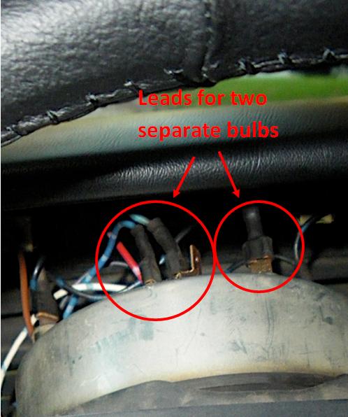

flipb
post Nov 2 2009, 09:52 AM
Posts: 1,900
Joined: 2-September 09
From: Fairfax, VA
Member No.: 10,752
QUOTE(SGB @ Oct 9 2009, 08:21 PM) *
QUOTE(montoya 73 2.0 @ Oct 9 2009, 12:23 PM) *
I believe there is only one bulb inside the turnsignal indicator, which would flash both indicators when either side is activated. Mine did the same thing until about two months ago. Now, the left signal makes the indicator work but my right signal does not (both signals work on the outside front and rear)?
My green indicator light turns off when my headlights go on!
Green indicator light is supposed to turn off when headlights are on. It is for parking lights only.
There are two bulbs. You need a new relay. A turnsignal relay from a VW bus is a great replacement and will restore proper function of left and right dash indicators.
Here's the post that suggested changing the relay.

And since I like pictures, here are the two leads for the two separate turn signal indicator bulbs in the top of the tach (this is a '74).

hmm. I didn't care before, but now I must look to see if mine has 1 or 2 bulbs (IMG:style_emoticons/default/biggrin.gif)
