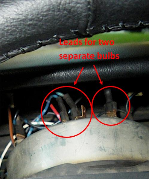

flipb
Nov 2 2009, 10:18 AM
And since I like pictures, here are the two leads for the two separate turn signal indicator bulbs in the top of the tach (this is a '74).
