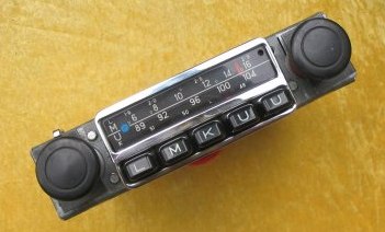

I wasn’t happy with the look that my modern stereo contributed to my 914 interior, so I went to a stock radio. Origninality was important to me (IMG:style_emoticons/default/biggrin.gif) However, my radio also plays music from my iPod, or iphone. One extra benefit about the iphone, is I can turn on an internet radio station and play it also through my stock radio for free…a poor man’s satellite radio.
Our cars were outfitted with a variety of radios such as the Motorola the Sapphire or the Blaupunkt. There are a variety of options to connect an ipod, iphone or mp3 player and have them play through the stock radio…you could wire an iPod through the headphone jack directly to an amp as well, but I’m focusing on just enhancing the stock radio.

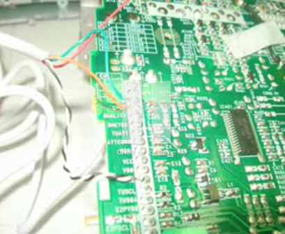

Tap into the pre-amp of your radio
•Another option is to open your radio and tap into the pre-amp circuit off of the volume control. It can be as easy as removing one wire off the volume control and inserting an aux jack inline with a couple of resistors. You can also soder onto the circuit board. Combined with an iPod cord that you switch the pins on, you can charge your iPod while pumping the signal directly into your radio. Many of the schematics are available on SAMBA. Costs about $20. Here are some of the radio schematics on SAMBA. Here is a video of the basic idea how: http://www.metacafe.com/watch/897853/conne...isten_recharge/
Traditional ipod lineout cables do not charge the ipod, but only directs the music. You can rewire the pins on the cable if you want, or just buy one off the net.

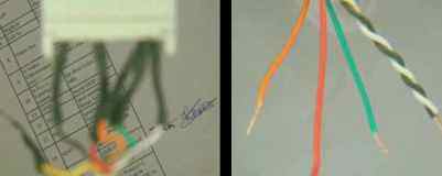

Pin order Required to charge ipod and direct music out. (connects to ipod)
pin 30 (& 29 optional) Black color
pin 20 Red color
pin 4 Orange color
pin 3 Green color
pin 2 White color
Here is the wire code that connects to your radio.
Grd Black & White cables twisted together
Left Channel Orange cable
Right Channel Green cable
12V Red Cable

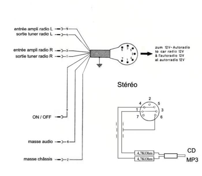

Geez, $89 for that DIN to 3.5mm adapter. I made one for about $5 in parts.

Stereo and mono diagrams. I put all the wiring connections in a little box and included a switch to bridge the correct pins when I want to go back to radio only. The DIN output usually has a cap on it with a set of bridged pins. When the cap is removed, it looks for input to the DIN.

TRANSLATION OF THE FRENCH WORDS ...
Entrée = input
Sortie = Output
MASSE = ground

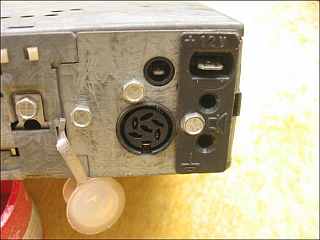

Managed to get my digicam close enough under the dash to snap this. It's the backside of my Blaupunkt. There appear to be two ports covered by plastic clips - on the left, the plastic cover with a "leash", and on the right, the plastic cover with a small nut holding it in place.
Anybody know which of these is the DIN? Or am I looking in the wrong location?
