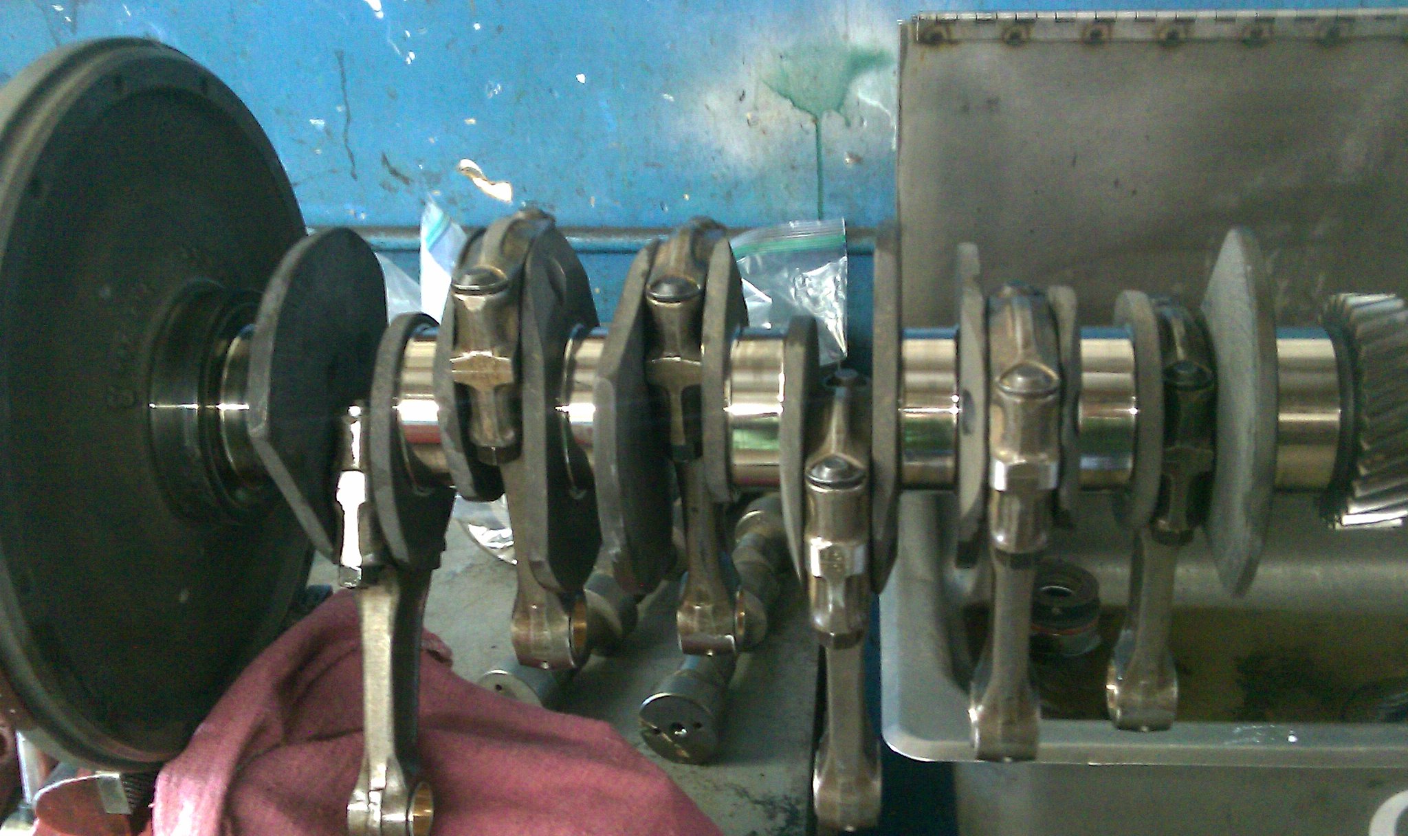

thanks, I need to ask my buddy again on the re-grind of the cams. 9.8:1 + twin plug. why do you say its not warranted? you wont hurt my feelings but I'd like to hear the Six Guru's take on the subject

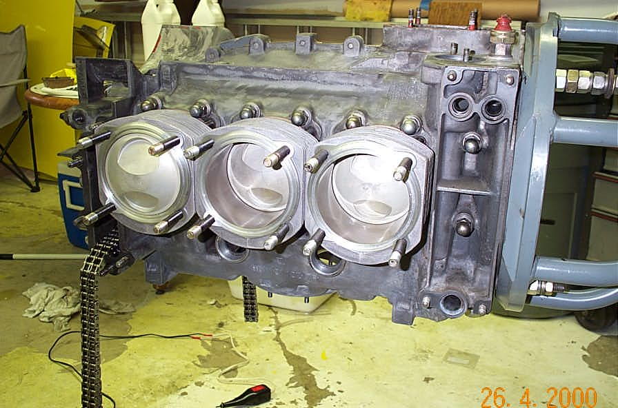

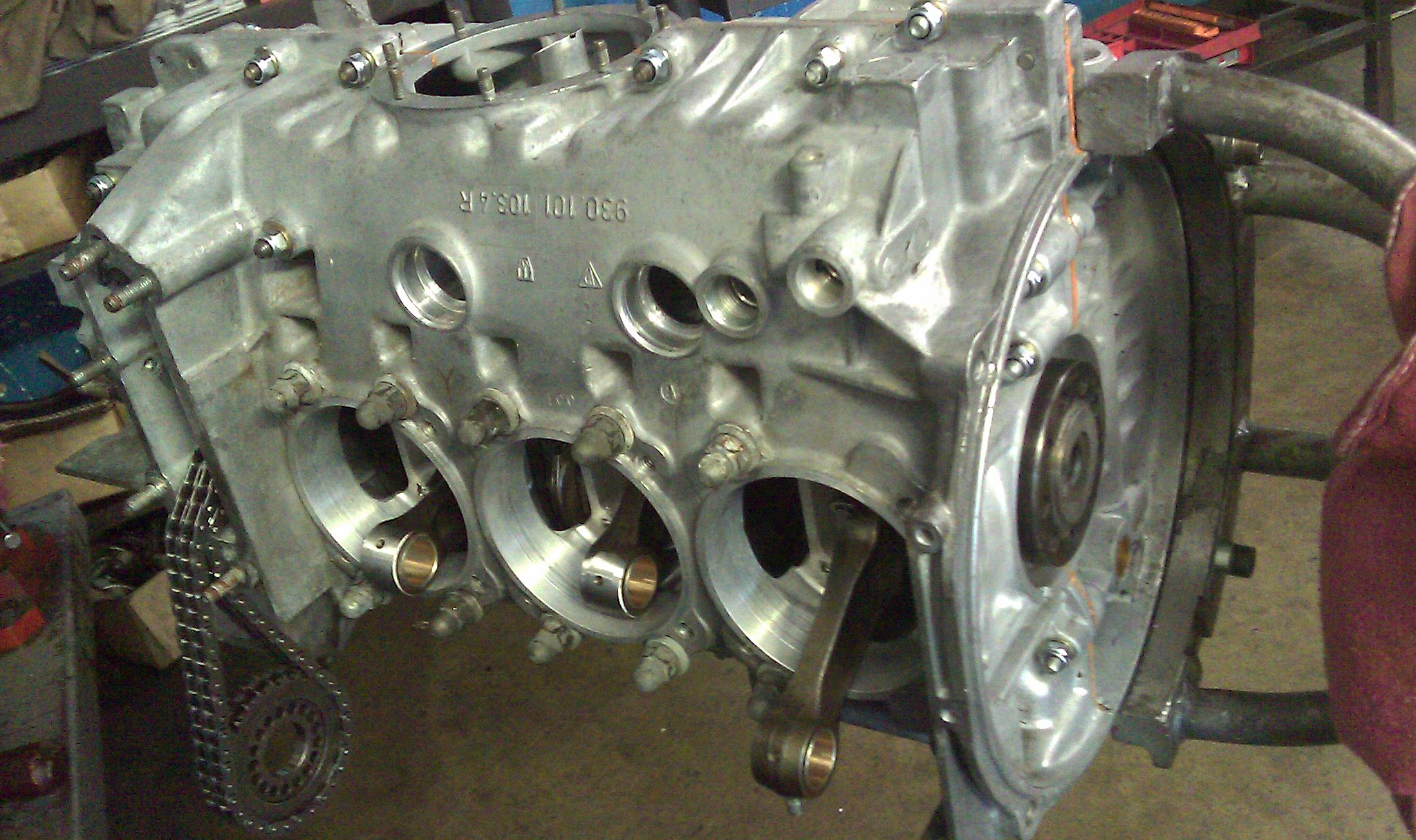

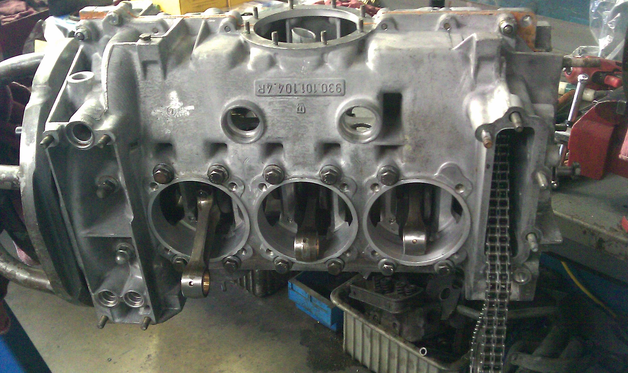

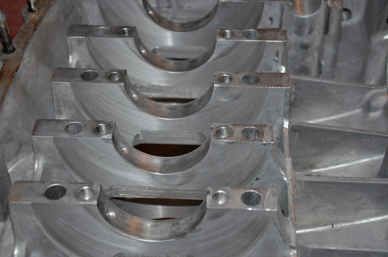

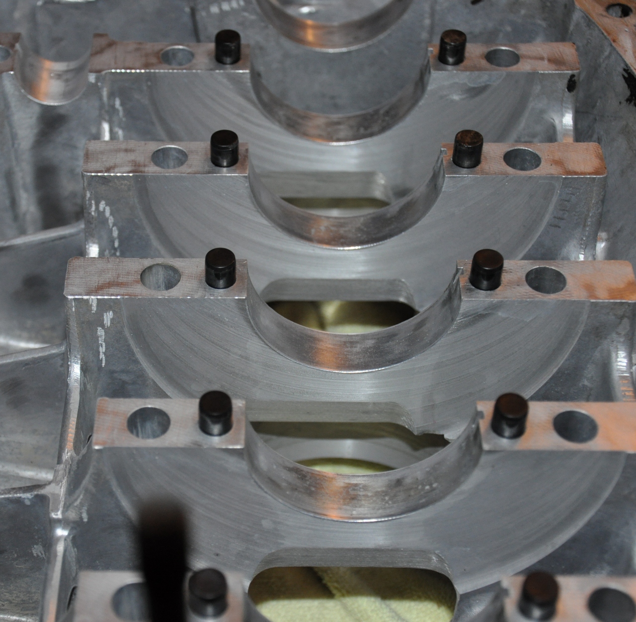

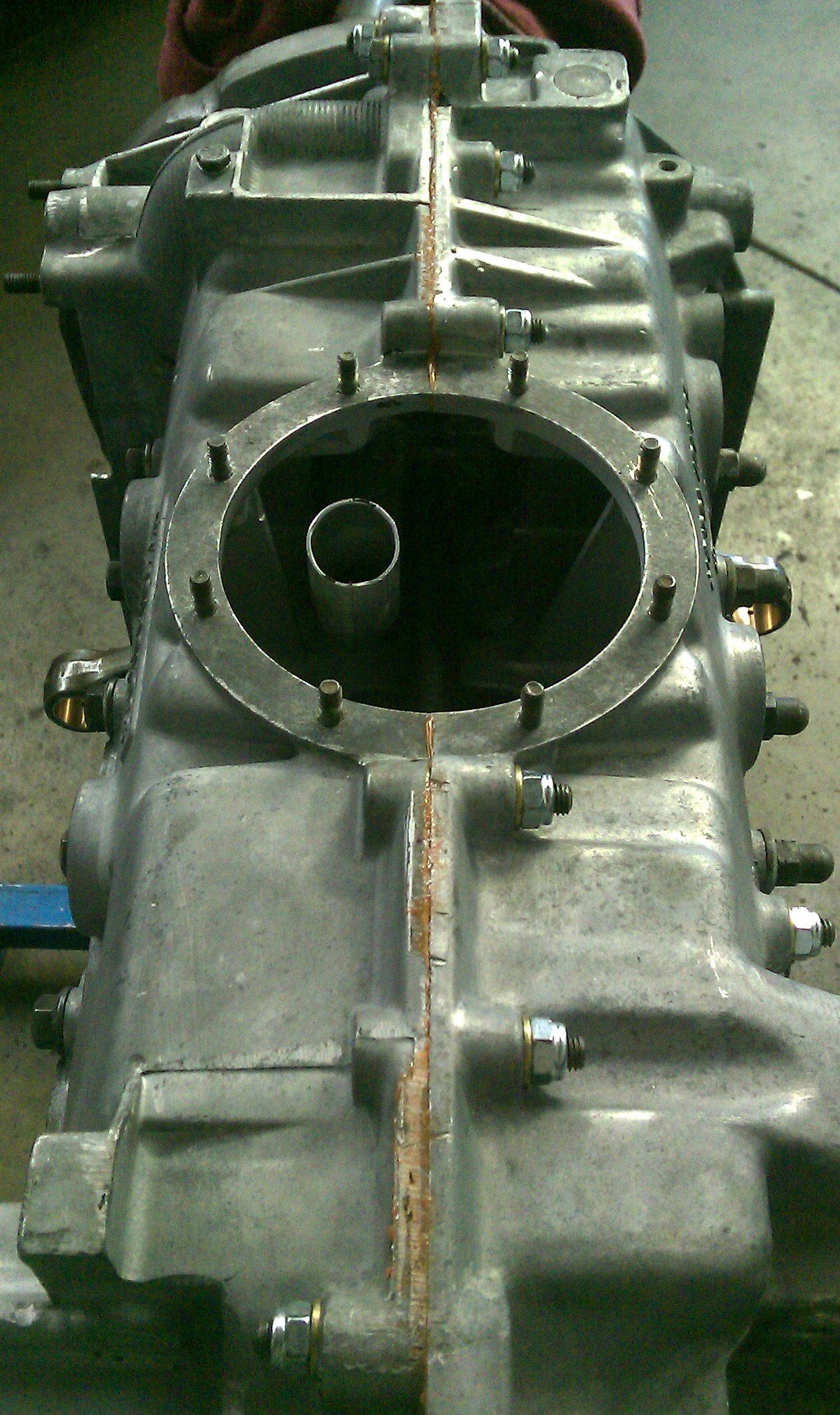

here's two pics of the Shuffle pins

9.8 you,ll need twin plug, just curious on the cam,
It will run sweet with twin plug. You have all the bells and whistles for sure.

QUOTE(Socalandy @ Aug 3 2011, 07:57 PM) *
Mahle computes compression without taking into account the required .04 deck height.....thus the actual compression is closer to 9.3:1.(or less). The twin plug, shuffle pins, half mooning the cyls & boat tailing he block add little or nothing to the output of the engine....what, no boat tailed crank?...my money would go elsewhere......but all that makes a nice base for an 8000 rpm race motor.
Those pistons kill anything approaching a cam that scavenges well......top end down the tubes wasting those big ports. IMO, lotta bells but not many whistles. Don't forget, ...."you won't hurt my feelings". (IMG:style_emoticons/default/biggrin.gif)
Something like these in 95mm will solve your shortcomings.

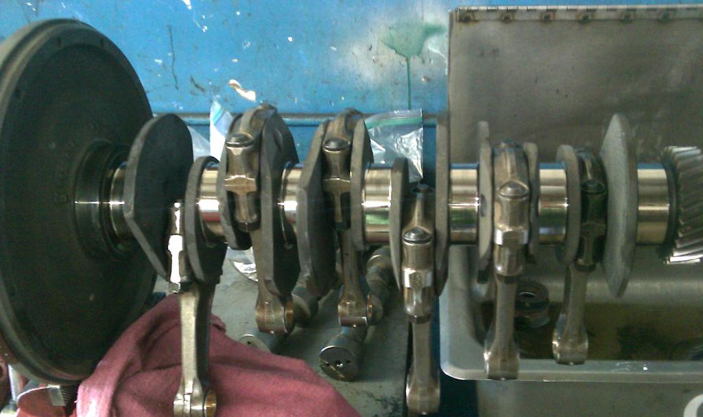

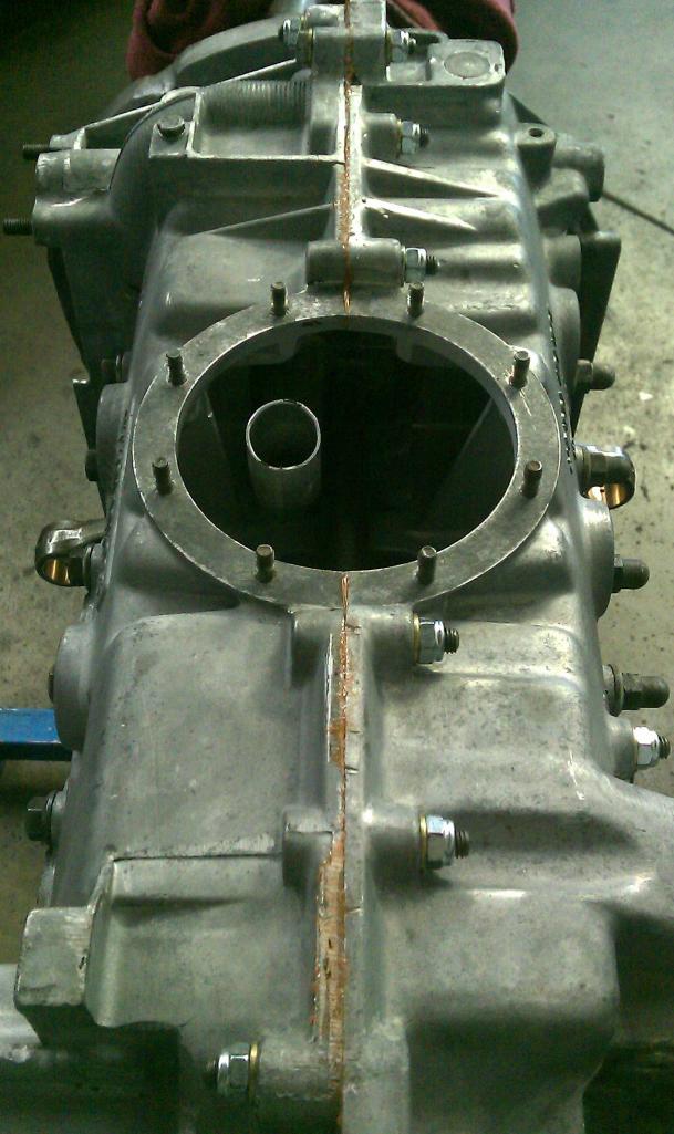

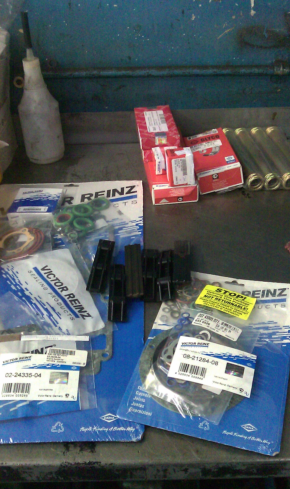

assembly started, sorry for the crap cell pictures

more tomorrow with the Nikon camera (IMG:style_emoticons/default/biggrin.gif)

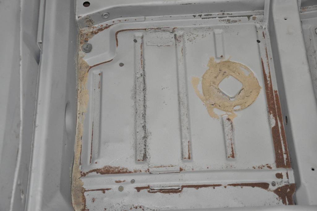

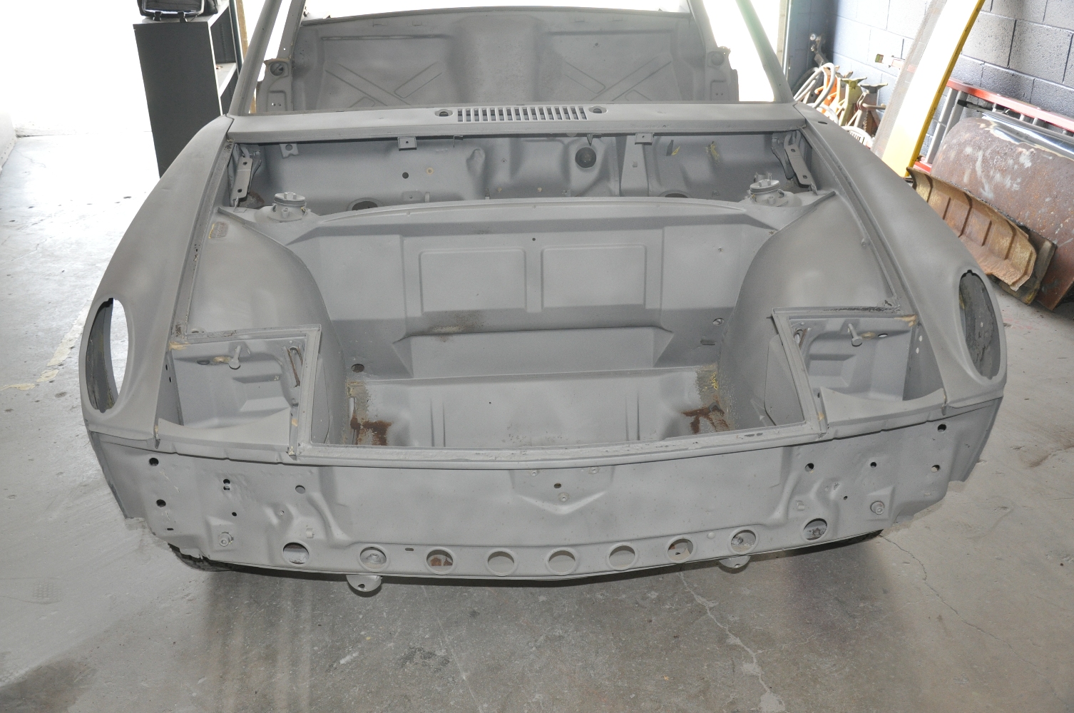

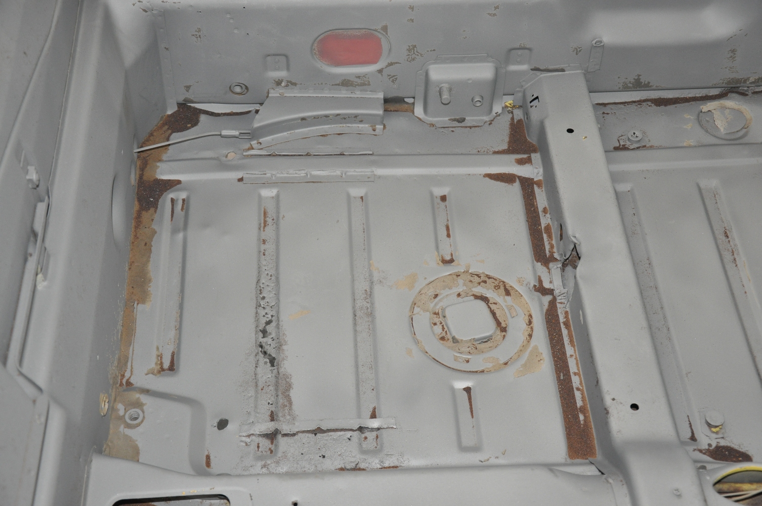

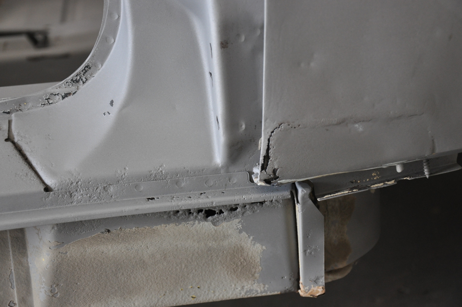

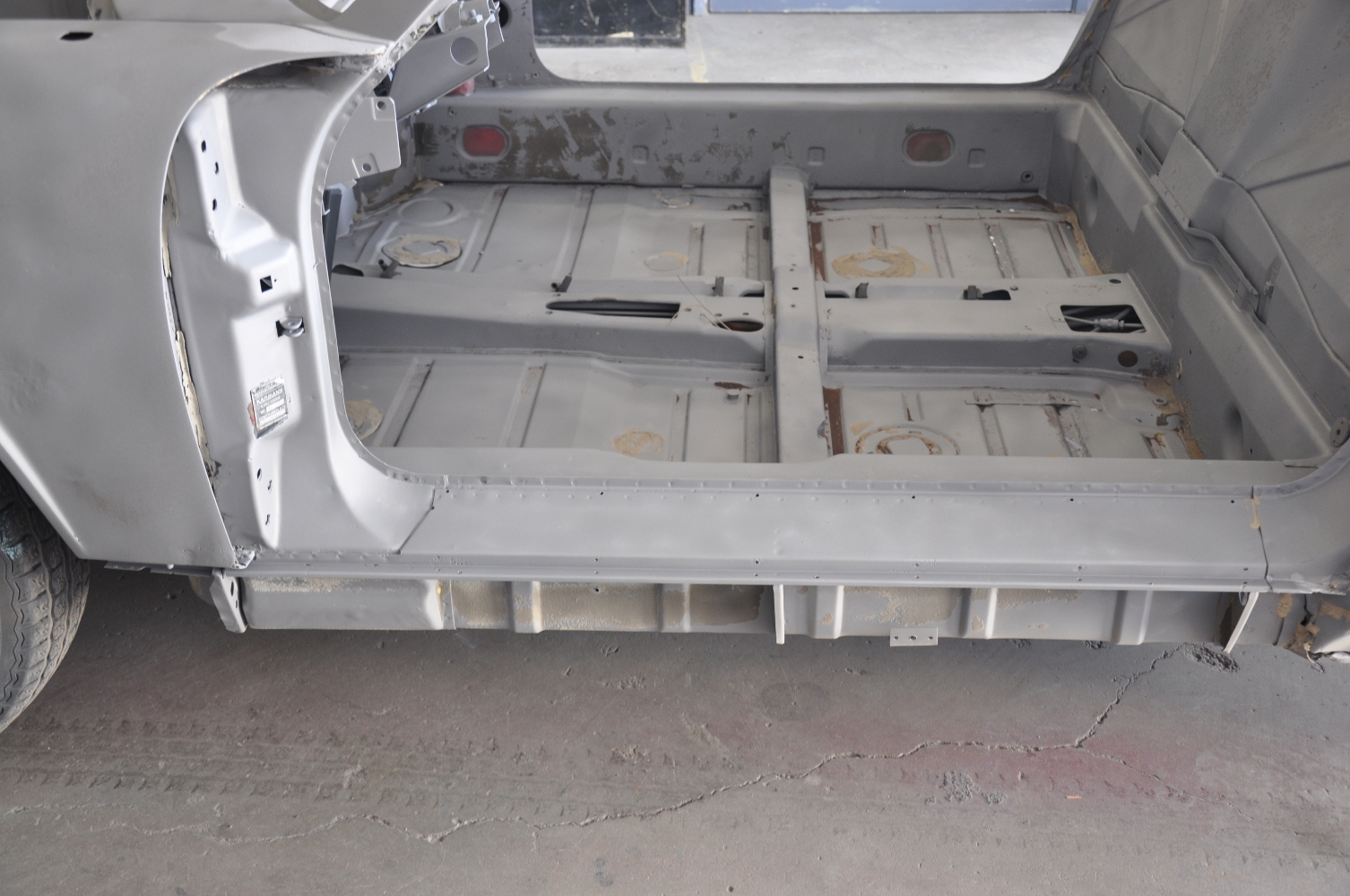

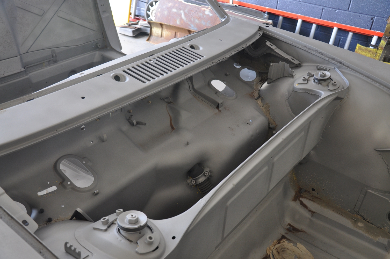

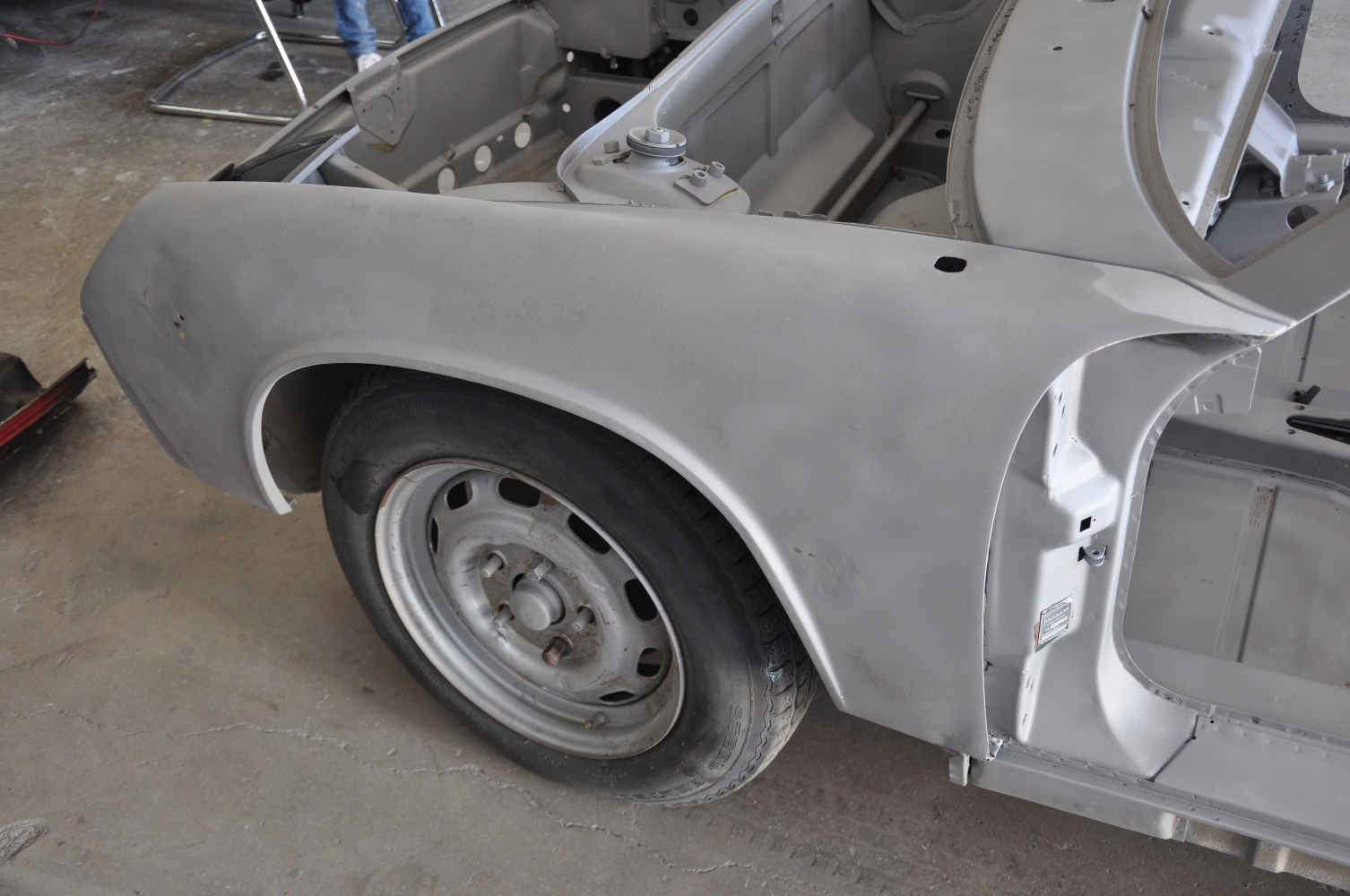

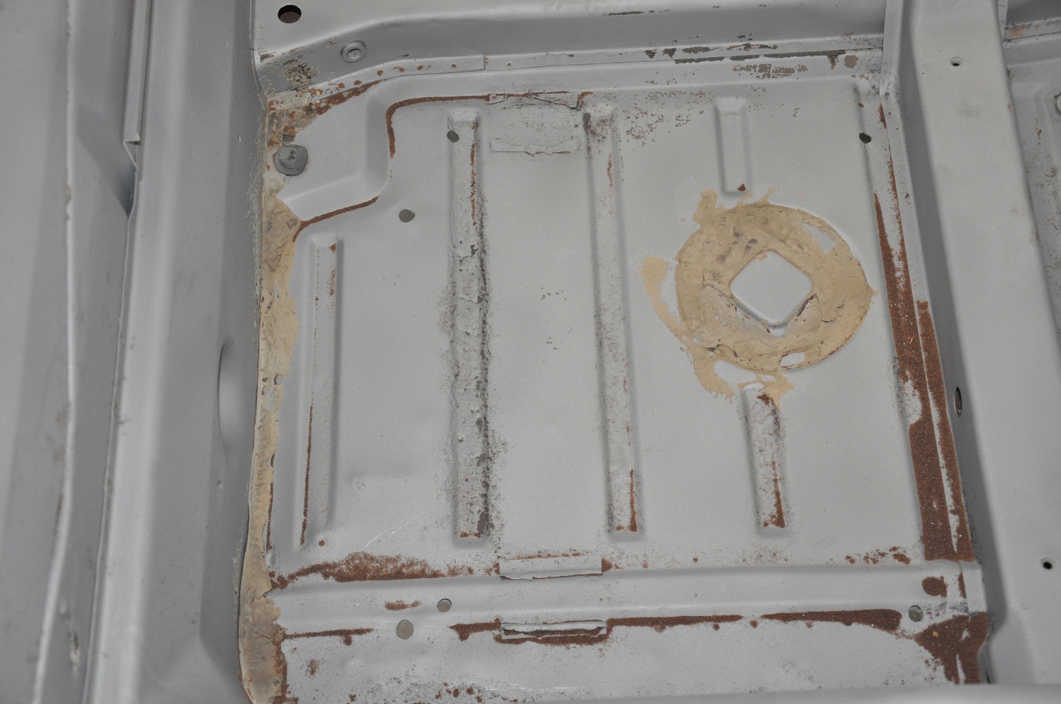

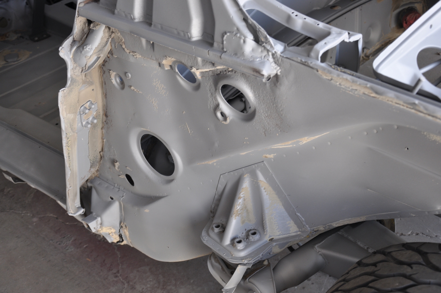

Well after a rough few months of work, fathers trust I'm caught up and thank you Ron for helping get Joe's engine out. Sorry for the delay Joe!!!
The car is back from media blasting and I know i have alot of work ahead of me but it's better than I thought it would be!!!! I have all the skins needed and of course the flares so were off and running and hope to supply a steady stream of progress photos.

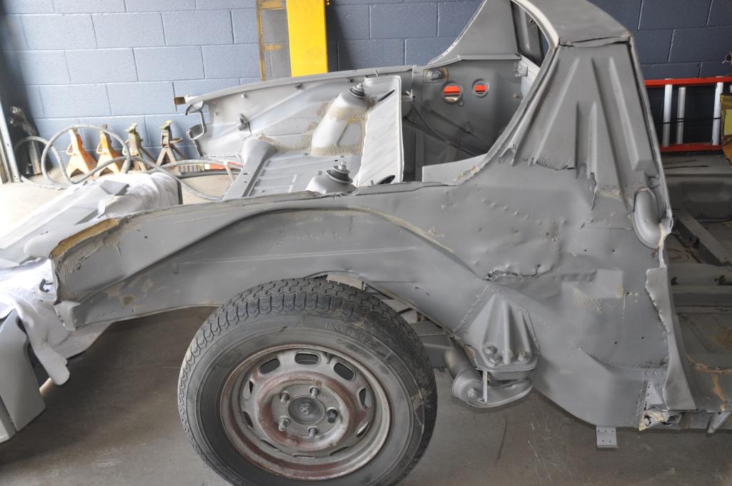

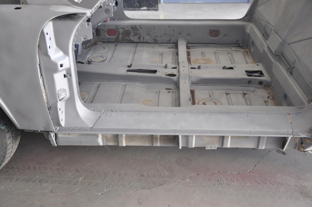

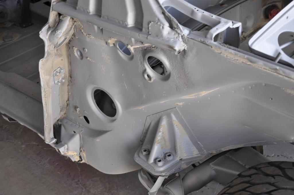

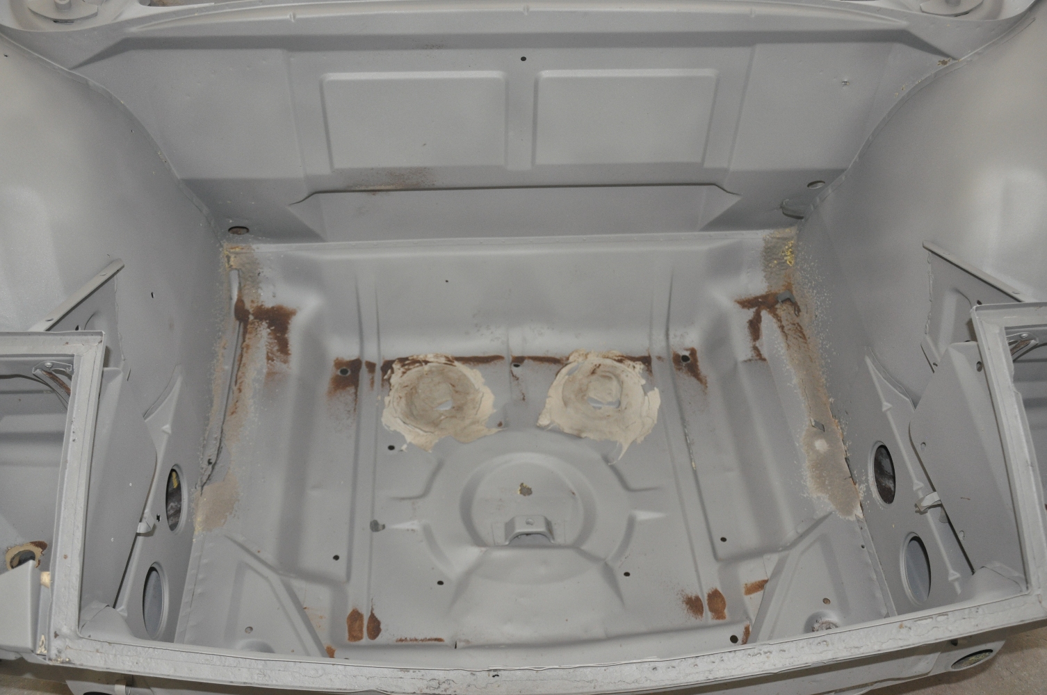

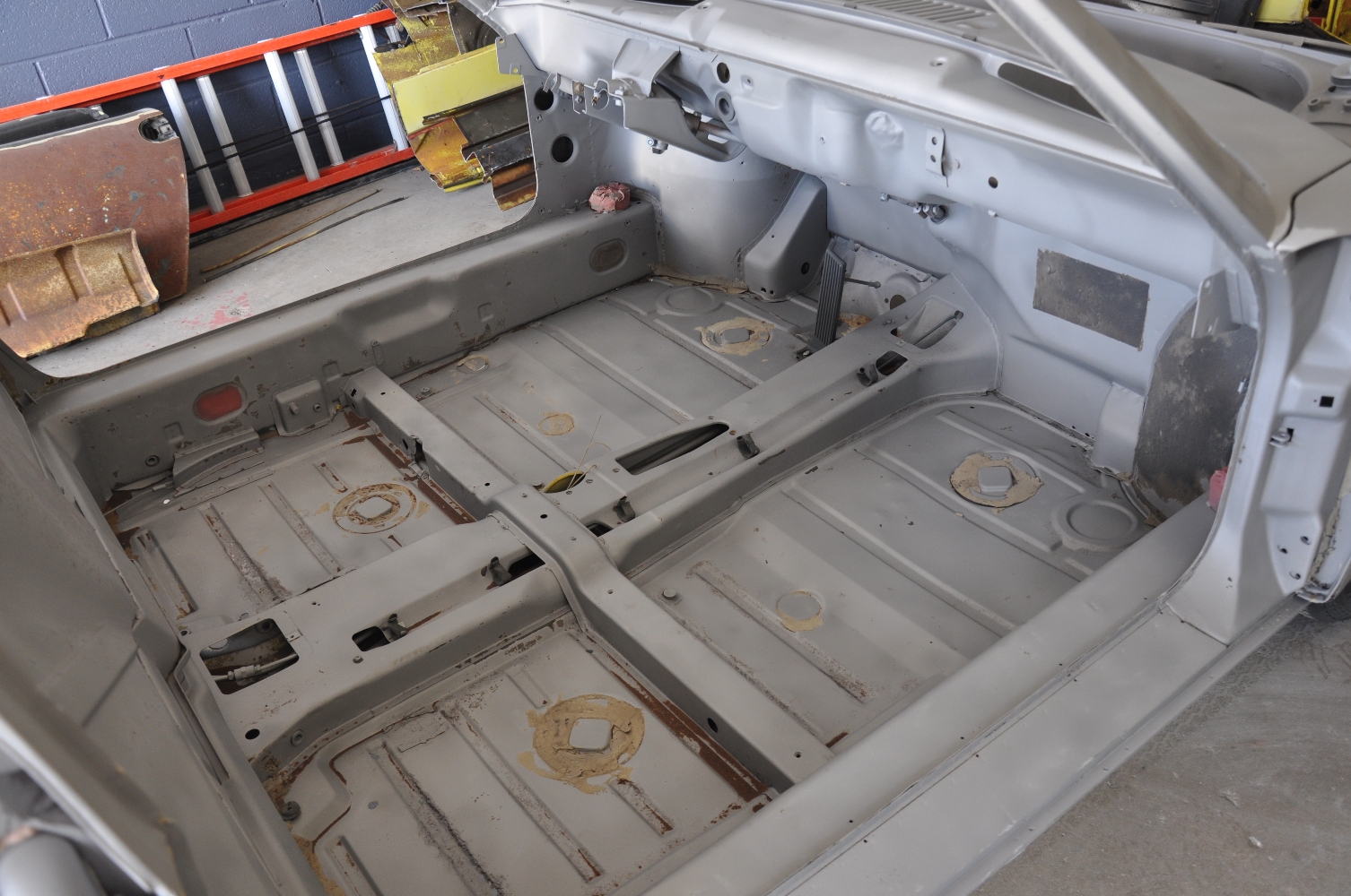

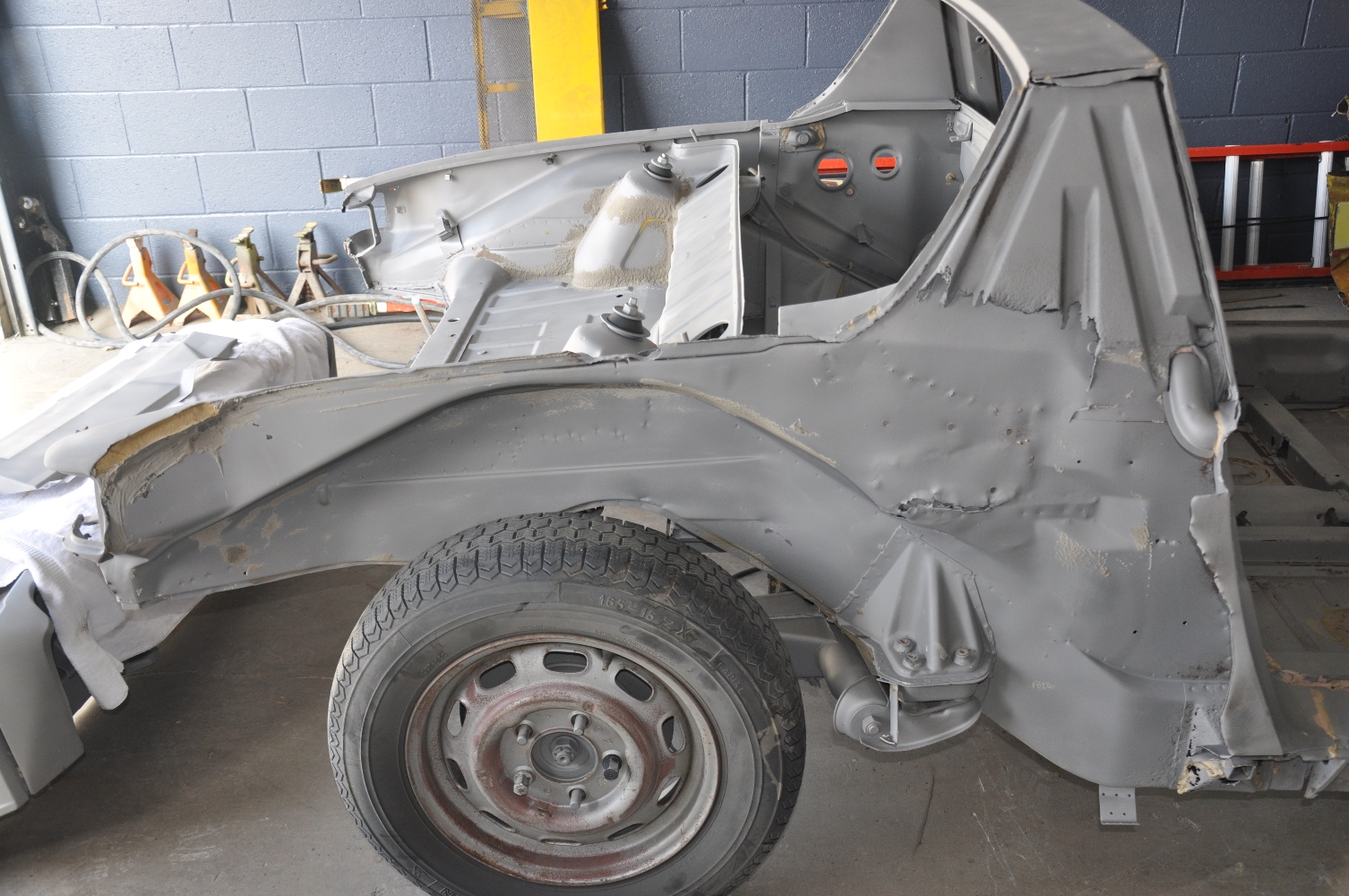

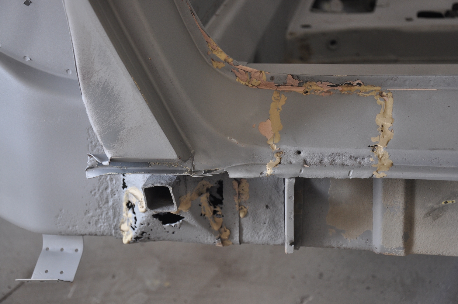

Socalandy

time work some (IMG:style_emoticons/default/welder.gif)
