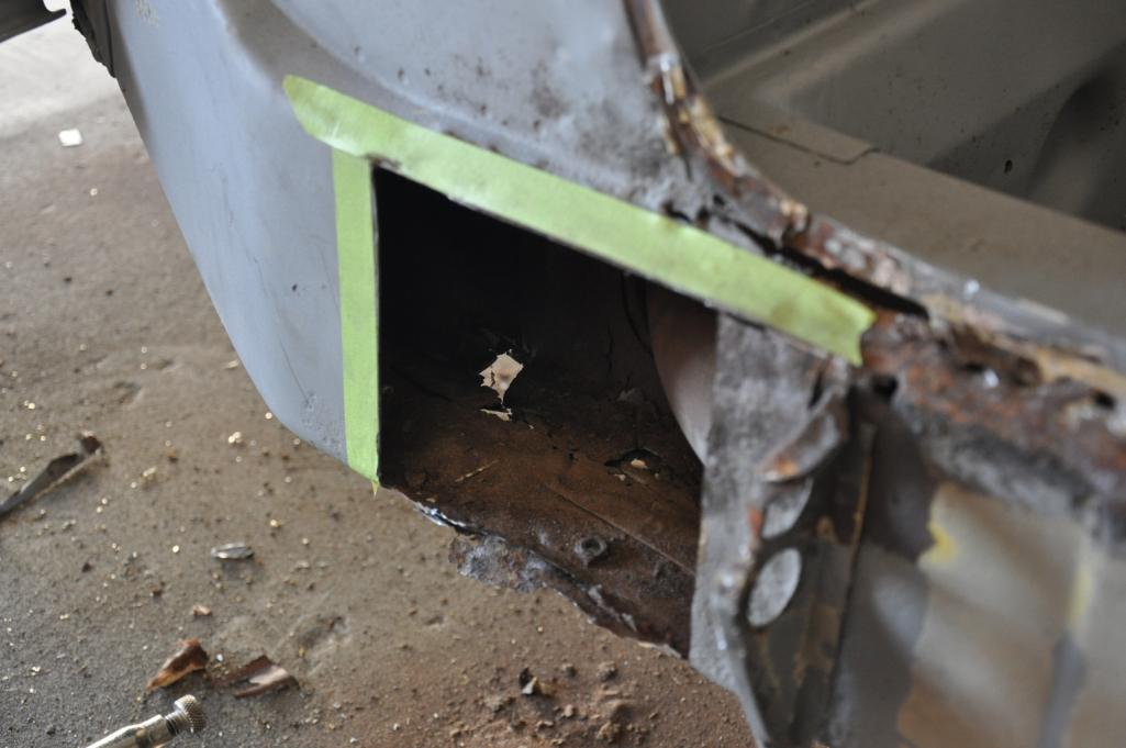

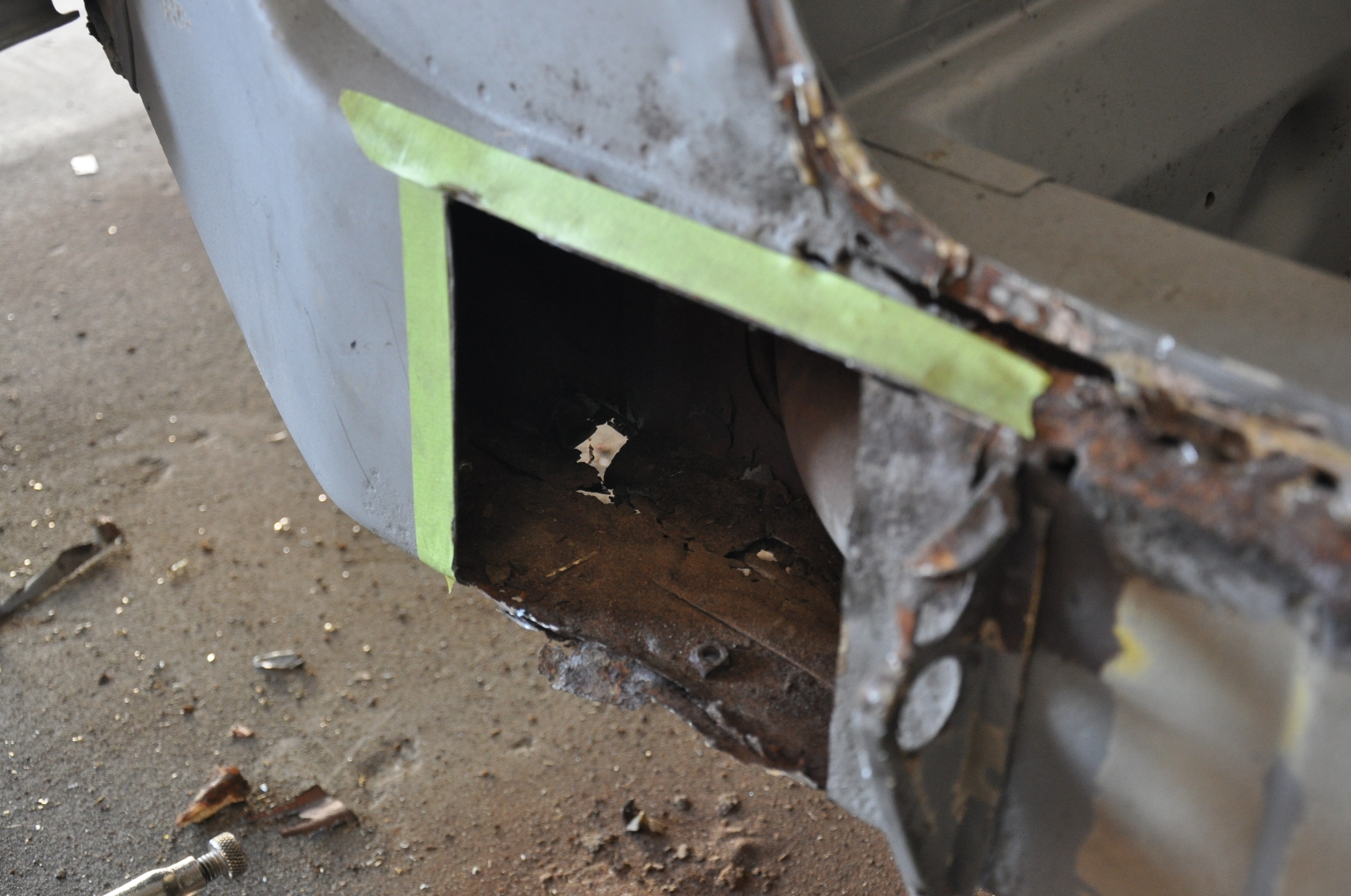

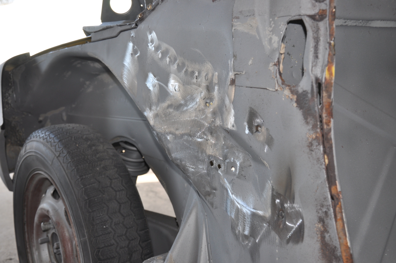

Both headlight bucket and the drivers side trunk floor-to-wheel well are PO f'up's.

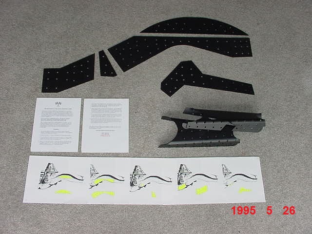

Rich makes this kit (a914guy) for the back half

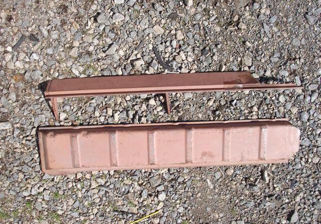

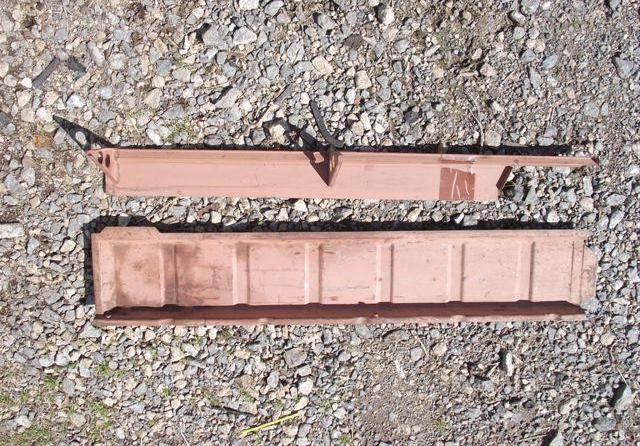

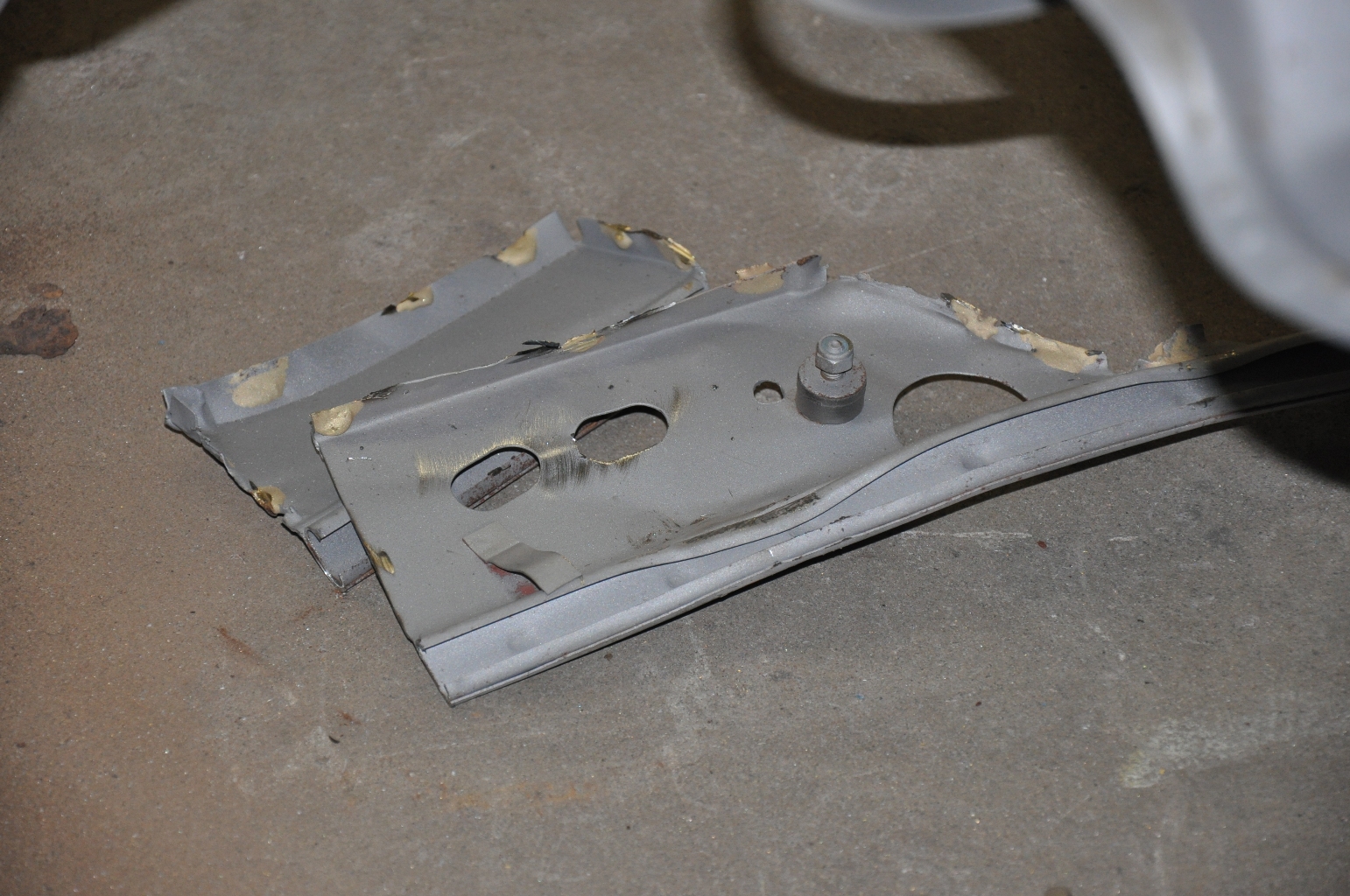

found NOS long parts, listed as passenger inner, lmust be outer to with no holes and ribs but need confirmation on left side and what end the jack point would be on.
thanks

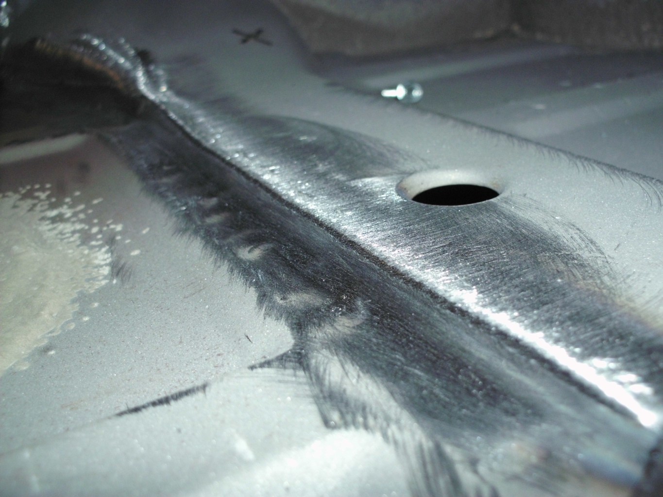

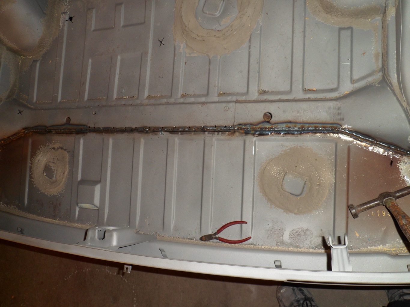

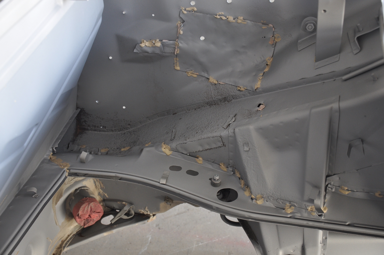

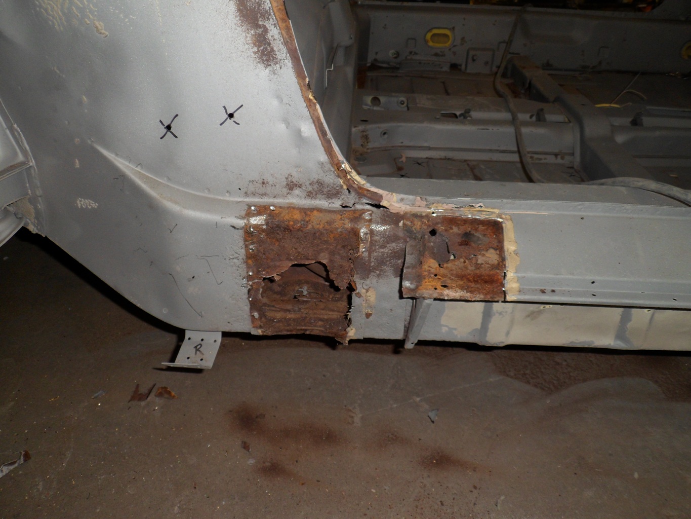

The rear section is now part of the car and look what was under the sill repair (IMG:style_emoticons/default/sad.gif)
lots planned for the long weekend (IMG:style_emoticons/default/smash.gif)

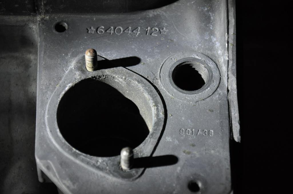

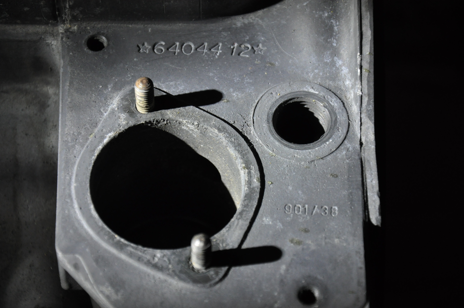

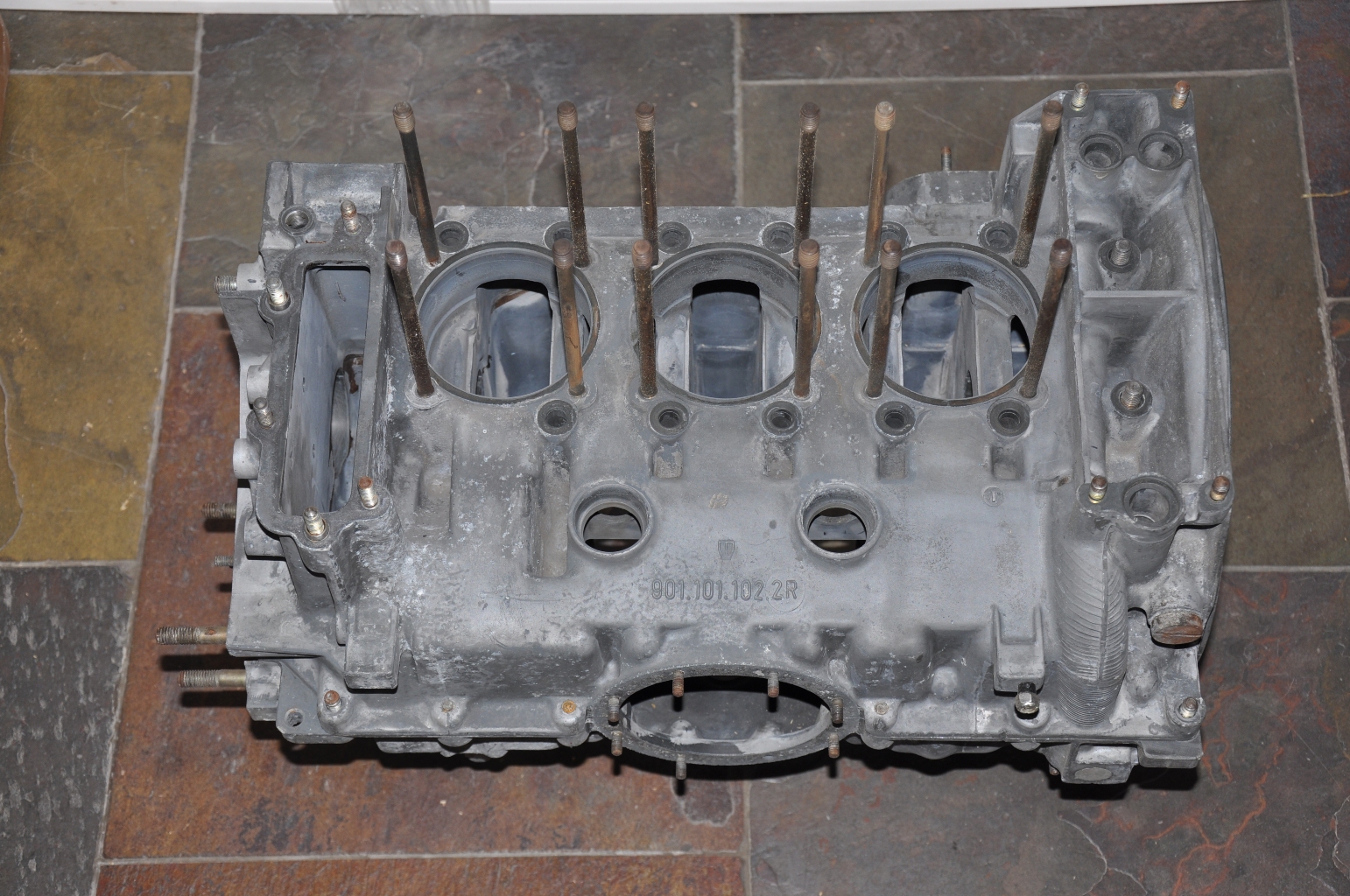

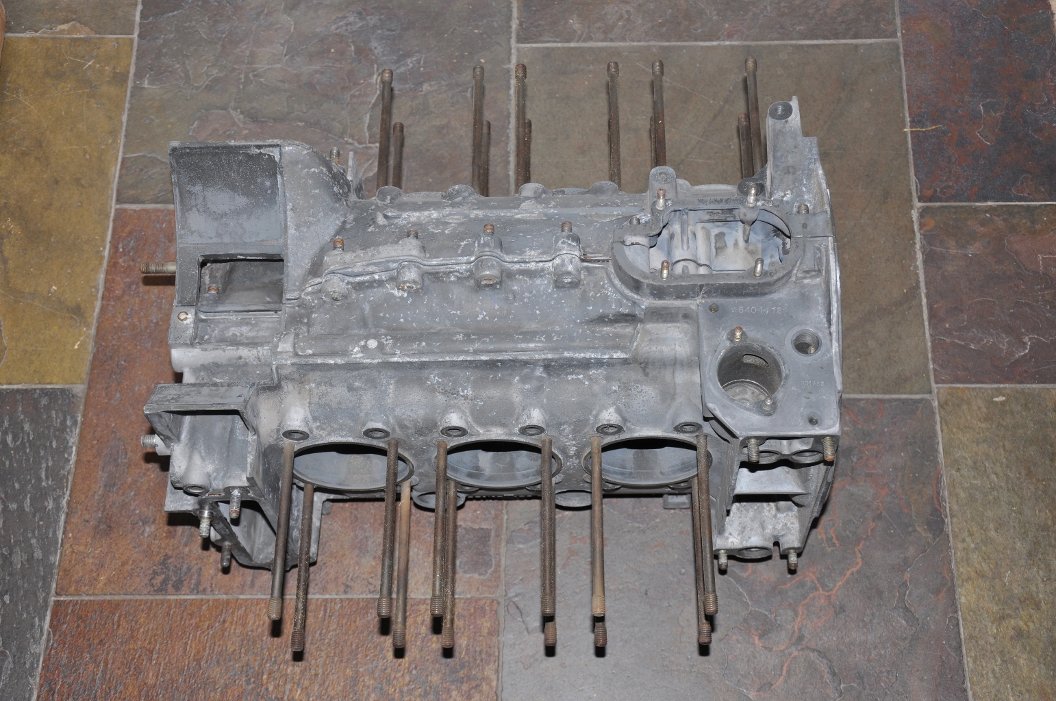

well it's finally here, one number off from my COA. I at least have a period correct case and the parts to put a correct -6 engine together (IMG:style_emoticons/default/biggrin.gif)
finding one so close to what is said to be in the car from the factory is amazing alone I think

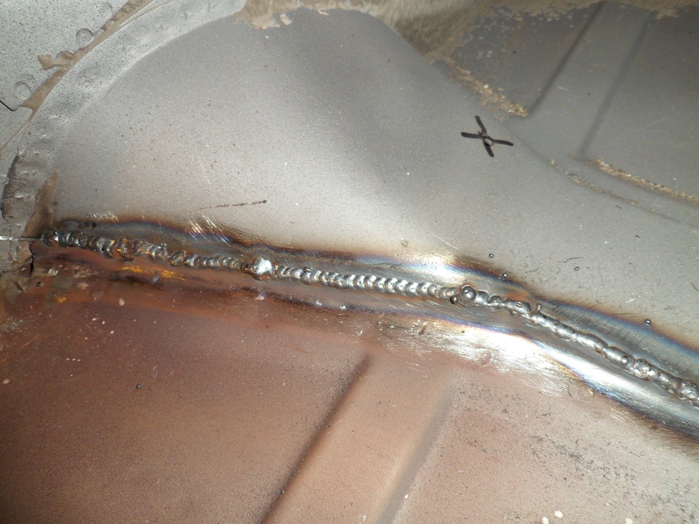

Nice welding !

Thats my buddy's welding skills, Yes I could have done it but it would have been alot more grinding on cleanup or a hole or two to fix.

That's Cool (IMG:style_emoticons/default/biggrin.gif) . CoA's can be wrong on these Numbers. My CoA said 4418 ( not far off from you), but the car came with 4444. There was no reason or record of changing it.
I wish I had kept that Un-number'd 914-6 Case I had a few years back. At least I know it went into a Real -6
QUOTE(Socalandy @ Nov 23 2011, 09:53 PM) *

I know a guy that has two unstamped Mag cases but he's not great at following thru so I went this route. He refered to them as replacement cases.

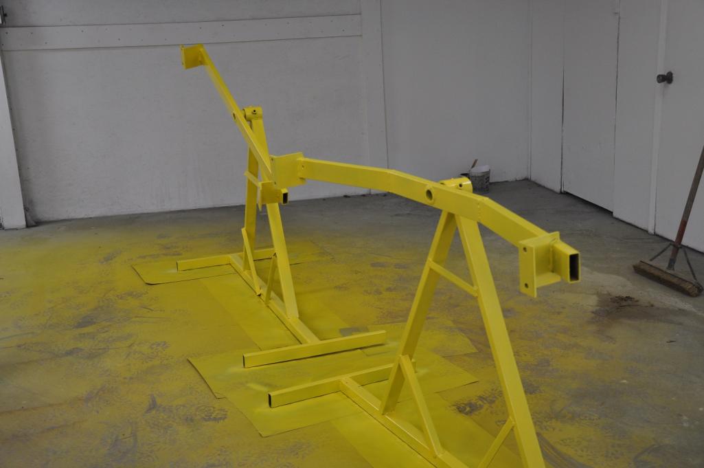

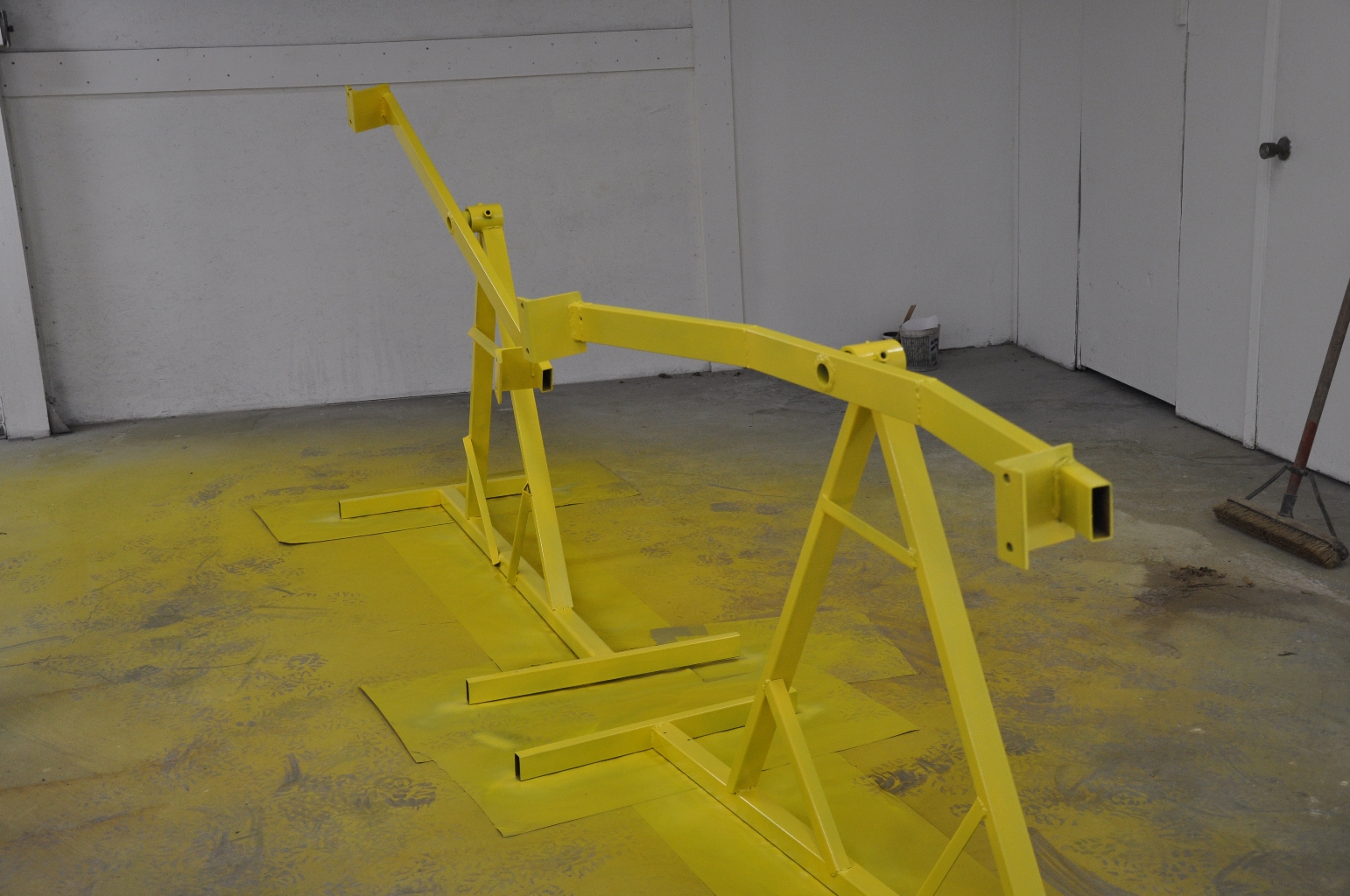

Back at it today, In order to keep cross contamination from the rotiss. to the car a little cleanup was needed.
Yellow for safety of course. You did'nt specify color Joe (IMG:style_emoticons/default/smile.gif)

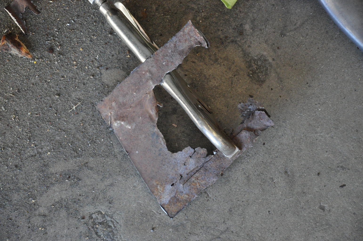

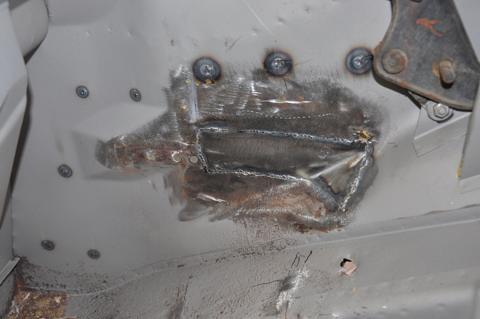

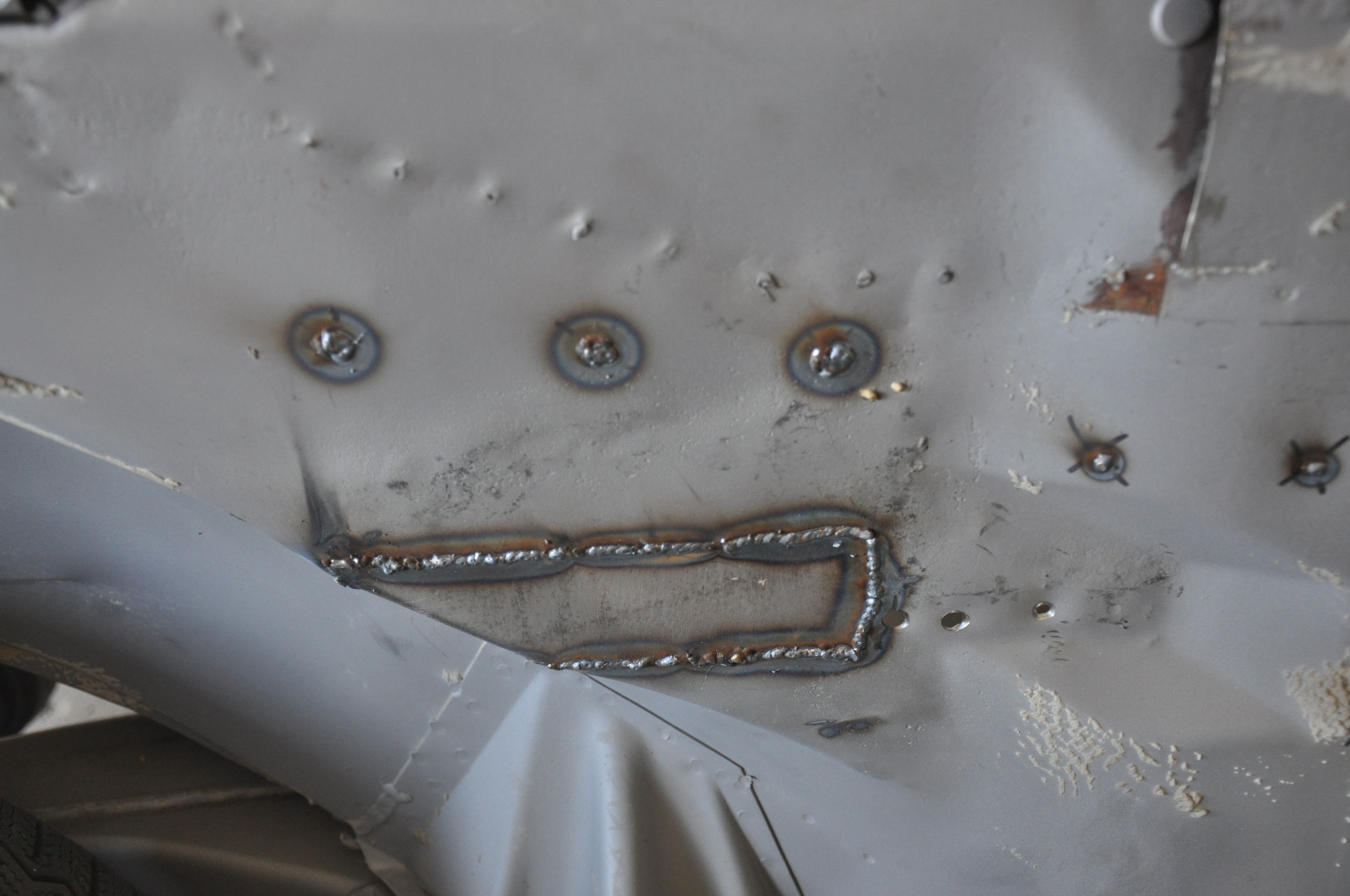

battery area patch work (IMG:style_emoticons/default/welder.gif)

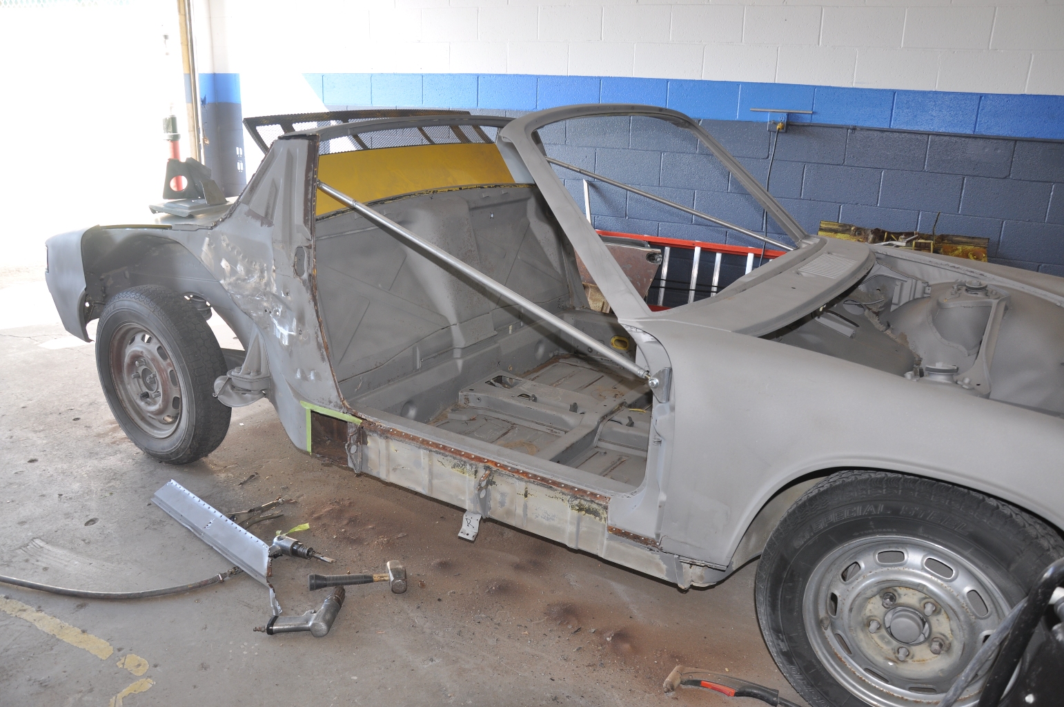

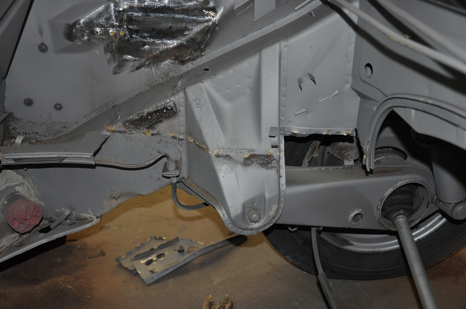

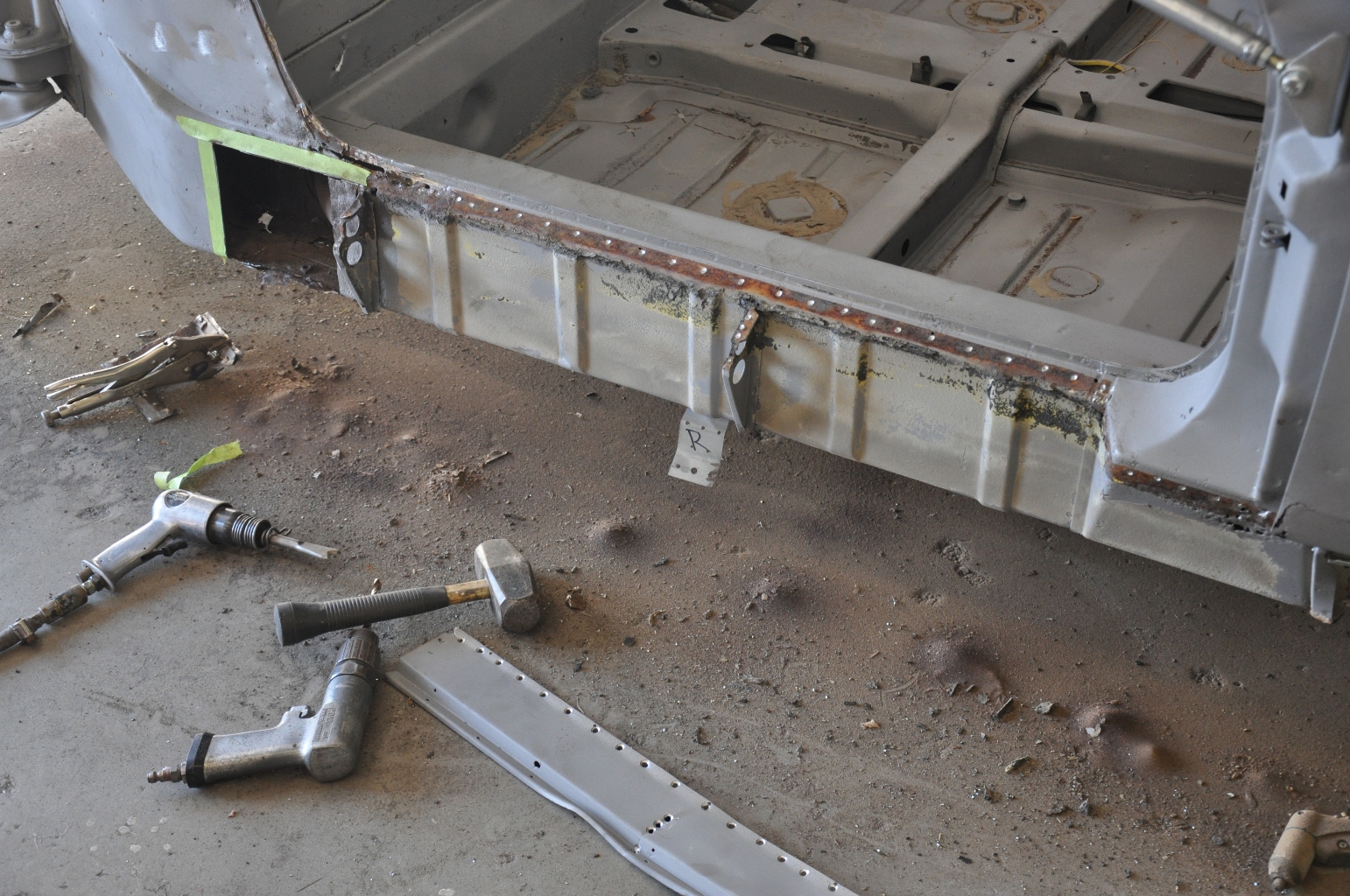

some more sill probing and removal

hope to get some more done tomorrow, I did pull the trigger on the NOS outer long and sill so waiting on that and more exploring before I place another order with Restoration Design

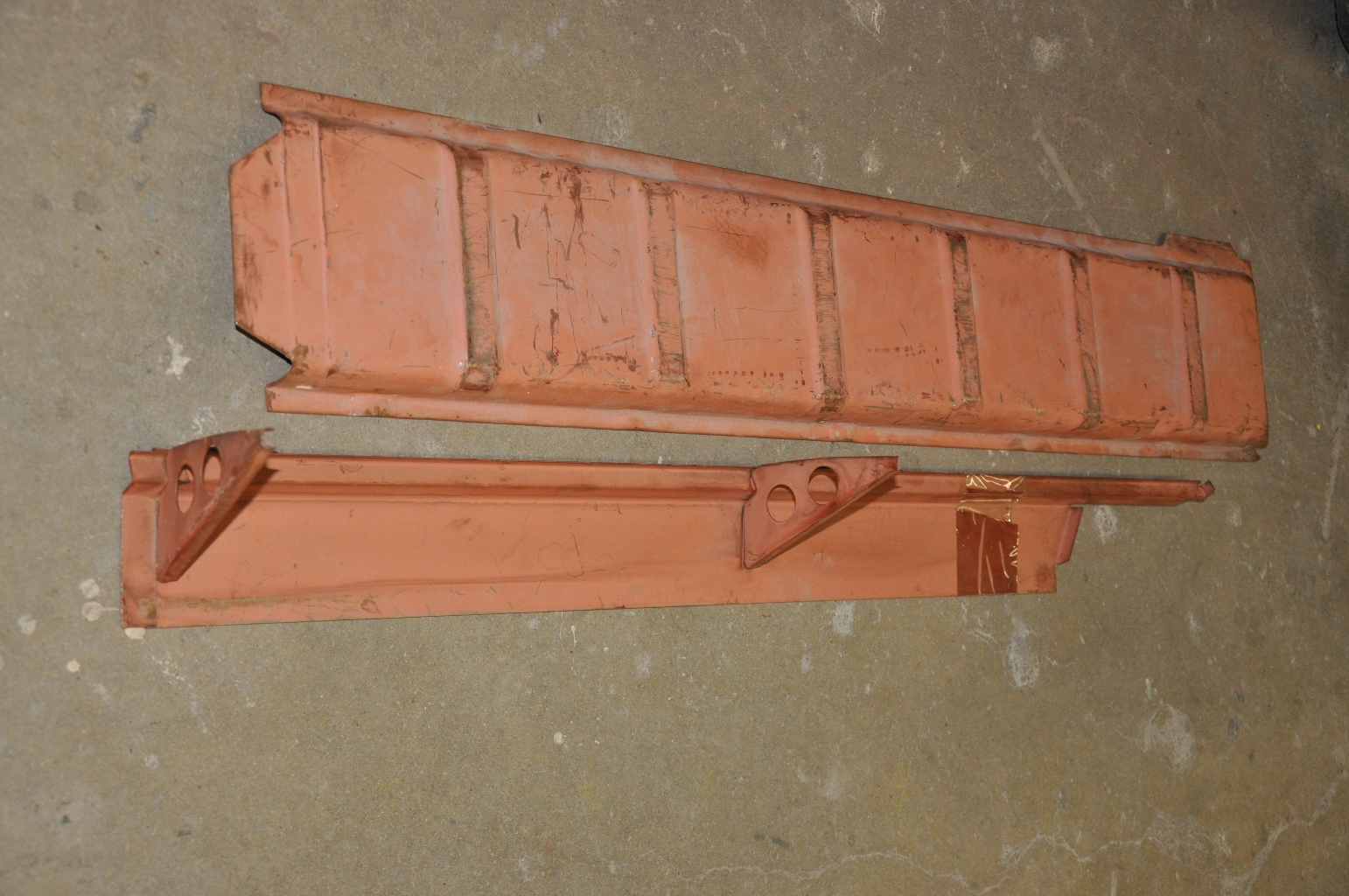

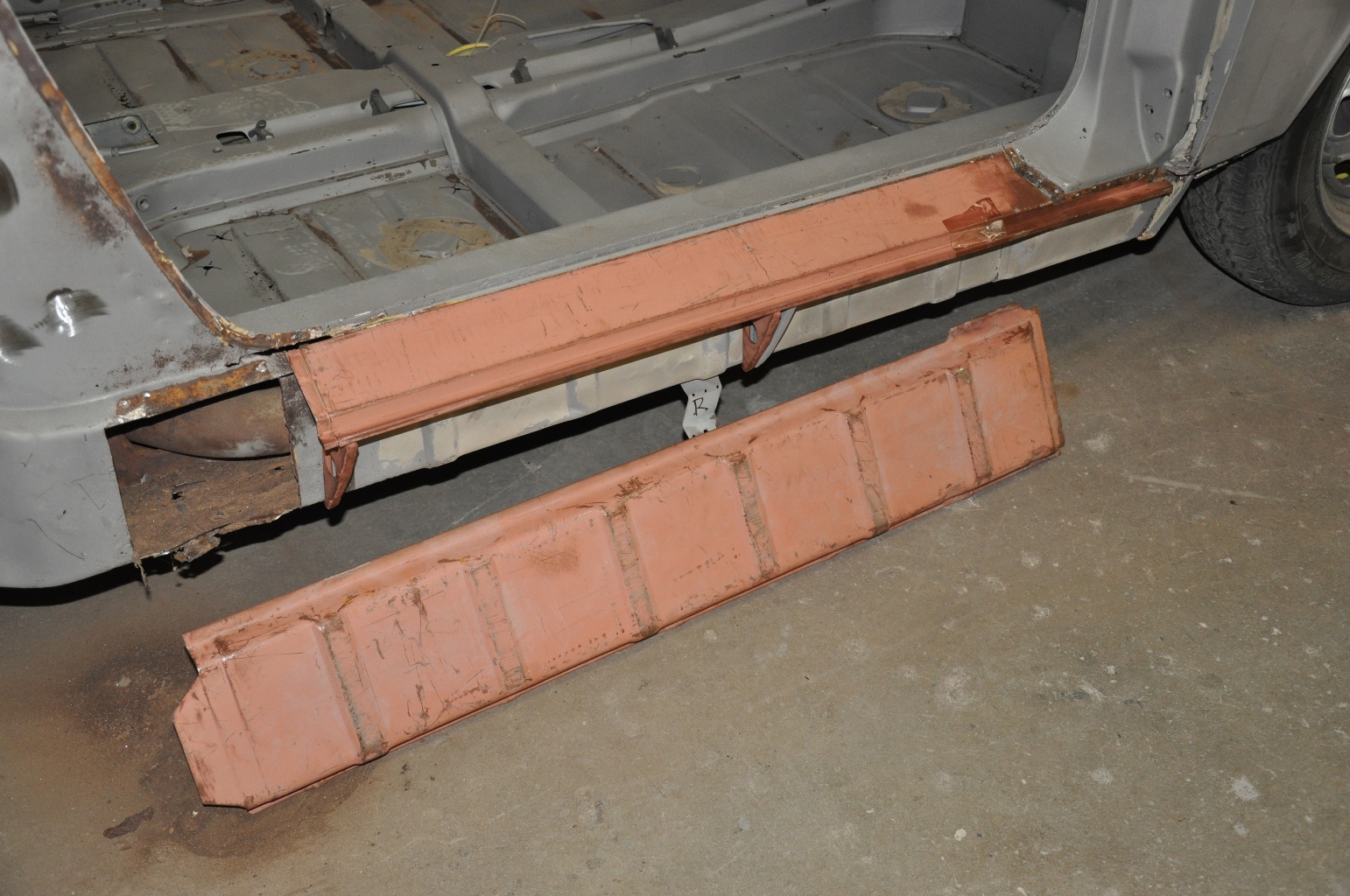

the sill and rocker came in today and the Engman kit and looks (IMG:style_emoticons/default/drooley.gif)

the passenger side engine ledge was poorly fixed and braised in so it will be replaced

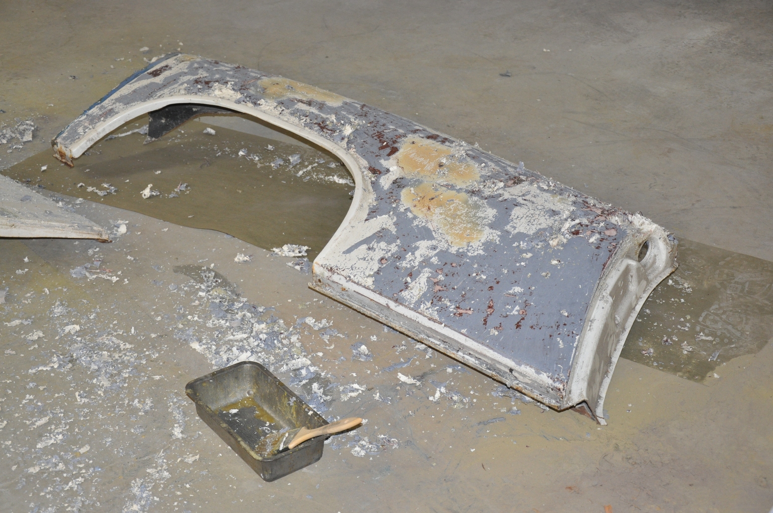

striping the donor parts (IMG:style_emoticons/default/stromberg.gif)
