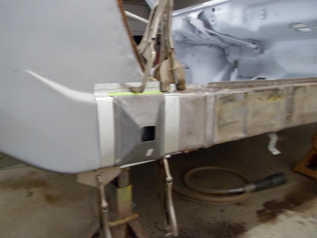

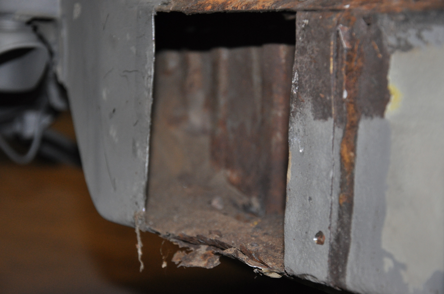

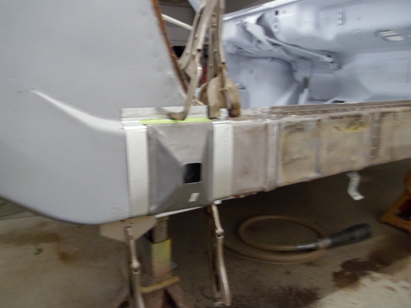

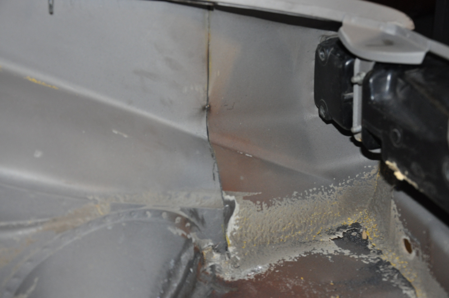

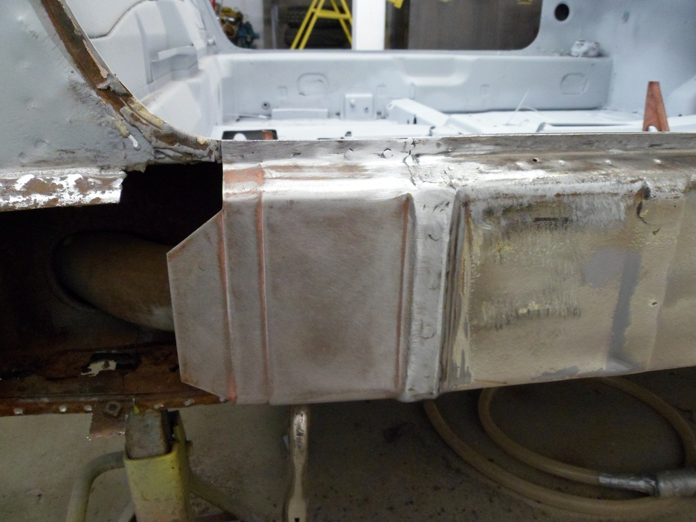

the drivers side jack point was not as bad as the pass. side and a shot inside. Just arond the jack point and solid either side (IMG:style_emoticons/default/pray.gif)

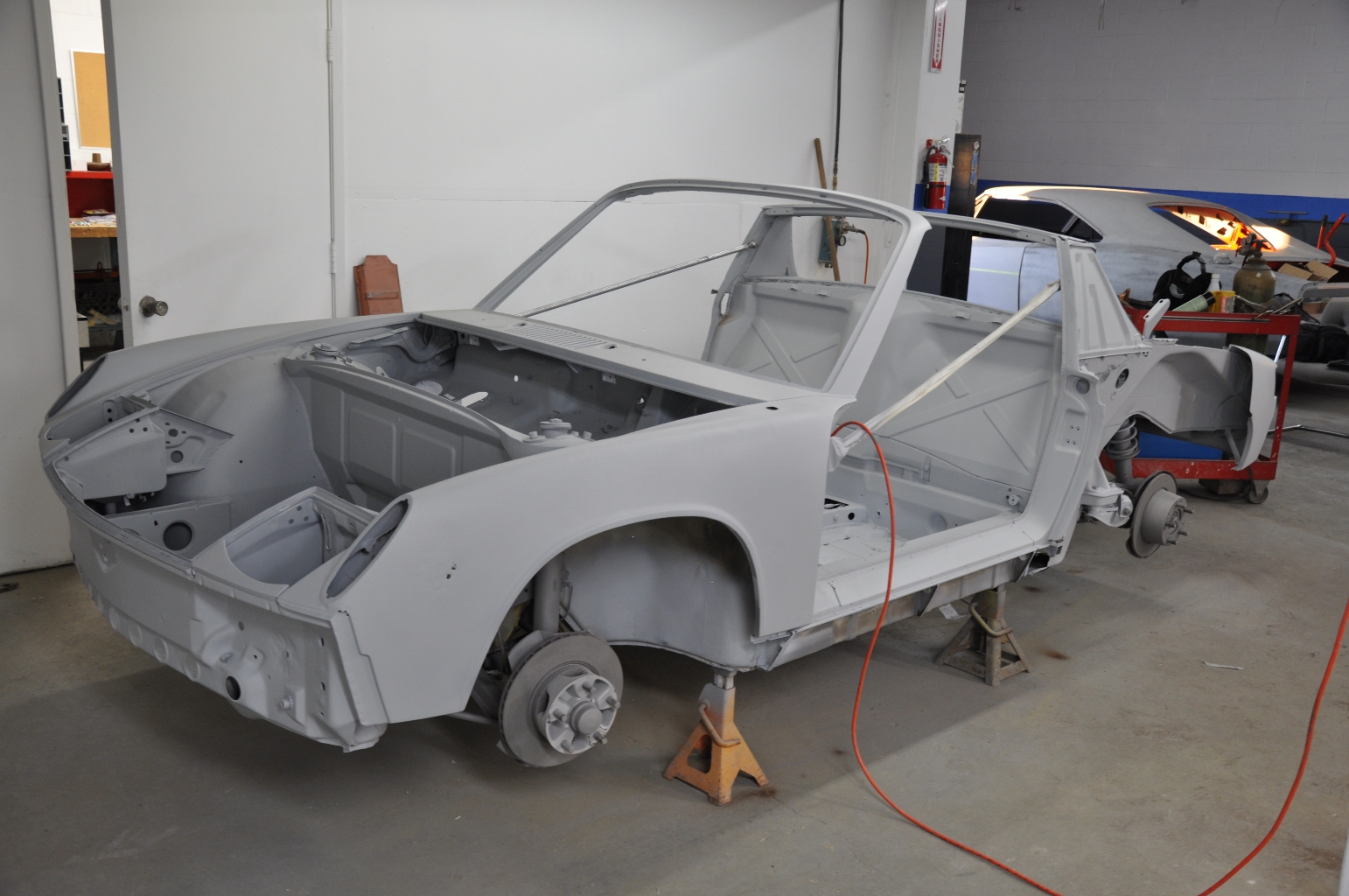

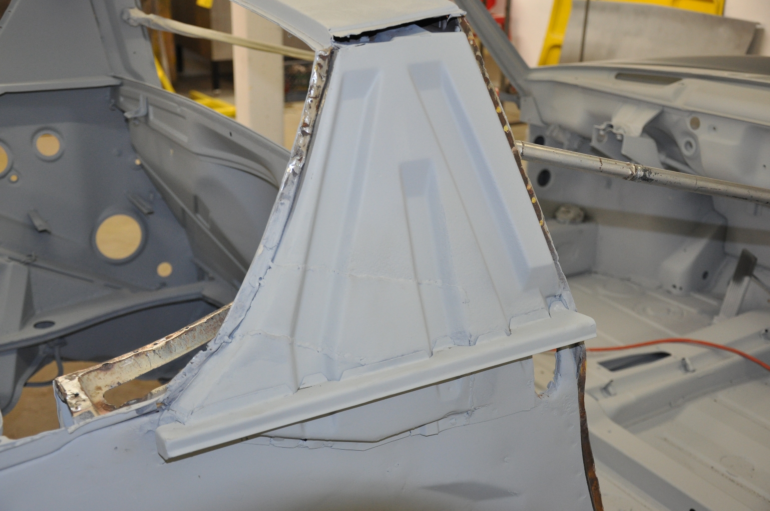

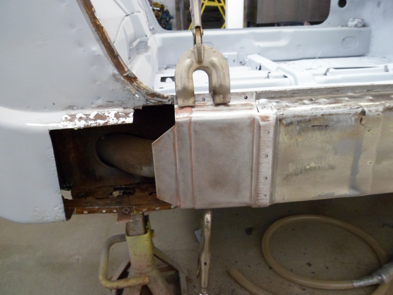

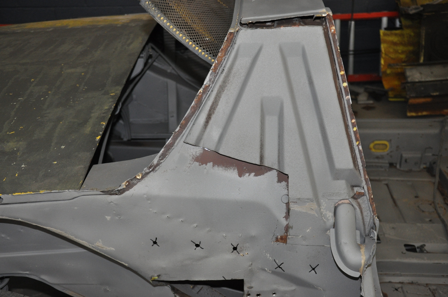

waiting for the rear quarters before finishing the (IMG:style_emoticons/default/welder.gif) but lineing up nicely. Alot of progress for a holiday weekend and some more tomorrow. I'm really enjoying this resto and inching closer to driving my dream car!!

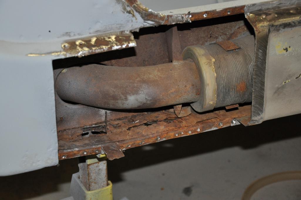

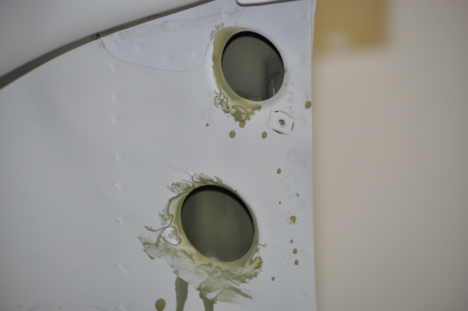

So with the longs open.... what have you used to treat and convert the surface rust inside of the longs?
I want to seal things up before closing up and keep it from rusting from the inside out especially since I will be running heat. I prefer a product that hardens/ dries completely to make welding up easier and strong.
thanks in advance!!

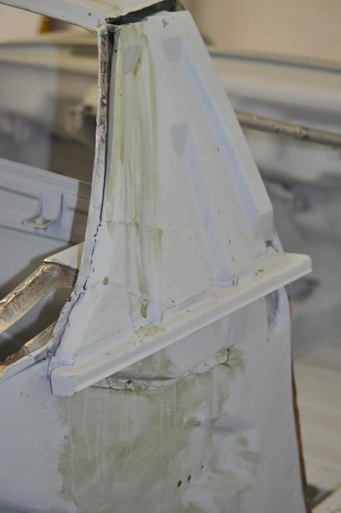

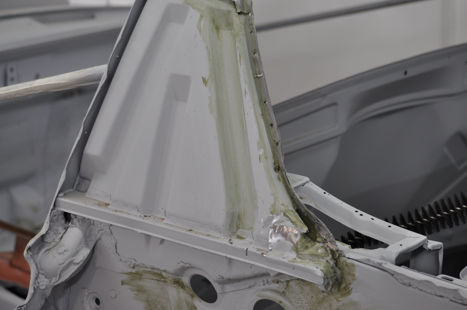

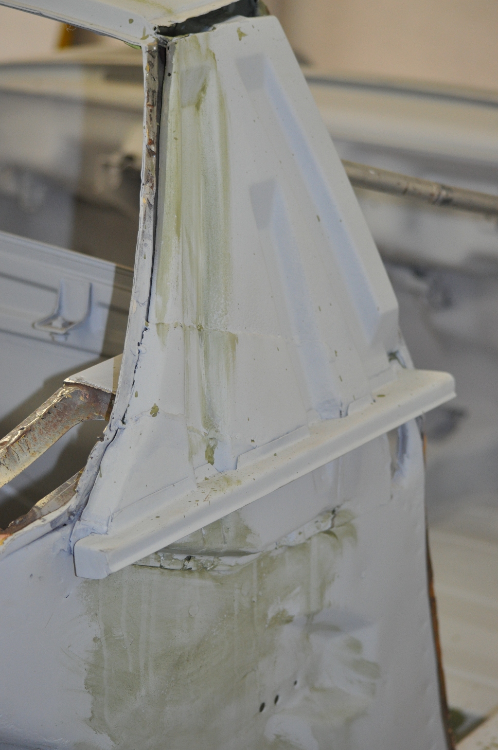

putting the sail under structure back together, glad I had a few parts cars
We need a new smilie name sparky that is using a grinder (IMG:style_emoticons/default/biggrin.gif)

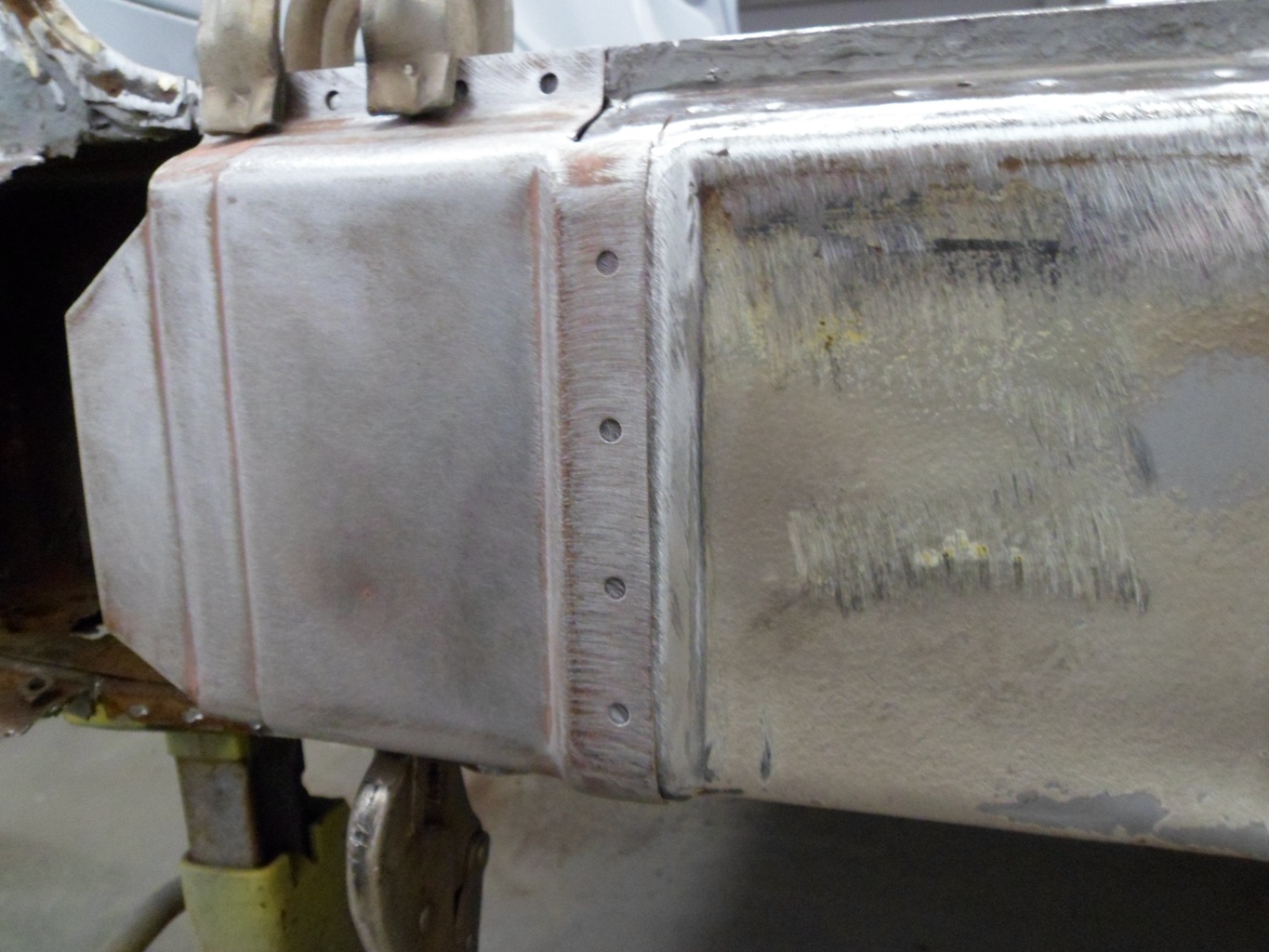

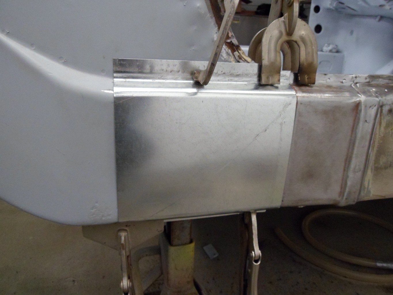

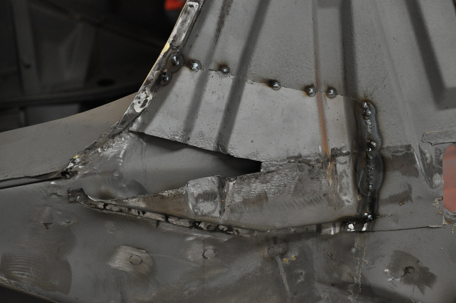

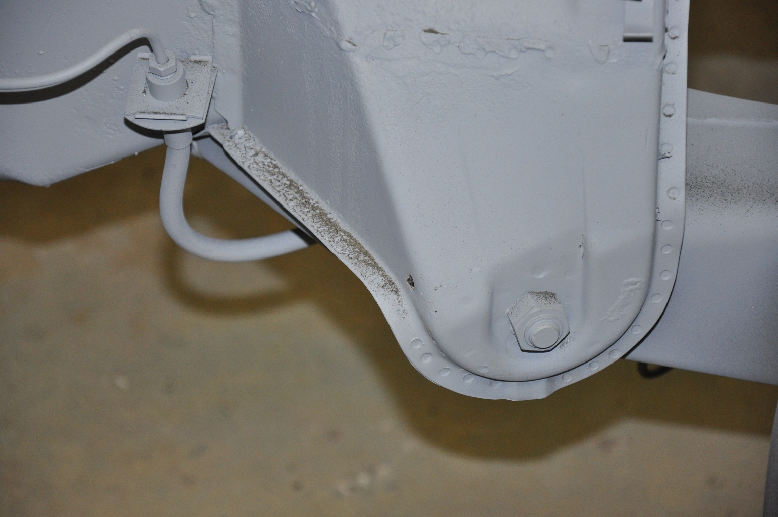

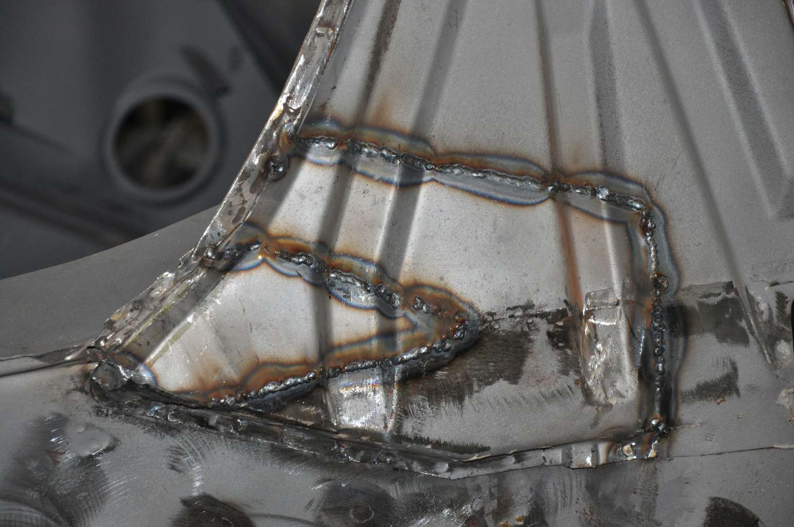

(IMG:style_emoticons/default/welder.gif) more after work progress. the drivers side will be a bit easier

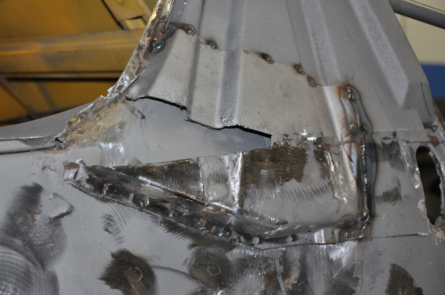

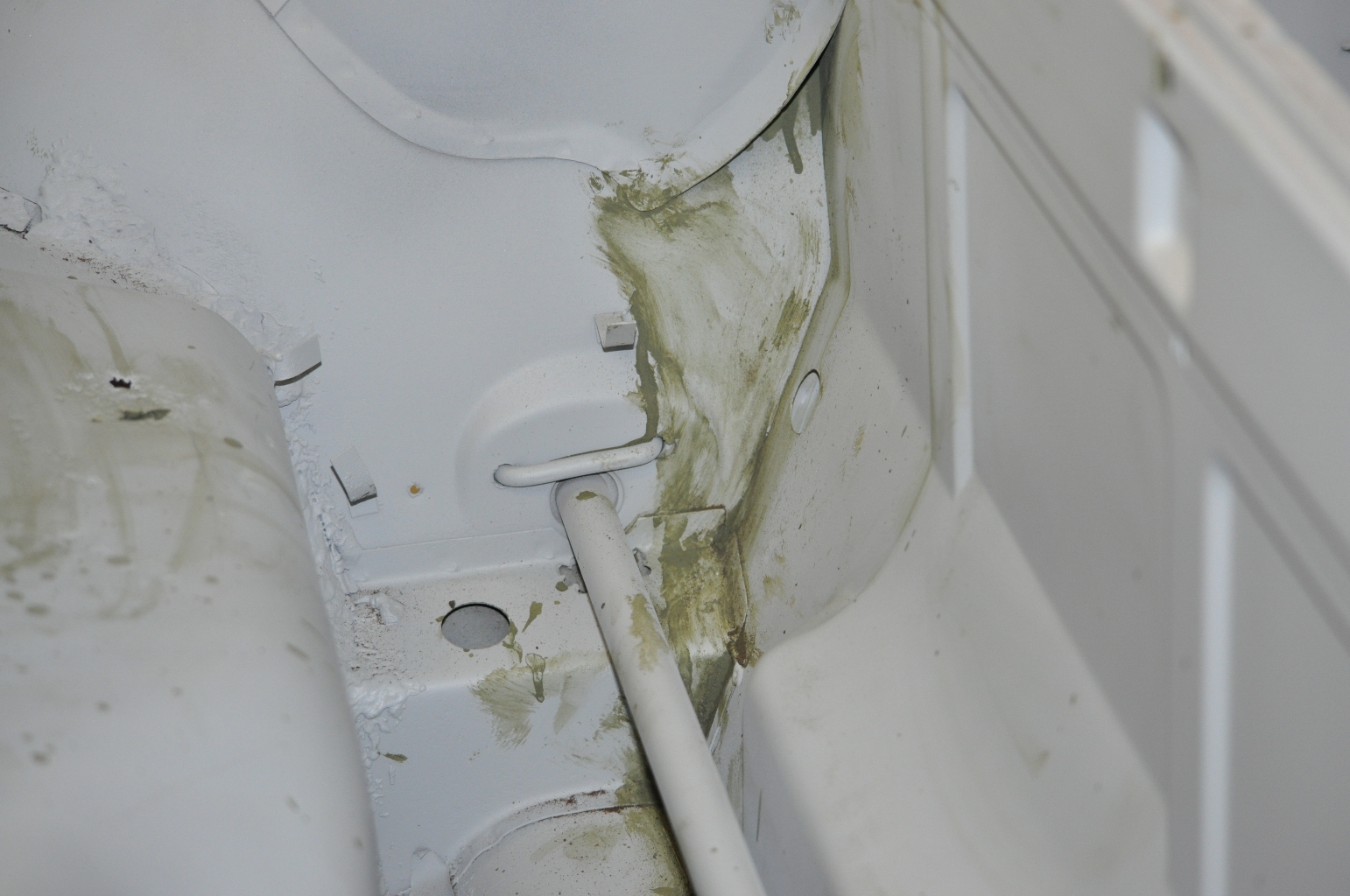

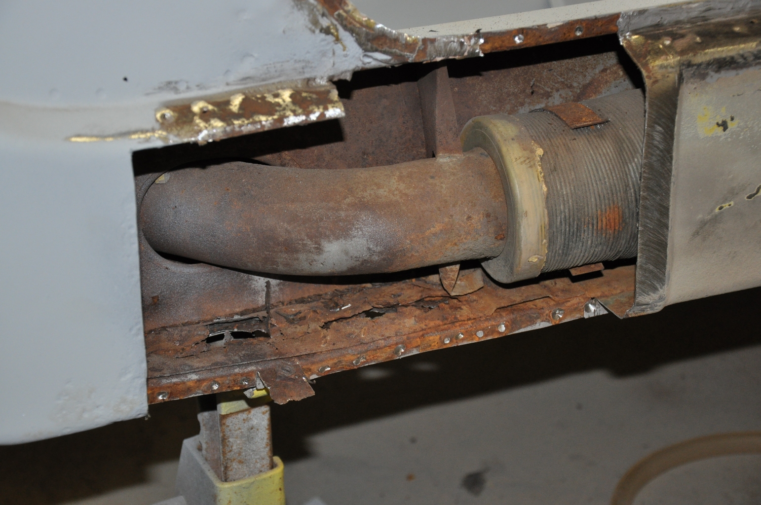

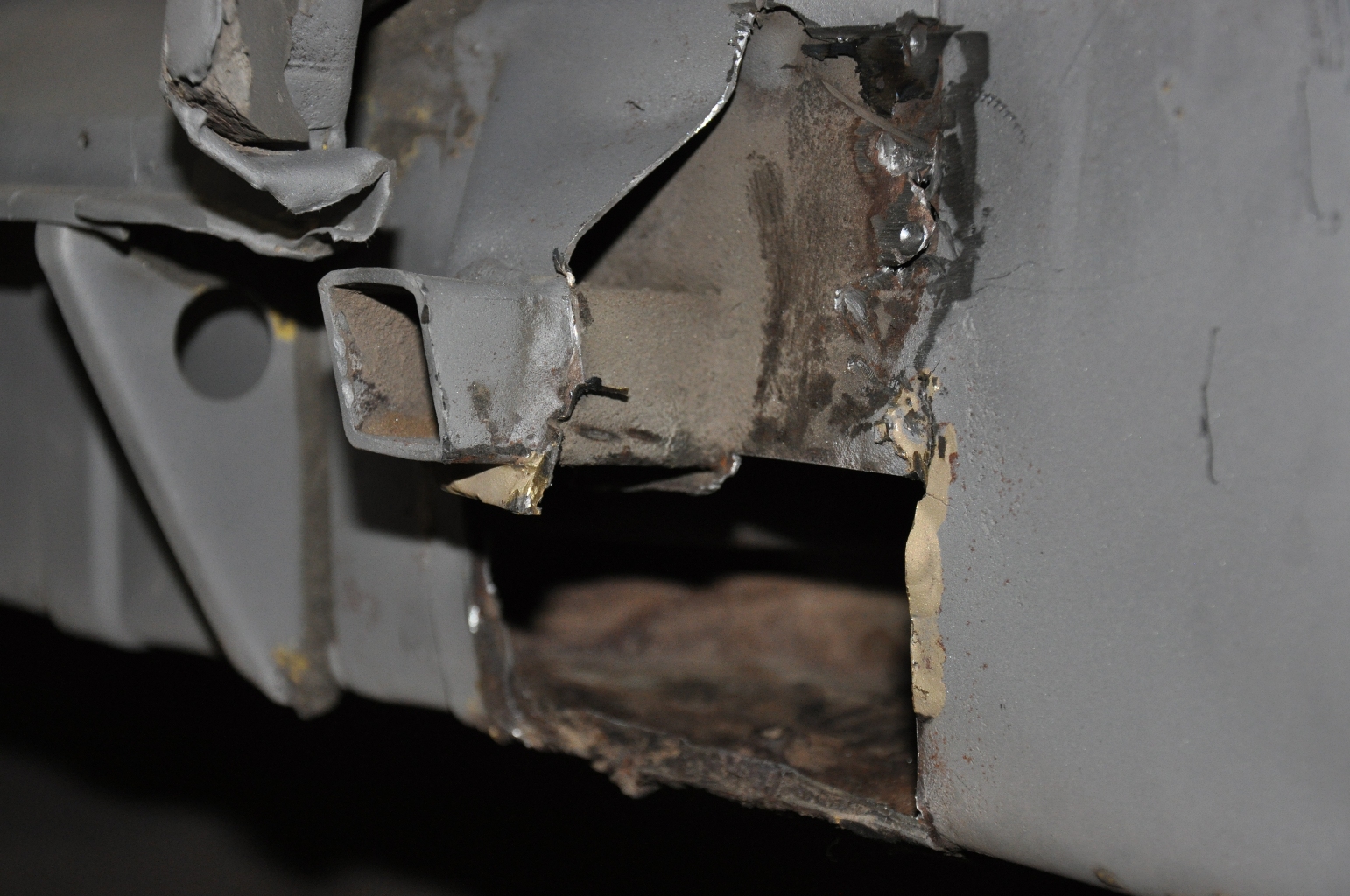

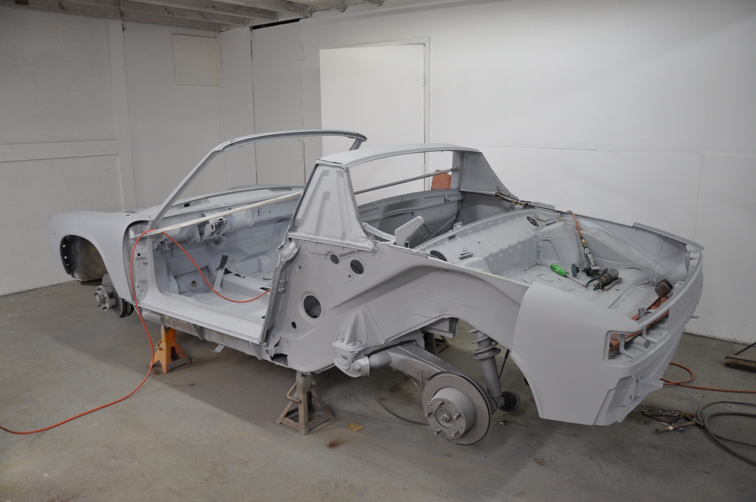

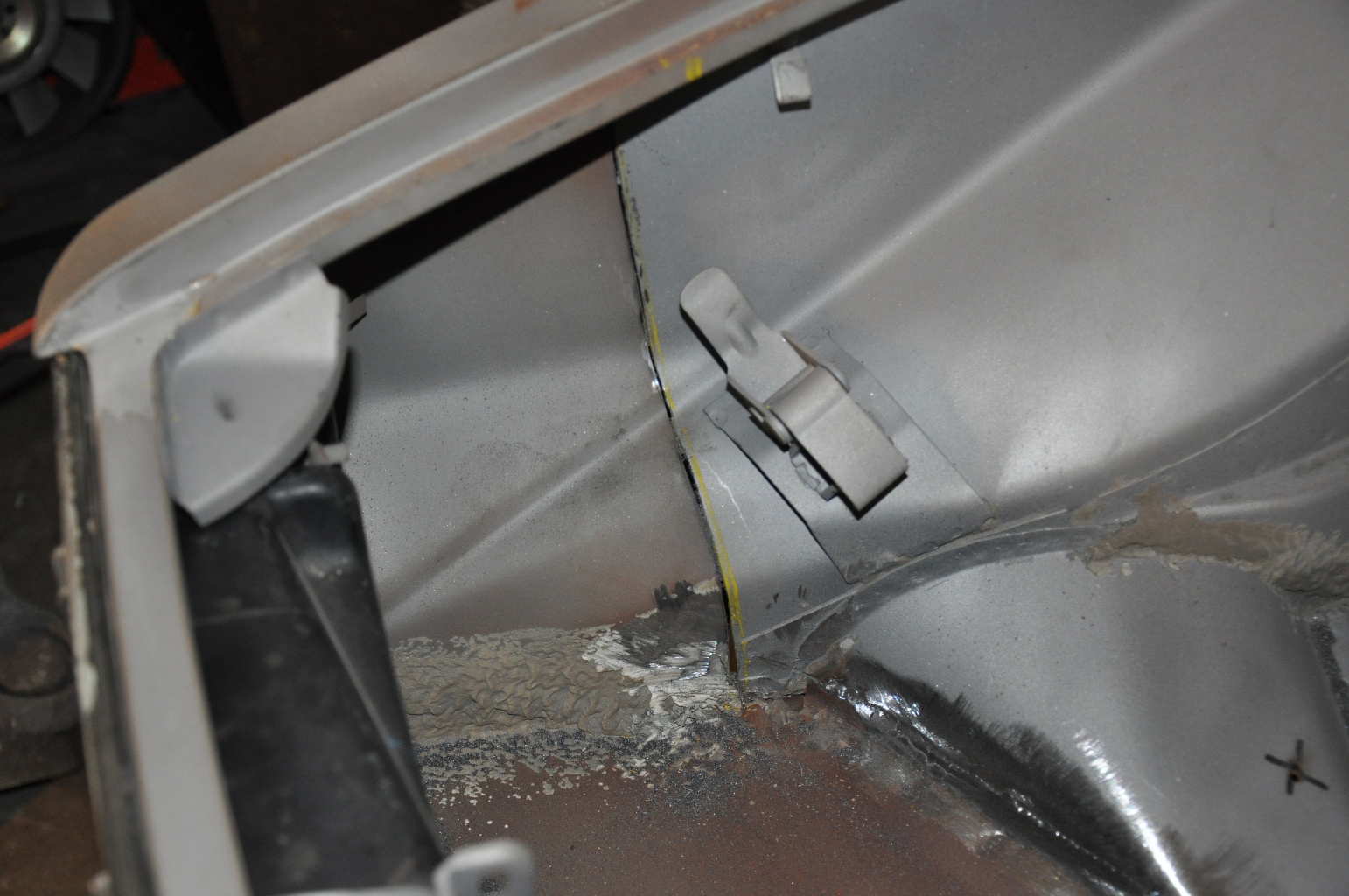

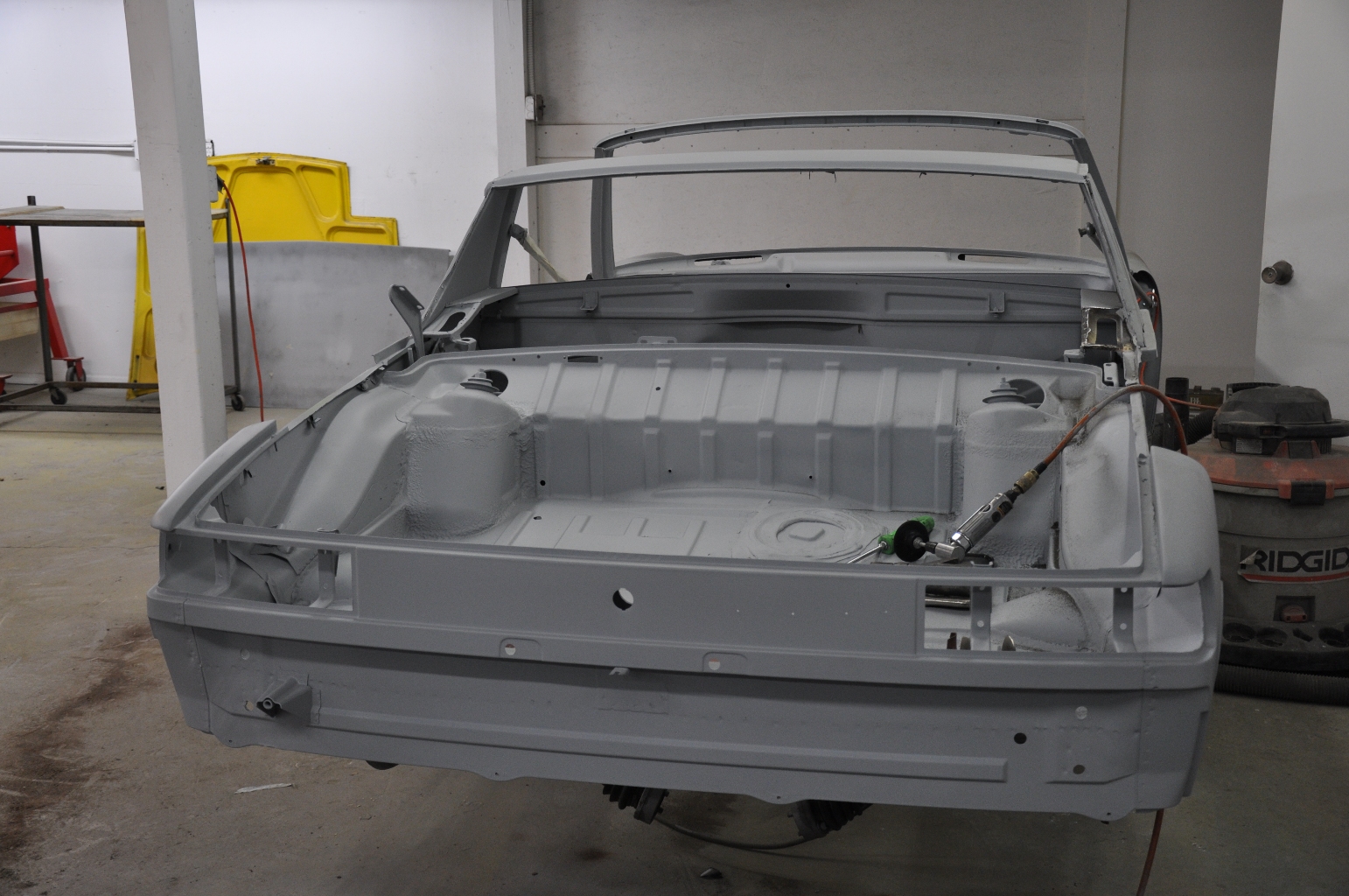

The car has now been sealed but in the process it exposed a few small holes (IMG:style_emoticons/default/blink.gif) the console on the pass. side has one on top and a bunch on the bottom so it will get replaced.
That means the pass. engine tray will have to wait. it will be interesting to see how bad it is behind the mount

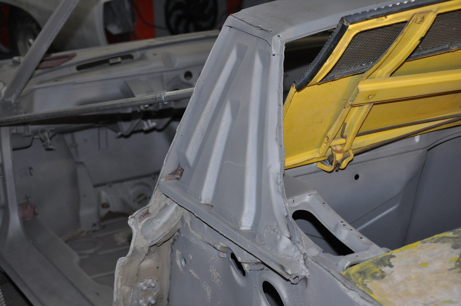

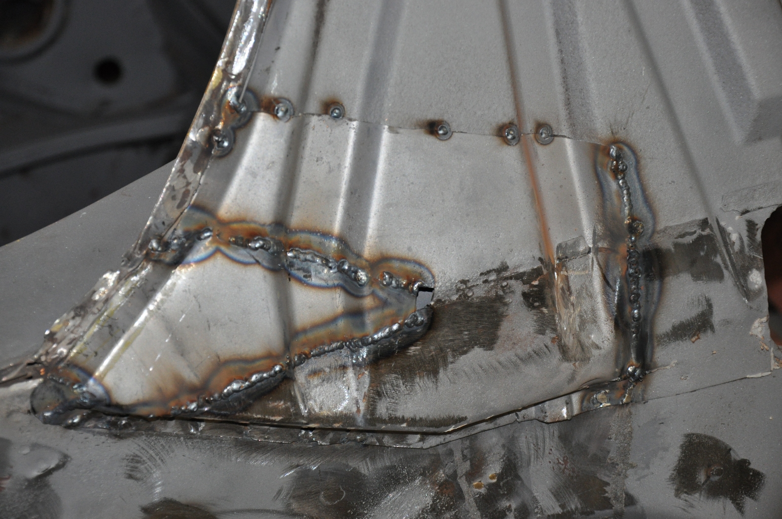

bottom edge for the sail area was made since the break is in the shop. A liitle more grinding to flush the welds up

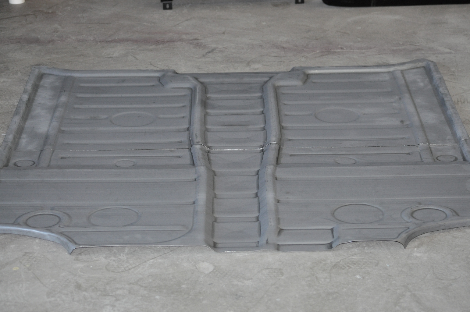

And with all the dents and a PO that jacked the car up from the floor pans I think they will go as well. It will be alot of work to get them right and be easier and cheper to just replace. (IMG:style_emoticons/default/sawzall-smiley.gif) (IMG:style_emoticons/default/welder.gif)

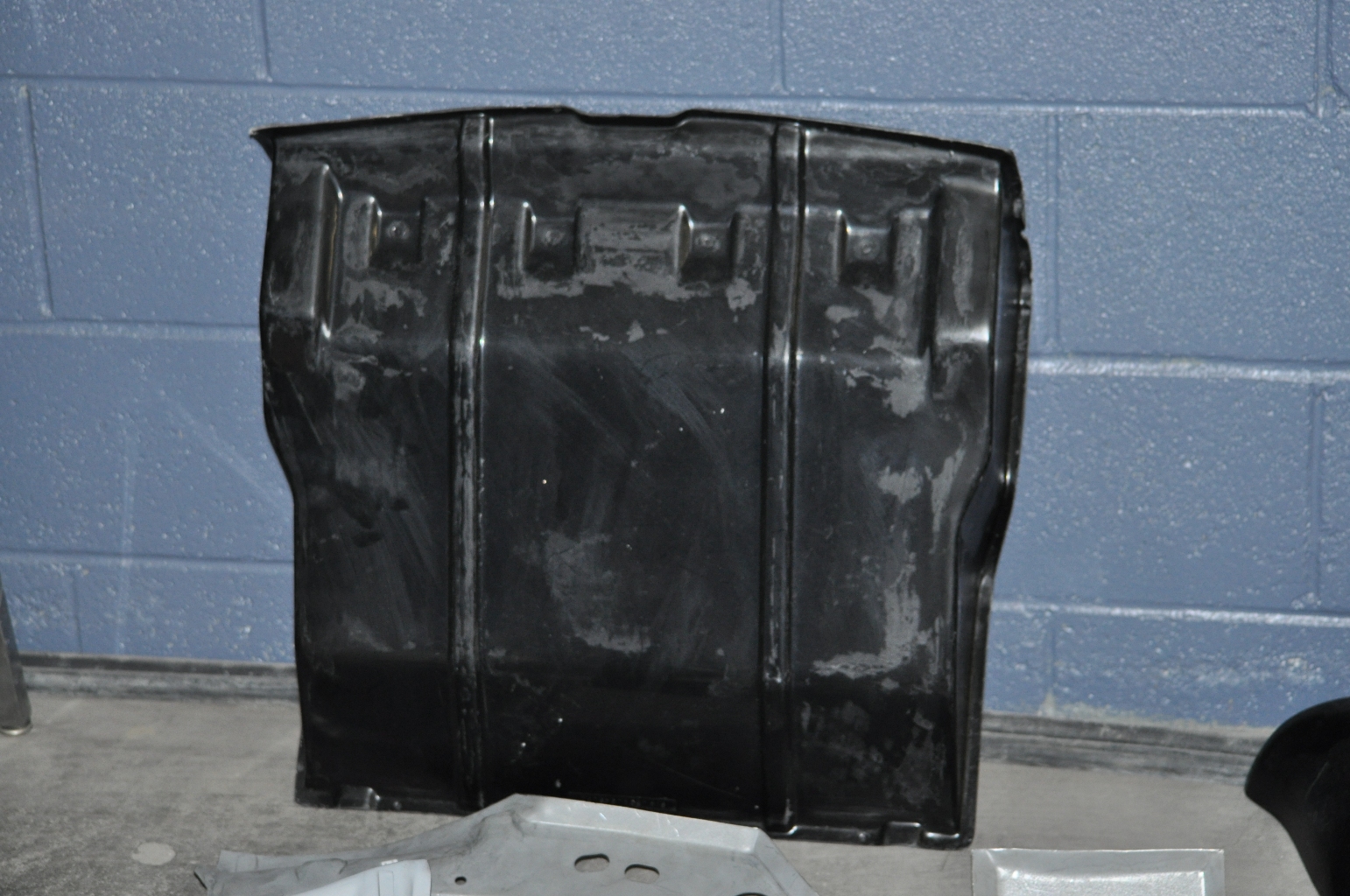

Please post pics of the inside of your console when you remove it. I bet it is nice and crusty.

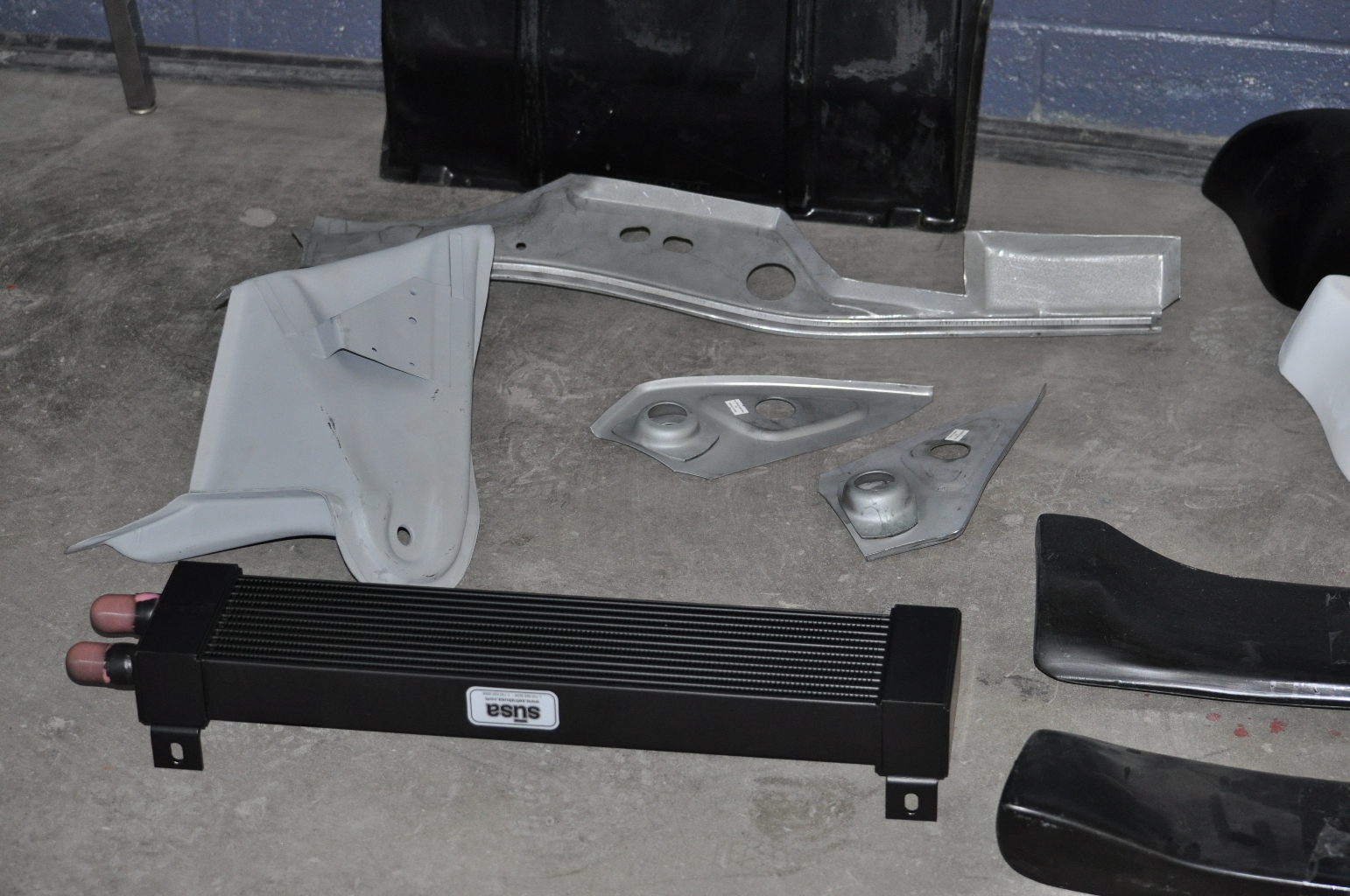

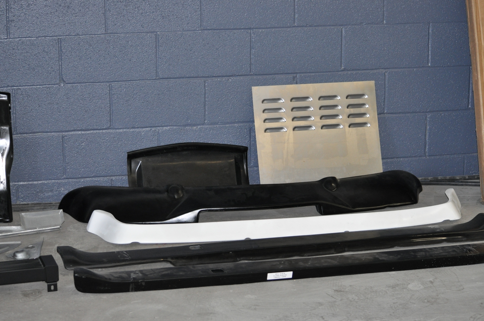

The suspension floor pans and console are on order but I will get lots of pics of the removal and the inside to show its condition.
More work on the longs and prep for the jack point. waiting for Eastwoods frame rust converter and sealer before it all goes back together.

this last picture sucks but shows what the final parts will look like finished, now for the bottom of the long and treat inside before final (IMG:style_emoticons/default/welder.gif)

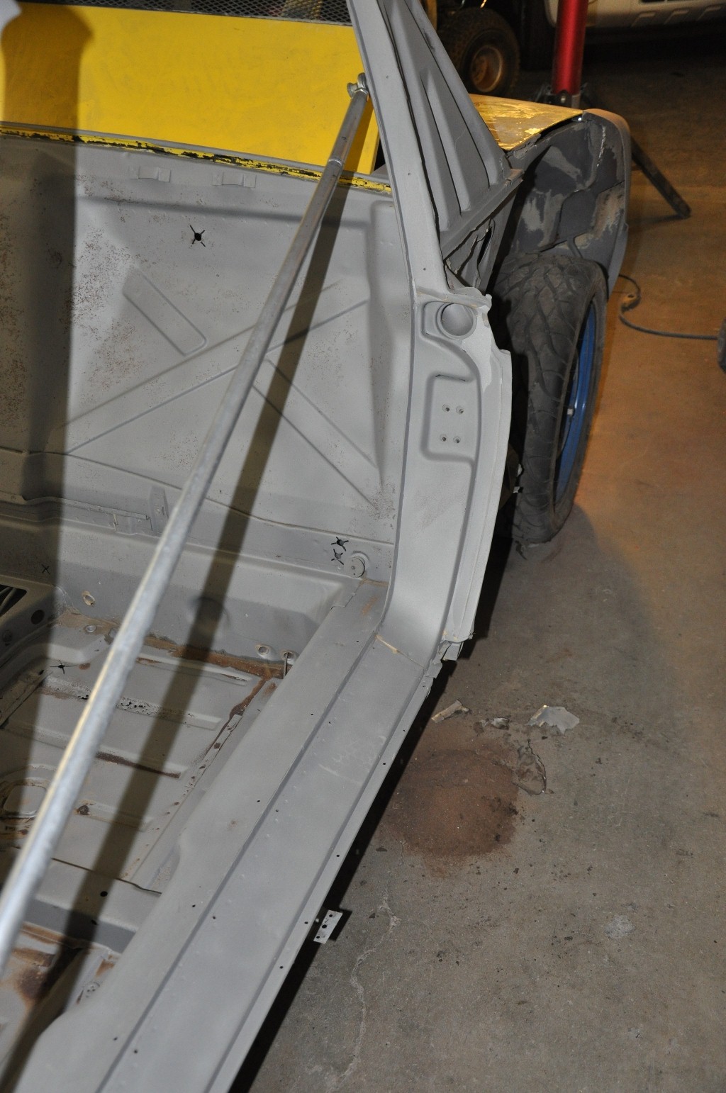

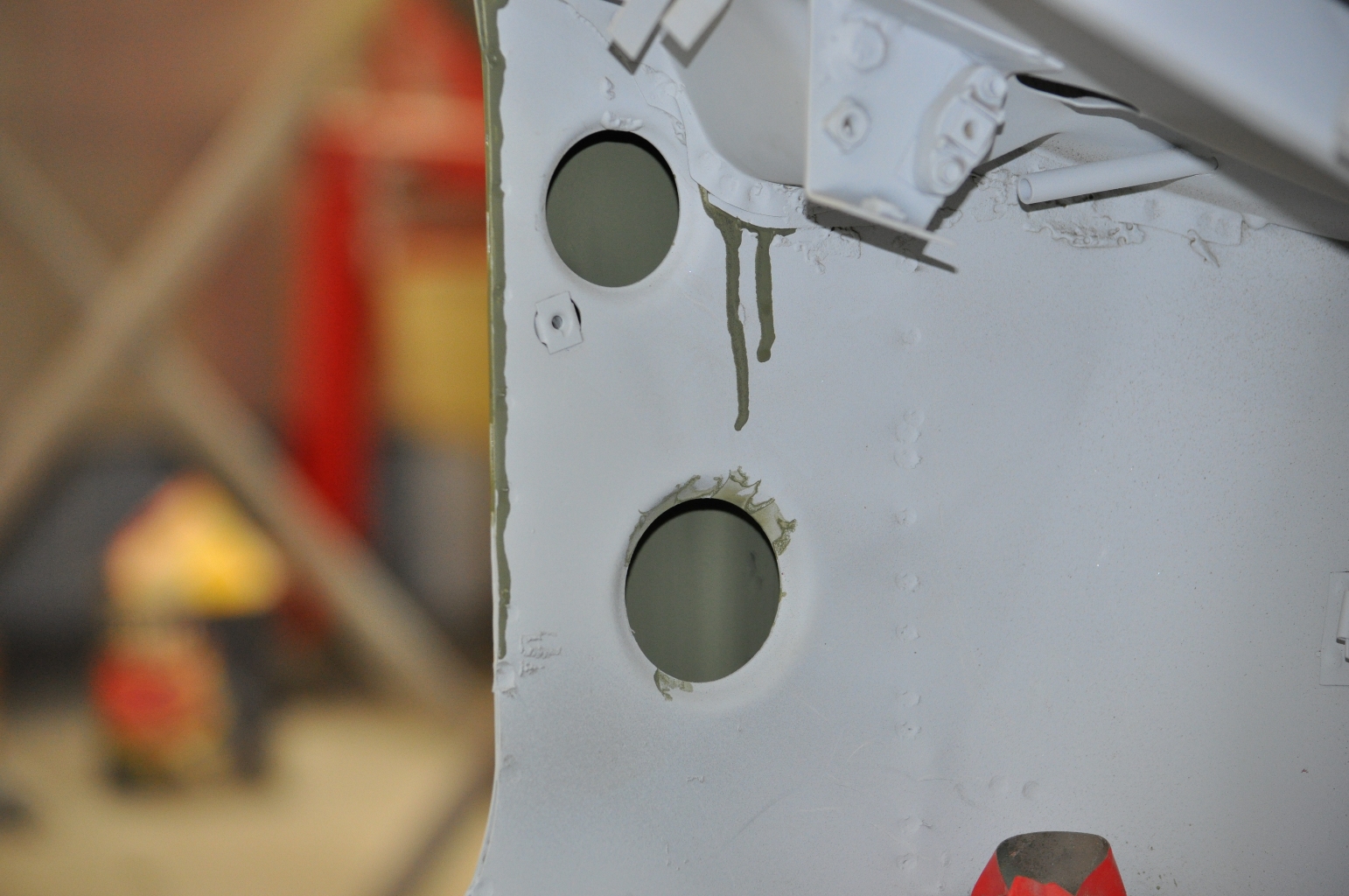

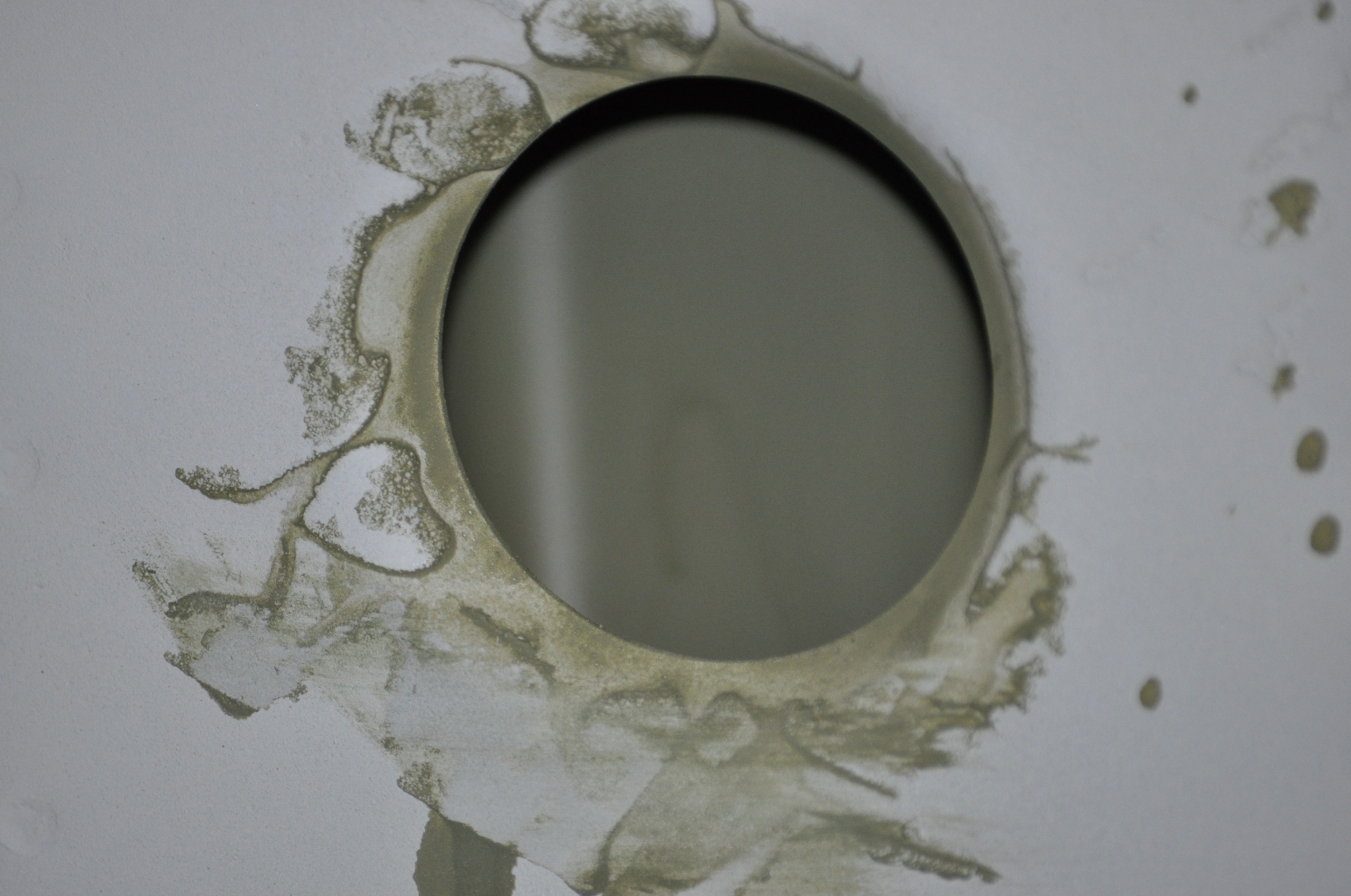

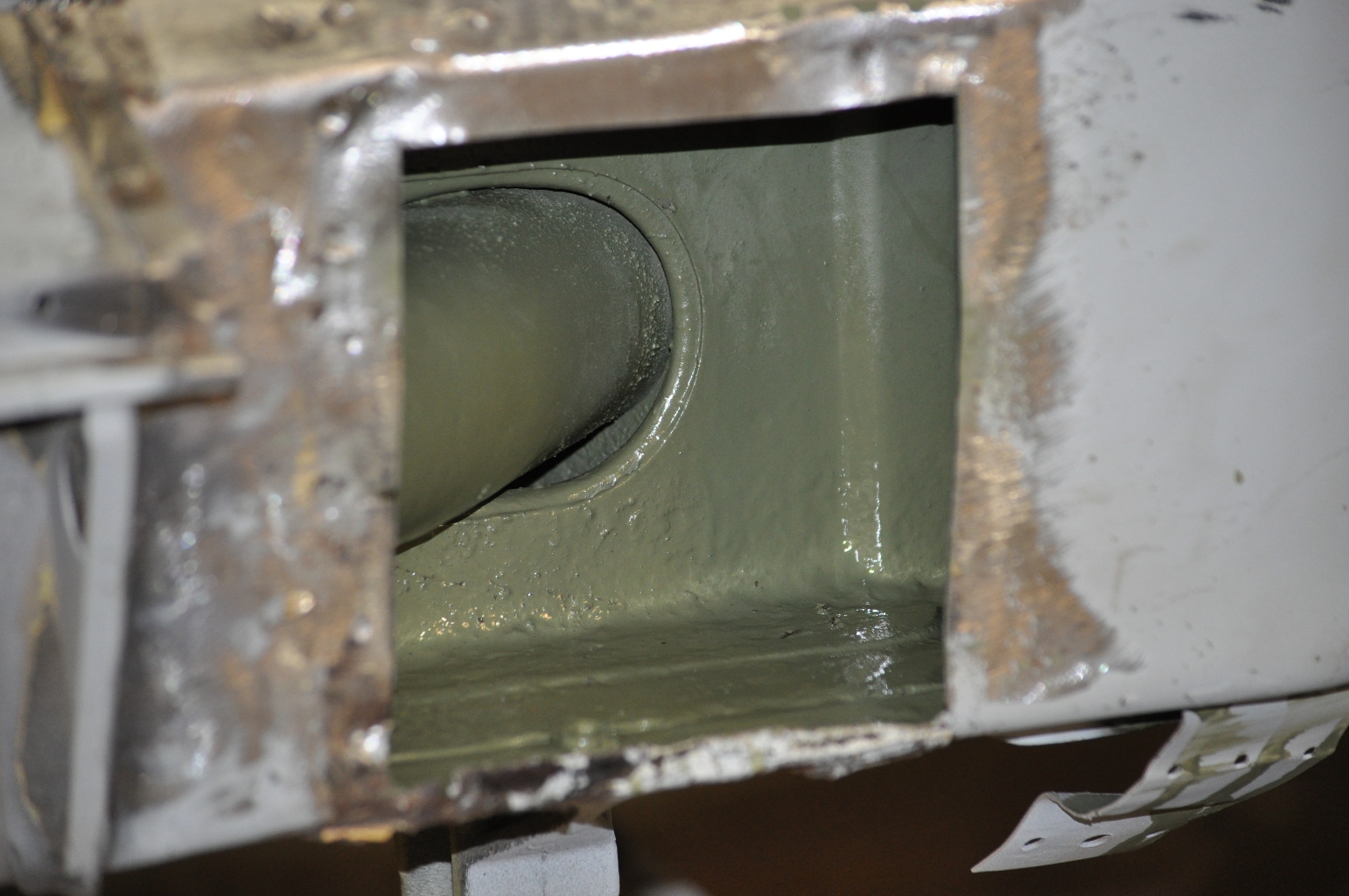

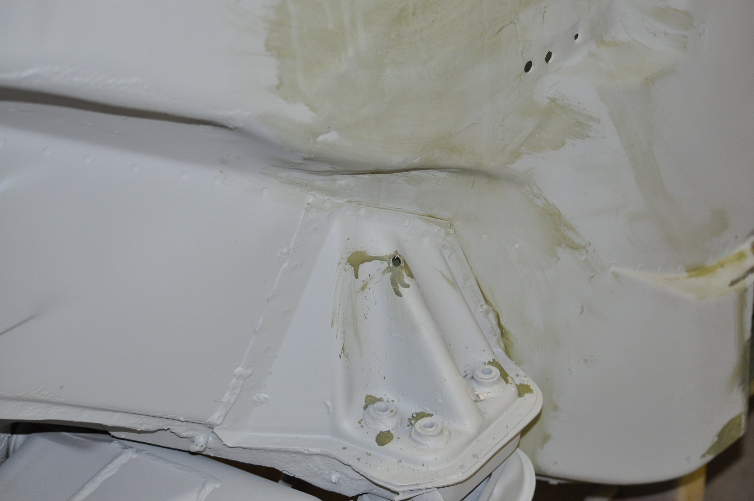

So back at it today and lots of goodies arrived. Spent several hours with the air hose and vacume getting out left over media from blasting and preping the longs for the Eastwood rust converter/sealer. It really flows well and the fine spray nozzle gives a nice 360 deg. fog.
Stop the rust in its tracks!!!
Socalandy
post Dec 18 2011, 08:45 PM
Post #239
Its got to be Yellow!!!
Posts: 2,432
Joined: 29-August 09
From: Orange
Member No.: 10,742
the green stuff is the eastwood converter that ran out and got wiped off, it covered way better than expected and flows into every little creveice. We drilled a few holes to treat enclosed areas. This cars internal areas are sealed (IMG:style_emoticons/default/aktion035.gif)
