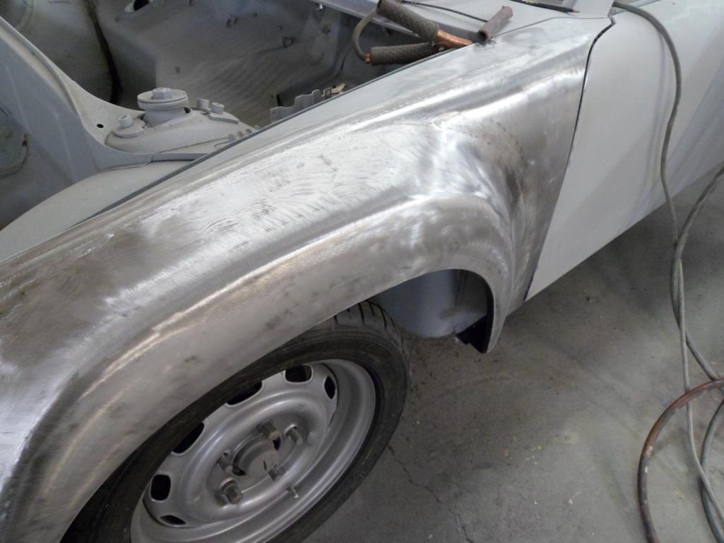

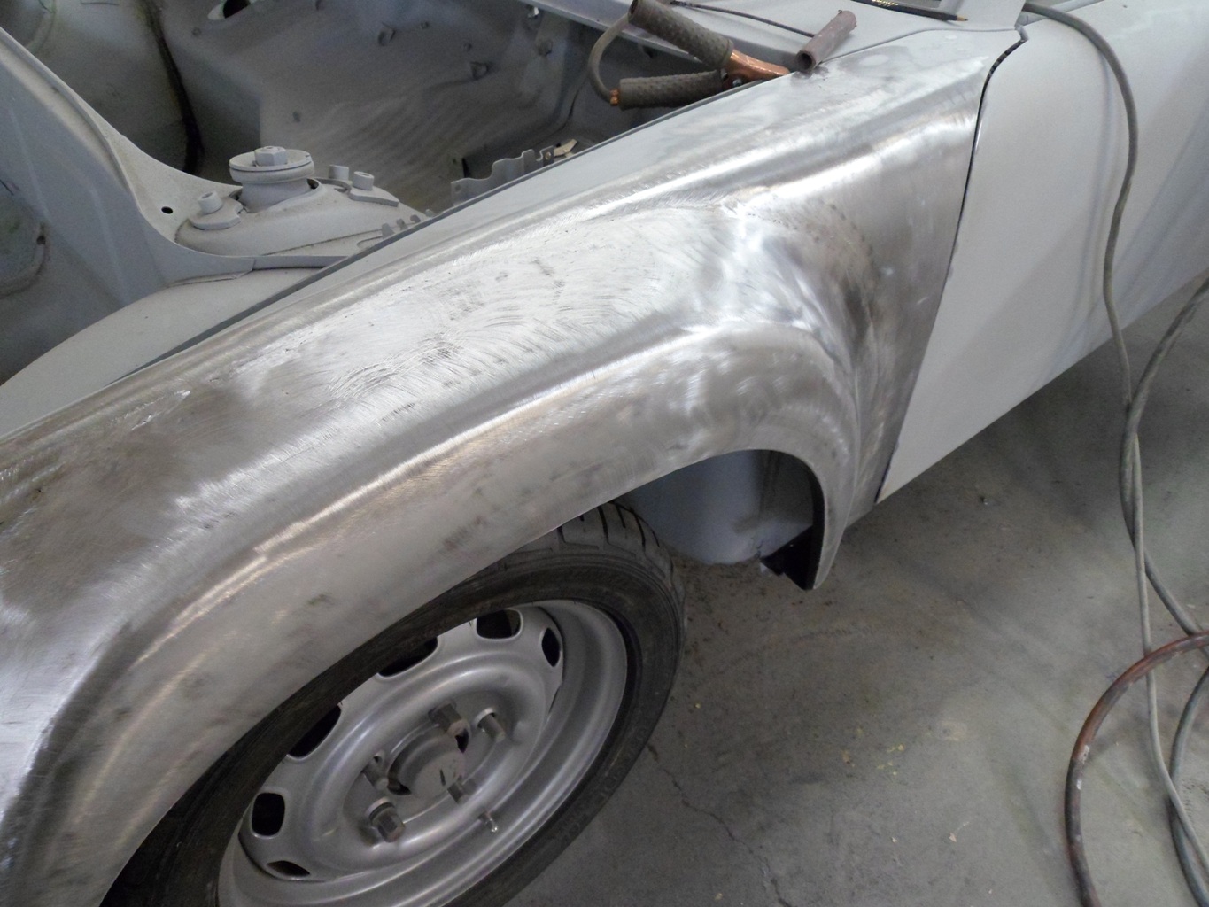

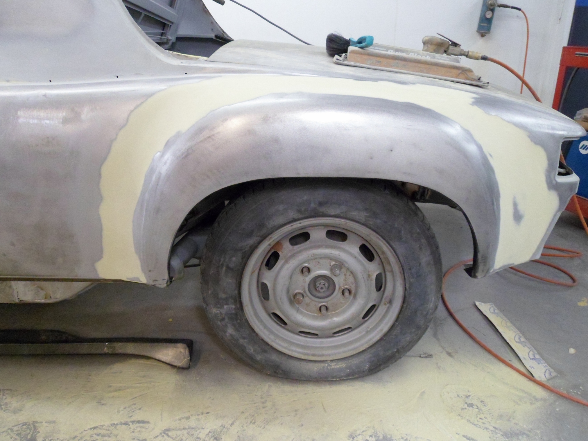

The last flare is on (IMG:style_emoticons/default/piratenanner.gif) finish the (IMG:style_emoticons/default/welder.gif) a body work on it and get it on the rotiss. for the floor pan replacement.

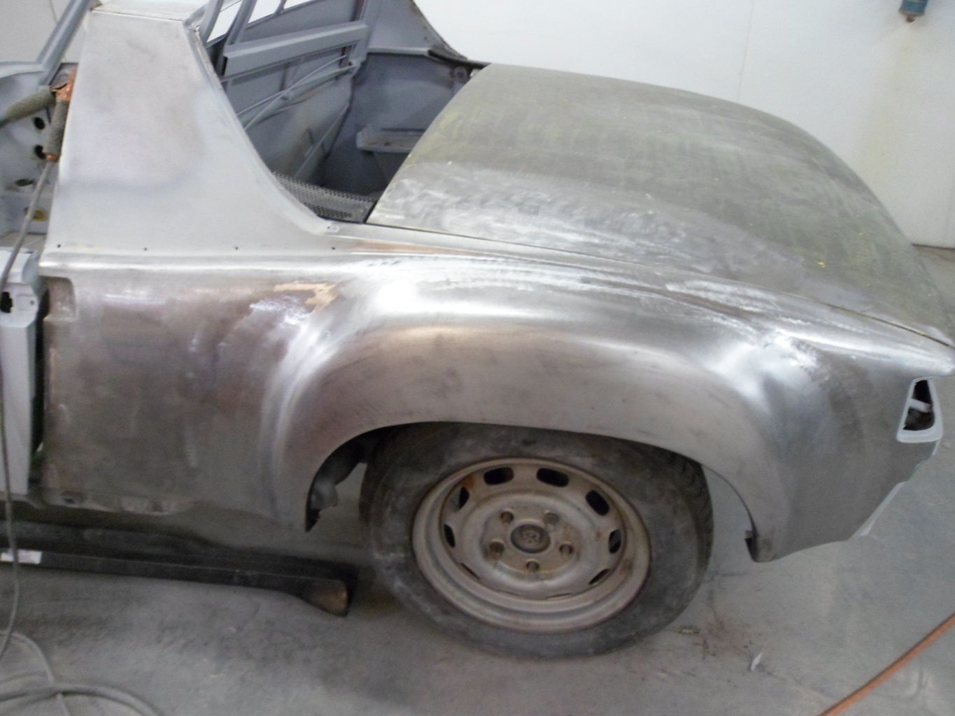

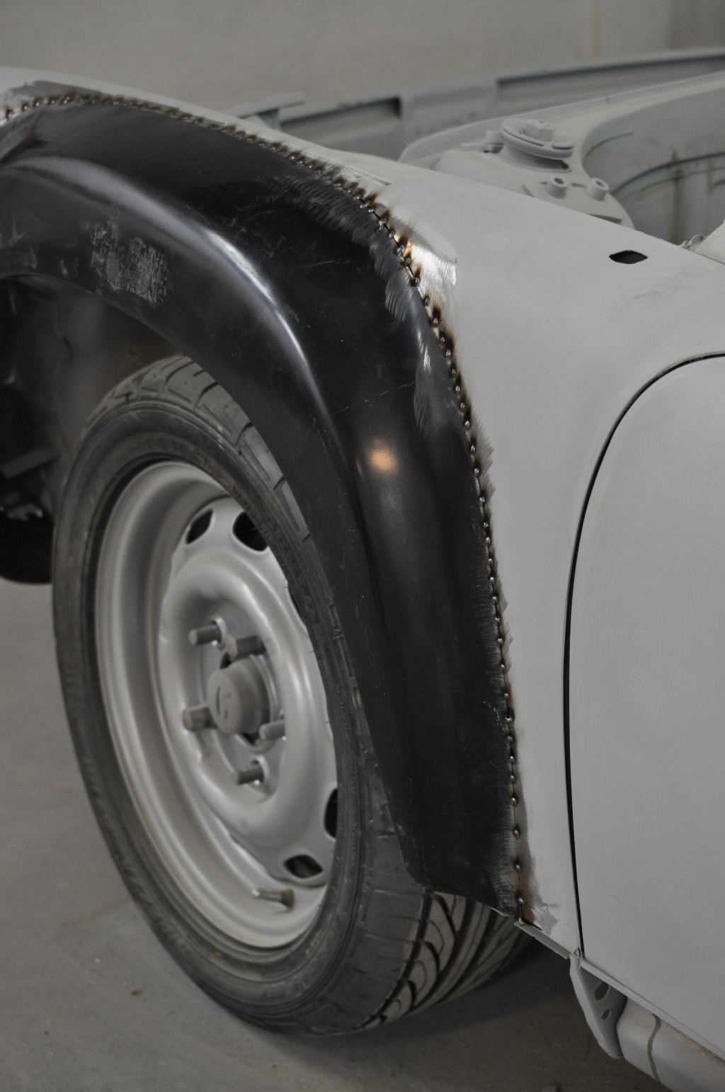

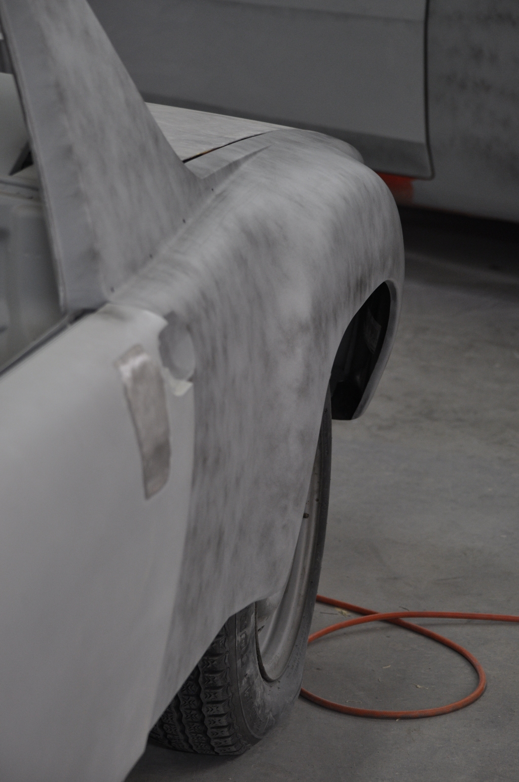

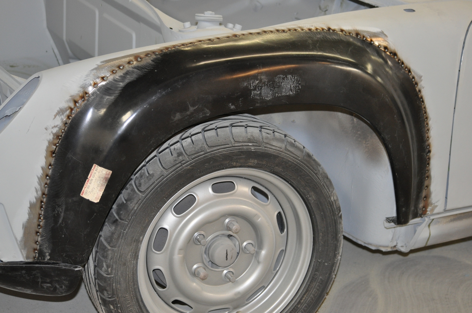

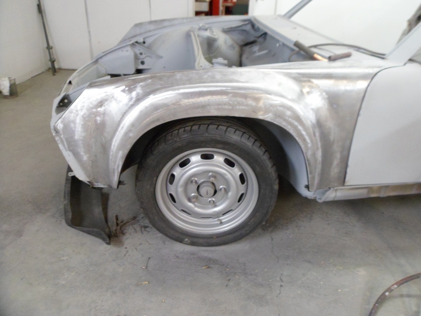

final welding on the last flare and I'm (IMG:style_emoticons/default/piratenanner.gif) on the couch like Tom Cruize

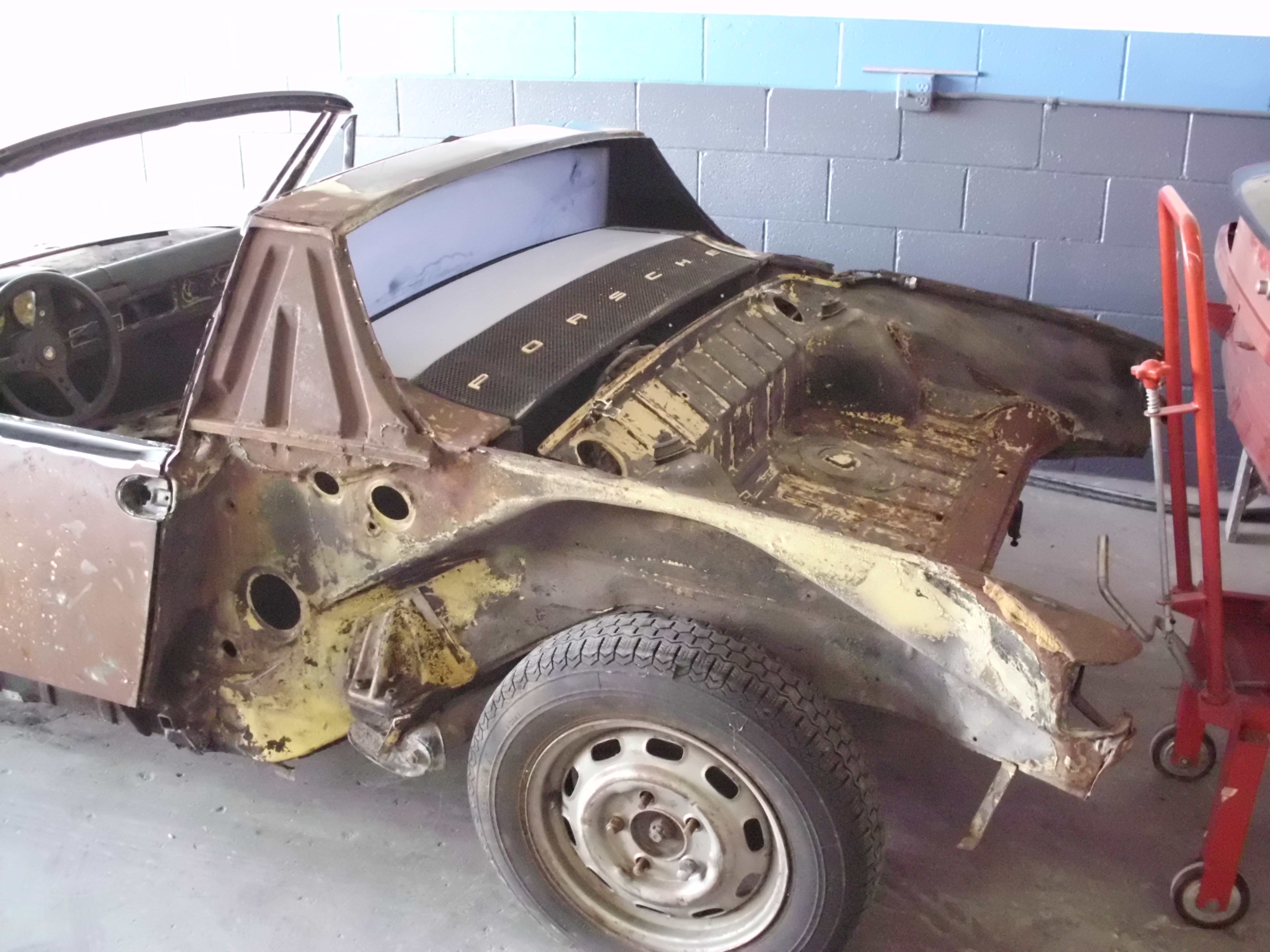

a look back

Aaron Cox

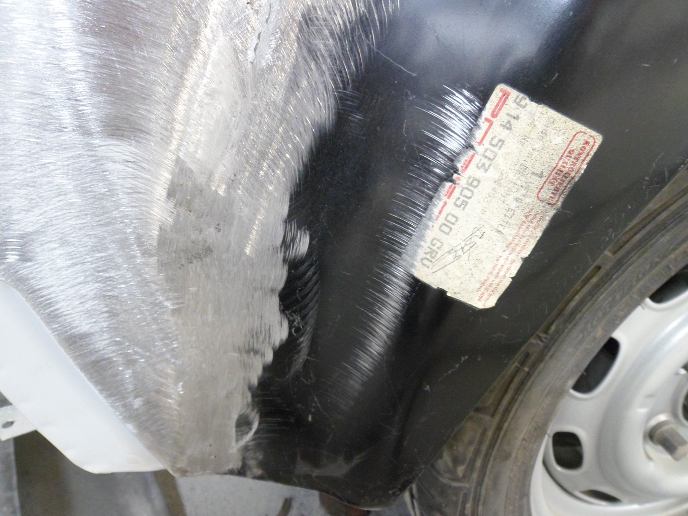

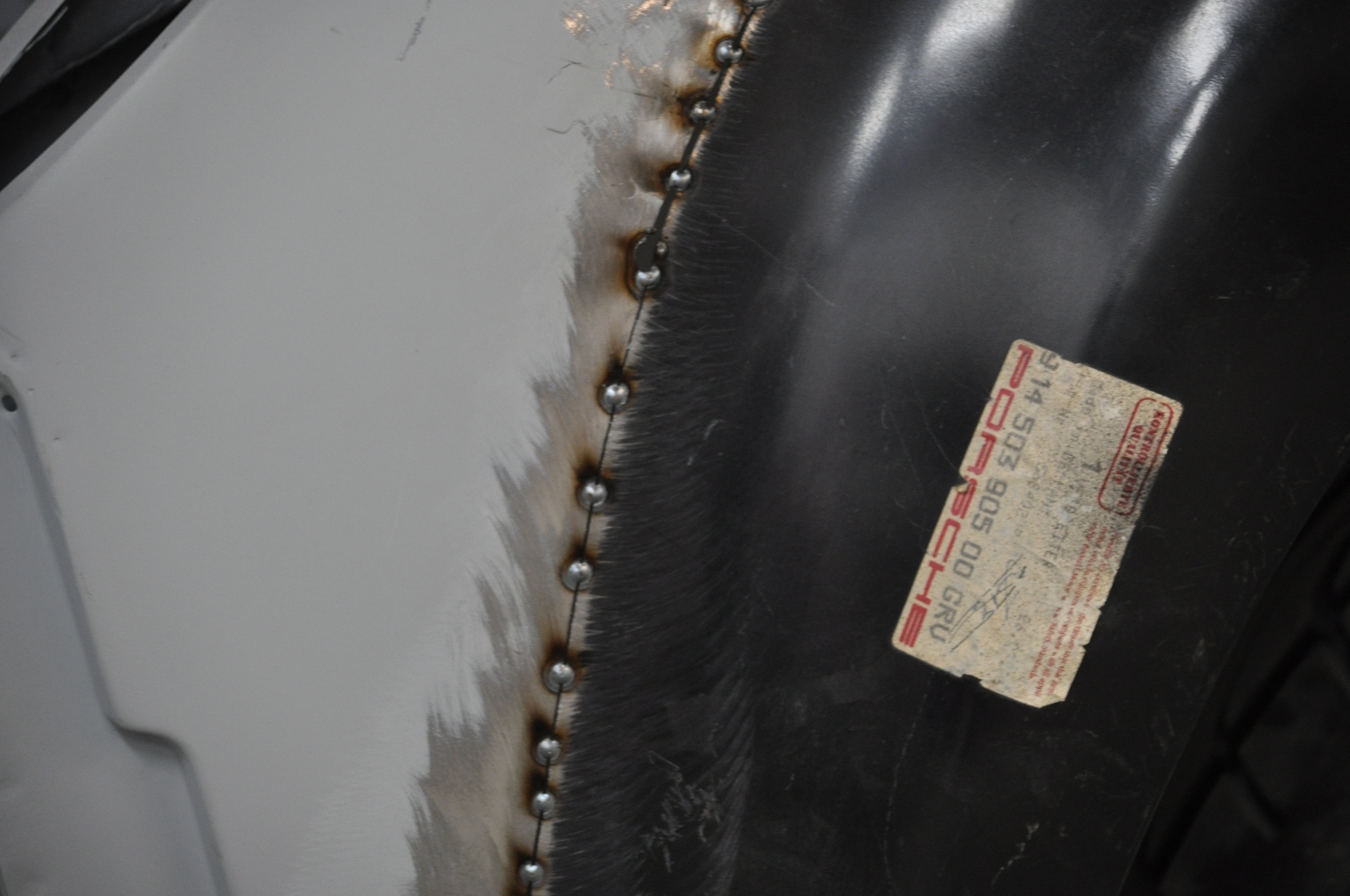

looking good!
what did you grind the fender welding down with? flapper wheel? what grit?
(i'll be embarking on this task shortly...)

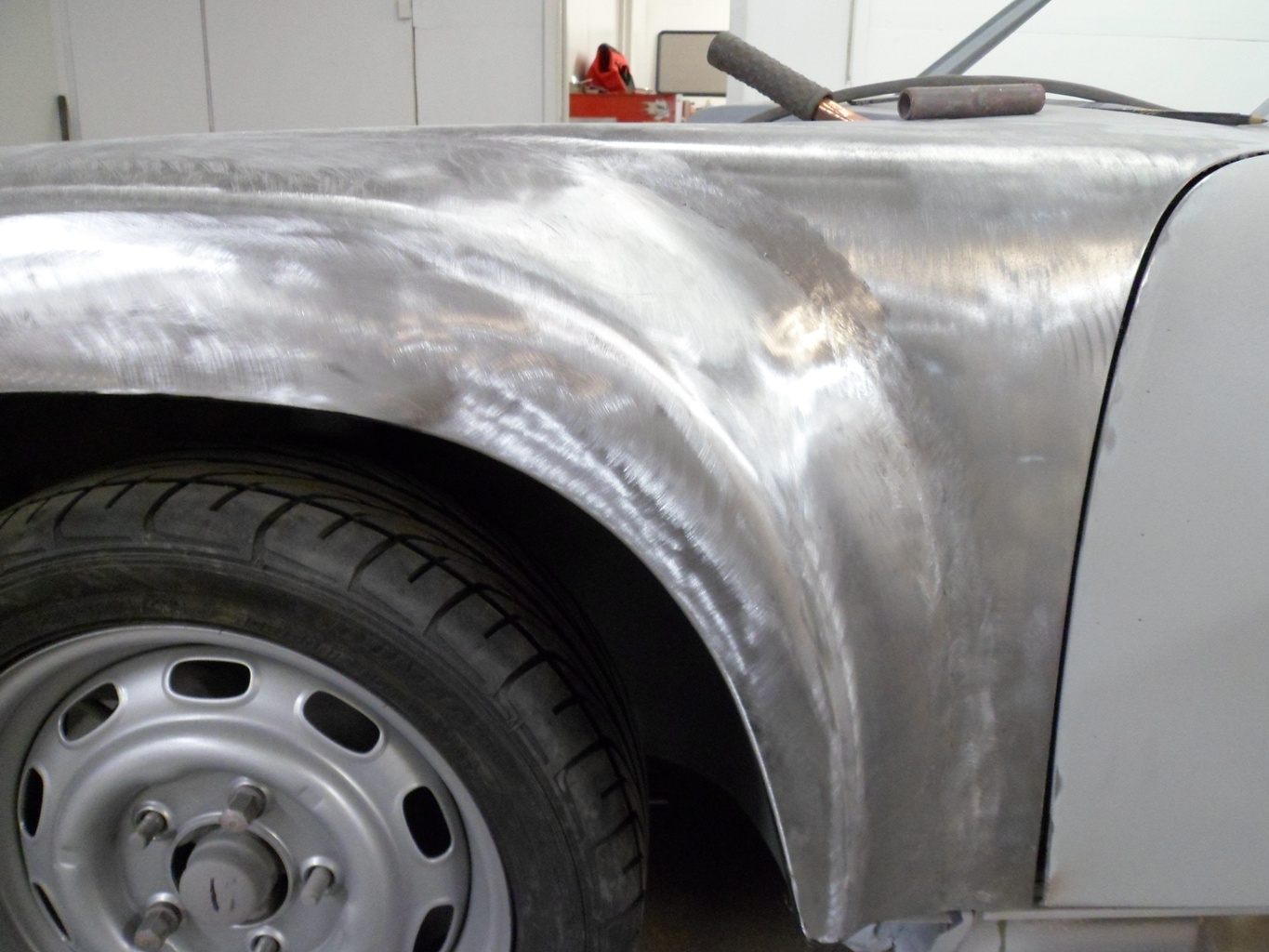

QUOTE(Aaron Cox @ Apr 12 2012, 07:33 AM) *
looking good!
Thanks Guy's
Disk to flapper wheel 36 grit. No matter how smooth it is you'll still need a thin coat of filler to blend it perfect

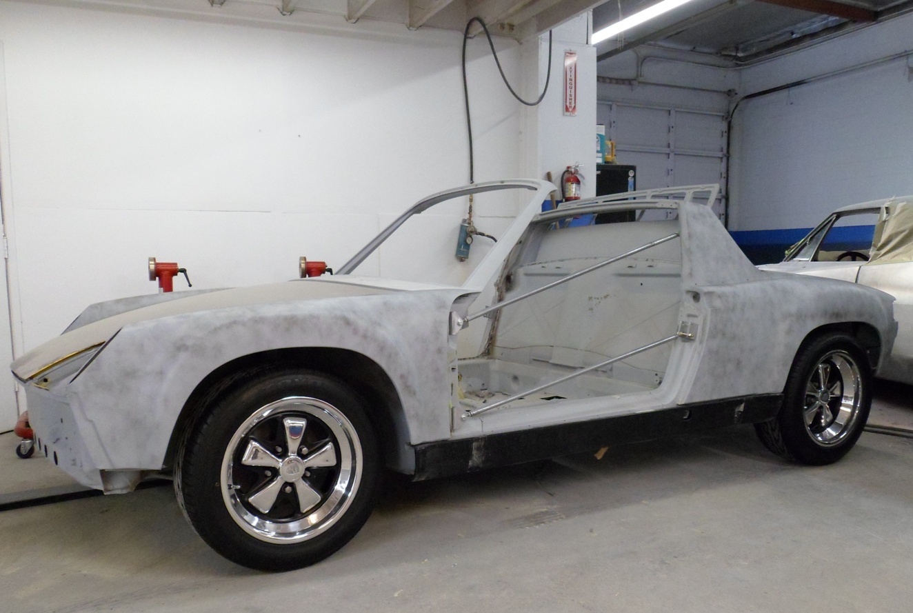

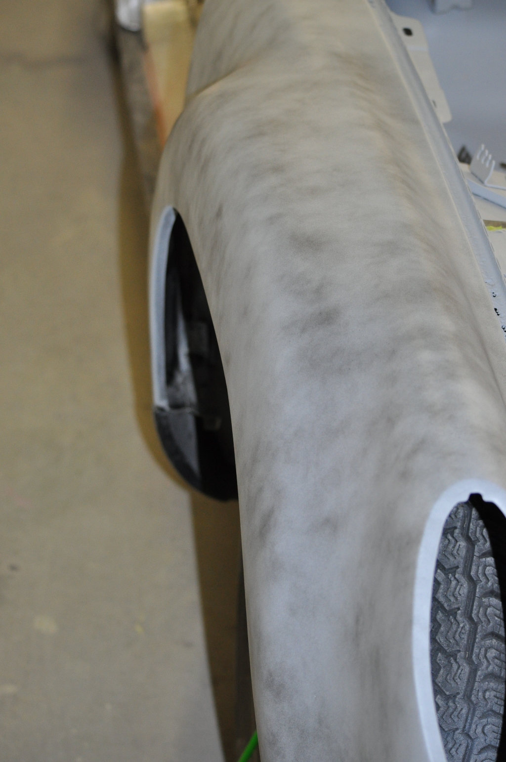

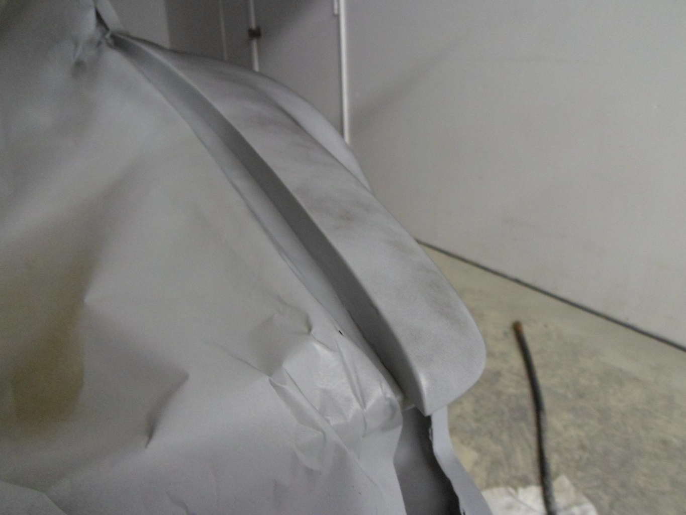

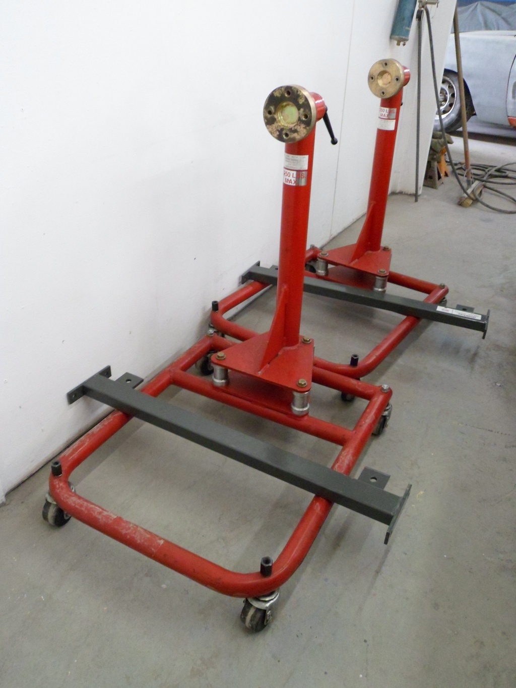

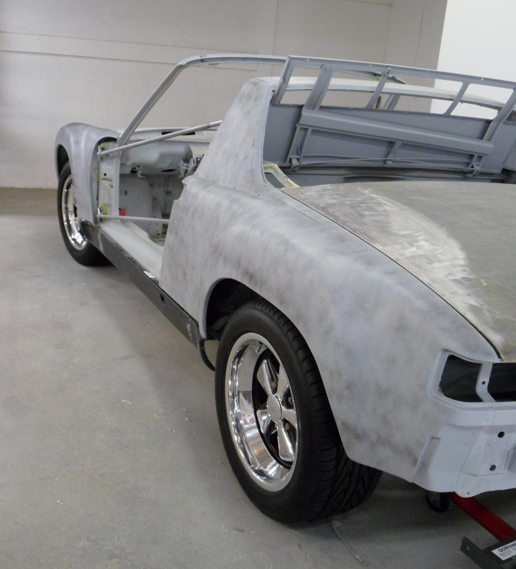

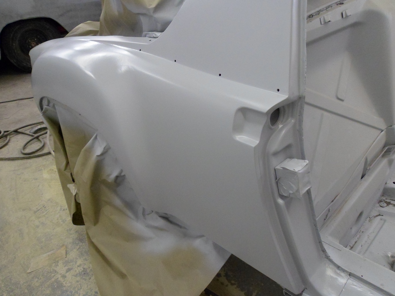

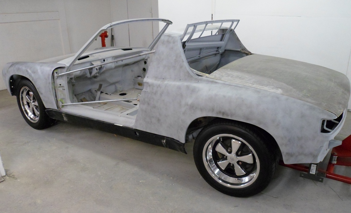

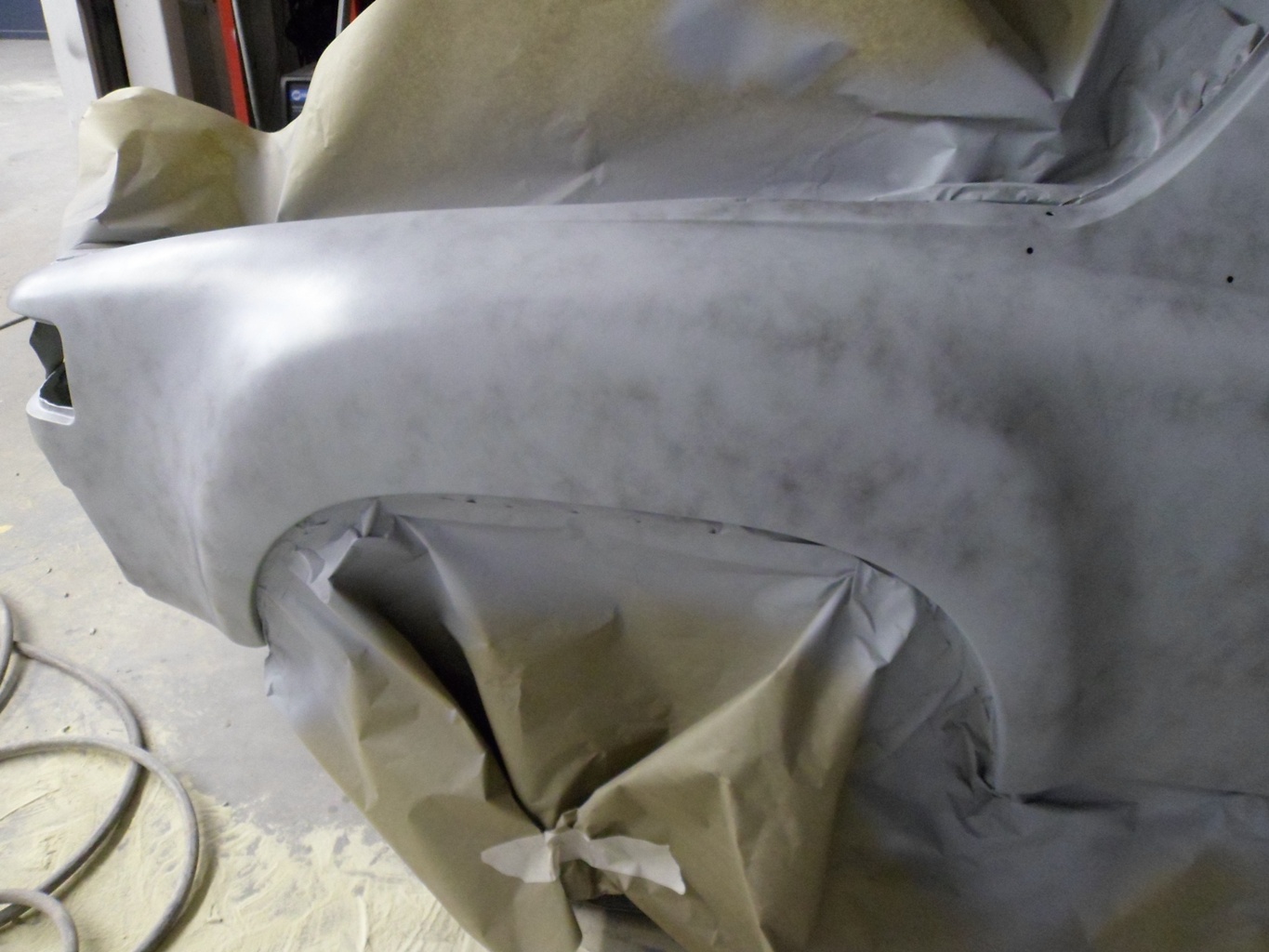

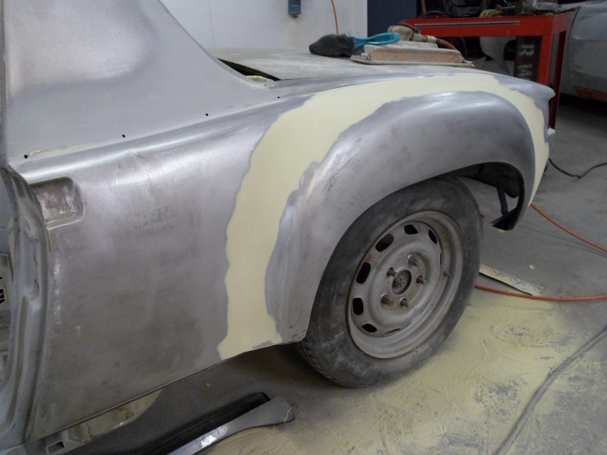

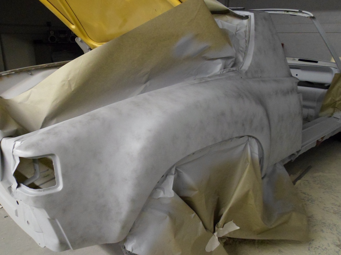

the body work on the flares is done and it's time to build the rotiss. and get the pans replaced.
Engine stands are sweet so its time for some metal and bottle jacks. Also I had to see one side of the car with it's shoes. Pinch me (IMG:style_emoticons/default/biggrin.gif)

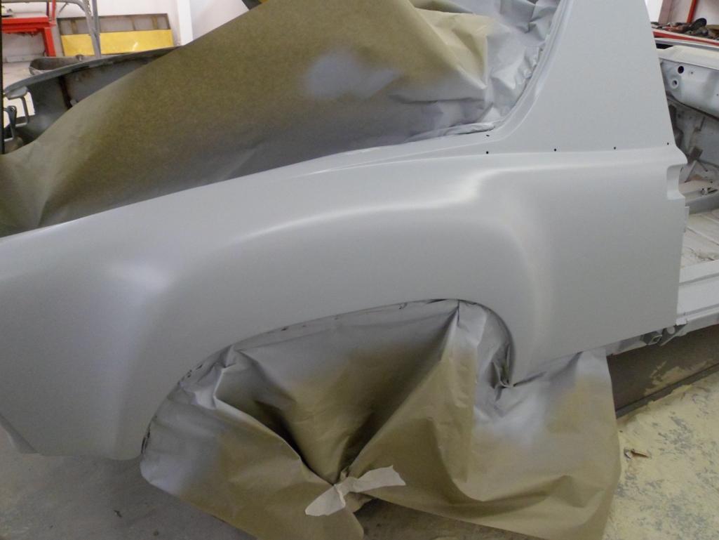

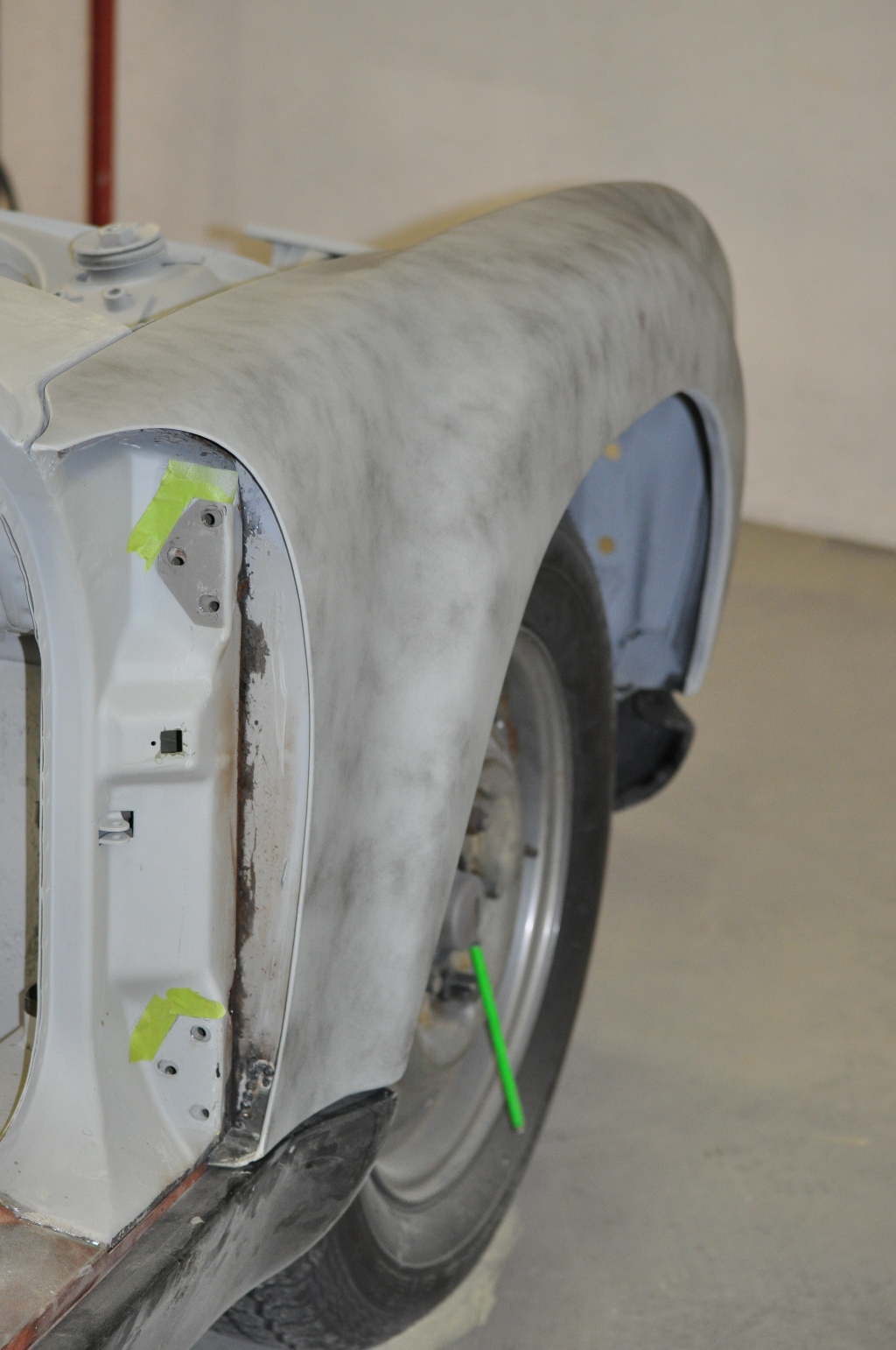

the passenger sill is done and primered rear quarter.
I remember reading about the cost of materials for building a quality Rotiss. from Mr. O'Brien and how correct he was. Scratch the build as I bought one ready for use. picture's tomorrow
