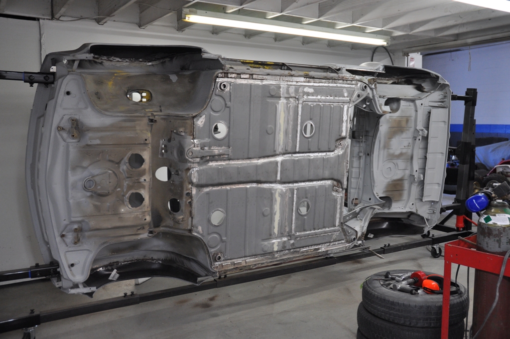

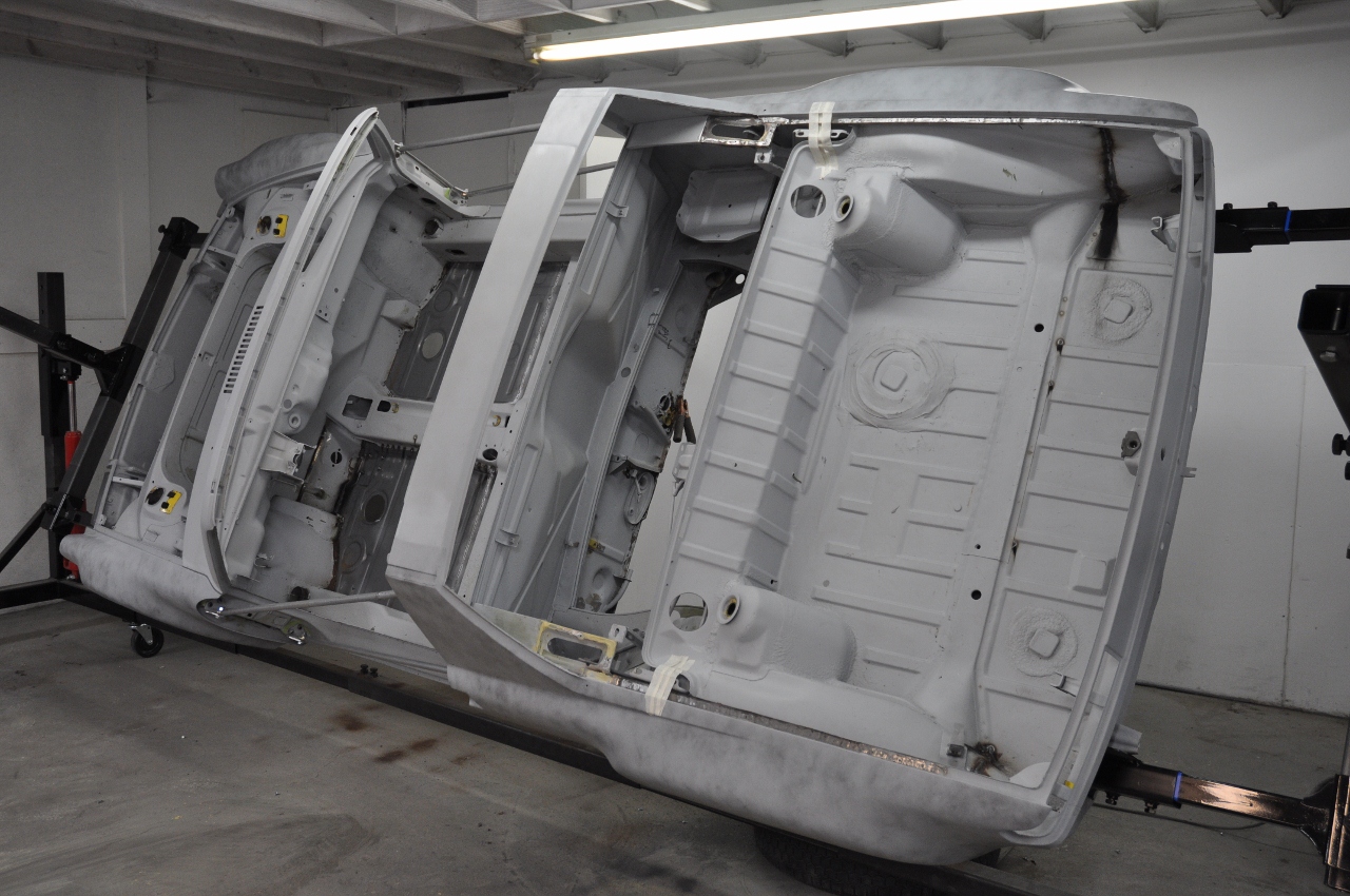

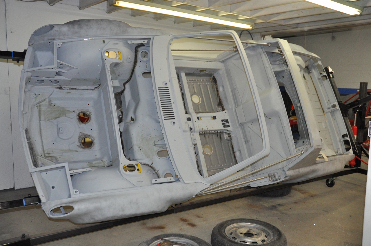

It was great to get the car on the rotiss. but cant wait to get it back on the ground. No more rust please (IMG:style_emoticons/default/pray.gif)

wow, oil lines monday, and some cheezy templates, cut once.

I am impressed that you went to the trouble to do the plugs. It is that kind of attention to detail that will set this car apart - great work!

That rotis is a serious piece too! Great job Andy

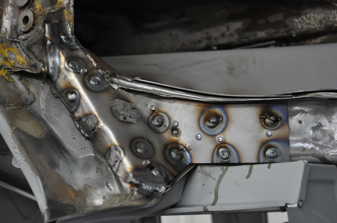

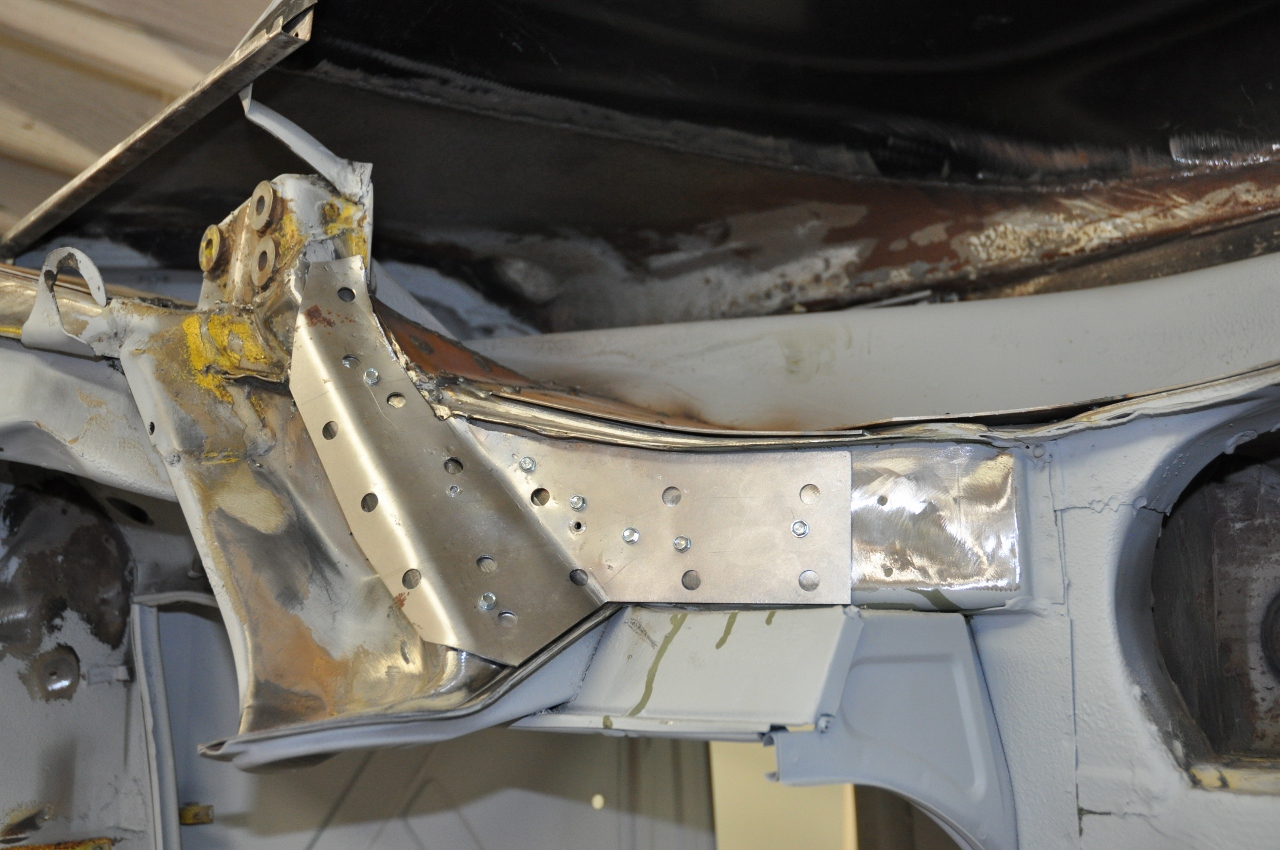

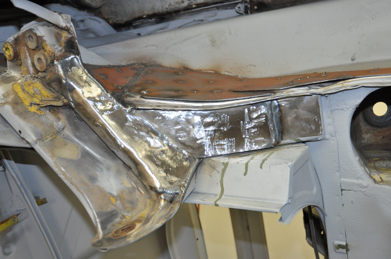

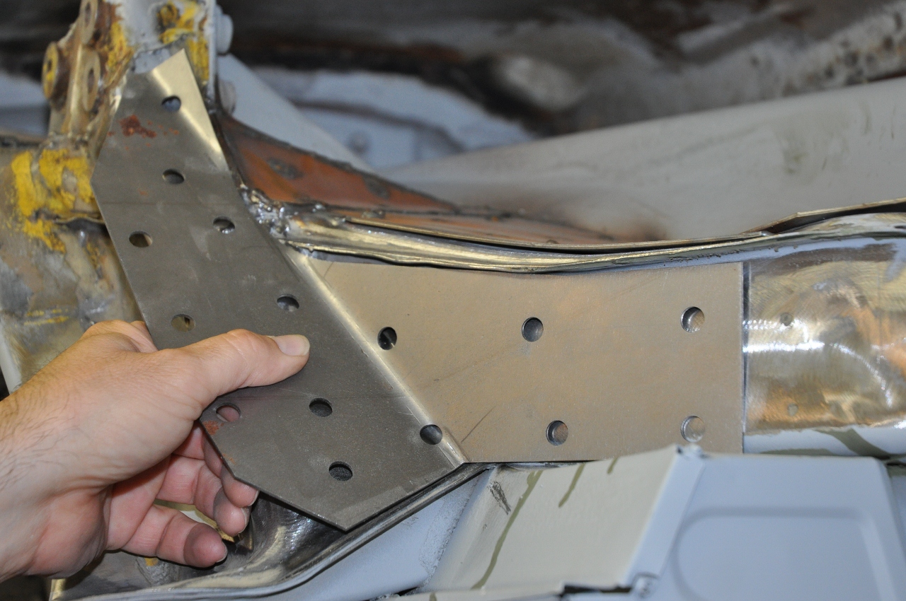

The last of the rear suspention supports are in (IMG:style_emoticons/default/welder.gif) (IMG:style_emoticons/default/smash.gif) (IMG:style_emoticons/default/welder.gif)

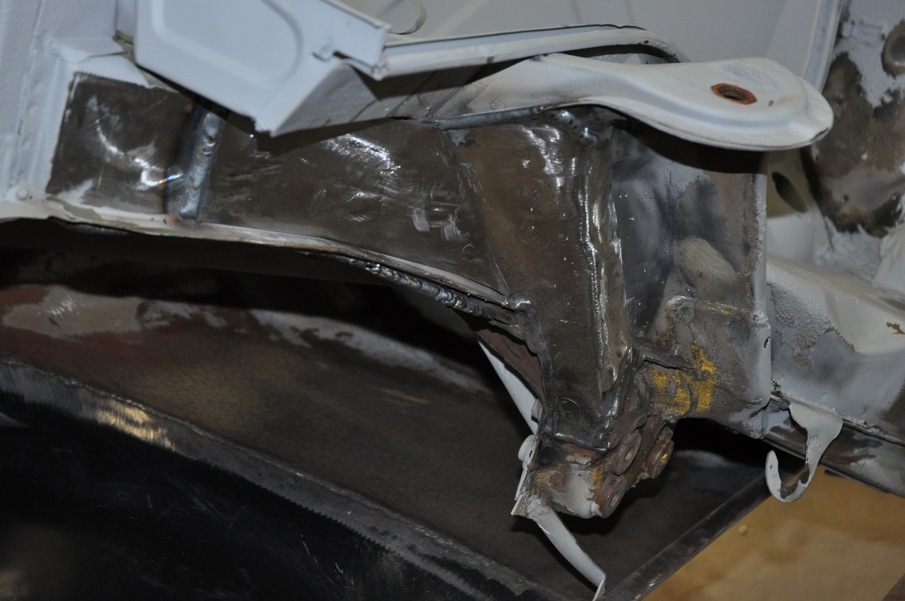

Next will be the GT engine mount modification and backing plates for the sway bars (IMG:style_emoticons/default/biggrin.gif)

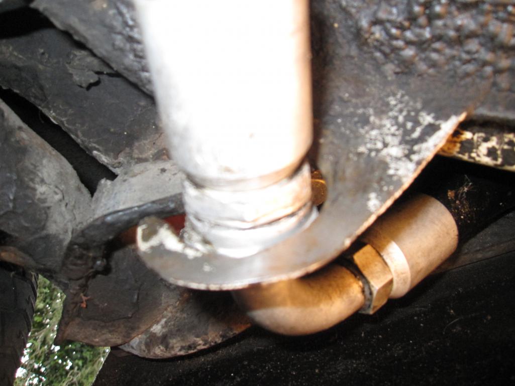

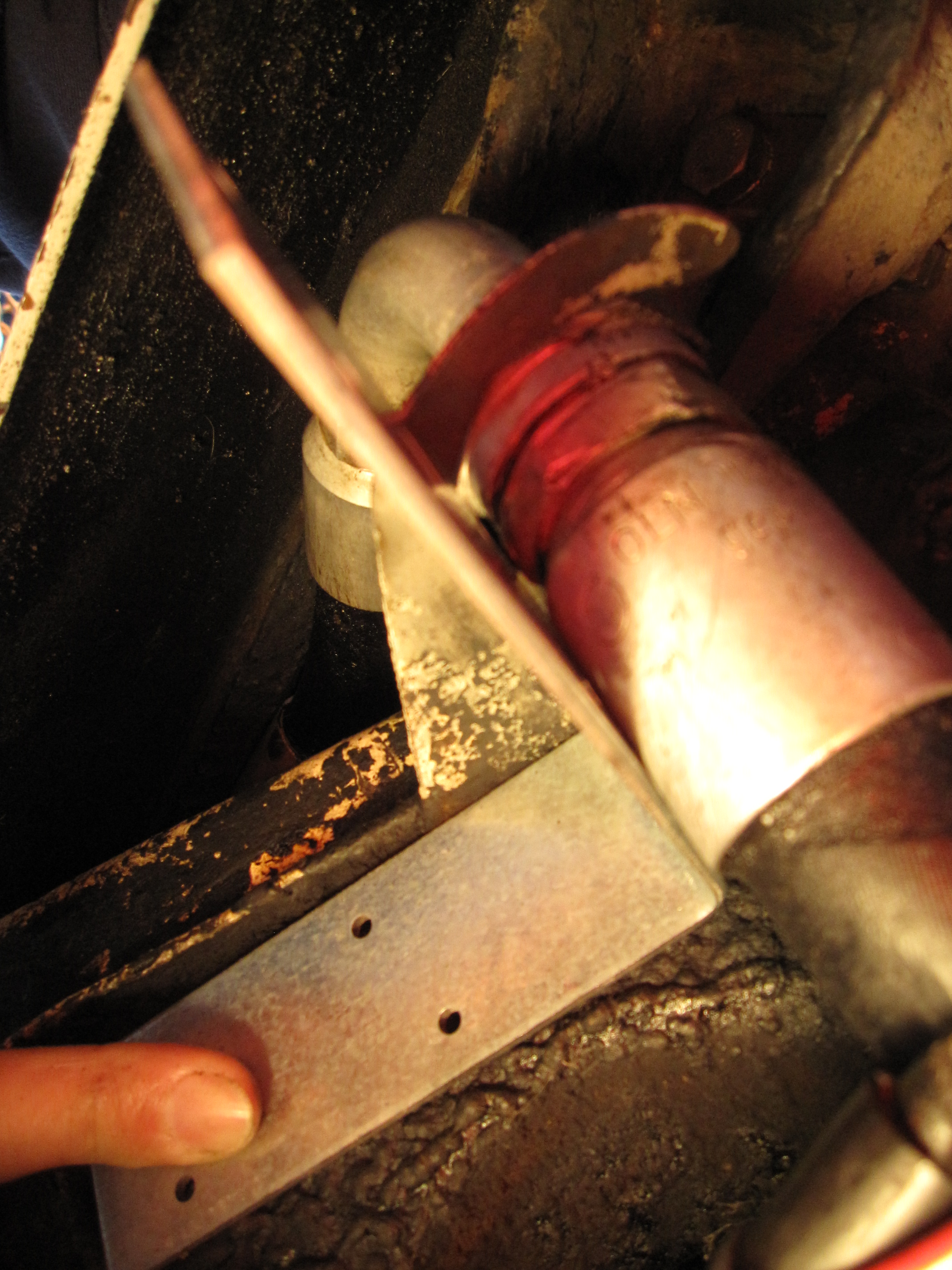

Hello All. I'm looking for a good picture of where the oil line suport hook should be so I can get it back in the correct position
Thanks in advance!!

QUOTE(Socalandy @ Jul 12 2012, 09:46 AM) *
Thanks in advance!!
Andy,
Are those Racer Chris' mounting sleeves installed on your susp console?
I'll crawl under my six when I get home tonight and take a picture of the oil line support hook for you.
Gary
Gary
If my memory is correct YES and thanks in advance for the pic.
I think it should be strait down with no bends (IMG:style_emoticons/default/confused24.gif)

QUOTE(Socalandy @ Jul 12 2012, 10:12 AM) *
Gary
If my poor memory serves me I think its not quite 90 degrees straight down, but has a slight angle to it, but the pictures will confirm.

QUOTE(sbsix @ Jul 12 2012, 10:15 AM) *
Gary

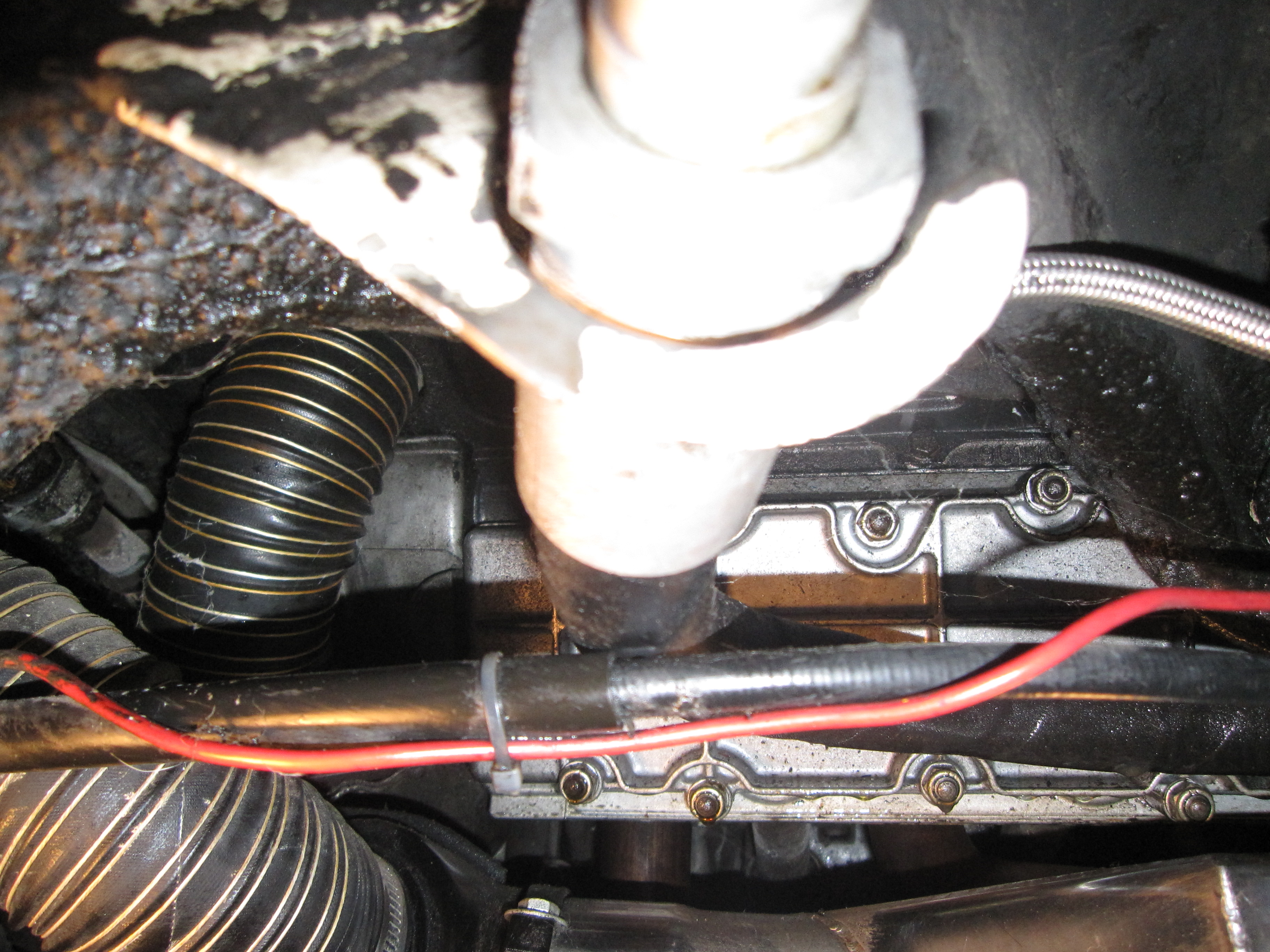

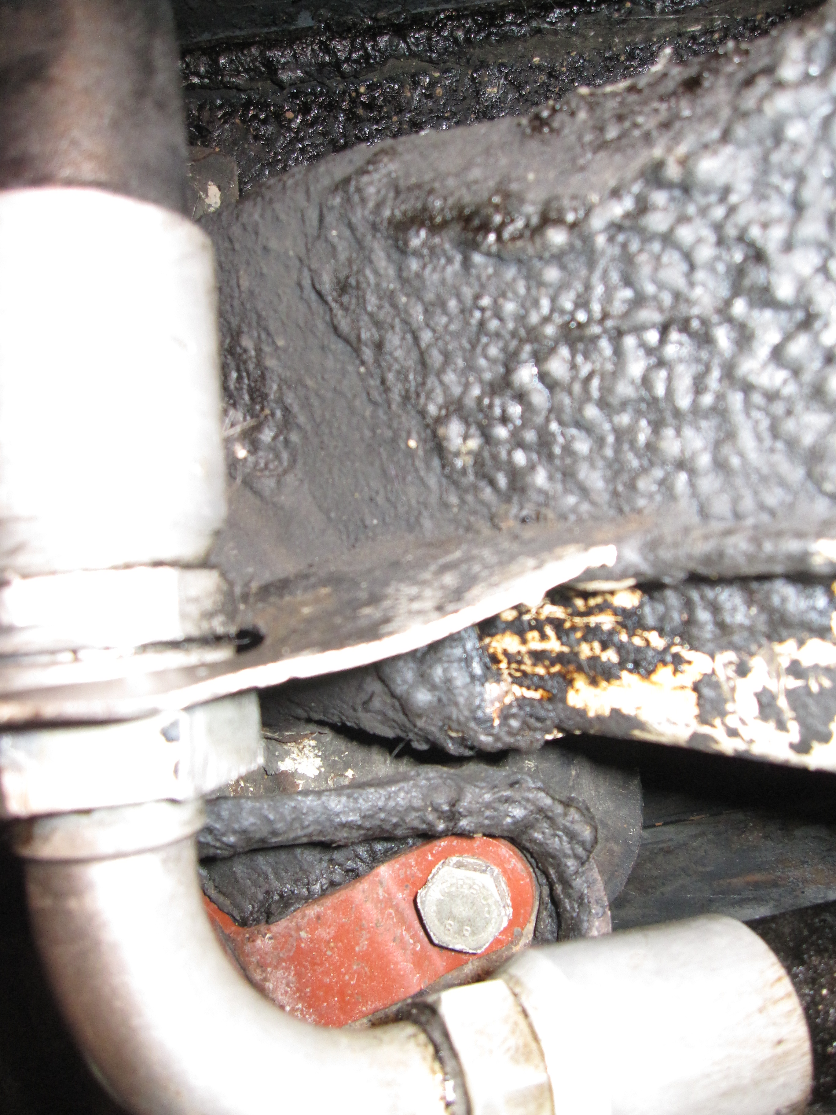

Andy this is my first attempt to add a picture to a post, please be patient.Attached Image

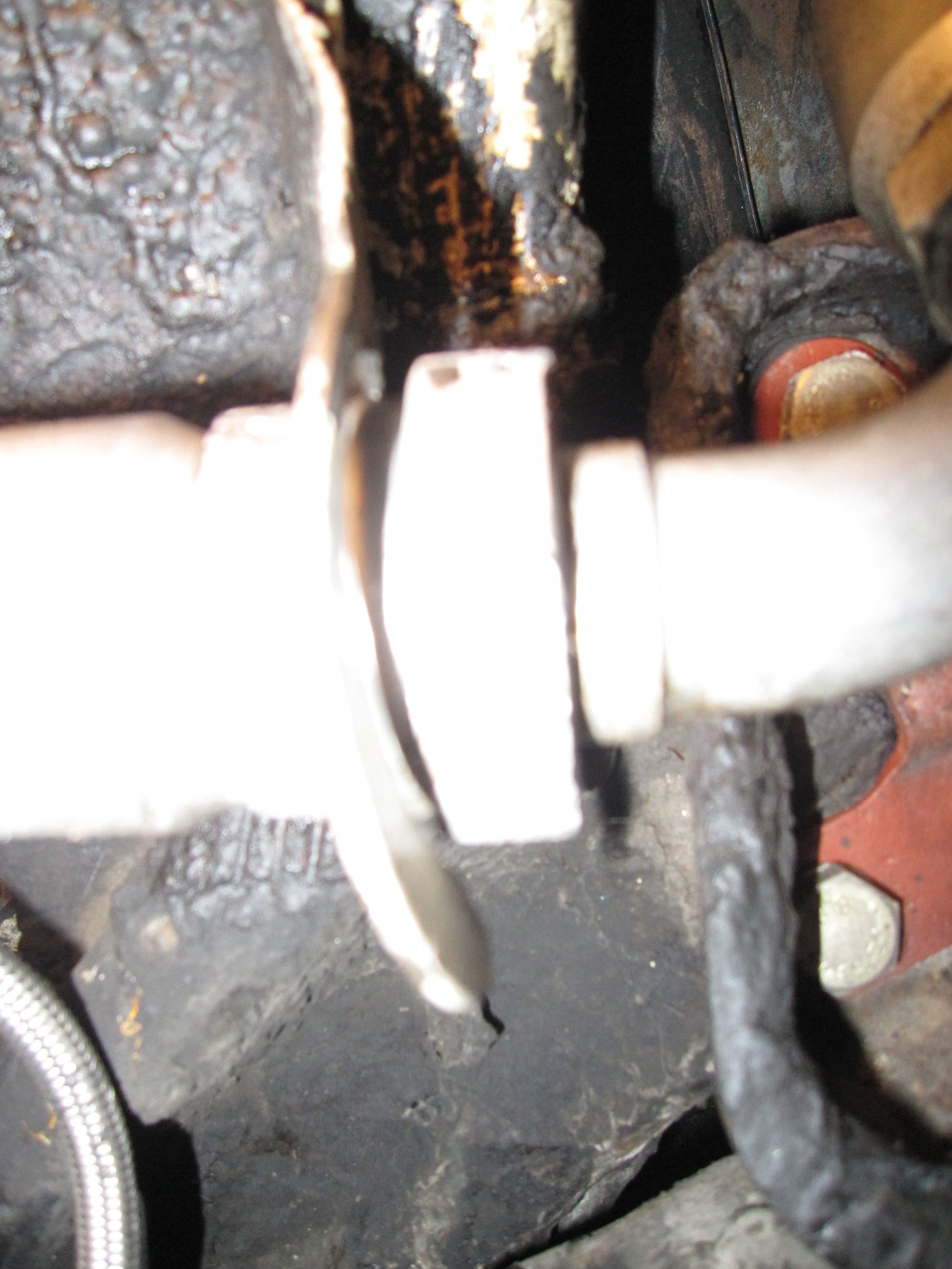

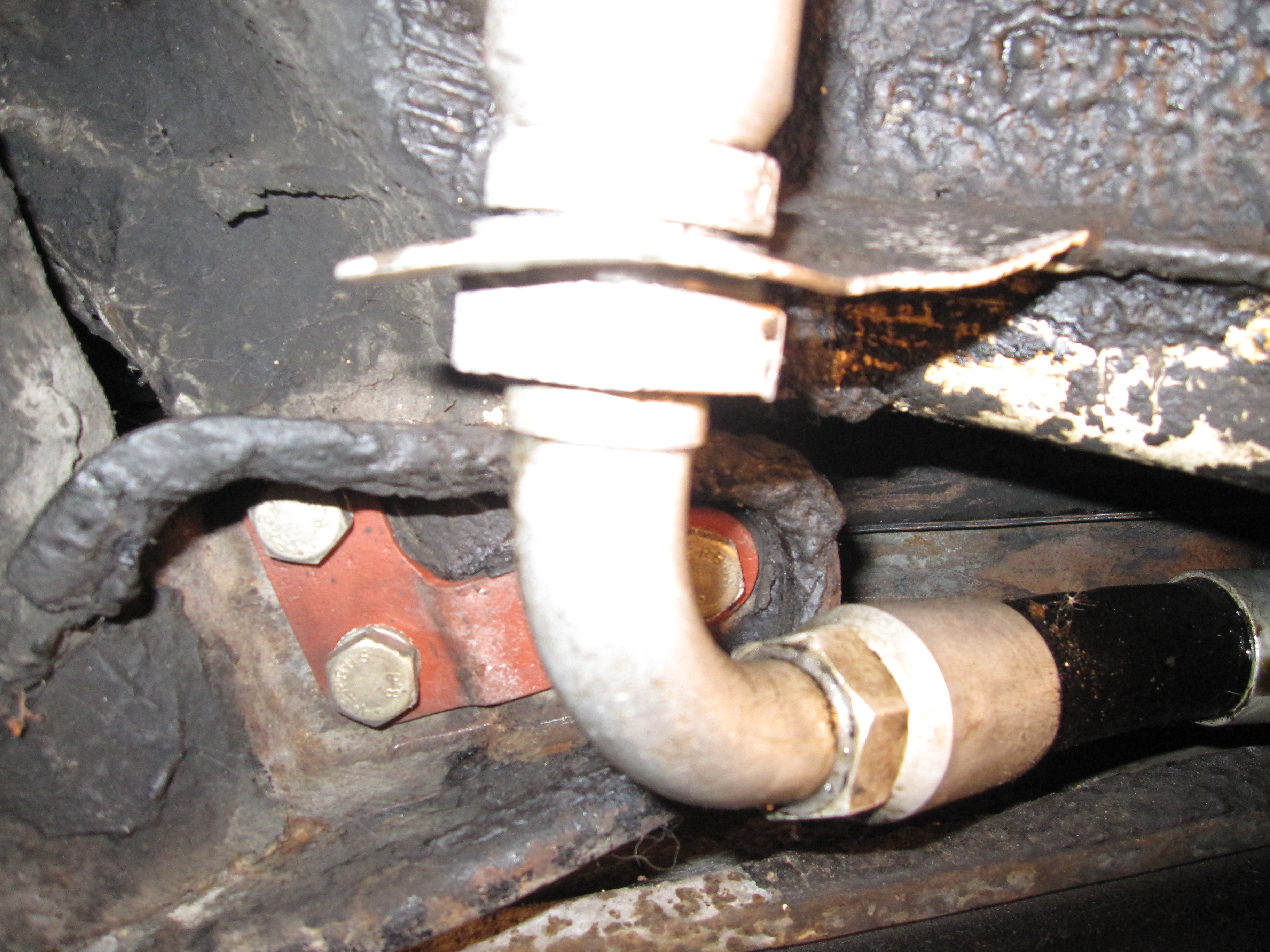

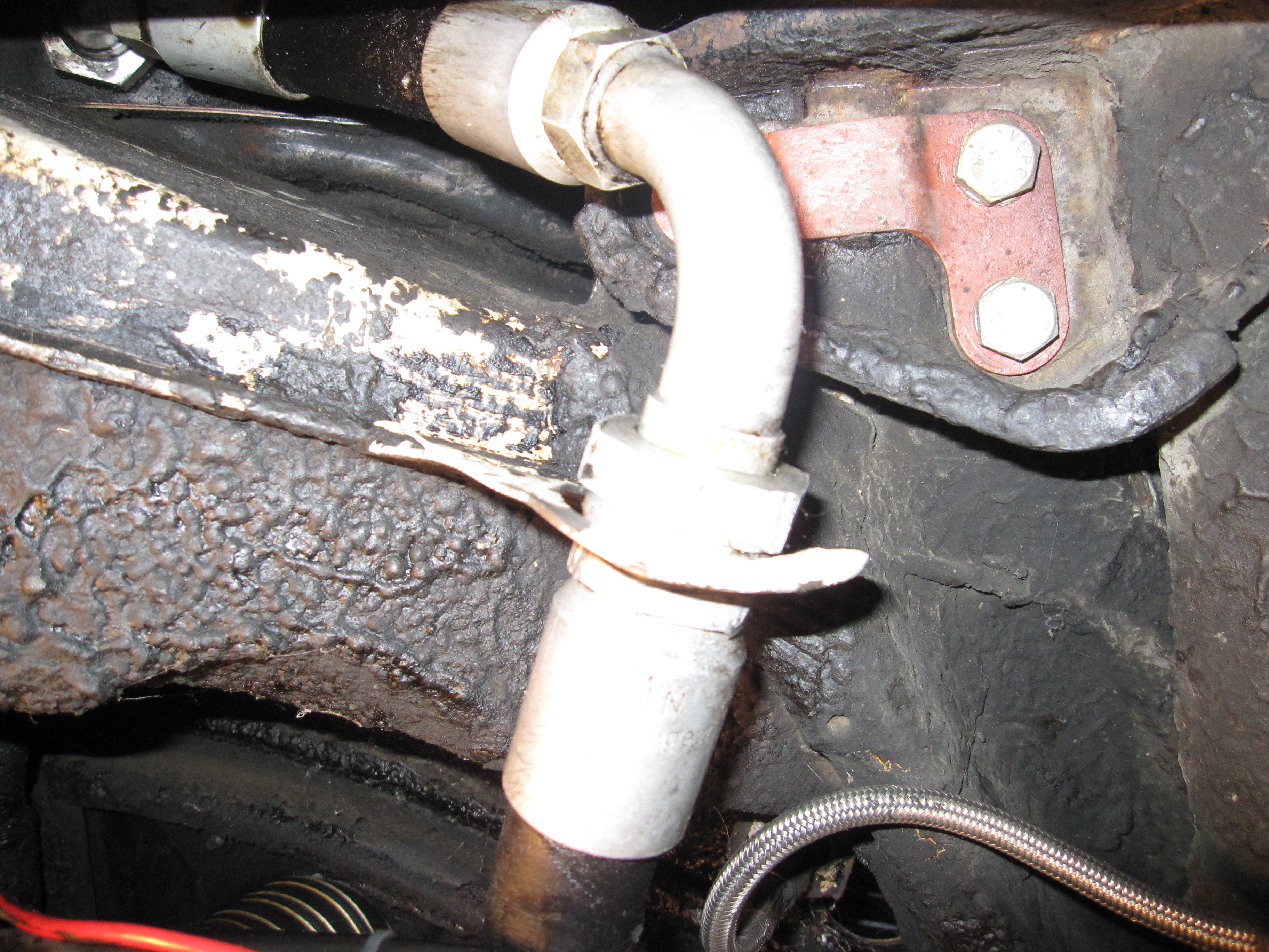

Attached ImageAttached ImageI have 9 more pix of the oil line hook. From the pictures you can see a slight curve from top to bottom, I think in order for the oil line coupling to fit properly.

you can see the slight curve from the top. The clearance at the coupling is minimal and would not fit if the hook was completley straight.Attached Image

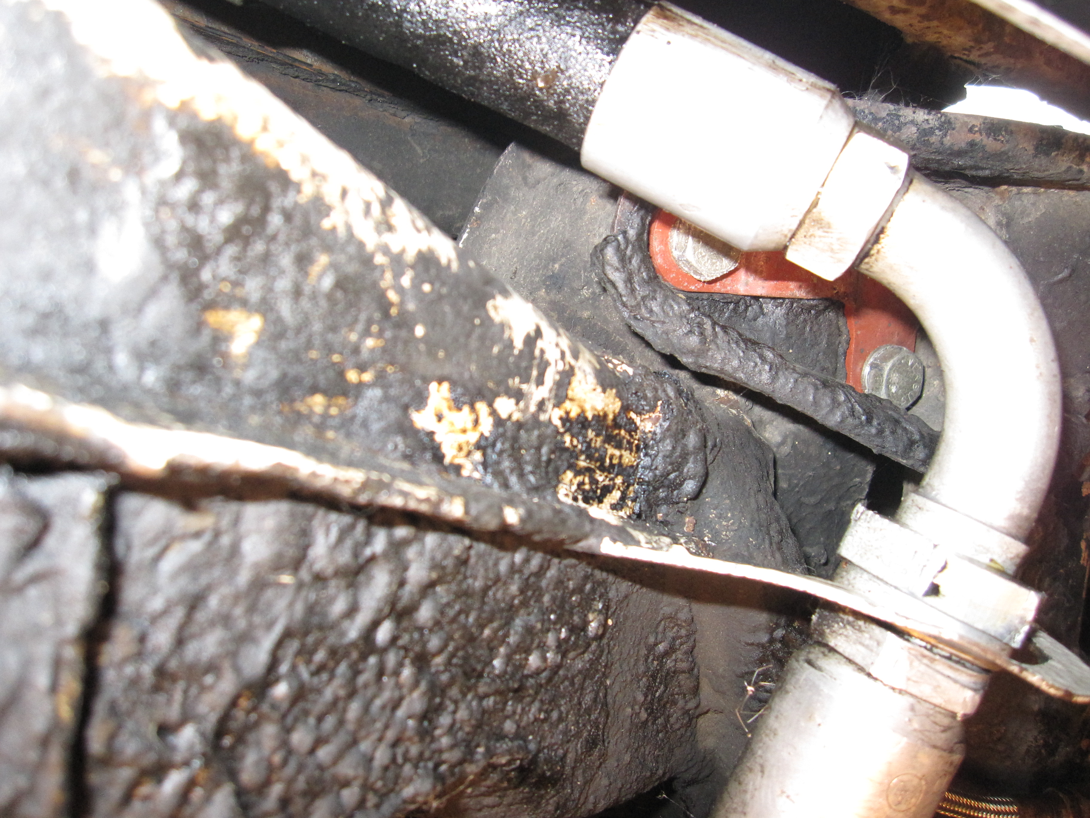

the curve is exaggerated because of the harsh lighting, but the end of the hook curves back slightly

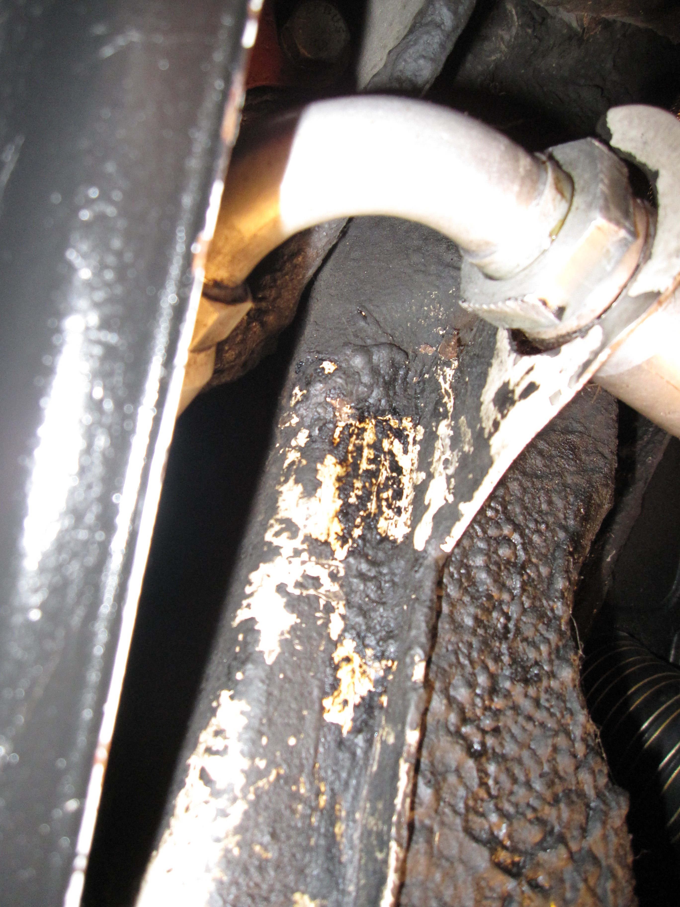

this shot shows the slight curve compared with a straight edge. I was upside down taking this shot and suprised this one came out as well as it did

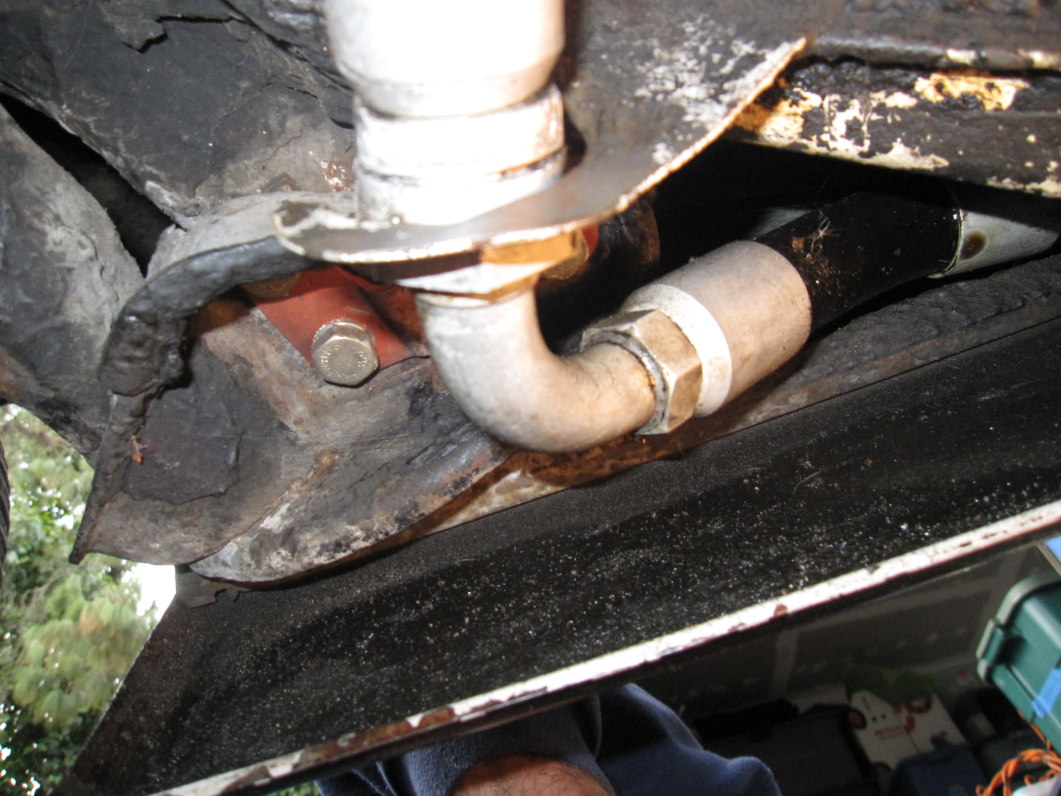

this shows the slight curve at the end of the hook towards the rear of the car

the edge is highlighted by the flash, but it does show the curve again

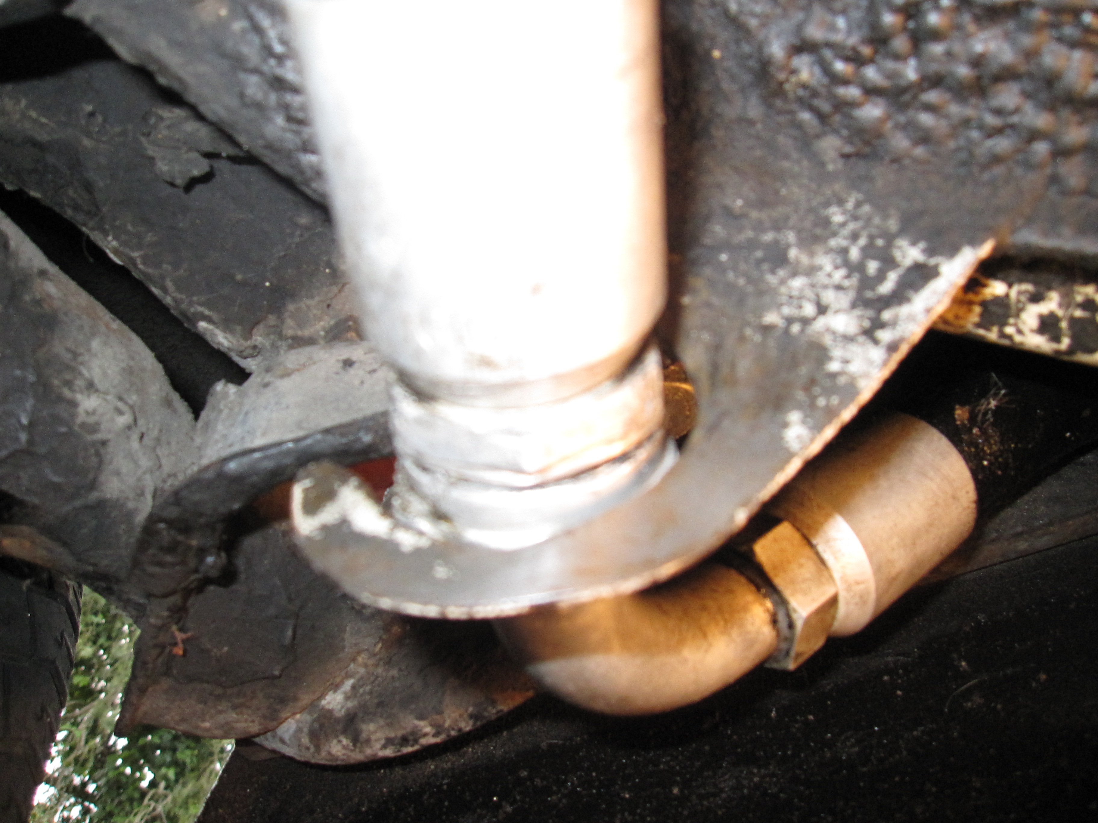

this shows both curves and the relationship of the hook to the oil line coupling.

this shot shows the oil line coupling and the clearances again. Of course, there is play in the line when you move it, but the coupling fits nicely within the curves surfaces.

another shot of the curves
