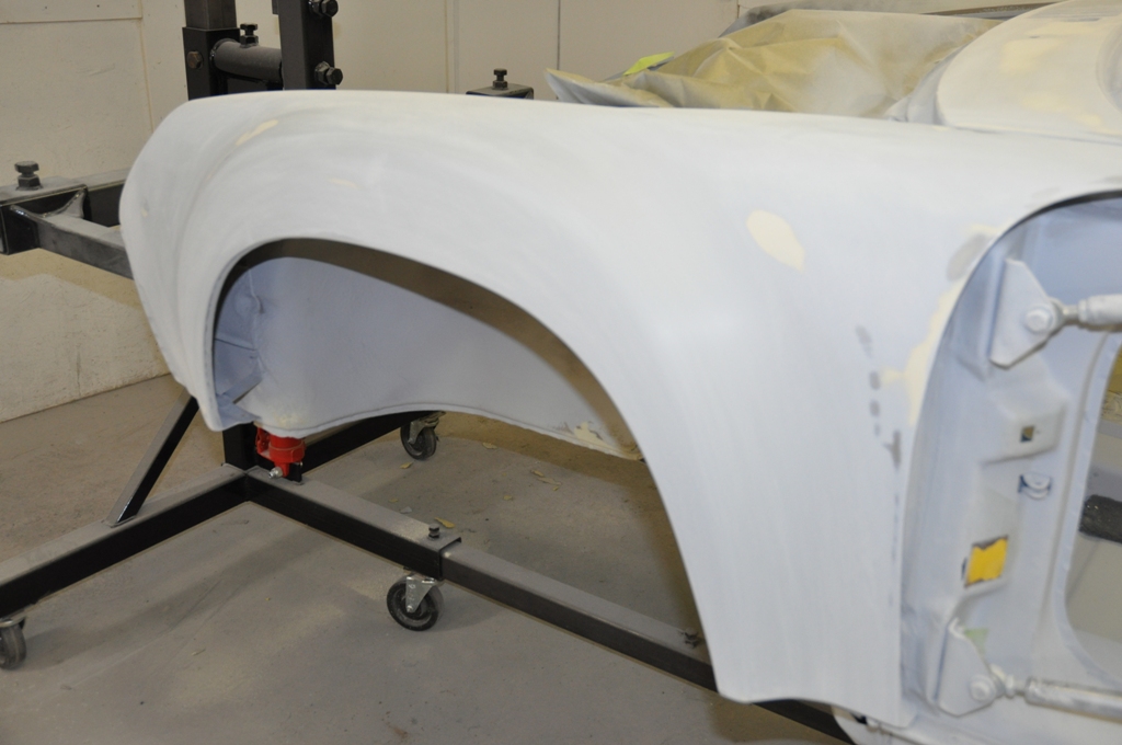

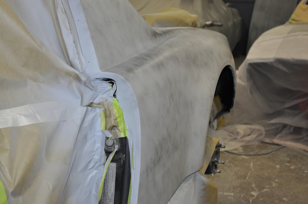

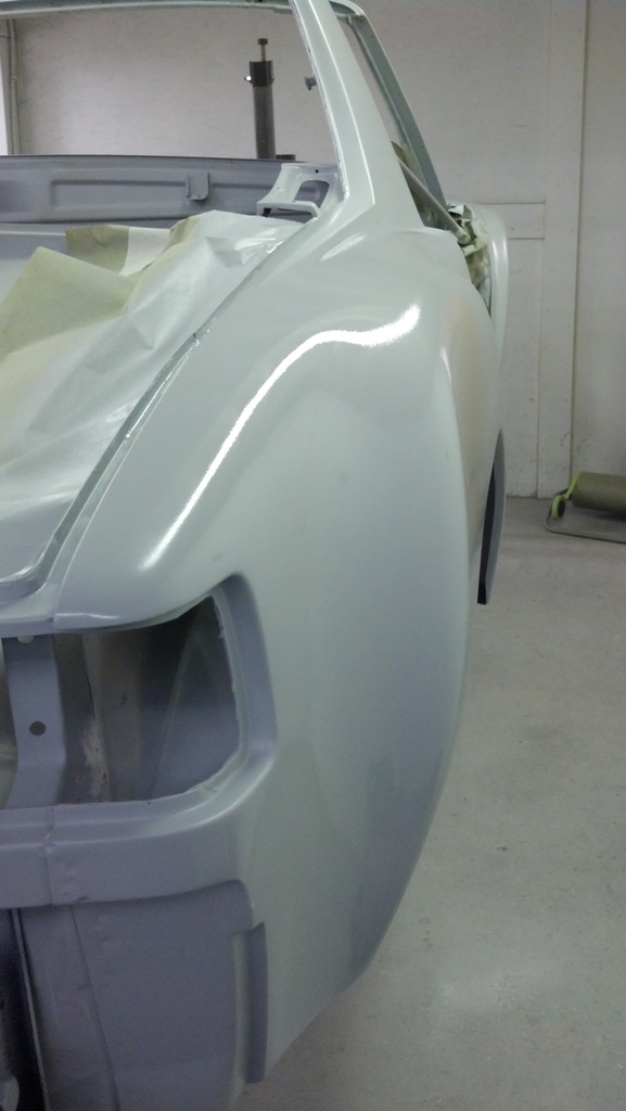

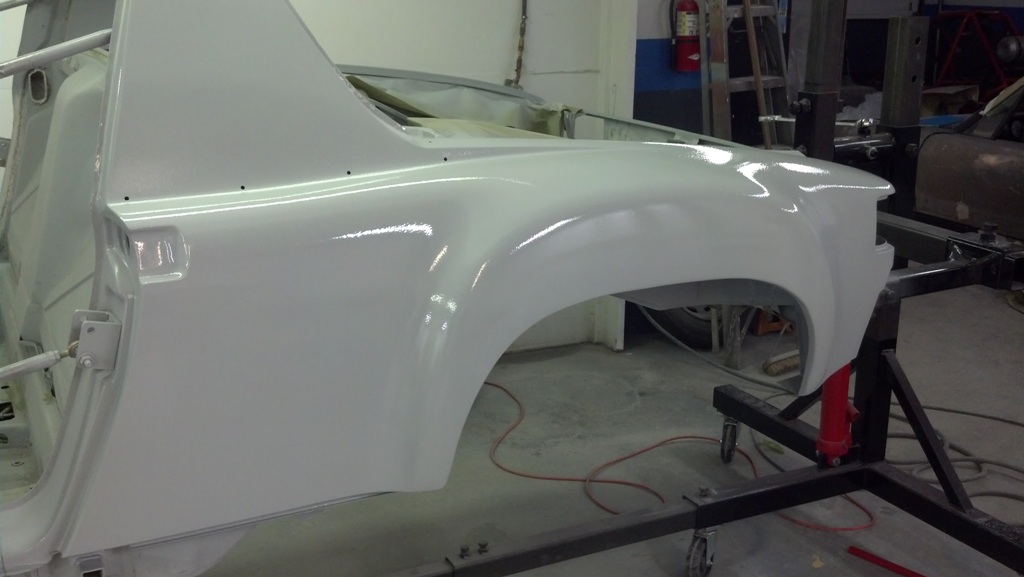

Kent added braces to the front flares on the trailing end and block sanding down to 220 is done. Fixed the stripped threads for the drivers side swing arm.

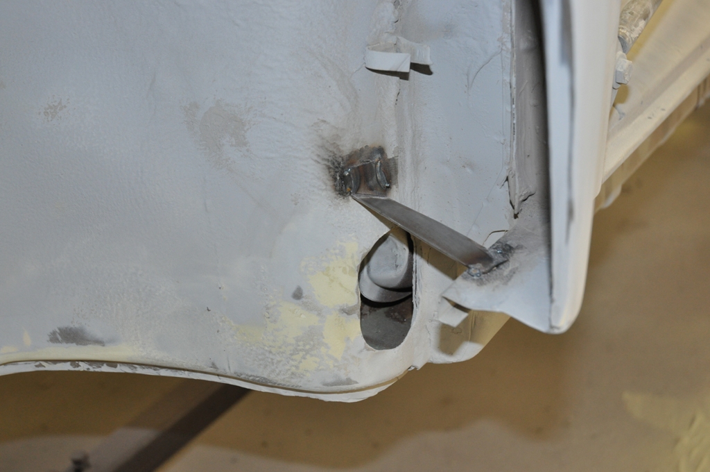

new threaded insert welded in (IMG:style_emoticons/default/welder.gif)
Kent has finished the first of his custom flares on his car (IMG:style_emoticons/default/drooley.gif)

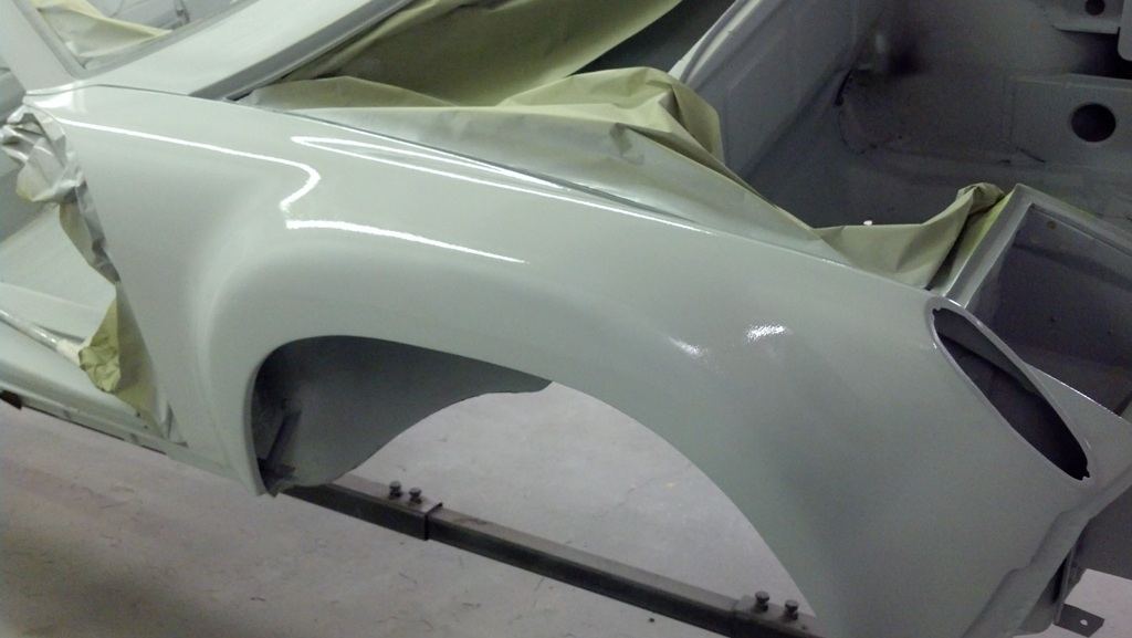

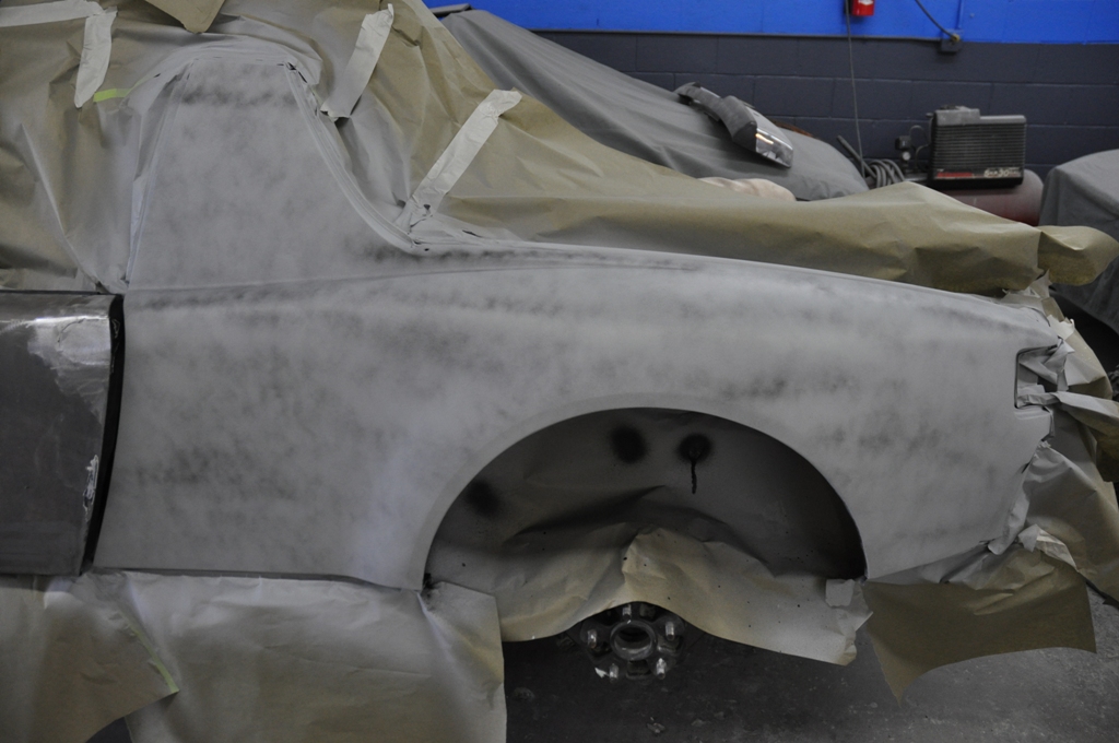

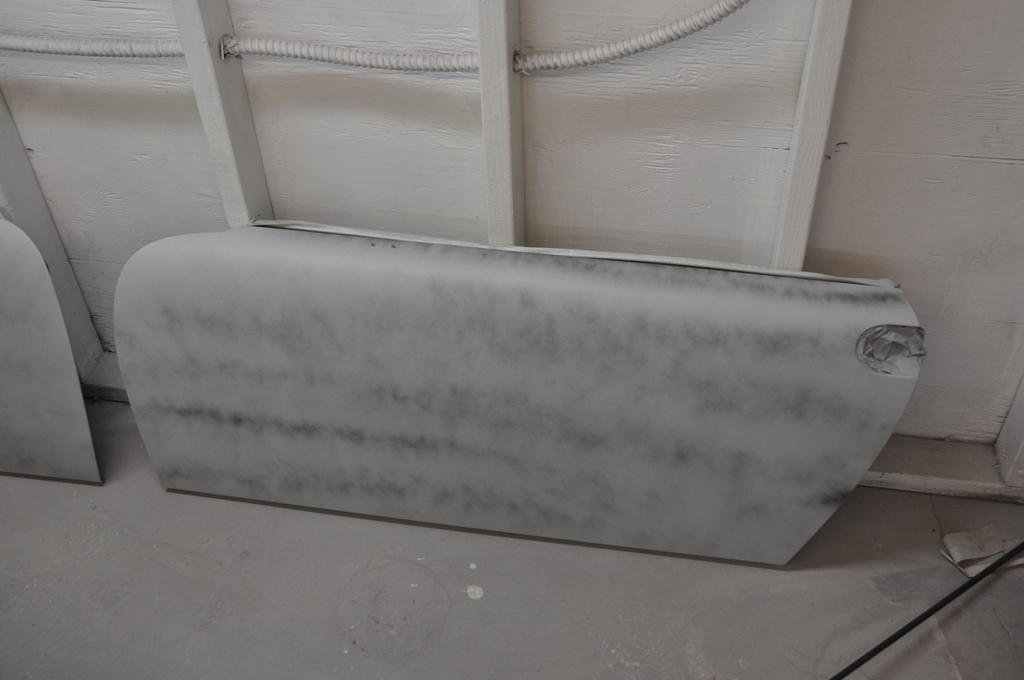

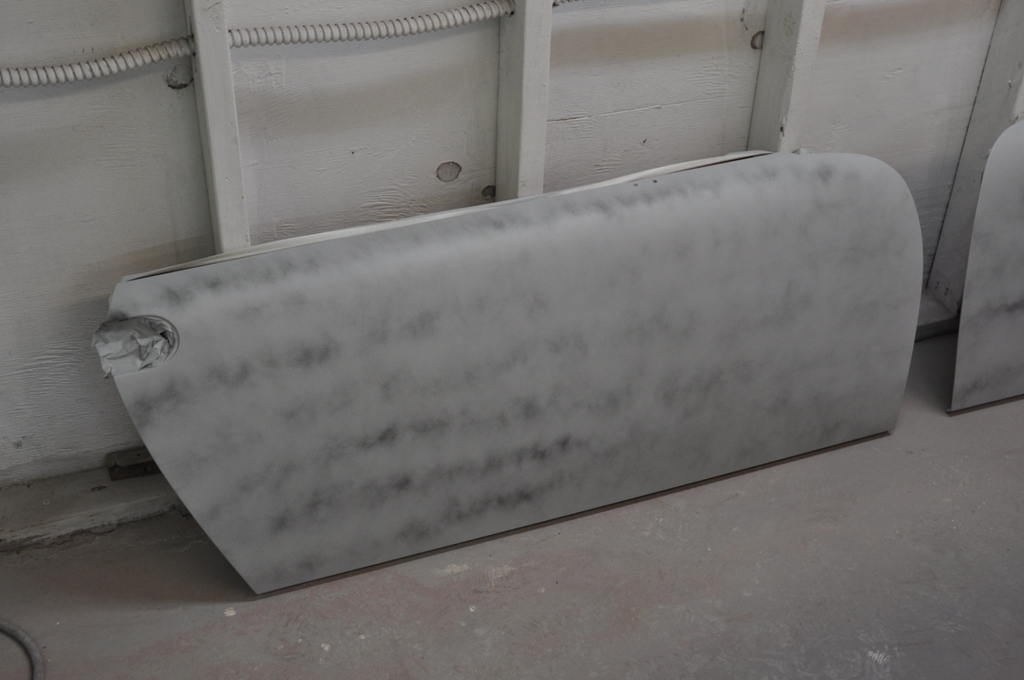

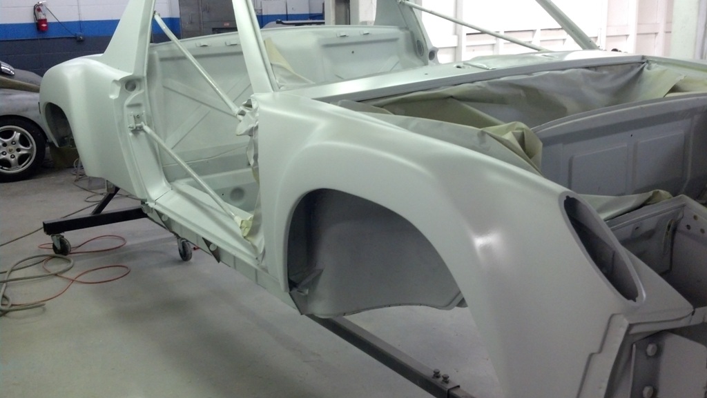

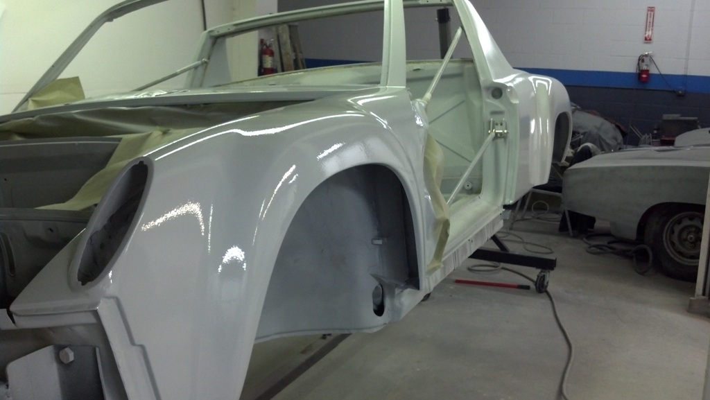

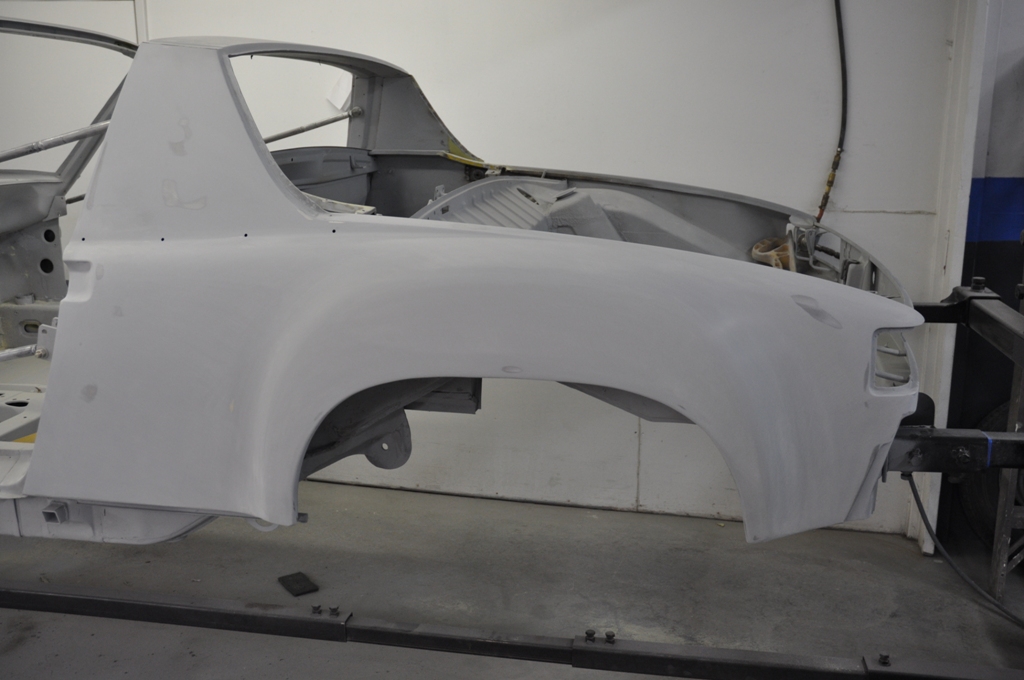

The last and very wet coat of primer, then 320 sanding and sealer

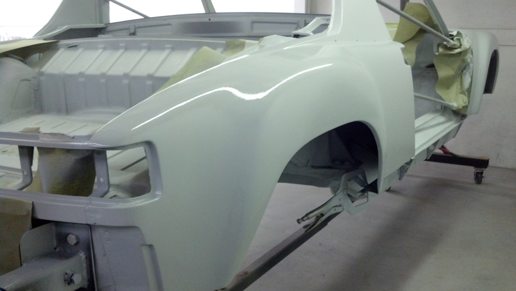

easier to see the lines wet and before another guide coat

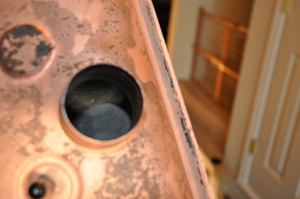

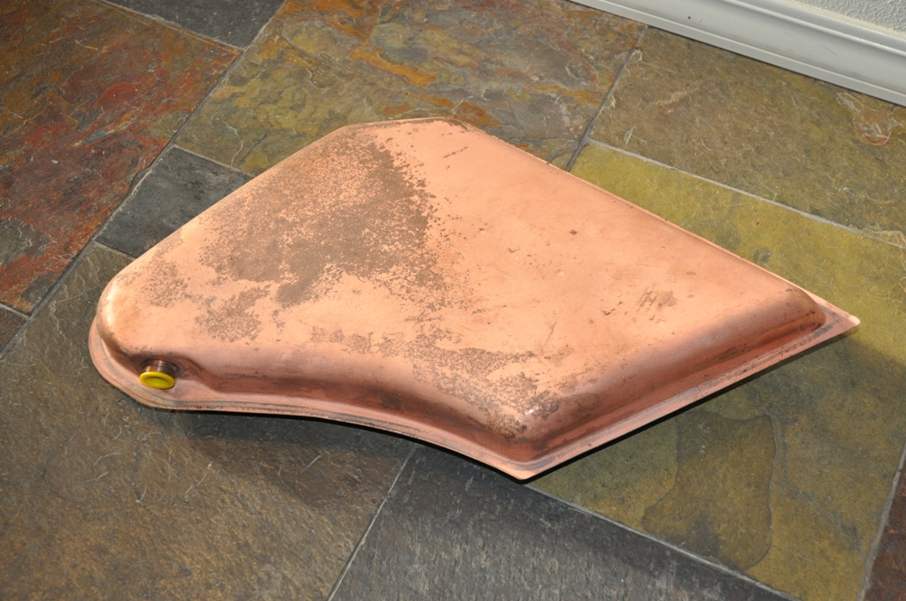

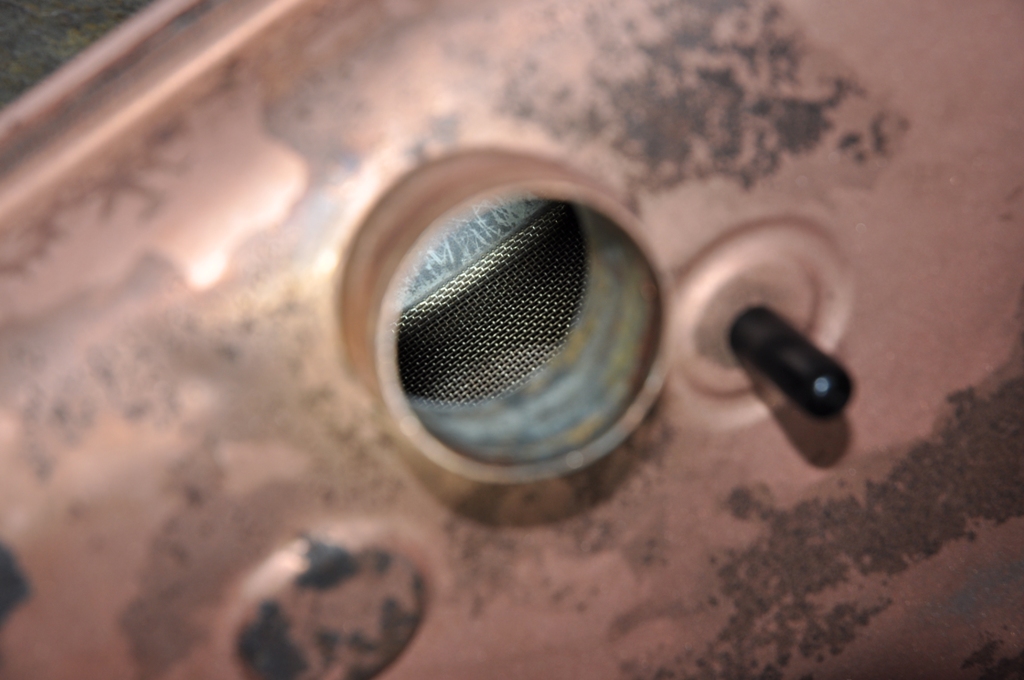

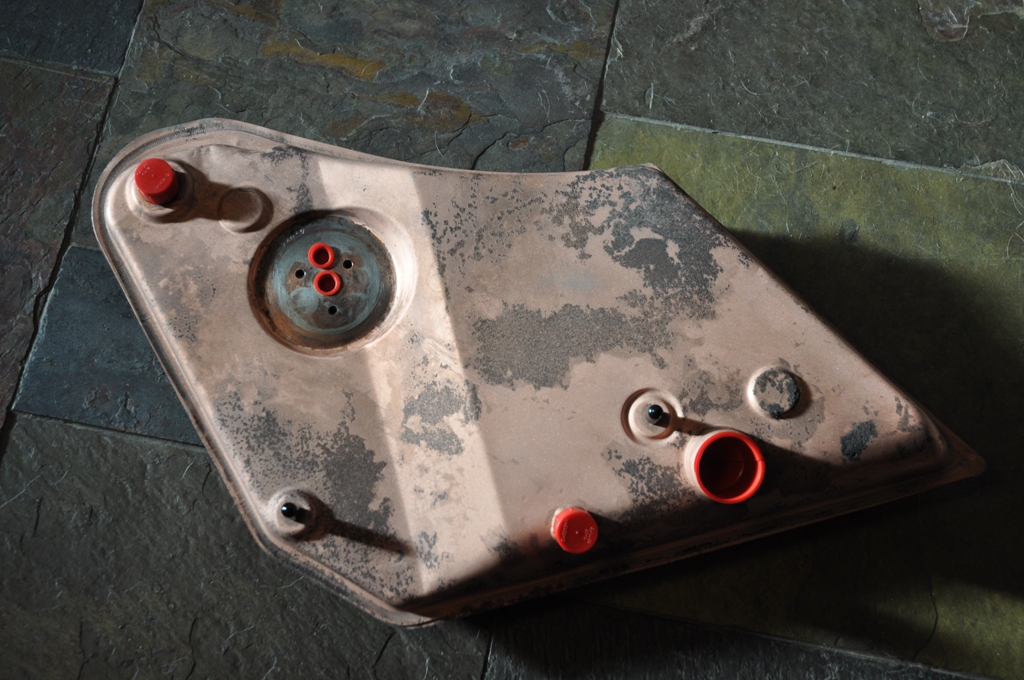

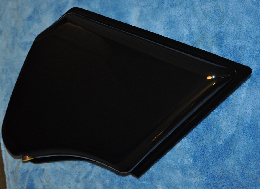

I got the oil tank back from the boys at Pacific Oil Cooler service and man is this thing clean inside and out. Thanks to Joe O'brien for telling me about them, they do a great job on coolers and now I know they will referb. tanks too.
now its off to the chrome shop for copper plate and then powder coat.

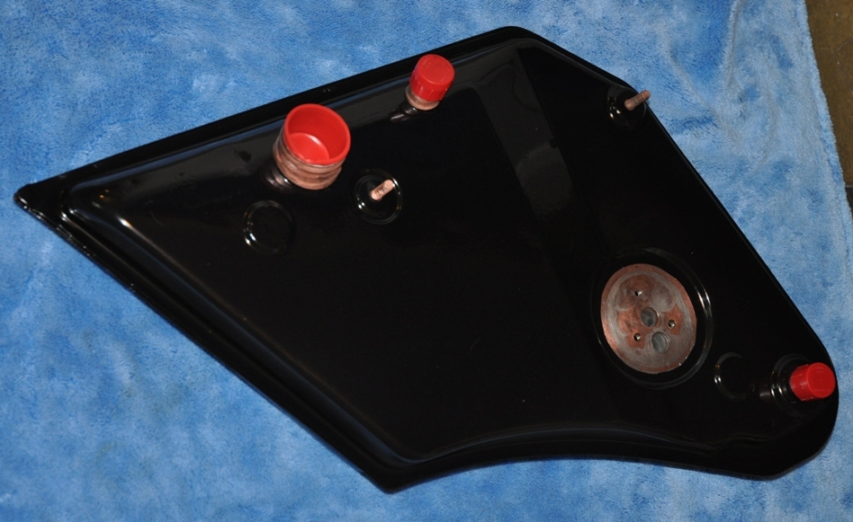

Now that the world didn't end we should have color on the pan,wheel wells, interior and engine compartment before the new year.
I did wrap up the oil tank and opted to use high temp paint instead of powder coating it. Got one little run while shooting it but know one will see it. I want to get a coat of oil inside to keep it from flashing and need some recommendations on what to use that wont contaminate the oil system later. I'm thinking regular motor oil would be OK but will the oil film stay put over time?

Put some motor oil in it and turn it over every once in a while.

That's what I was thinking but thought there might be something better. I didn't like the suggestion of using WD40. Really didn't think that would be something I'd want in the oil system

Definitely not WD40.

Regular oil and mix a bit of blue STP into it.
Say a couple tablespoons STP to a pint of oil. Only use the blue STP.
Use the left over oil for the drill press or any other storage rust protection.

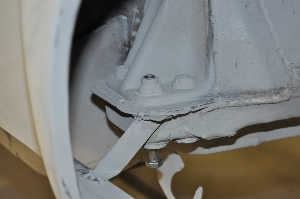

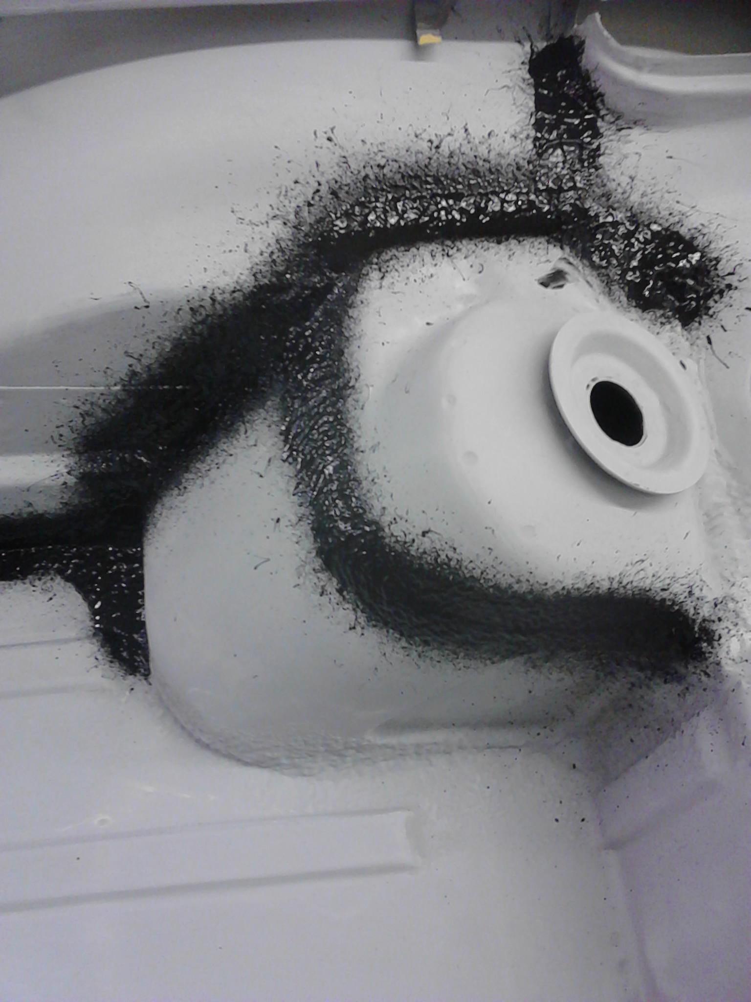

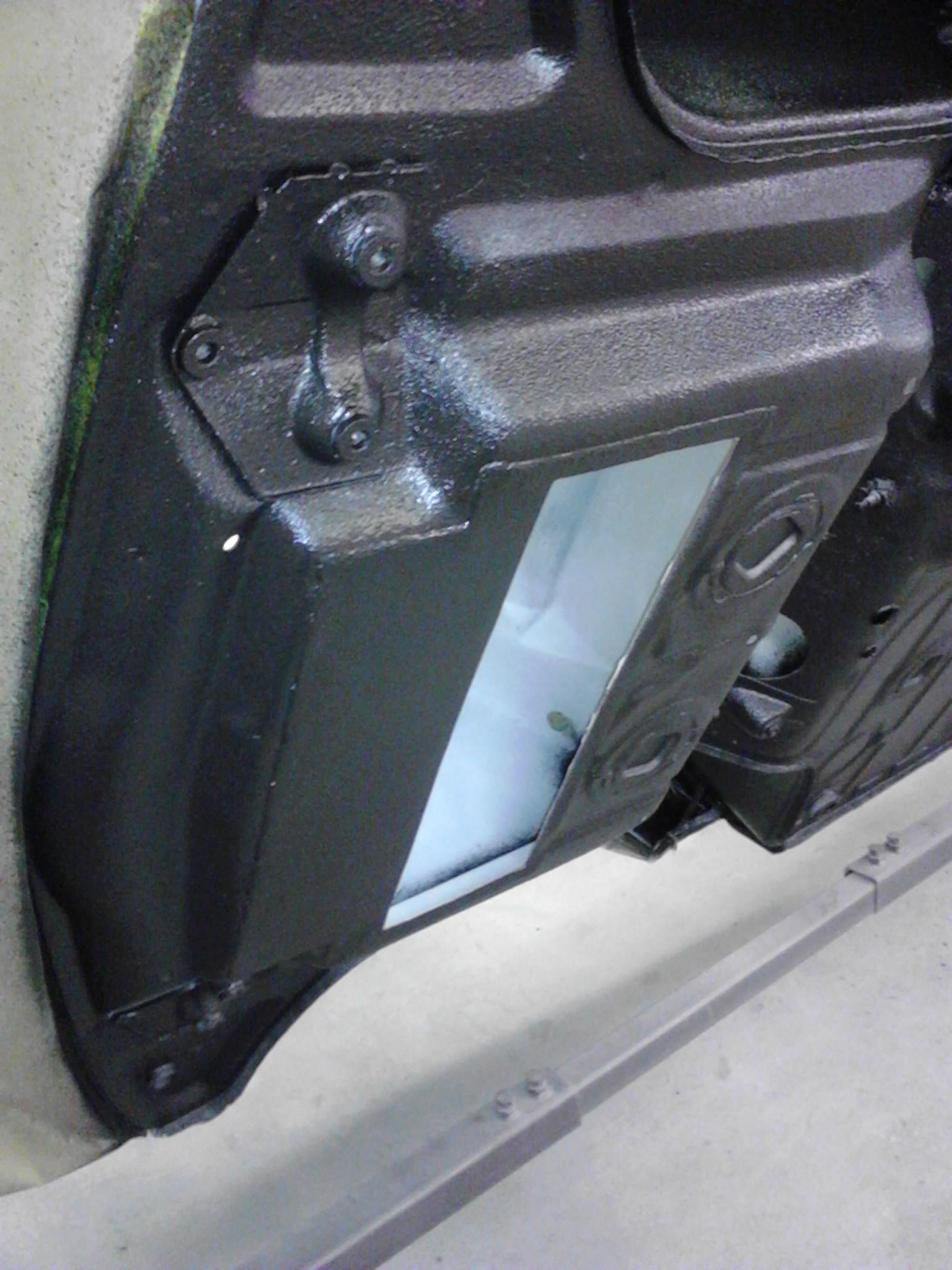

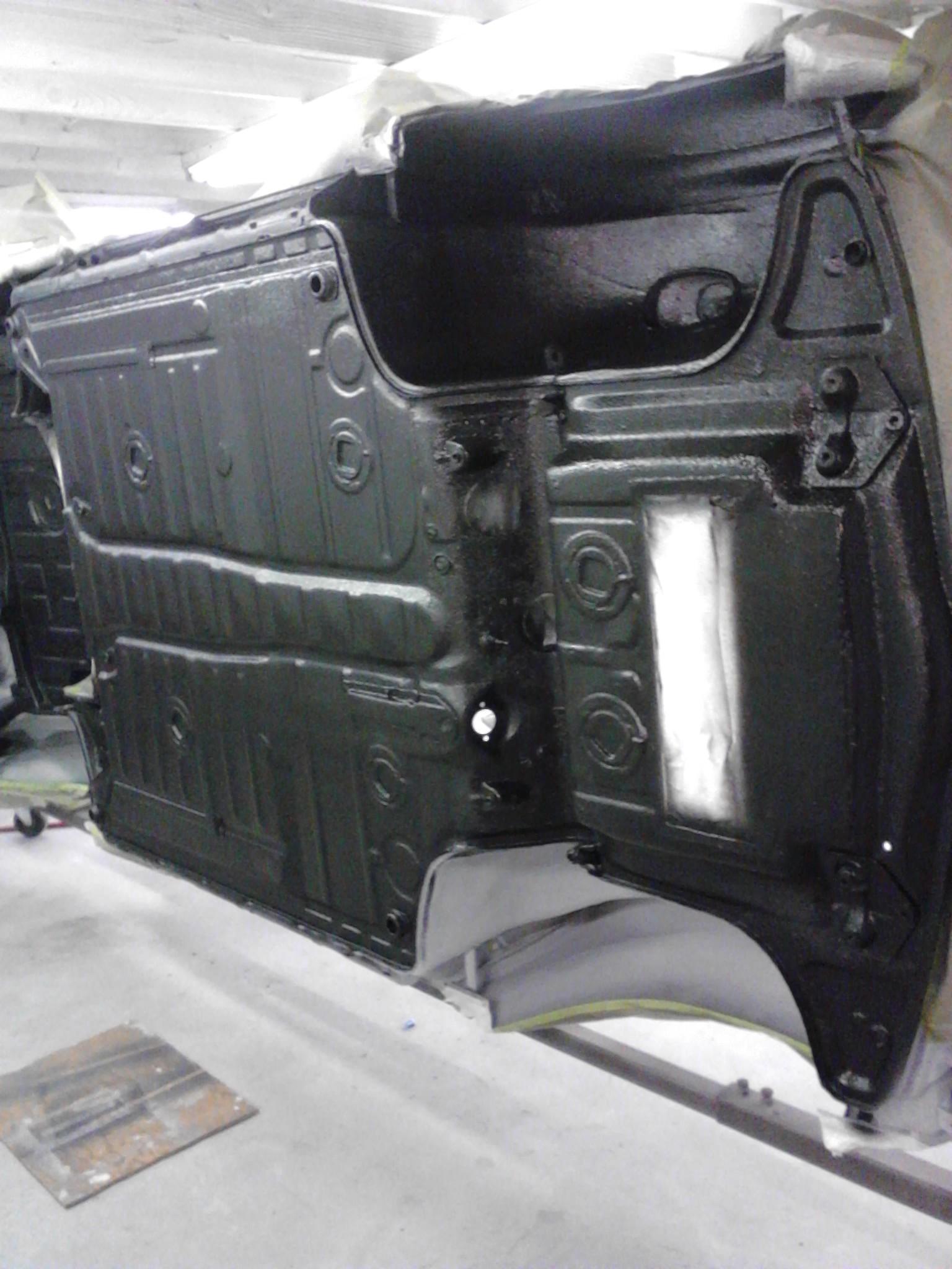

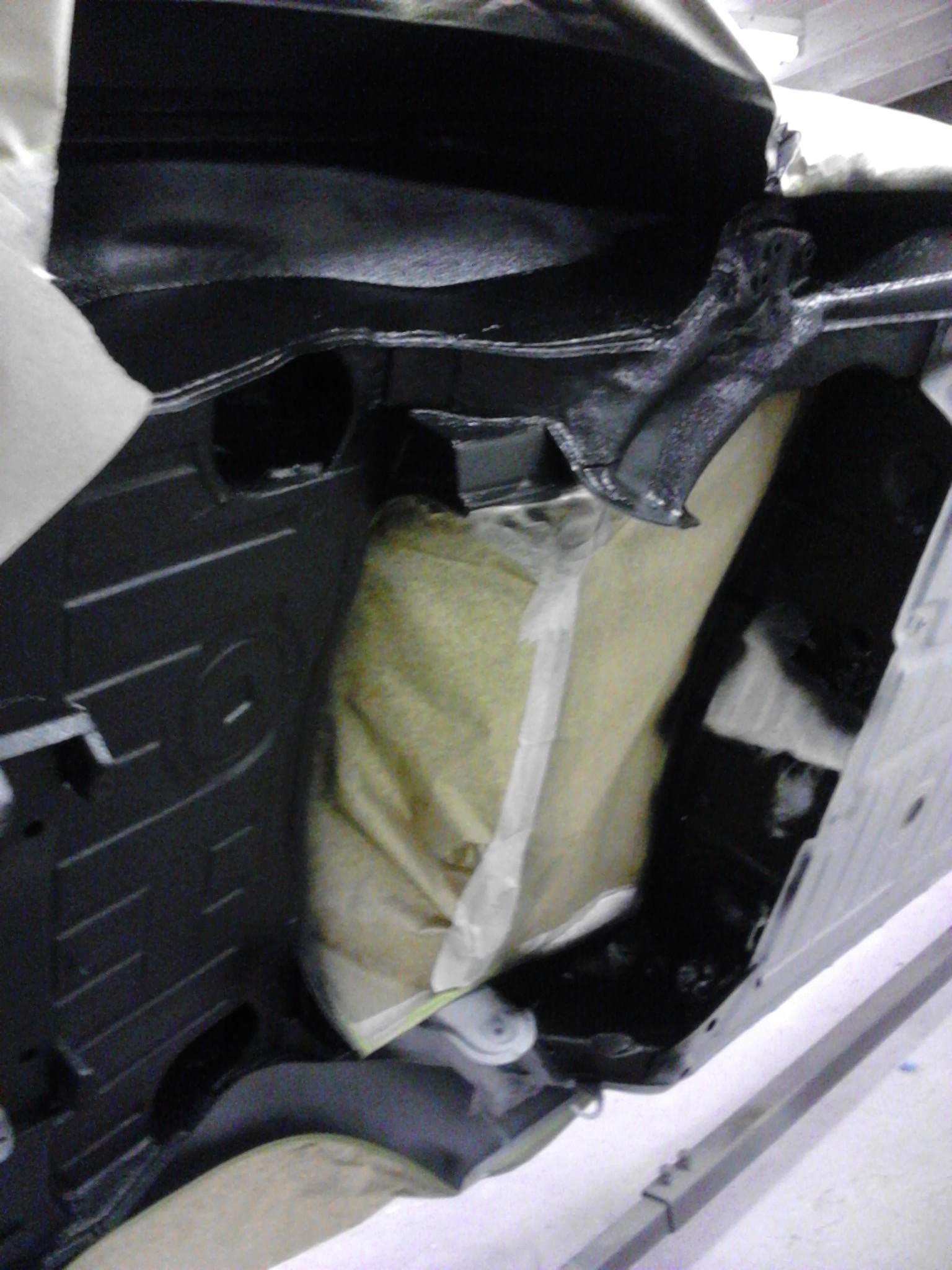

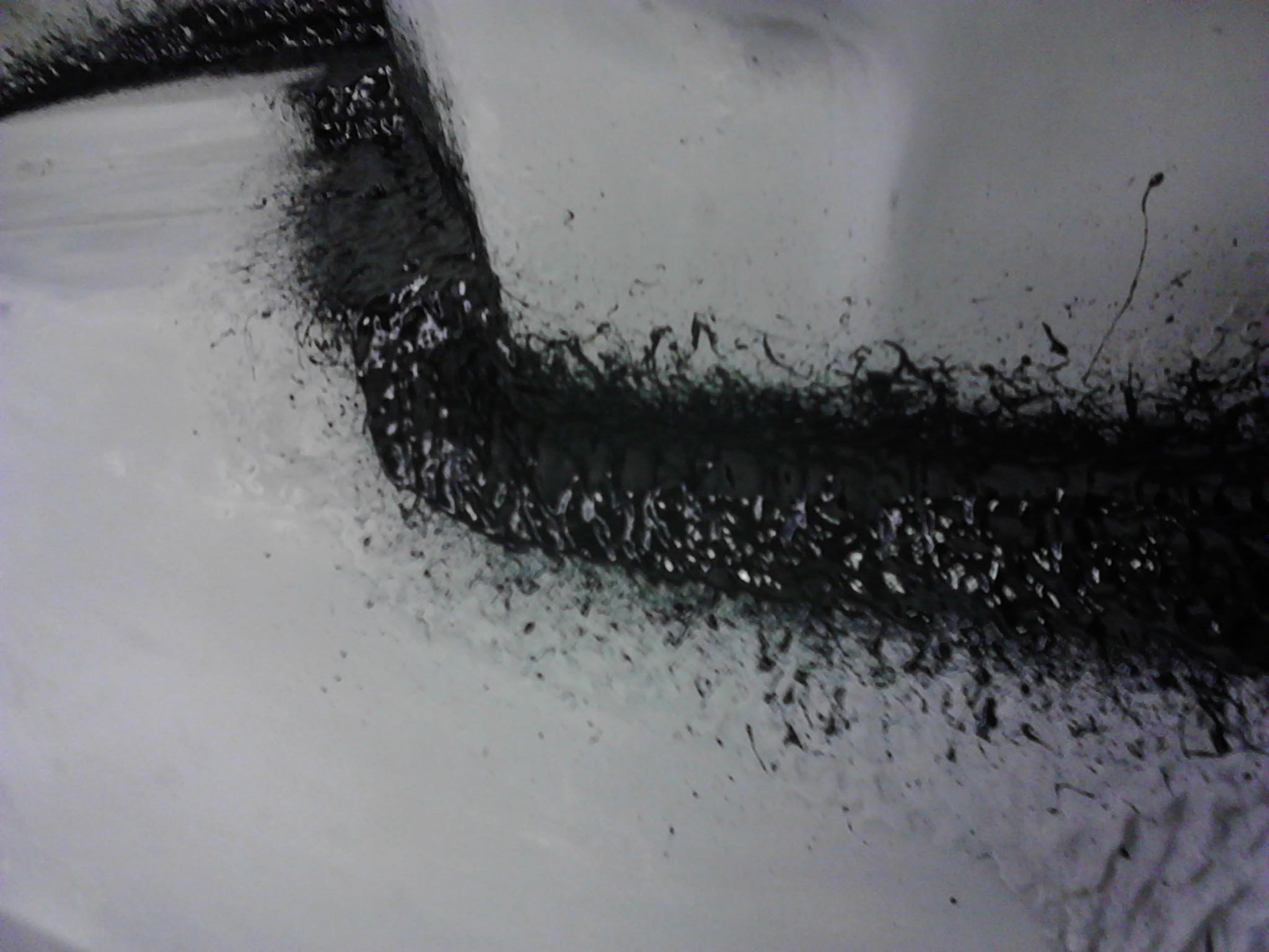

Undercoating today (IMG:style_emoticons/default/biggrin.gif) Sorry... cell phone pic. More later

Member No.: 10,742
looks great and works perfect for replacing seams I removed to get at the rust

Looks good in seams! What are you using?
