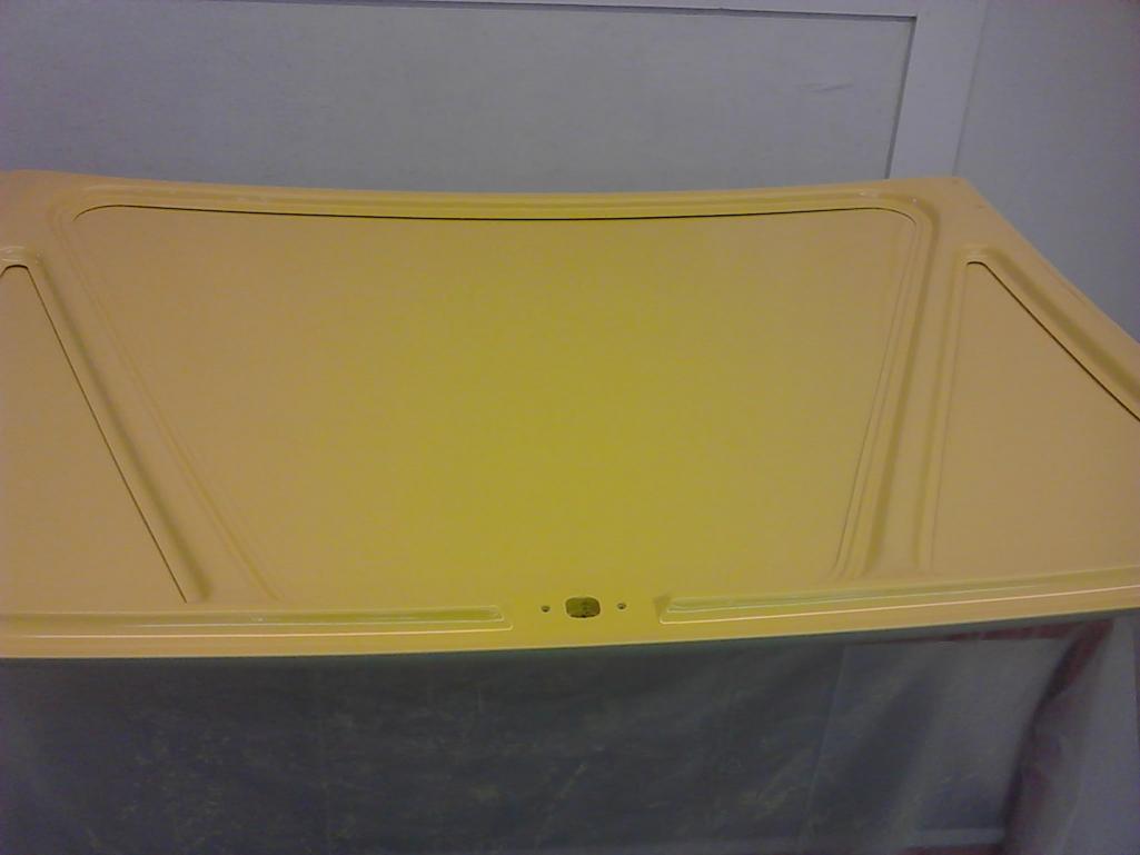

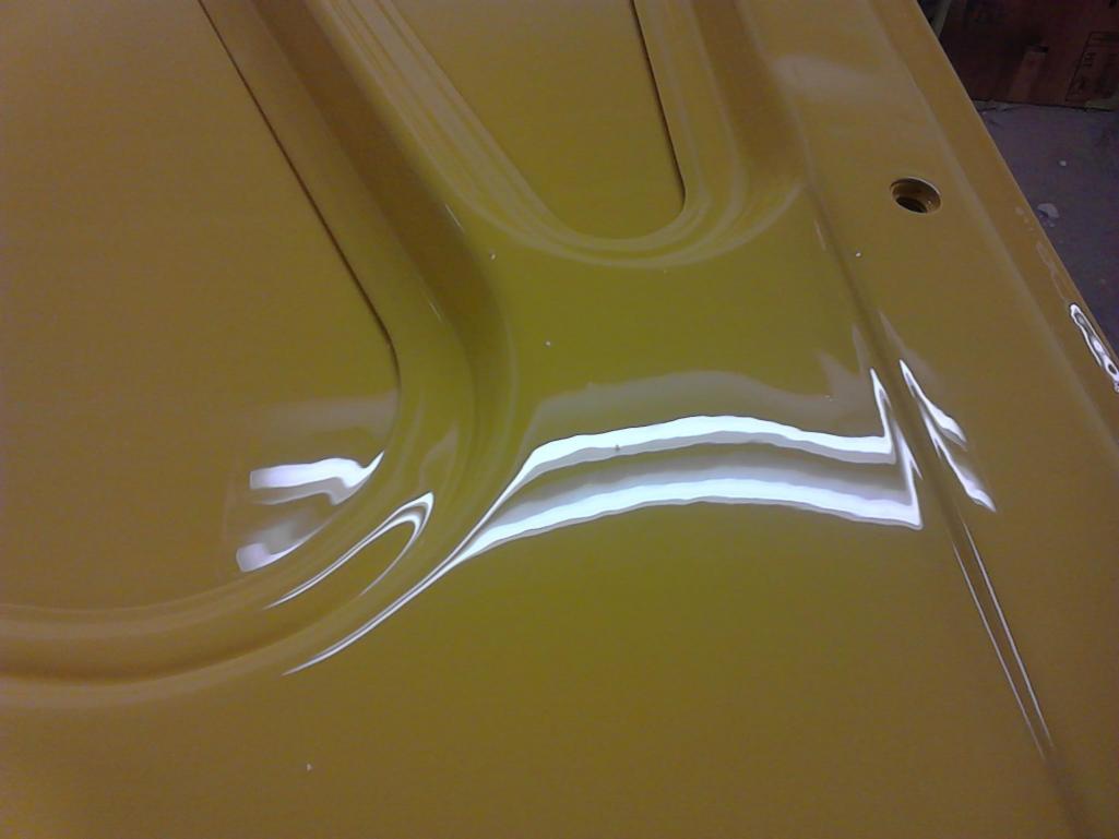

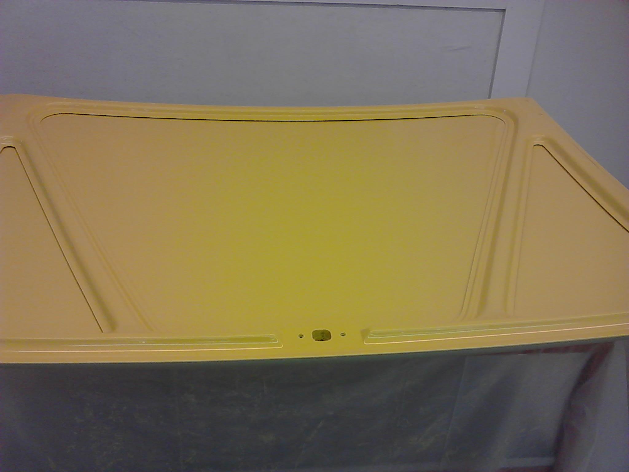

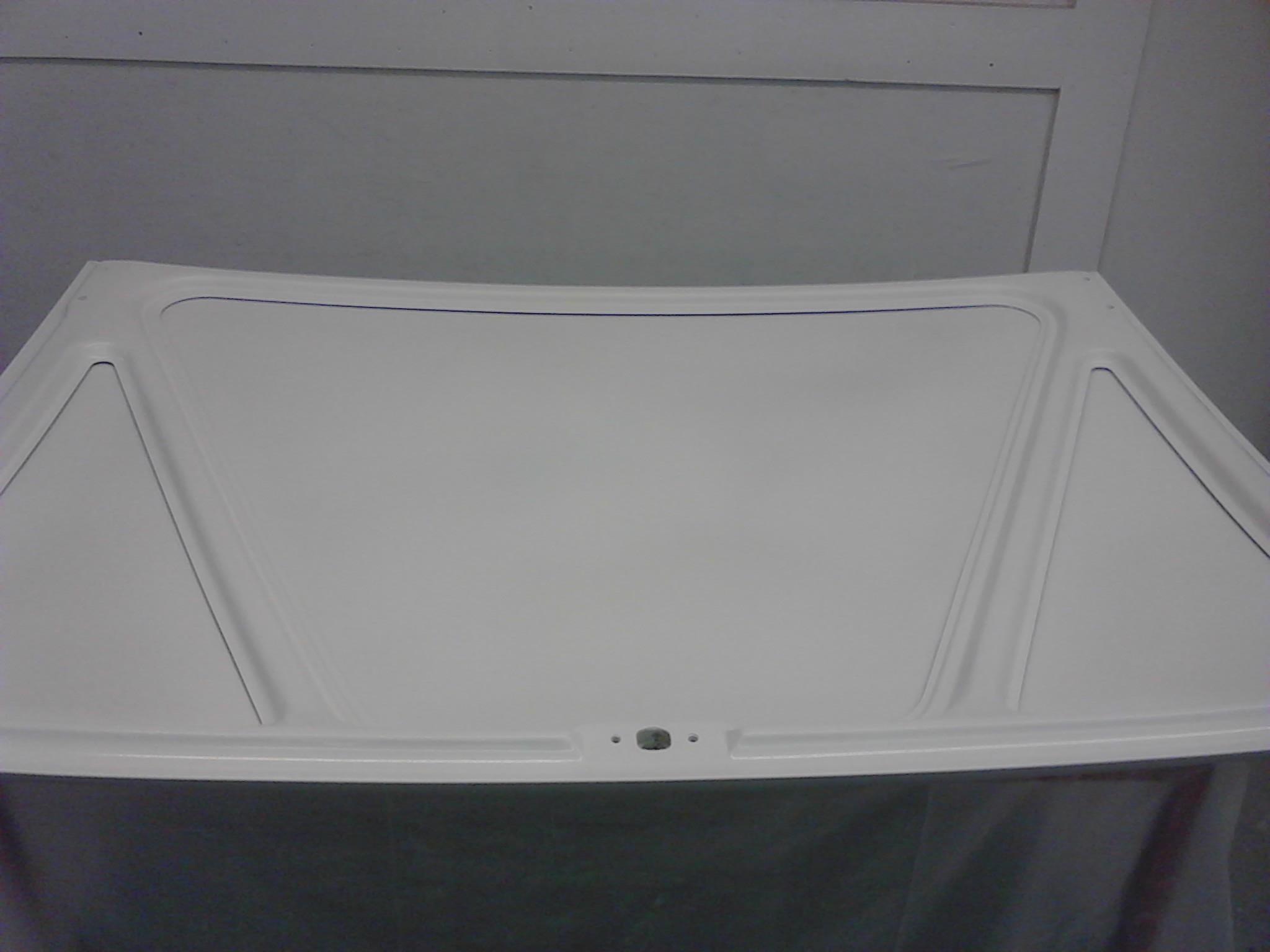

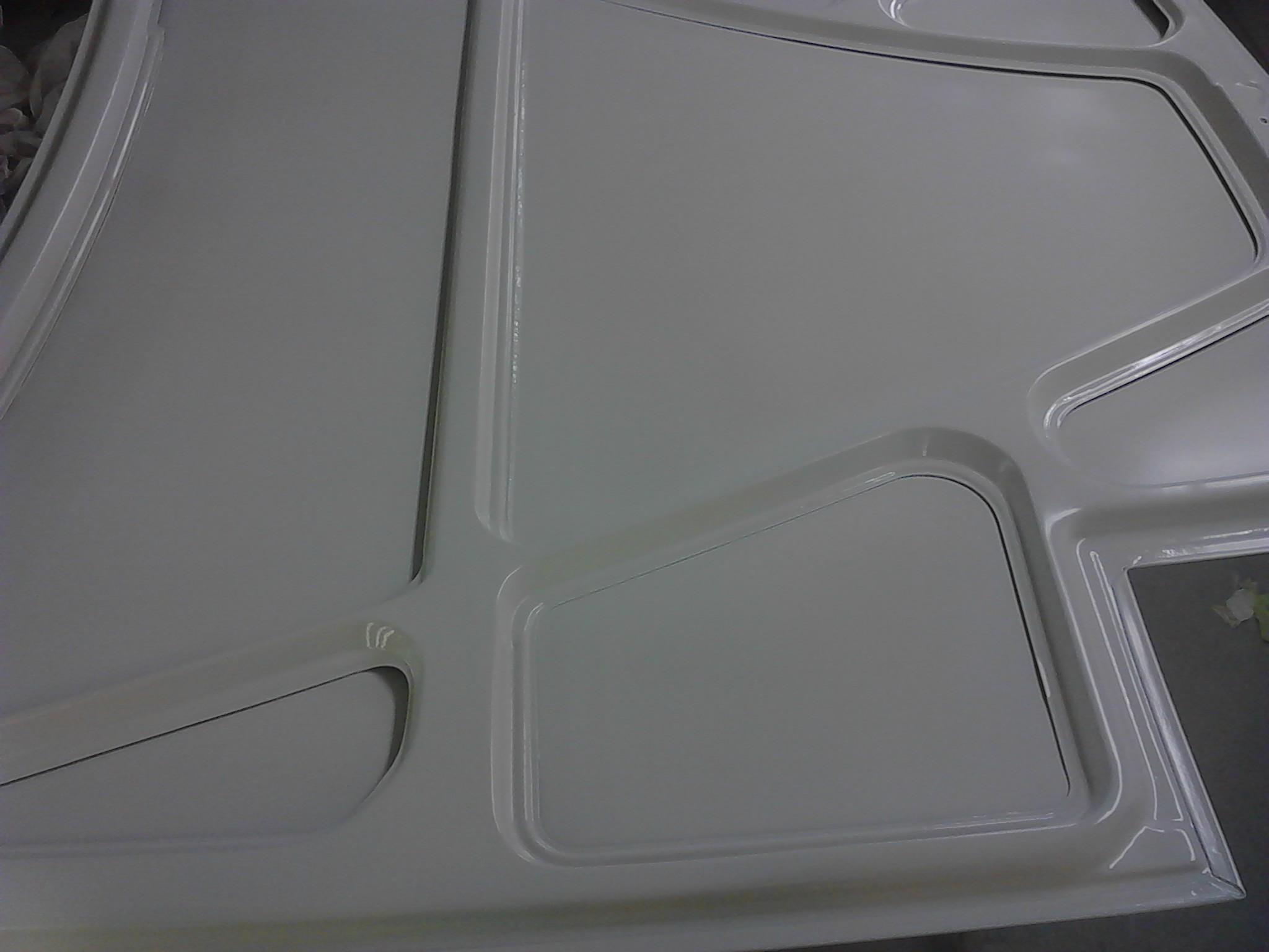

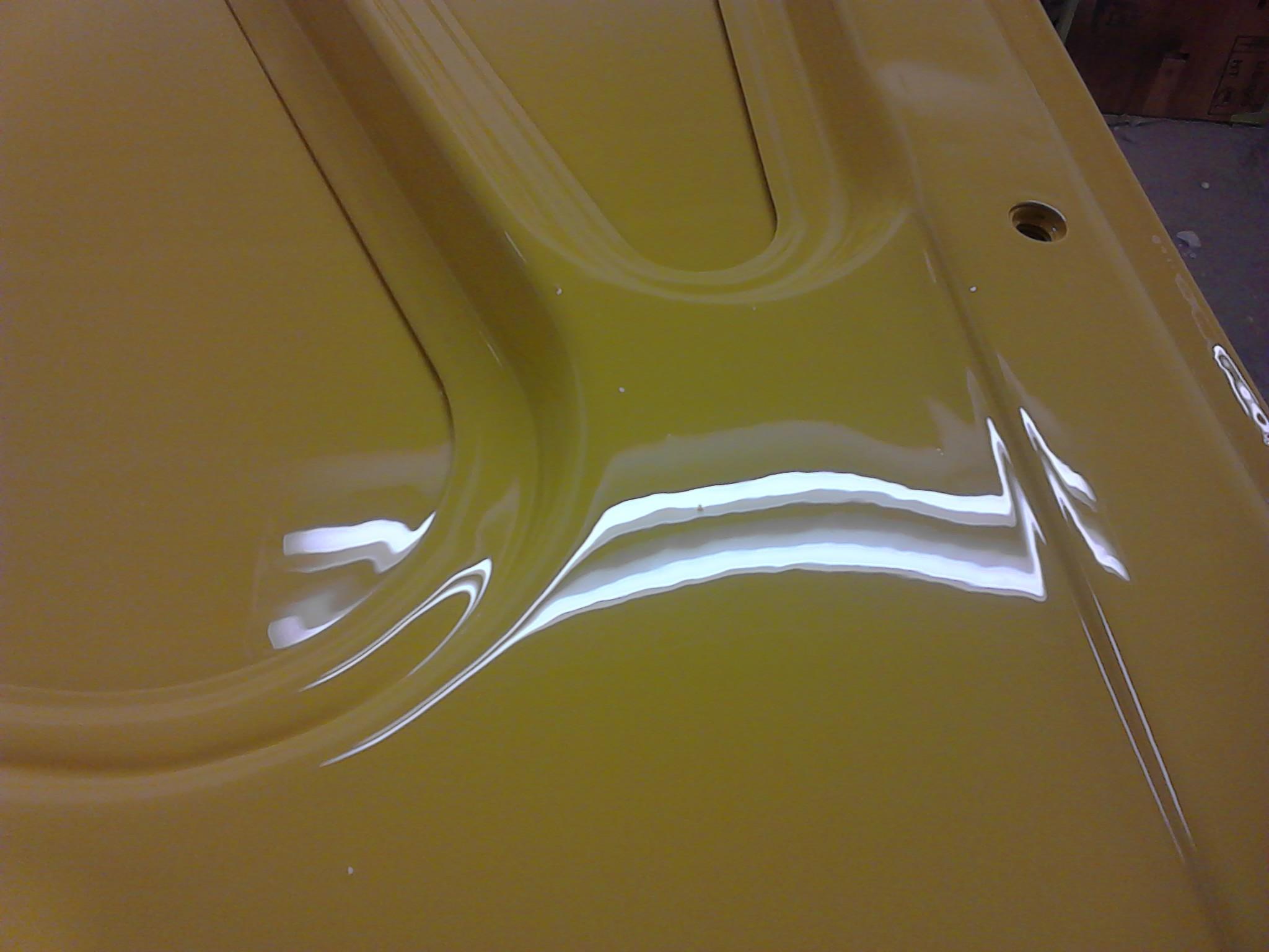

More paint laid down on the inside of front and rear trunk lids (IMG:style_emoticons/default/biggrin.gif)

That paint looks delicious!

Looks really good!

Andy, are you wet sanding after paint?

without a doubt, color sand and multi stage buff on the exterior of the car. This paint lays down so nice by itself and cant wait to see it color sanded and buffed out!!!

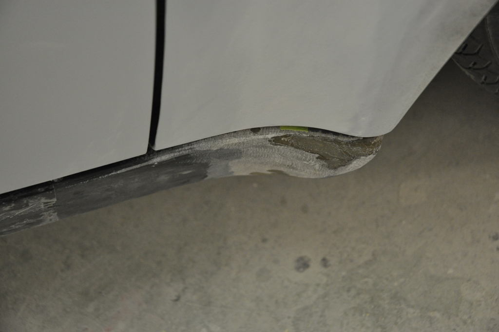

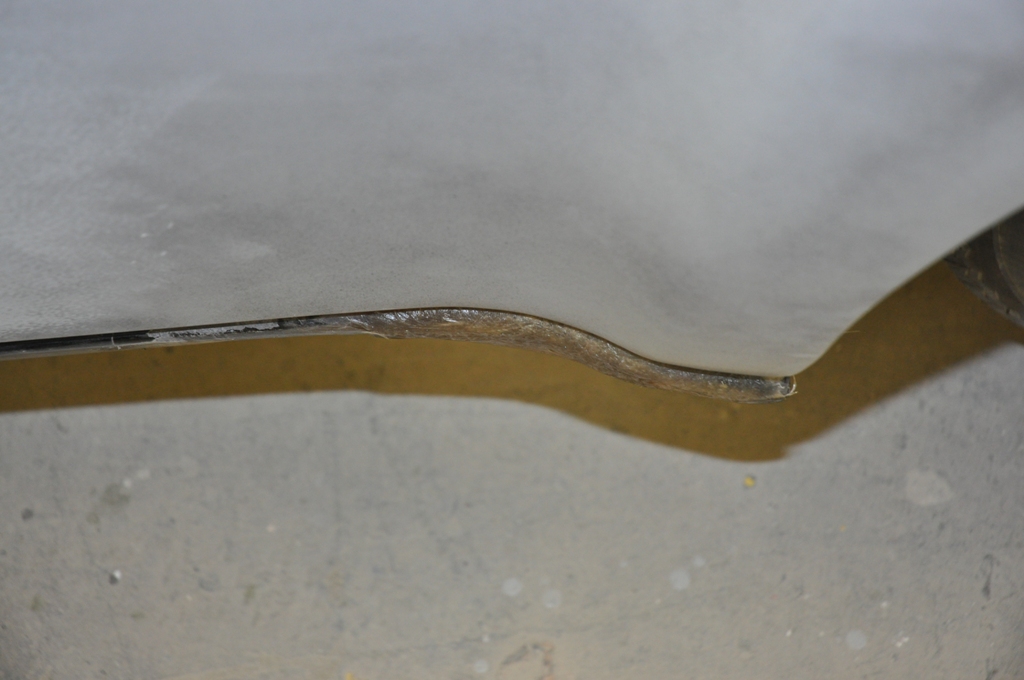

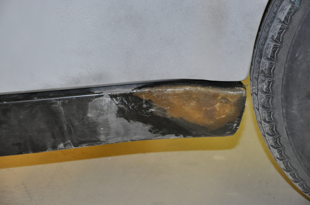

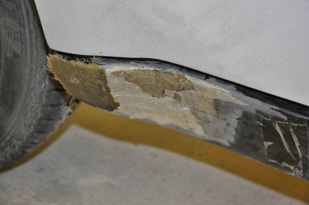

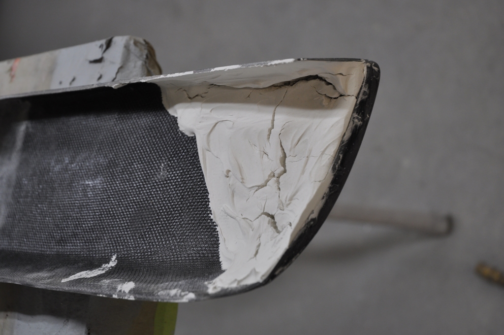

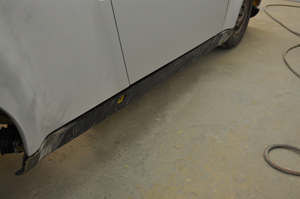

More rocker shaping and glass work, plaster back fill poured in to retain shape if grinding back broke thru. these things still need some work but getting there.

Looks like a great fit! (IMG:style_emoticons/default/aktion035.gif)
Are you going to run a flared rear valance too?
